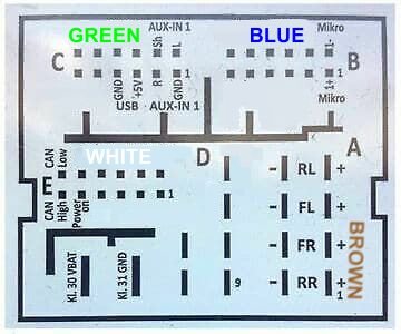

re-wire Your existing connector, see the above diagram (to make it clearer I have removed unecessary items), plug it in and... the most complicated part - try to find somebody to disable Component Protection for You. I have visited 7. yes SEVEN, so called independent specialists around my area and they all were unable to do so. Neverthless, if You did your wiring right, Your radio will work - just some features wont be accessible/available until you will find THE right guy to assist You with CP removal. I went step ahead, and I purchased FL speedometer from the same vehicle I got radio from (NOT a maxidot) which allegedly may help with CP removal.

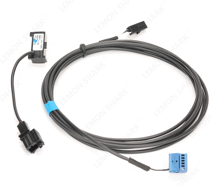

For complete integration of Your NEW FL radio unit, You will also require a in-Car microphone 🤔  Ive tried couple of aftermarket in-car microphones, but they would not work with the previously trialed Android Head Unit nor with genuine radio, so Ive decided to go full OEM by purchasing 3BD035711 - it worked like a charm.

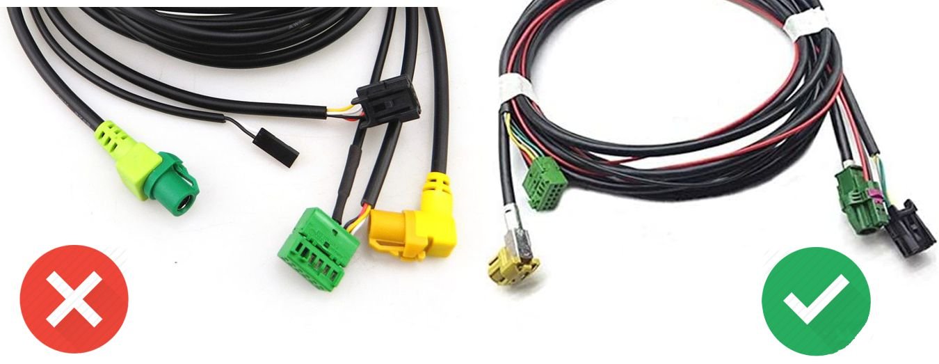

(5) avoid cheap copies from ali or ebay!! USB cable needs to look like a coaxial cable NOT like normal wire - see photo. Otherwise, it may not work at least it would NOT work in my case and Ive tried at least two different ones. If You will decide to use only USB part of the wiring loom, Black plug is not needed as this is for Your additional AUX port. therefore - 4-wires from the green 12-pin connector can be removed. Green 12-pin connector will be ONLY used to provide additional voltage to the USB port.

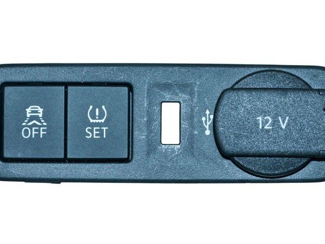

As the supplied wiring loom is very long, it is possible to add USB port as well additional AUX port next to Your cigarette lighter down at Your center console using 1S0863617B (NOTE: part 5Q0035726N is still required), buttons can be replaced or blanked or, if Your imagination and Your DIY skills allows it, there is so much wire supplied that You could install it in Your arm rest :D

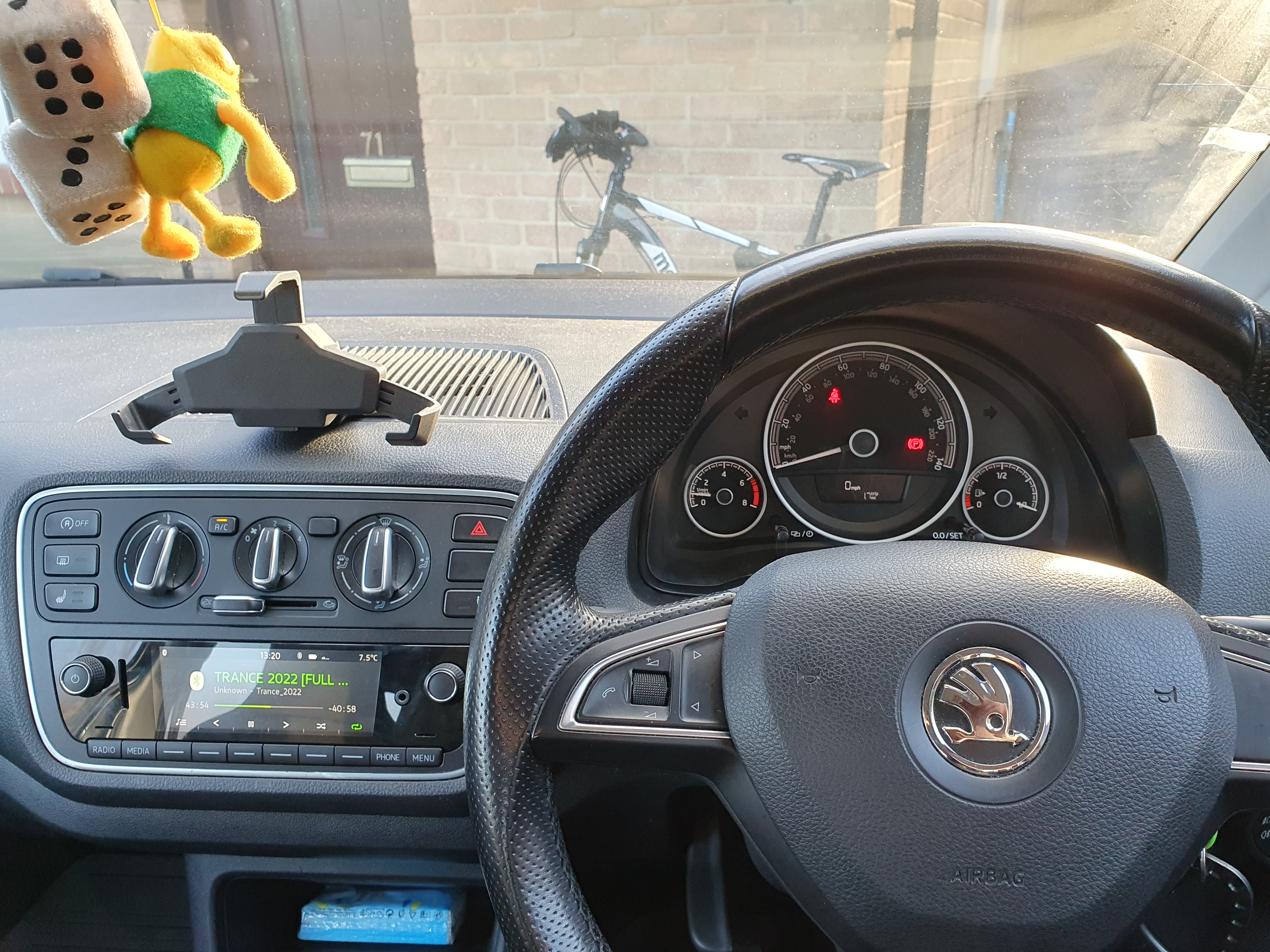

Mod completed.
Cloned speedo arrived just in time for Christmas :D
Having a speedo and Radio unit from the same donor car made a job much more easier. I wont be complaining that's NOT a maxidot instrumant cluster.
I am so pleased with the outcome!! 😏
This would not be possible without @maxychat and @RickB directing me to The Guy in the Netharlands! Thank You!!
@P3P5I great work dude!  your pre-face lift is now more facelift than my actual facelift since you have the upgraded cluster which mine is missing 🤬🤣
If I'm seeing correctly I can see you have the Bluetooth working, fantastic work.
Is the data passthrough on the top of the dash working?
Ive learnt from my mistake as I was under the impression that all NEW FaceLift Radios come with Bluetooth. Sadly, BLUES radio DOES NOT have BT connectivity. it have CD slot instead 🤭 so, the radio to be used for retrofit is SWING radio.
Bluetooth is fully functional for phone calls, media streaming as well as Move&Fun App.
Yes, Media playback from external USB device as well as charging, just as per  one for Your earlier post - not the fastest but its there if needed.
P.S. the only feature it does not work, and it didnt work on the OEM unit, is FM RADIO 😳 I suspect aerial issues, but as I dont listen to the radio - I cant be bother to get it rectified.

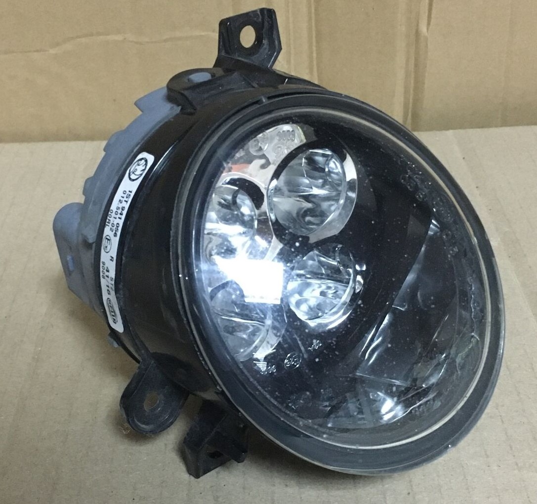

As we moved off to LED's subject. I have found LED fog lights available for SEAT Mii. VAG #1ST941056 O/S and VAG#1ST941055 N/S.

Interesting about the LED fog lights. I had a quick look this morning and they seem to be from the Seat Mii electric car and are used as DRLs on it.  I'm not exactly sure how it works but perhaps it's different bulbs for the DRLs and for the fog lights all in the same housing since there's 4 LEDs in there.

Ok, you are right about saying, that these come from electric Mii and indeed they serve as DRLs.
From what I could see from available photos of those lights, plug on the outside appears to be the same as the one on the HB4/9006 bulb. So theoretically, if the plug is the same it should work (as a fog light - NOT DRLs).
