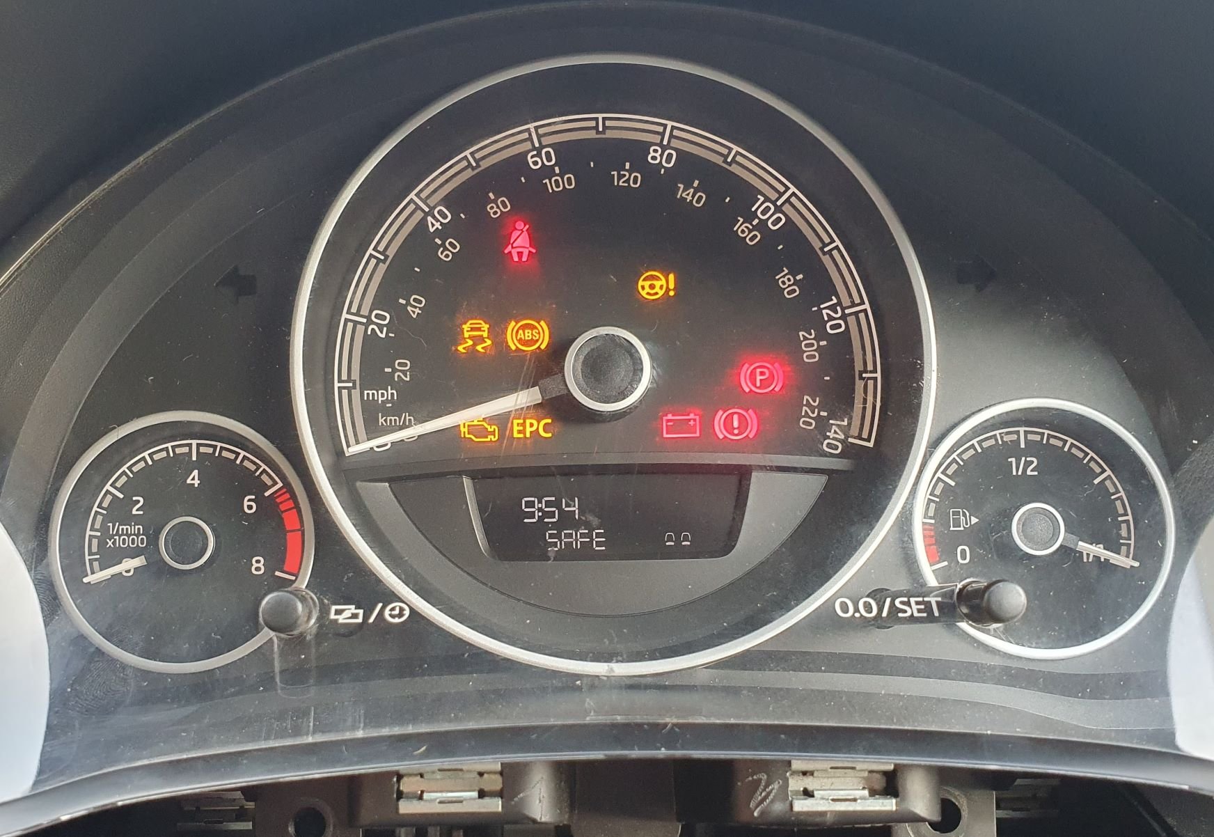

I just went crazy, and bought a maxi dot instrument panel from the very same car as the radio came from. Im aware, that speedometer will have to be coded to be used with my car. However, the "Wizard of VAG" wont be able to say its not going to work as BCM, Instrument panel and radio will be from the same car. thats theoreticaly, as practicaly I already have 1S0937090J BCM and the car ive got the bits from has exactly the same BCM, therfore I dont see a point of replacing it 😏

ODIS error 'no-KS Master' was caused by lack of facelift instrument cluster as this, in a way, controls the radio unit (sorry if Im using wrong terms).
So, dear reader, if You want to benefit from the facelift radio in Your car - You will also need a FL speedo!  Having both parts from the same donor car may simplify Component Protection removal process.
Bit of an update, replacement Instrument Cluster arrived yesterday :)
it is NOT a maxidot but still will look better than a OEM green backlight ;)
will keep You posted on the progress.
Yeah I was wondering which speedometer you got since I don't think Citigo ever came with a Maxidot, only the VW UP, and I think it's just reused from a VW Beetle too.   The black screen ones are really nice, I'm still don't understand why my facelift car doesn't have it!
@maxychat I have to admit, that I was bit disapointed when it turned out NOT to be maxi dot display 🧐 however, it will still look better that original from the pre-FL.
One of the main reasons, why I went with THIS speedometer in particular, is that it comes from the same vehicle as the radio. Therefore, the whole retrofit process should be slightly easier.
