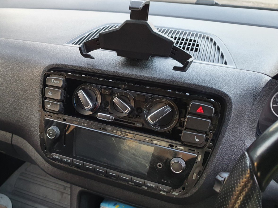

  • Bit of a summary, for those who might be interested in doing a similar mod.     First of all, You will need a FL radio. Ideally a SWING radio as it has a bluetooth connectivity - BLUES
The only minor catch is that the facelift phone holder with built in USB is a different form factor and electrical interface to the original PID bracket.
The shape of the hole in the top of the dash is the same but that's it - the bracket doesn't fit.

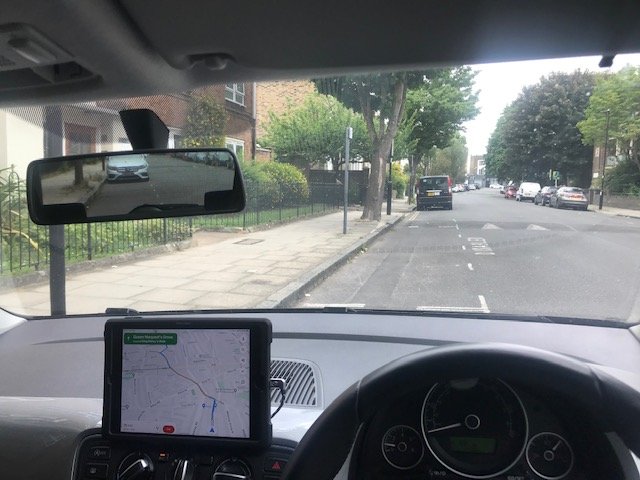

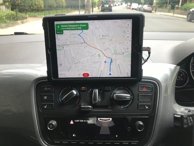

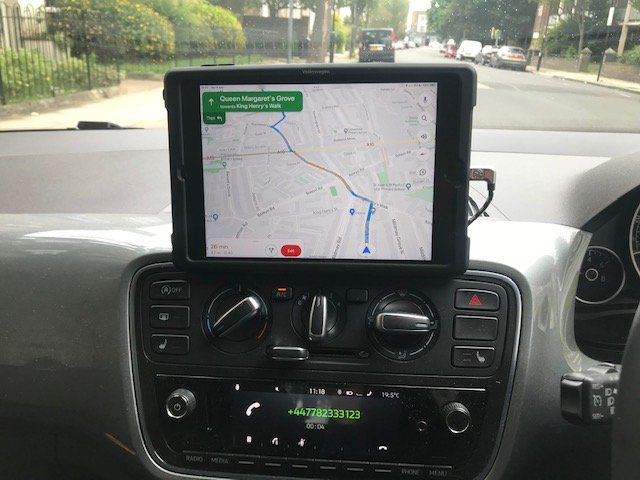

My fairly simple solution on upgrading the head unit.  Using an iPad mini 4 cellular.  I've found the iPhone app to be pretty much useless and use only google maps but have grown a bit frustrated with the small size of a phone.
Firstly and most importantly it doesn't block any of the field of view while driving.  It has the same advantage as using a phone, can run maps with directions through the speakers of the car, the field of view is so much better now - can see miles ahead, it make or receive phone calls through the phone, the reverse assist works like normal etc
IMG_6208.jpg.895abe62307d3fb14e783b0ebbd8649e.jpgIMG_6209.jpg.0c7a05c3d9f1be9c43d007947513bbc0.jpg
@maxychat Your choice was way easier as You already have face lift radio with built-in Bluetooth. That means, that You can use any Bluetooth device over Your in-car radio. Having vehicle pre-face lift vehicle, the easiest solution would be to replace the WHOLE head unit with something modern.
Your setup looks excellent! 👌

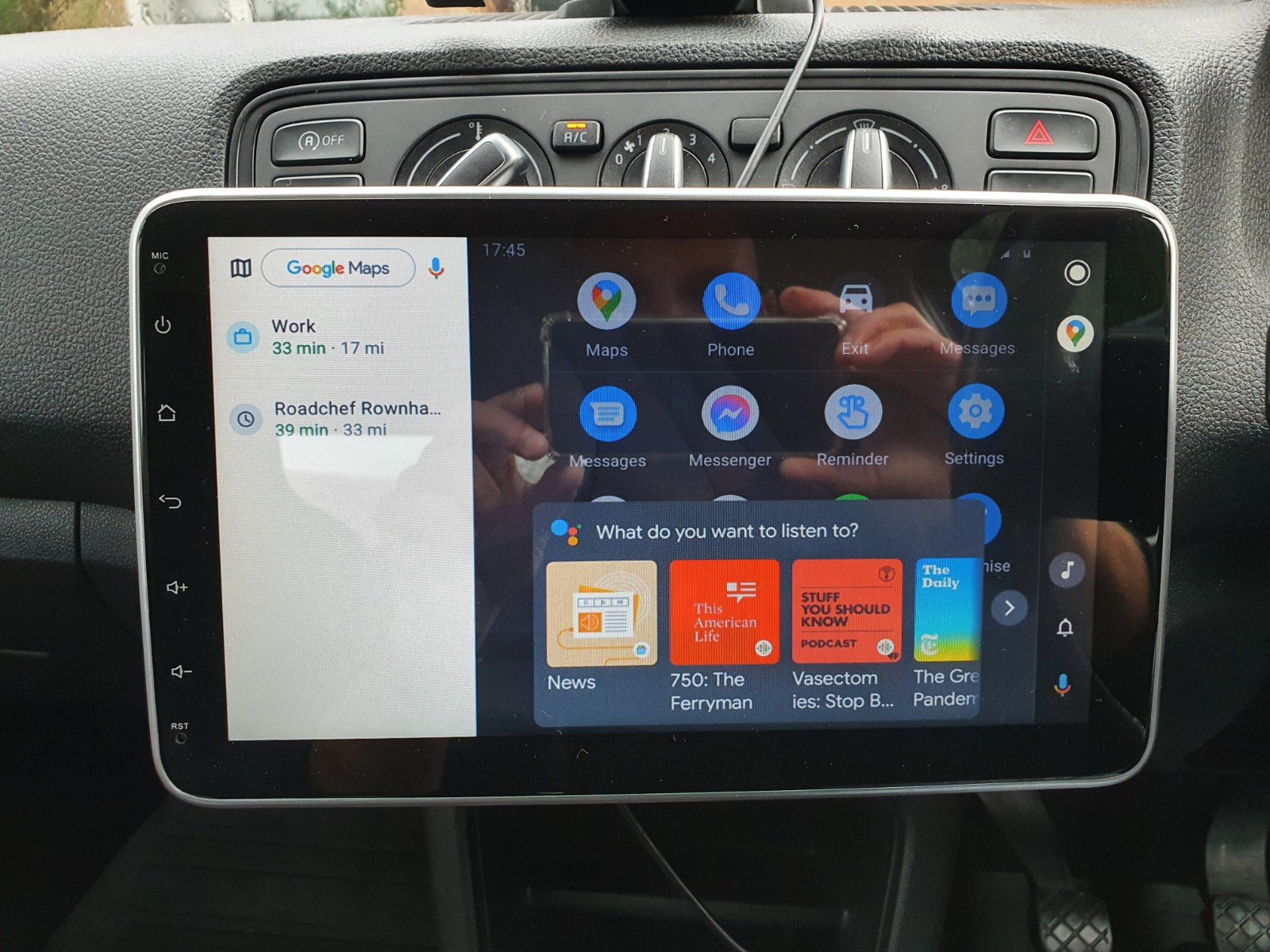

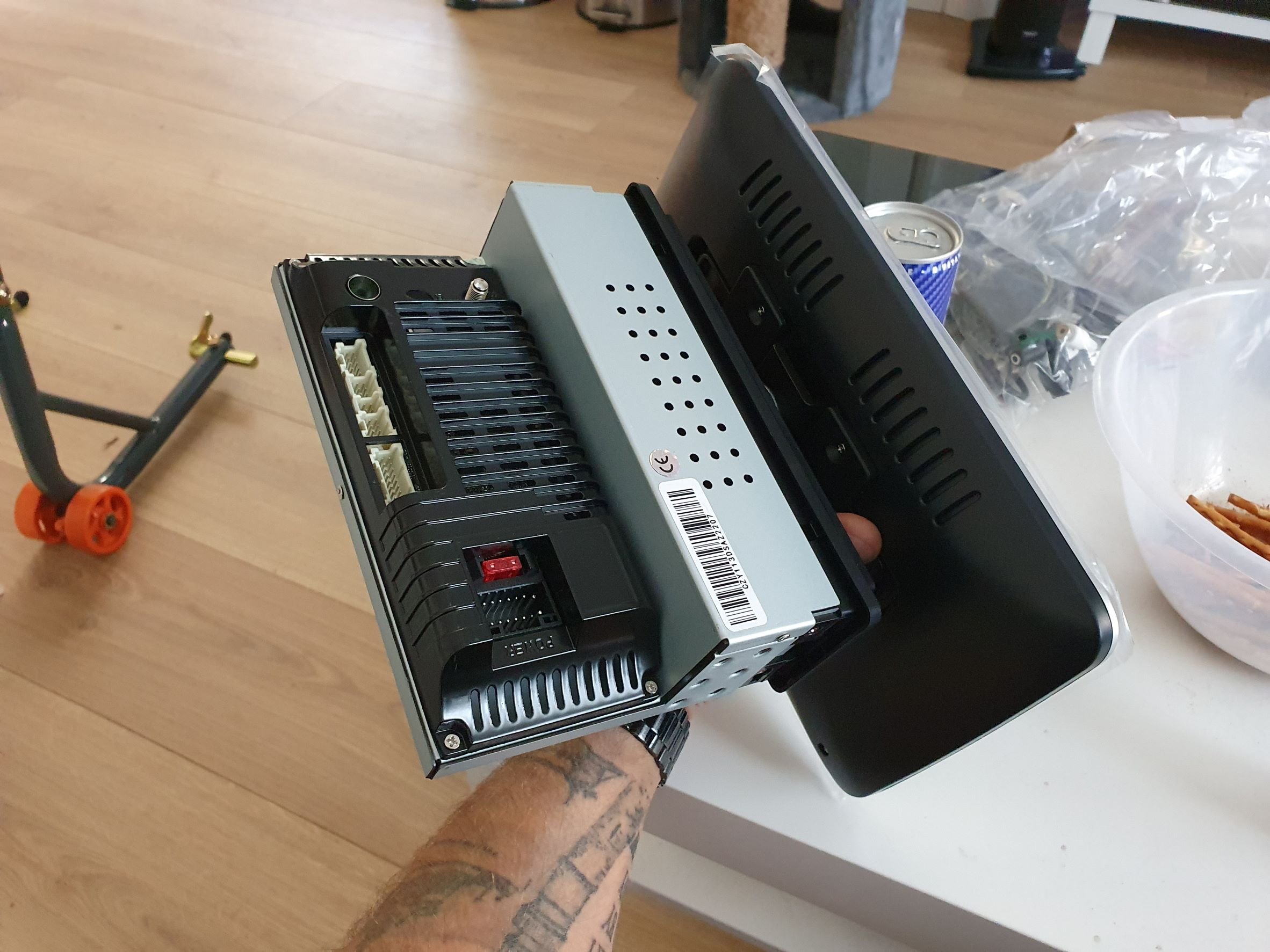

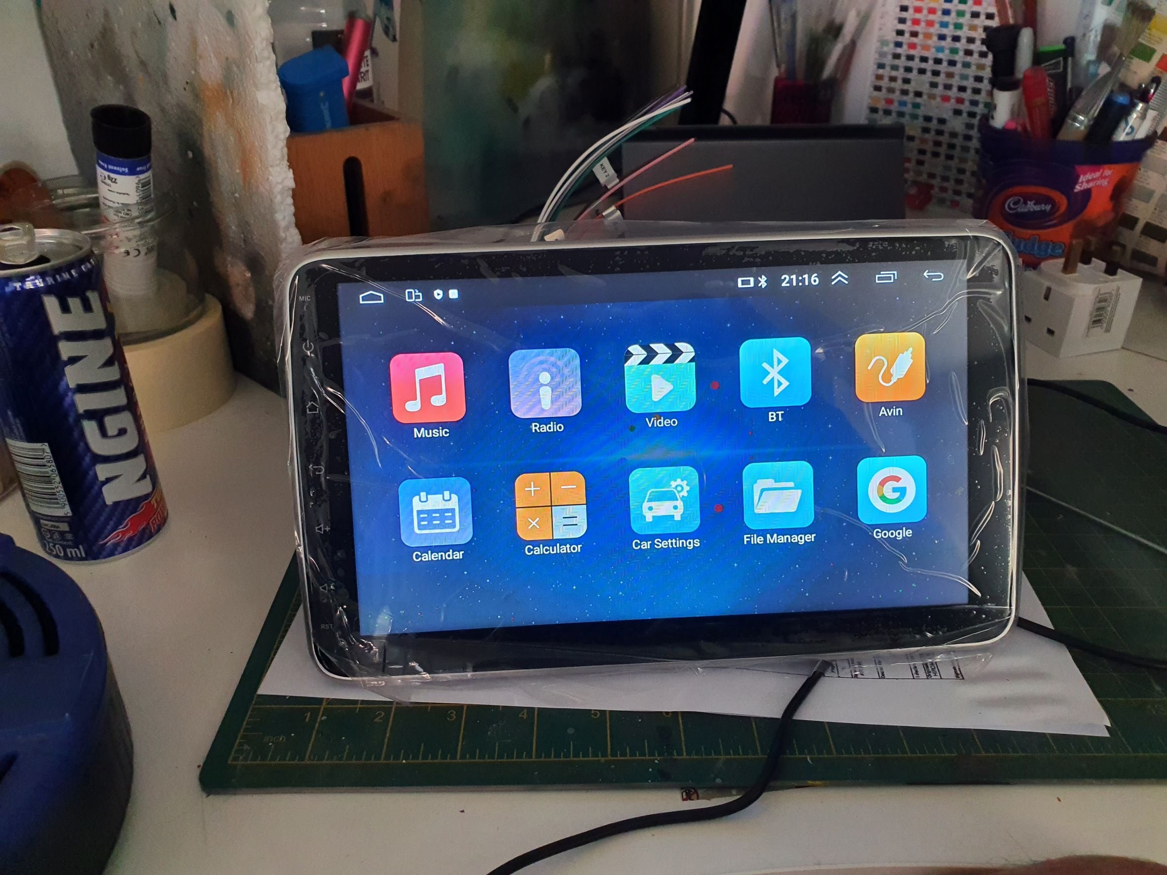

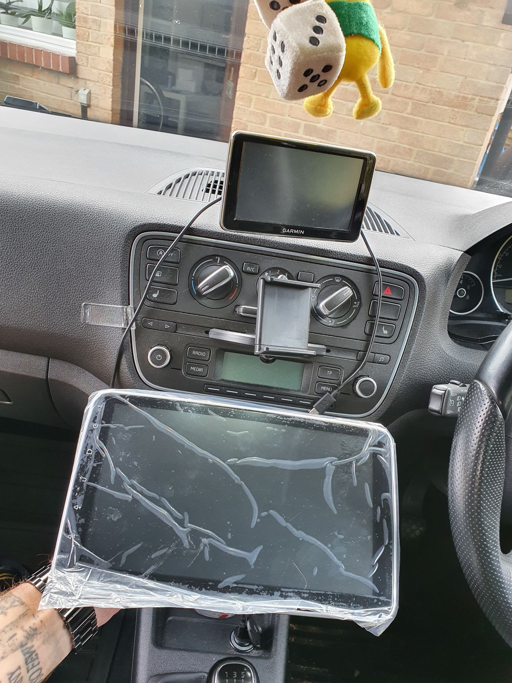

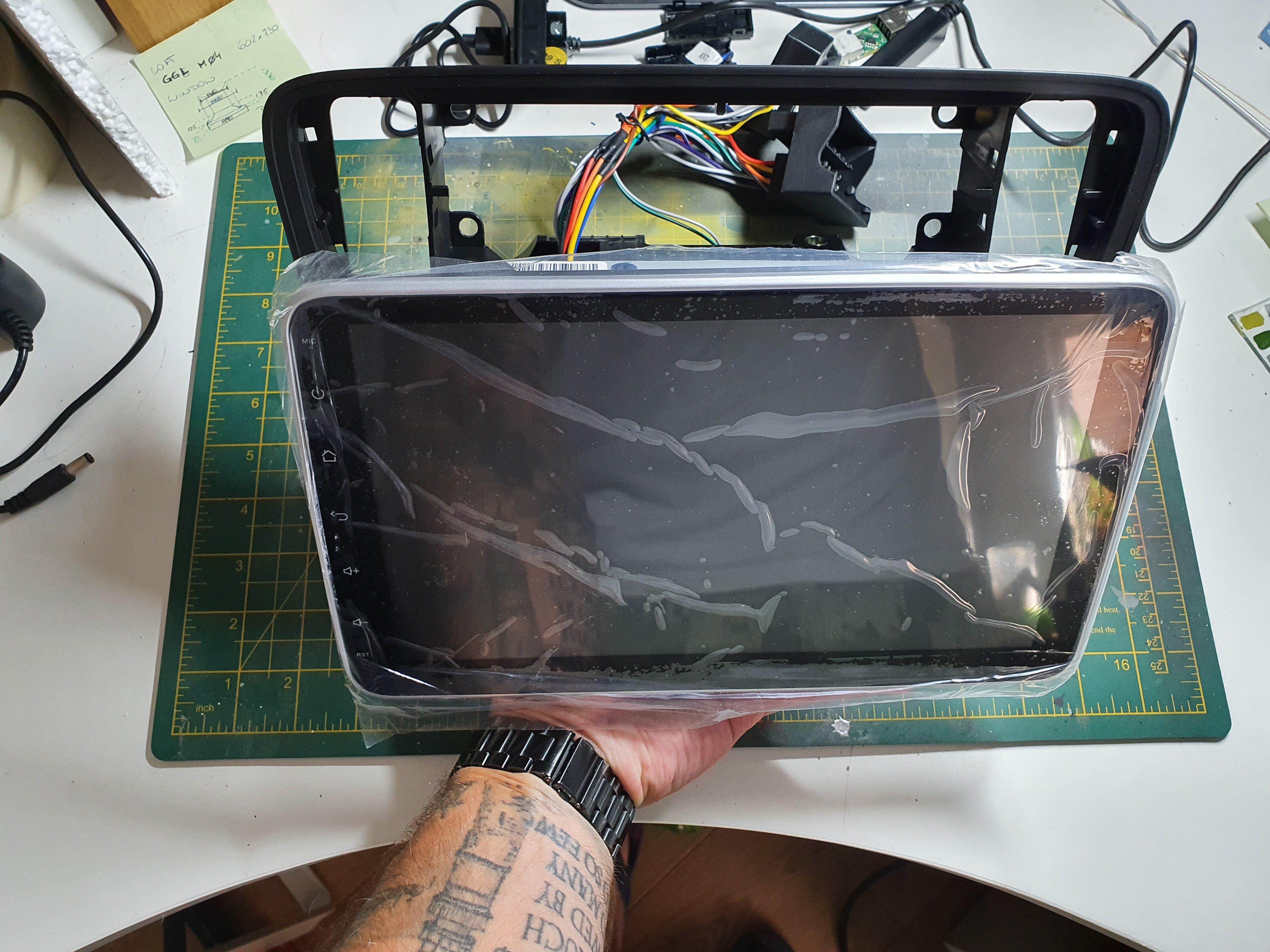

10Inch Android Auto... it is larger than anticipated 🤨
It will be something to tackle on my next day off
Various wiring adapters came trough i.e. OEM quadlock to stereo connector with CAN-bus adapter, aerial adapter...
Still waiting for a radio mounting frame.
NOTE: if any of you would decide to use single DIN fascia adapter, you will also have to purchase an aluminium mounting frame, as there is nothing to attach new head unit to the fascia.
It looks promising 😀

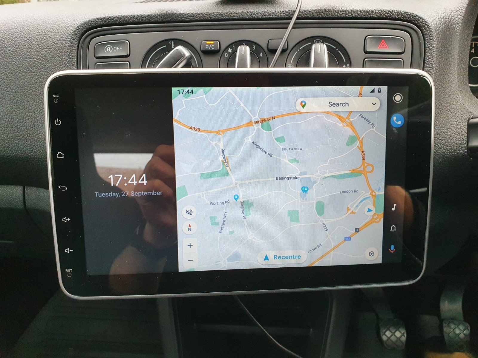

Few months later, I have finally managed to have the unit installed in my car. It looks good, sound is decent.
The CONS of this unit are:
- poor in-call quality due to poor quality of the built-in microphone; with an additional external microphone was NOT much better either 😕
- Lack of Android Auto functionality. This can be bypassed by downloading Headunit Reloaded Emulator by B3IT or its counterpart for Apple Phone.
- wiring issue - could NOT work it out - unit would remain ON even with the key pulled out of ignition. Every time had to manualy switch the unit off. Eventually, I found a way around it by disconnecting one of the power wires from the connector at the back.

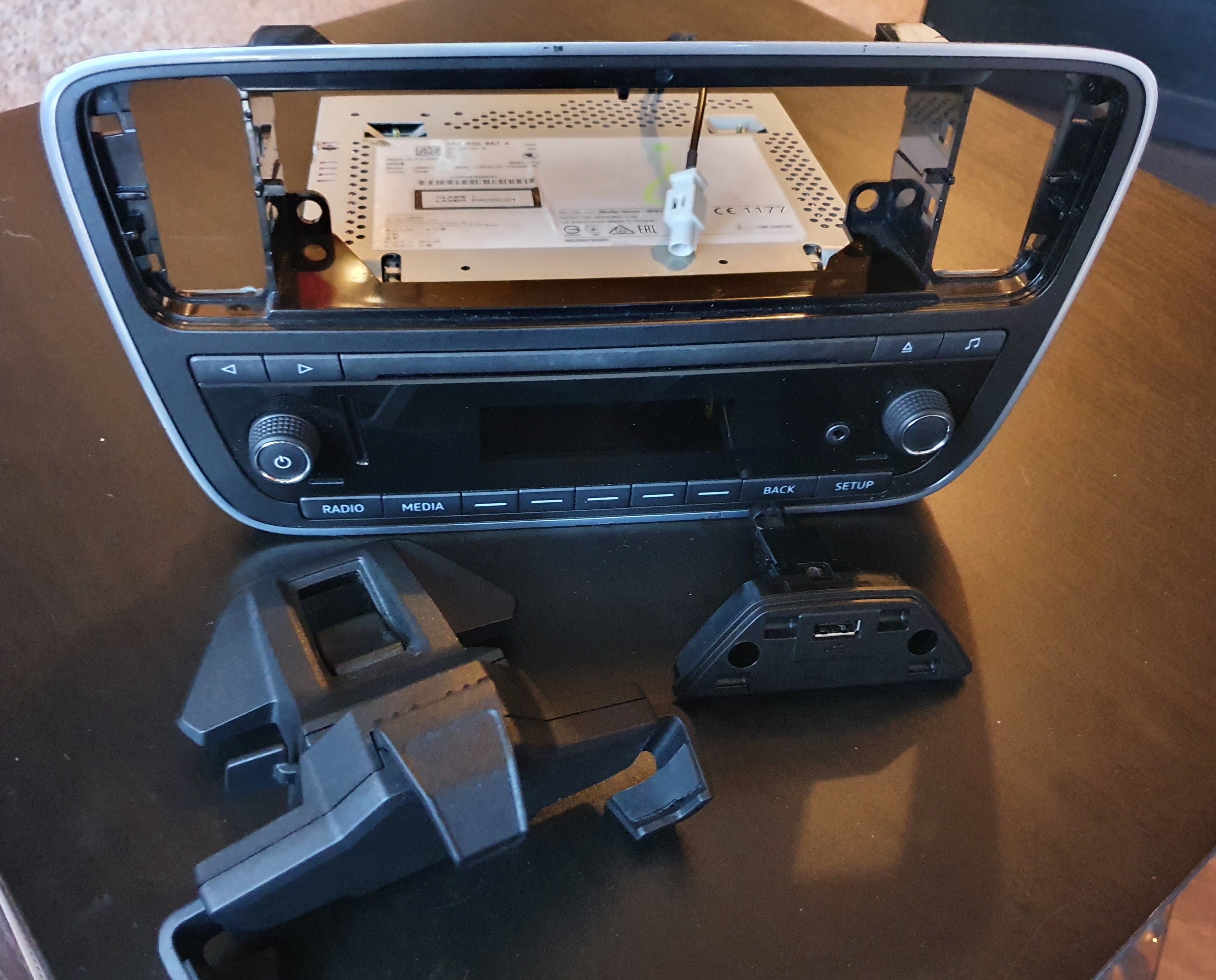

so... decided to go OEM way...
The OEM way.
It is a radio from newer Citigo and... it works!! Surprisingly, no code was required to lunch everything.
Bluetooth is working, music is playing... and it looks ok.
