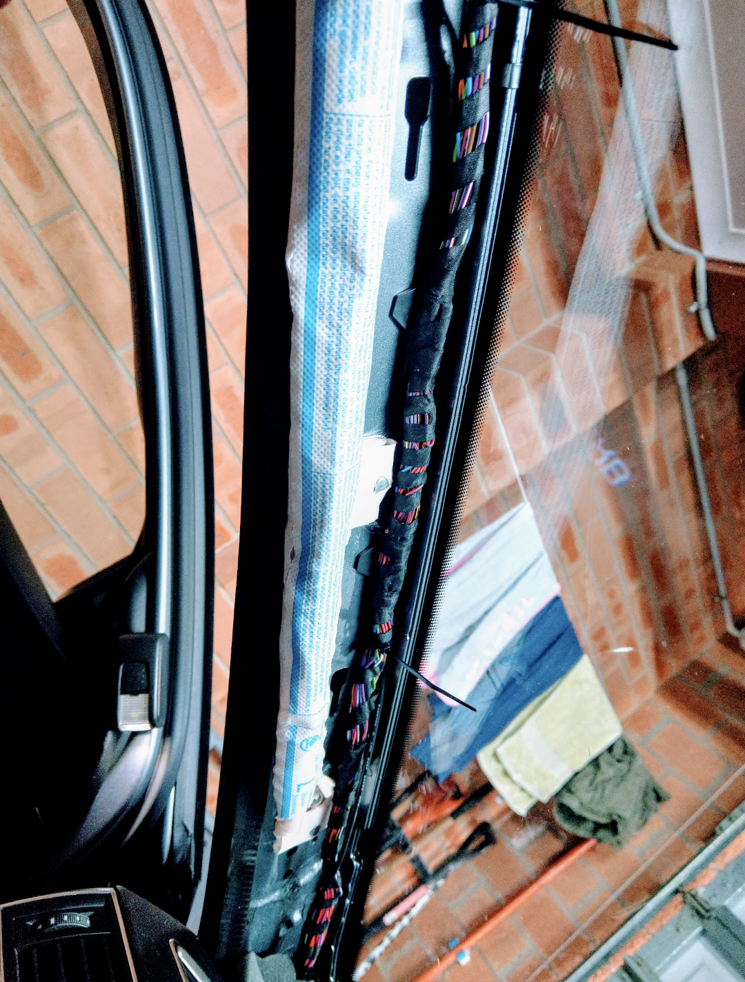

DO NOT run the wires by just tucking them into the A pillar! So many people make this mistake and I’m forever correcting it on cars I work on.
The reason being, there is a curtain airbag that runs above your head and down the A pillar, this is made to deploy in a set way, when you run the wires straight over the top of it you are preventing it from doing its job In an accident.
The A pillar trim is very easy to remove and you should run the wires behind the airbag then down the original loom and behind the dash this way.

100% this - make sure u remove the A-pillar trim and tuck the cable with the existing wiring loom behind the airbag, like my pic below.
The easy way is to tuck behind the A-pillar trim, but then the curtain airbag will fail to deploy properly.
Do it properly, even though it's more of an effort, and pain.
