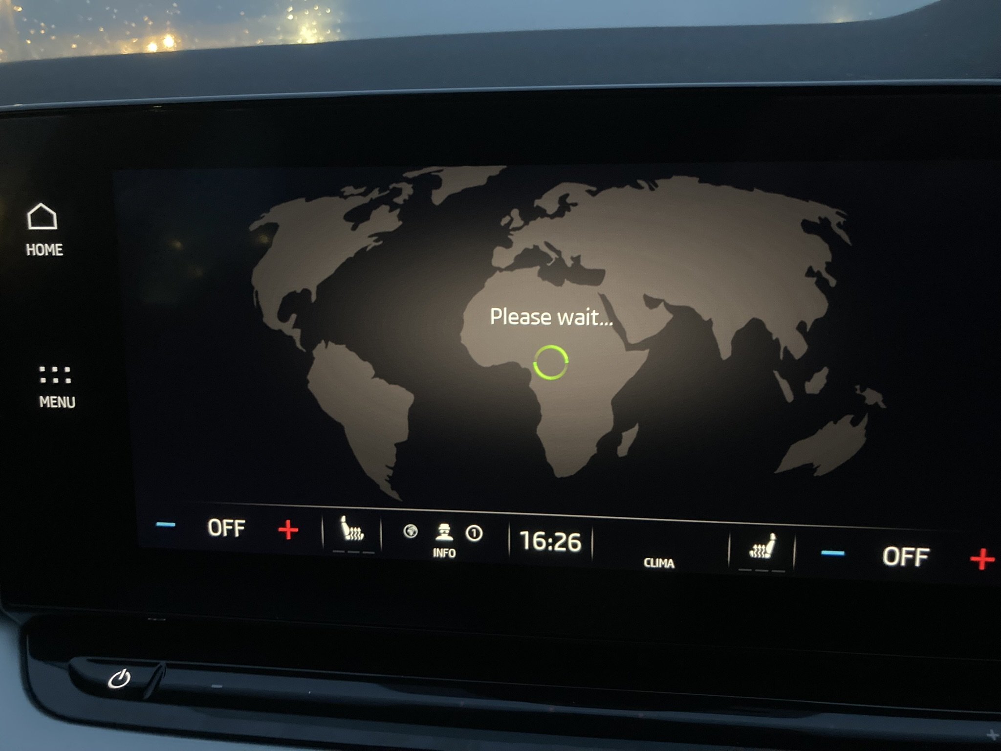

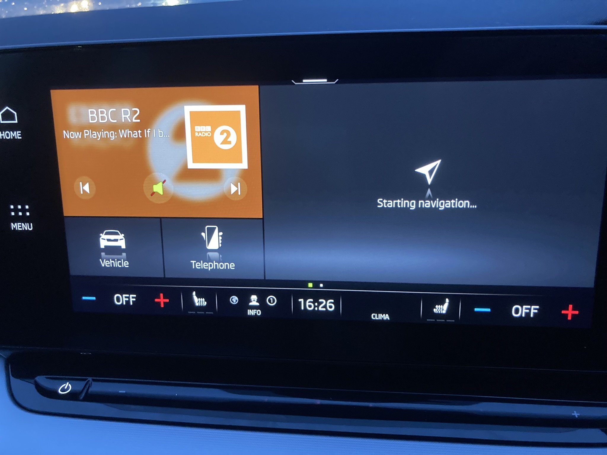

And ever since, the navigation just shows as "Please wait" and "Starting navigation" (see attached photos)

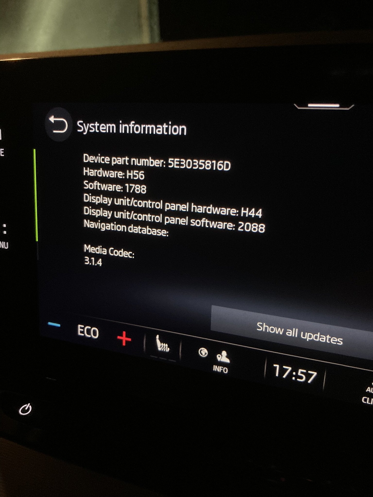

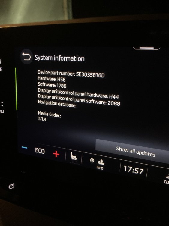

i notice on my photos (3rd one) the navigation database version is empty where I see on some other similar  photos shared by other contributors on this site, that there is some text there
almost seems to imply there are no maps but that said, the maps have worked been visible previously
Mine lost its database for no rhyme or reason, the garage tried updating it with no success, so had a new control unit which fixed it. All under warranty and done in a day, so no dramas!
