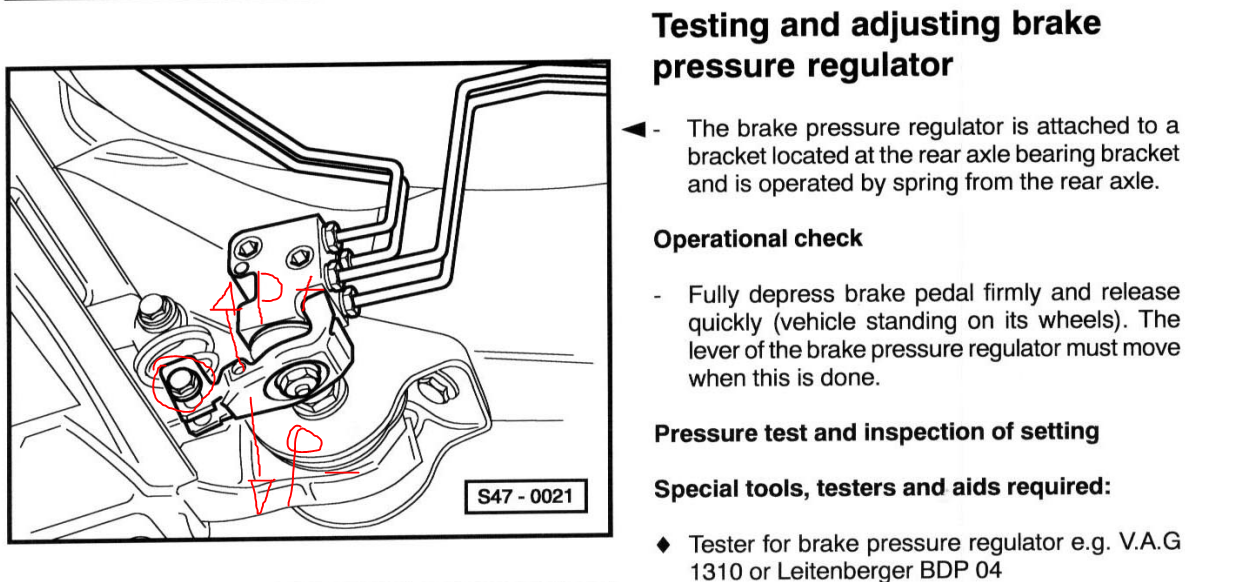

Searching thru the service manual I noticed the rear pressure regulator is adjustable.
So there in need for what we are talking.
Go ahead loosen the nut on the spring and move the attachment point upwards with the car laden.
And you are set.
Needs 2 persons inside a garage with the mechanic to know the procedure, if i ain't a Skoda guy i doubt if he take the responsibility to do it.
With the aftermarket pressure regulator things are much easier, after the install everything is on the driver, test and click till you find what's the best result.
