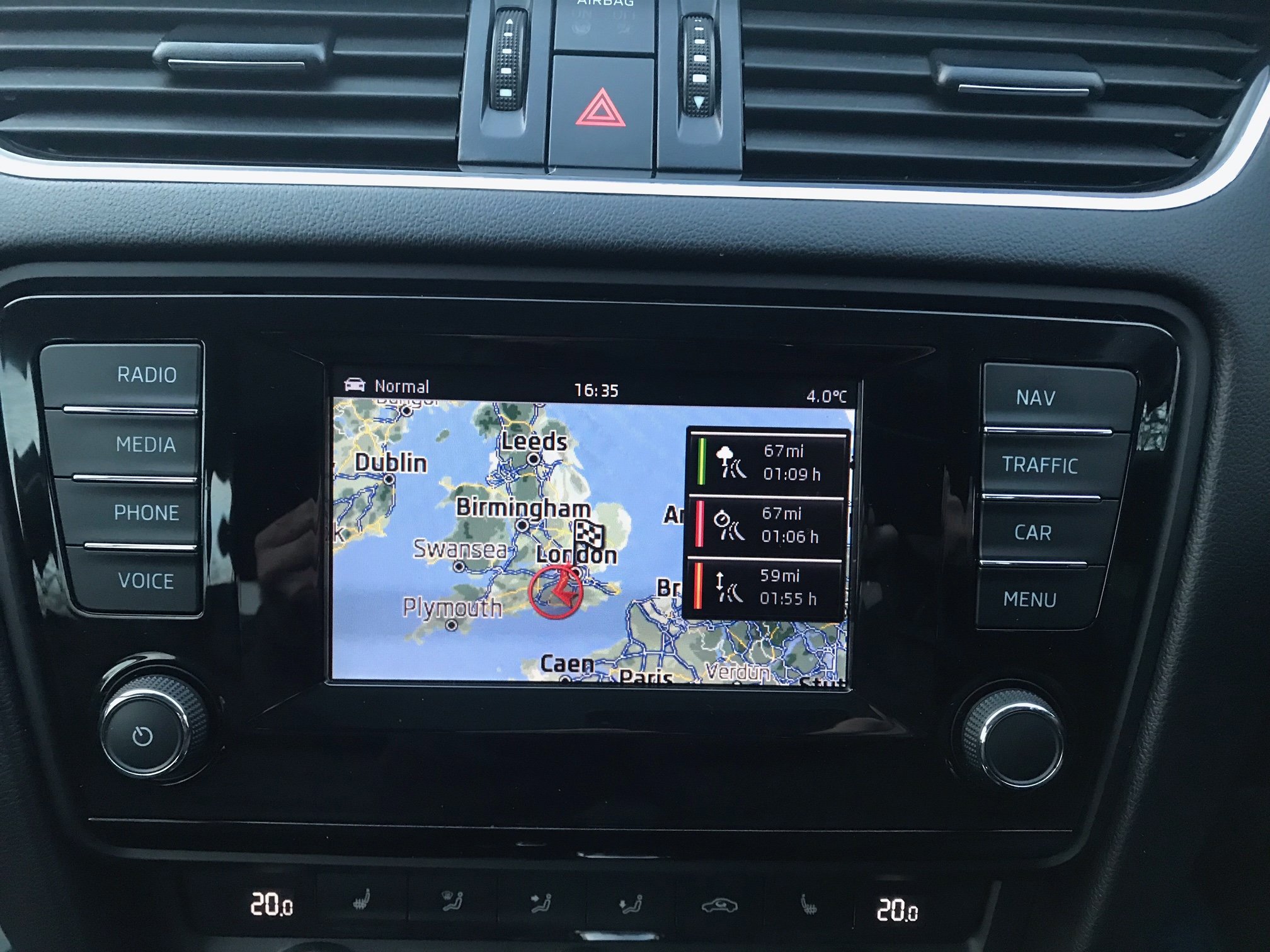

Yes ive spent ages browsing the forum on the topic... Ok Looking at it from the beginning and the basics i suppose  !!
Can anyone tell me what sort \ type of unit i have installed based on the pic..?

Looks like you have the Amundsen mib1 system. The mib platform has the headunit in the glovebox with a screen in the centre console. No you cannot just fit a bigger screen. You need mib2+ for that.
You have 3 main options:
1) Fit an android system of which there is a very good thread in this section detailing everything you should need and is by far the cheapest @£200-300. No coding required and should have most of the in car stuff but needs a bit if tinkering and Android knowledge.
2) Pioneer (or Kenwood?) system for best part of £1k. No coding and looks like it should offer a good solution but reports are that it's far too slow so isn't really an option.
3) retro fit mib2 system that will give you smartlink for Android auto/carplay. It's the most OEM option but a little fiddly. You need a new screen which is plug and play. You then need a new glovebox unit which will first require component protection removal (dealer should be able to do this for £60-80) then it will need coding nto match the car. @pab567 is your best option for the coding. Proper legend. Total cost for mib2 system starts at £600 probably with recent prices. £1k+ for a big screen setup with more bells and whistles.
Oh yeah, if you have a canton setup then you need a new bits of those too so add a few hundred for that.

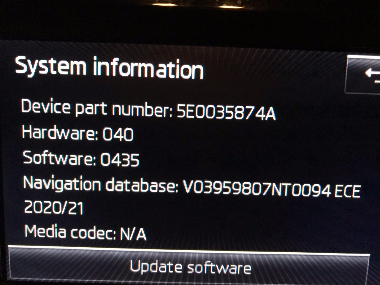

So been looking in to the NAV software update which is a faff but not hard its over 5 years out of date so well due an update which the vendors website gave me..
So im guessing there will also be a potential code update. But am still looking at a unit upgrade me thinks
Currently running..
DBINFO File
PartNumber1="8V0060866E "
PartNumber2="5G0919866AE"
PartNumber3="5E0051236  "
PartNumber4="5F0060884AD"
PartNumber="8V0060866E "
ApplicationSoftwareVersionNumber="0064"
SystemName=" ECE 2017    "
And it looks like the latest (available to me) is
DBINFO File
PartNumber1="8V0060866M "
PartNumber2="5G0919866BD"
PartNumber3="V03959807NT"
PartNumber4="5F0060884CJ"
PartNumber="8V0060866M "
ApplicationSoftwareVersionNumber="0094"
SystemName=" ECE 2020/21 "
Ok started to get my head around the unit now these are the latest running versions.

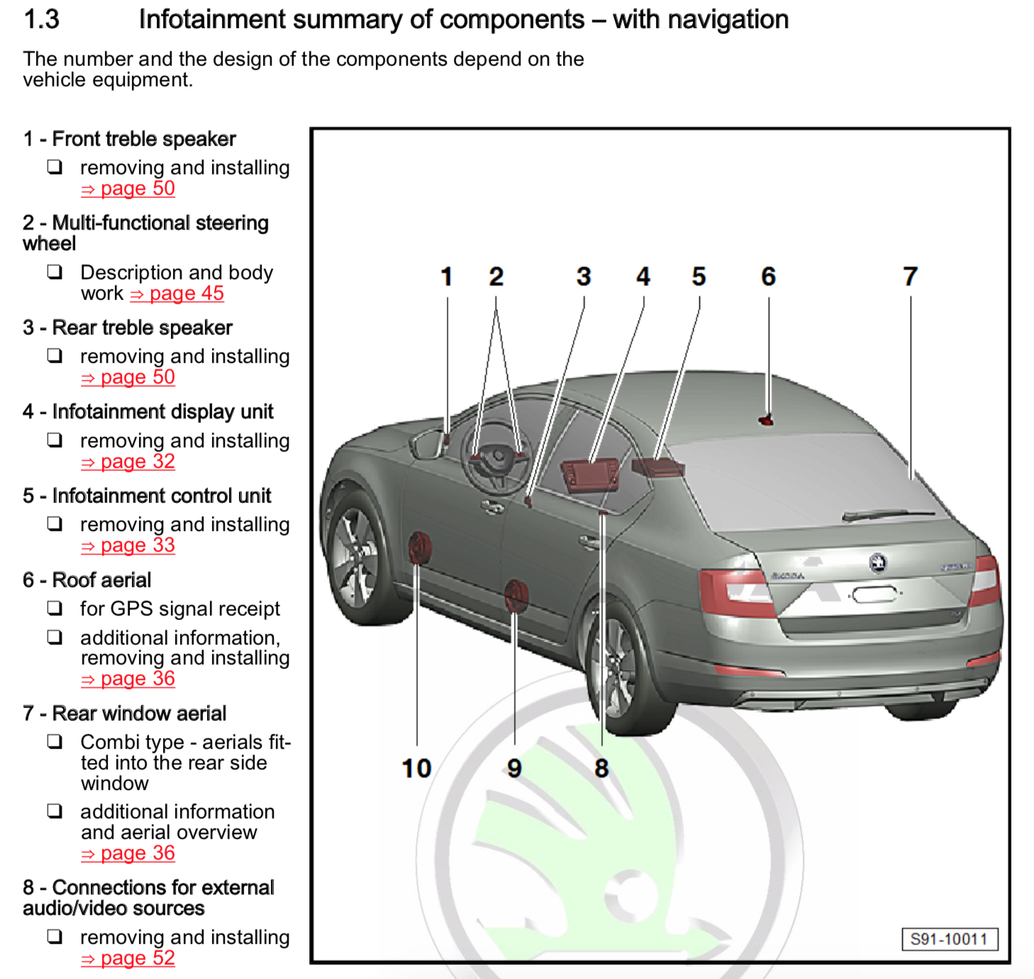

Where is the DAB aerial i cant see one anywhere,!!
There is a sharkfin on the roof but other posts on the forum indicate this is only for the purposes of FM and NAV.
I assume it would likely be better if replaced with the whiptail sort.
Kr
Paul
I think the aerial on the roof is only for the GPS. The radio aerial is in the rear window.

Looking at your other threads, you don't have an estate - the side glass is only used on the estate (or Combi as that image calls it). In the hatchback, it's just in the rear glass i think.
You can download appropriate owners manuals from Skoda's website, albeit that's not where the image above is from.

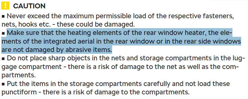

Downloaded the owners manual PDF associated to my VIN from Skoda.co.uk it has nothing like the above image and if i run a find in it for "Aeriel" there are no results returned.

As I said, that image isn't from the owners manual, it's from a workshop manual (or similar).
The closest reference you'll see in the owners manual is the warning in the cargo section not to damage the heating and aerial elements on the rear window.
If your DAB reception is particularly bad, it's possible a previous owner has damaged the aerial element on the window. I'm not sure if there is an easy way to connect an alternative standalone DAB aerial to replace it. A quick look on Google suggests the connection into the MIB unit for the DAB aerial is it's own separate connection, so it may be possible to retrofit your own replacement with a bit of research.

Hi,
I have a Amundsen MIB1, but I can't find DAB option anywhere!!!
Can it be possible that some mib1 don't have DAB reception?
About the touch I do not notice differences from start to after 20 minutes.
The most negative is the bluetooth phone call, having some receivers complaining about sound quality.
I looking for files to update the unit and check if there are some improvement.

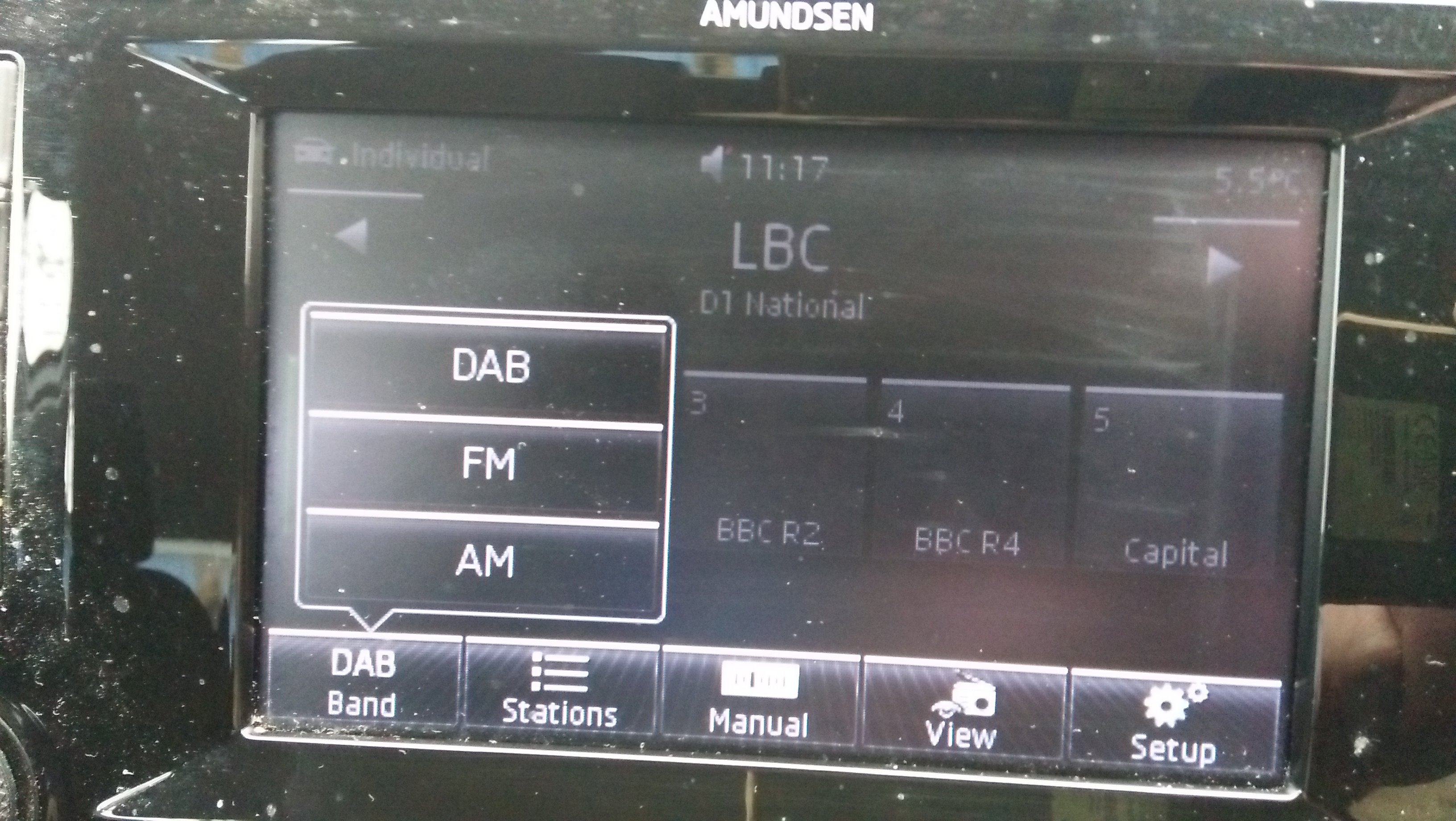

Mine has the DAB option and it had it before I updated the software. Bluetooth speaker quality is also ok.

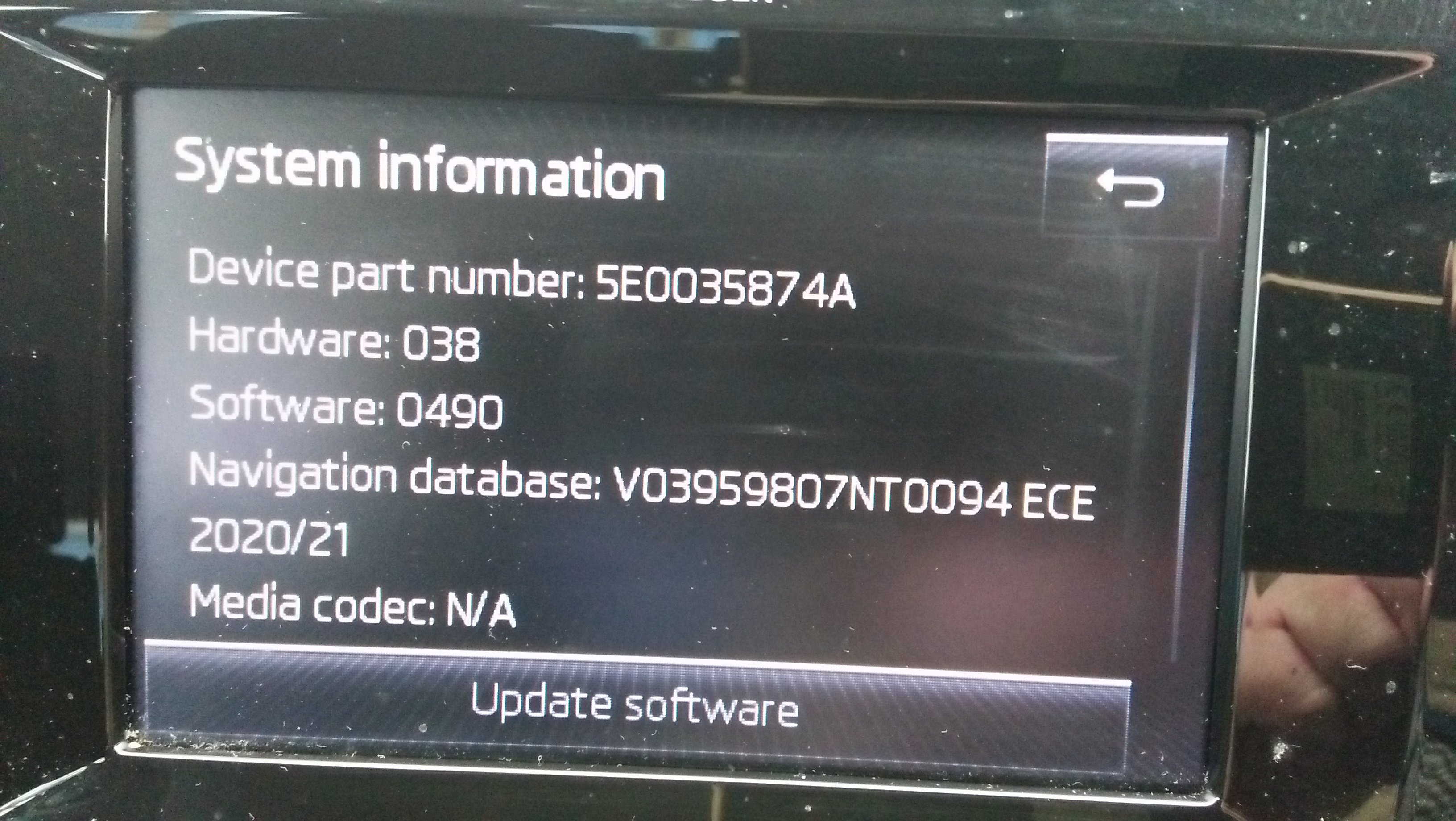

Hi ORDS,
is your unit hardware: 040 ?
Thanks
13 hours ago, JTORRES said:
Hi ORDS,
Thanks
This is my version and the DAB option
Hi ORDS,
Thanks for your share.
After some search I found a post that clarifies why my unit doesn't have DAB.
My device number ends with 64A (no DAB☹️) and your with 74A (with dab).
