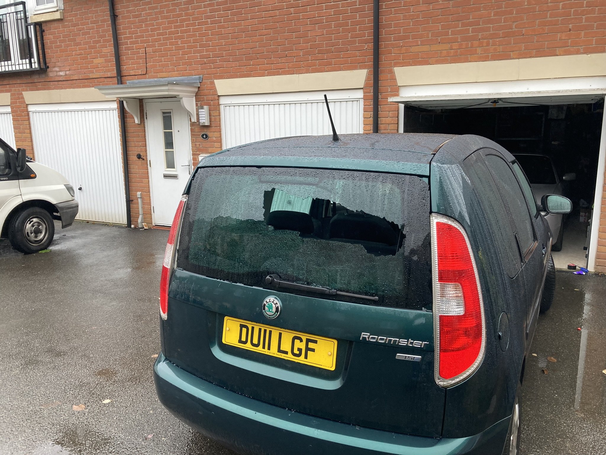

Smashing start to Boxing Day
Looks like the rear window smashed all on its own, accordingg to Autoglass, they have fitted 150 rear windows to Roomster's in the last 6 months, given that the Roomster has relatively low numbers this suggests that this is a relatively common problem?
Edited by ChrisTids
The damaged section at the top right and also towards the left at the top edge (that might be a trick of the photo) lead me to question their diagnosis, toughened glass does not break in two or more places at the same time; its very strong in the centre but exposed edges can be broken easily.
If it happened where the photo is taken I would suspect attempted forced entry, are there any scratches or chips to the paintwork beside where the piece is missing at the top right, witness marks from a tool?
Or is it shattered across the whole screen and bits outside of the sealant line have simply fallen out? Its difficult to see with the rain drops & my eyesight.
Edited by J.R.
Did the glass implode inwards or outwards? If inwards the glass may have had a blow. Did the alarm sound?
Most of the glass ended up outside of the car, nothing triggered the security camera overnight and the alarm didn’t go off.
