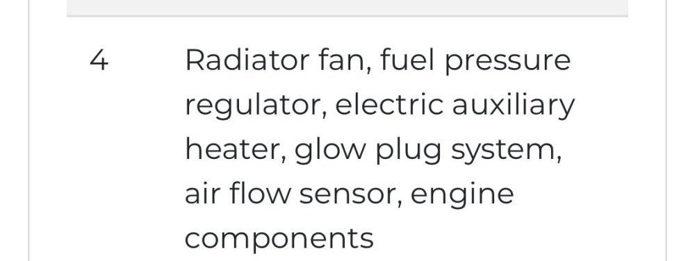

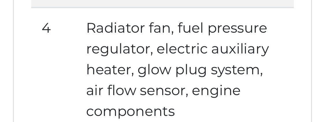

Is this a 30 or 20 Amp fuse? If so it appears to be related to the ABS module, at first glance? What if anything can your owners manual tell you about this fuse?
Edited by Wino
Oil is an insulator, I doubt that it would be creating a short and blowing a fuse. A lot of gate automation motors run in an oil bath.
Other than the oil level/temperature sensor there is not a lot beneath the sump mating faces.
It’s actually a 10a. This is the fuse that keeps blowing.

Agree with this, but it could be that "engine components" in the above list includes the level/temp sensor.  Probably a coincidence that there is an oil leak and this fuse blowing though.

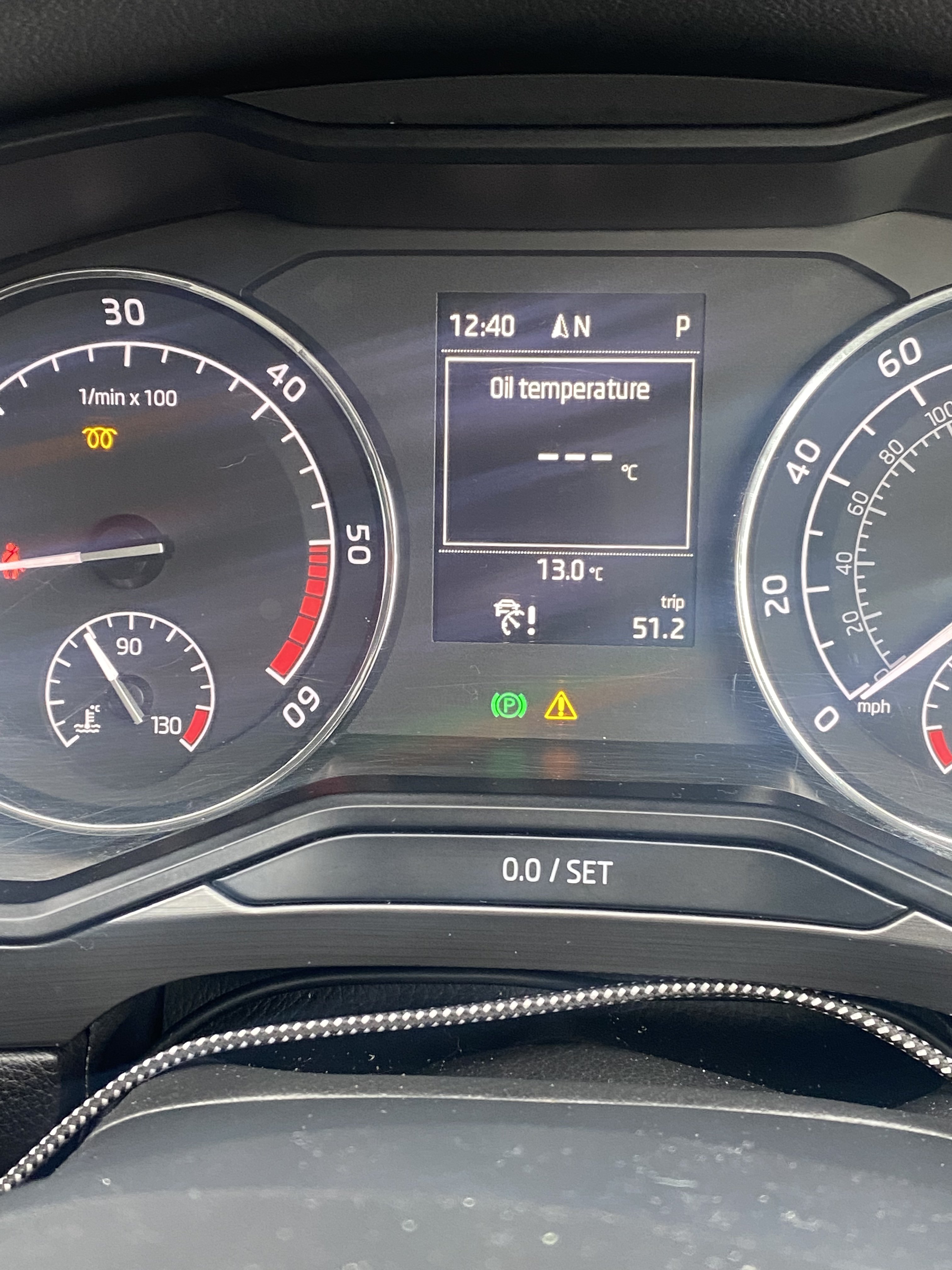

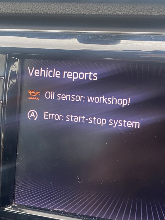

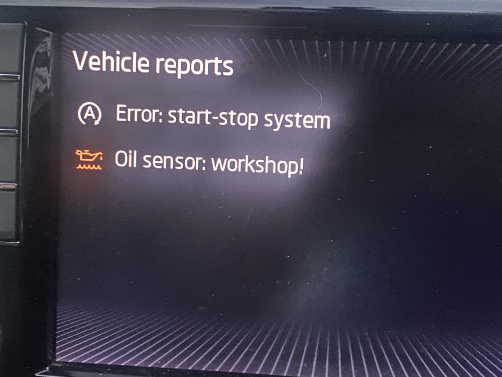

Initially changing the fuse solved it. Then it became intermittent. Then an elec guy cleaned that sensor and it was fine.

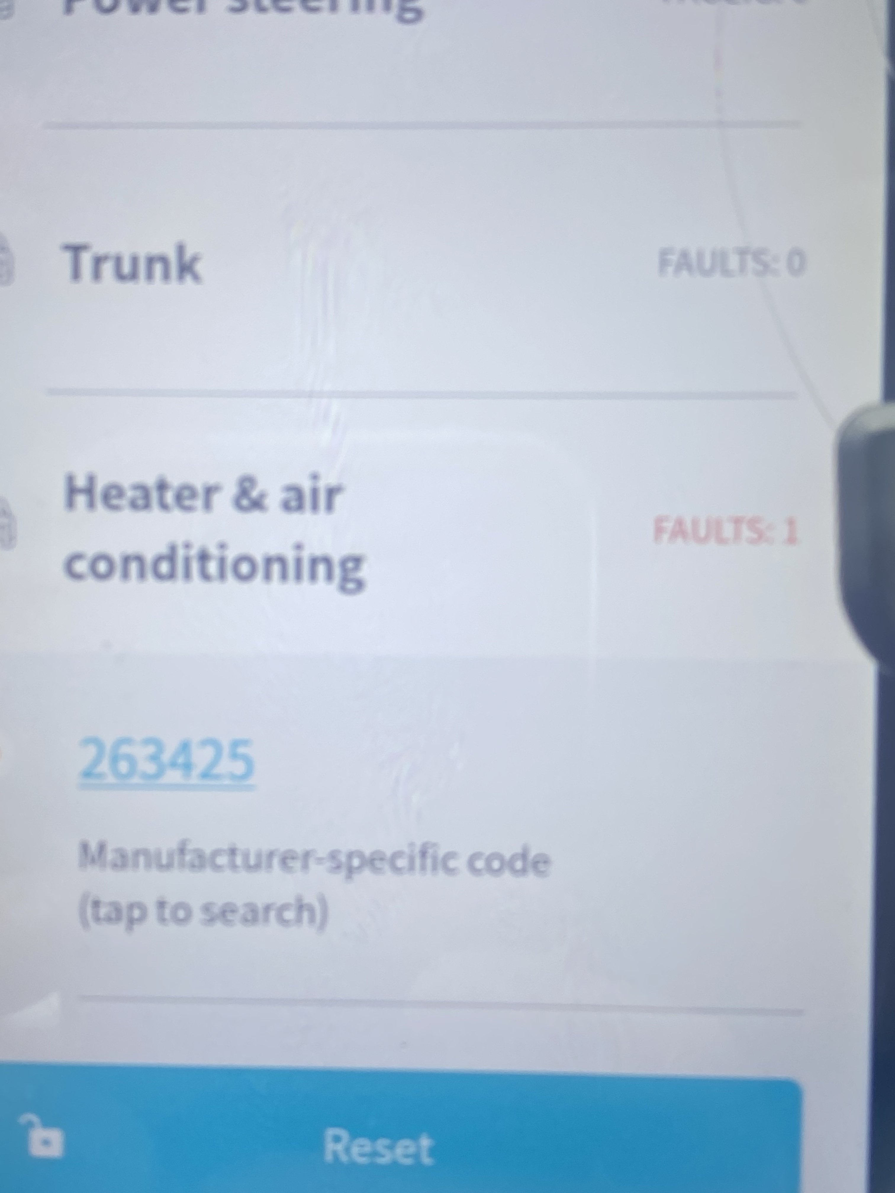

Oh, I must add that my heater is not fully functioning. Only warm on high power, and no heat drivers side.

The oil sensor connector may have been damaged so that it doesn't seal properly when mated to the sensor. Try pulling it off (gently) without disengaging the latch, and see if it just pulls off.
Although oil itself is a good electrical insulator, engine oil loaded with contaminants like soot and moisture may be quite a good conductor, I guess.

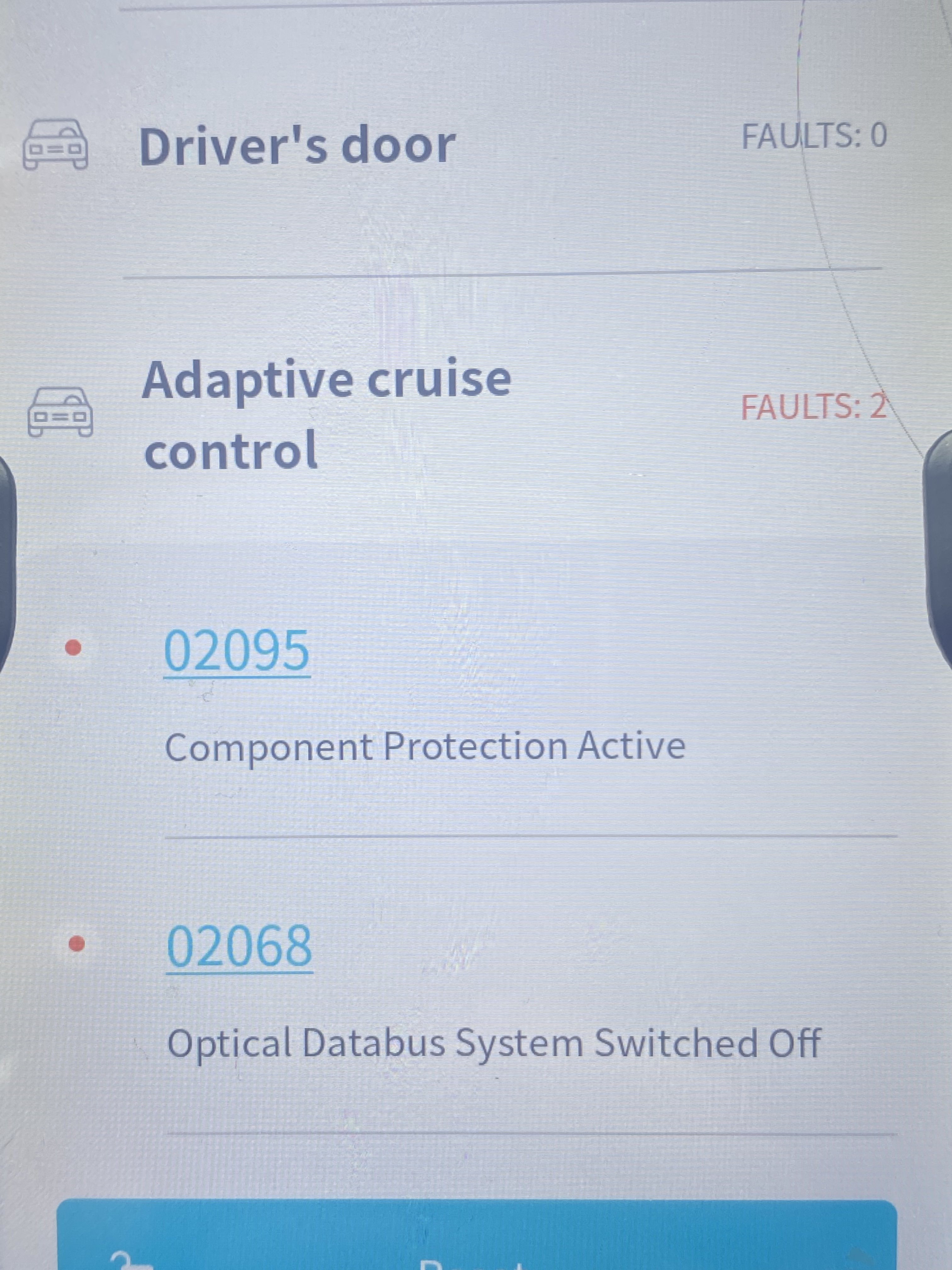

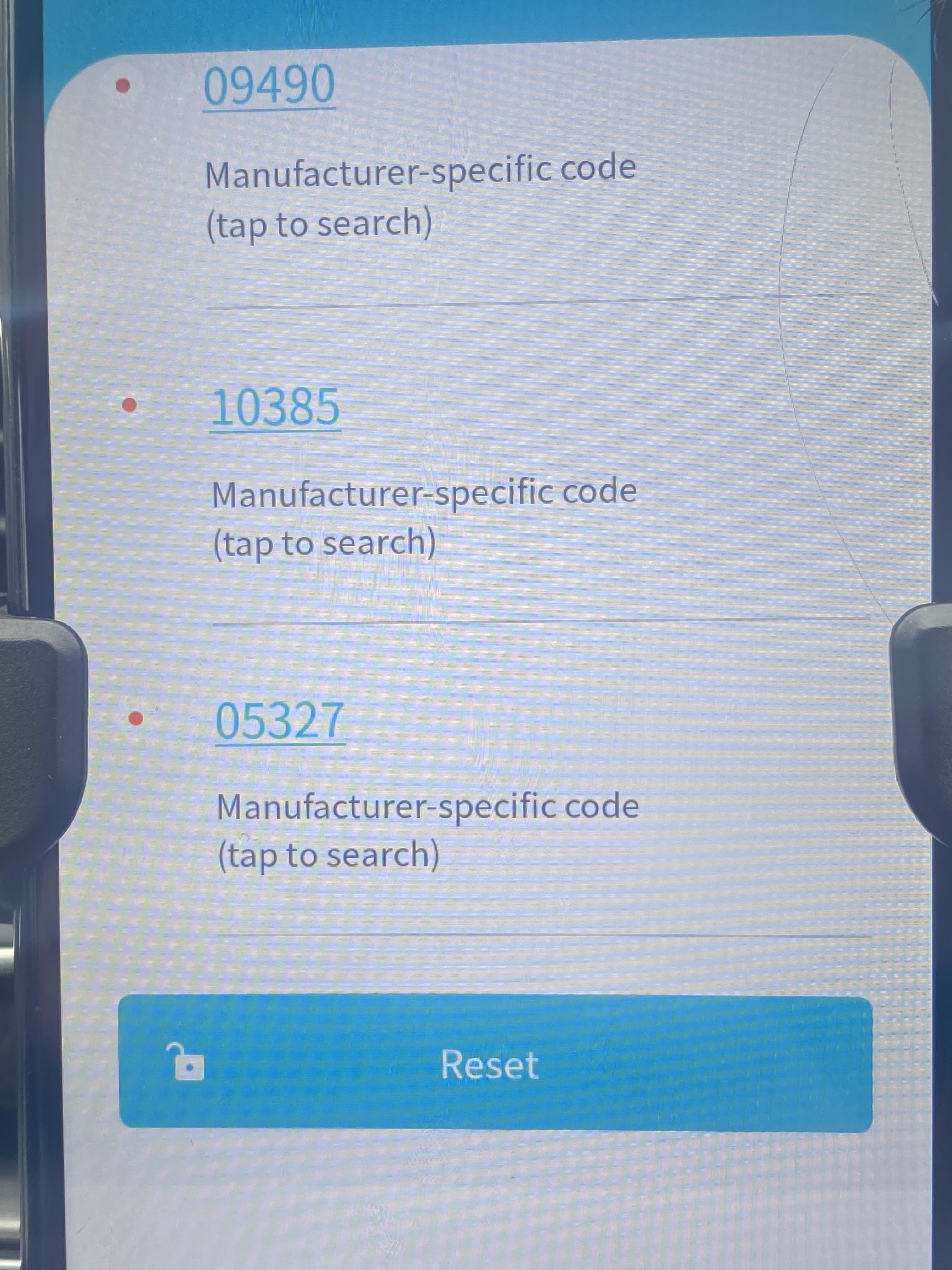

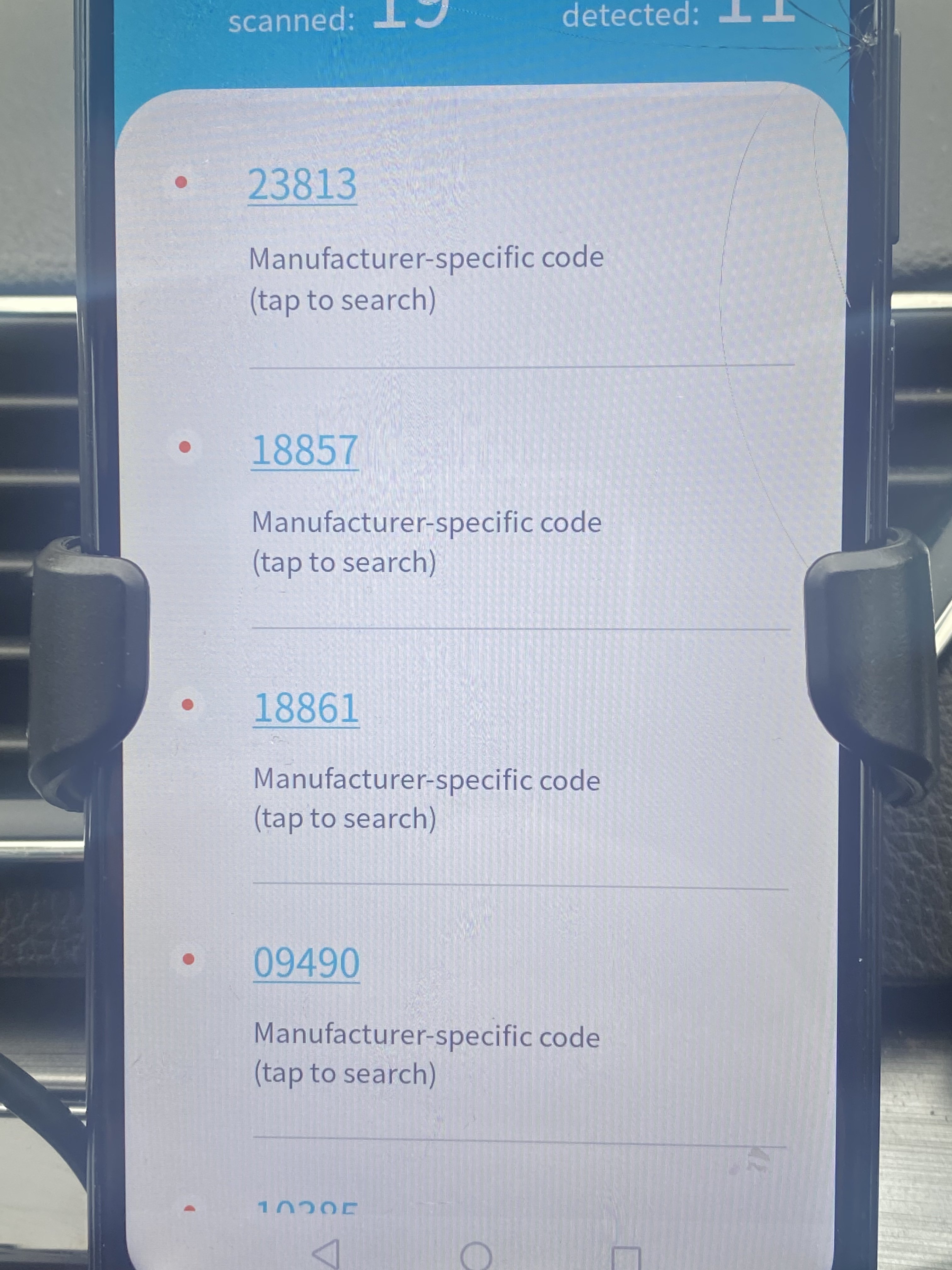

Bear with me guys. I’ve just been under and took a decent video. I’ll upload it to YouTube and post the link asap.
Her you go. I’m cleaned up the oil level sensor connection, changed the fuse, and then the car was fine again for 2 mins. Funny coincidence though, it was where I was turning right at the same point as a previous attempt, that the fuse blew again!

Just uploaded some vids
