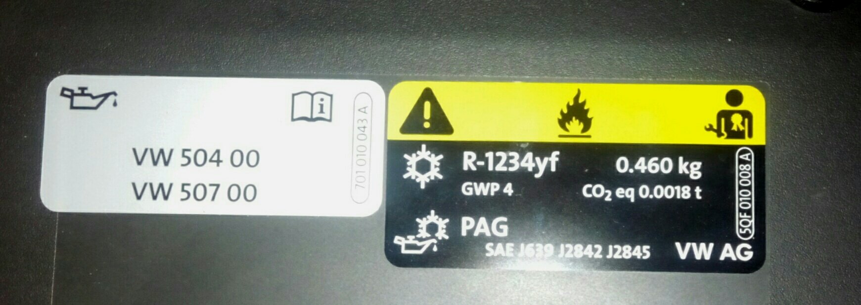

My engine has a factory applied sticker on the slam panel
Bearing in mind that 508.00 is not backward compatible and the numerous warnings I've seen that it should not be used on engines that are not designed and specified to use it and the possibility of damage, I personally would stick to 504.00 on any car prior to MY19 unless there was some definite proof (e.g. a sticker as above) that it was ok to use 508.00
Also bear in mind that engines evolve and a MY19+ 1.0tsi engine may have had modifications that allow 508.00 use that the earlier version did not have. Changes will be more than just sticking on a PPF.
