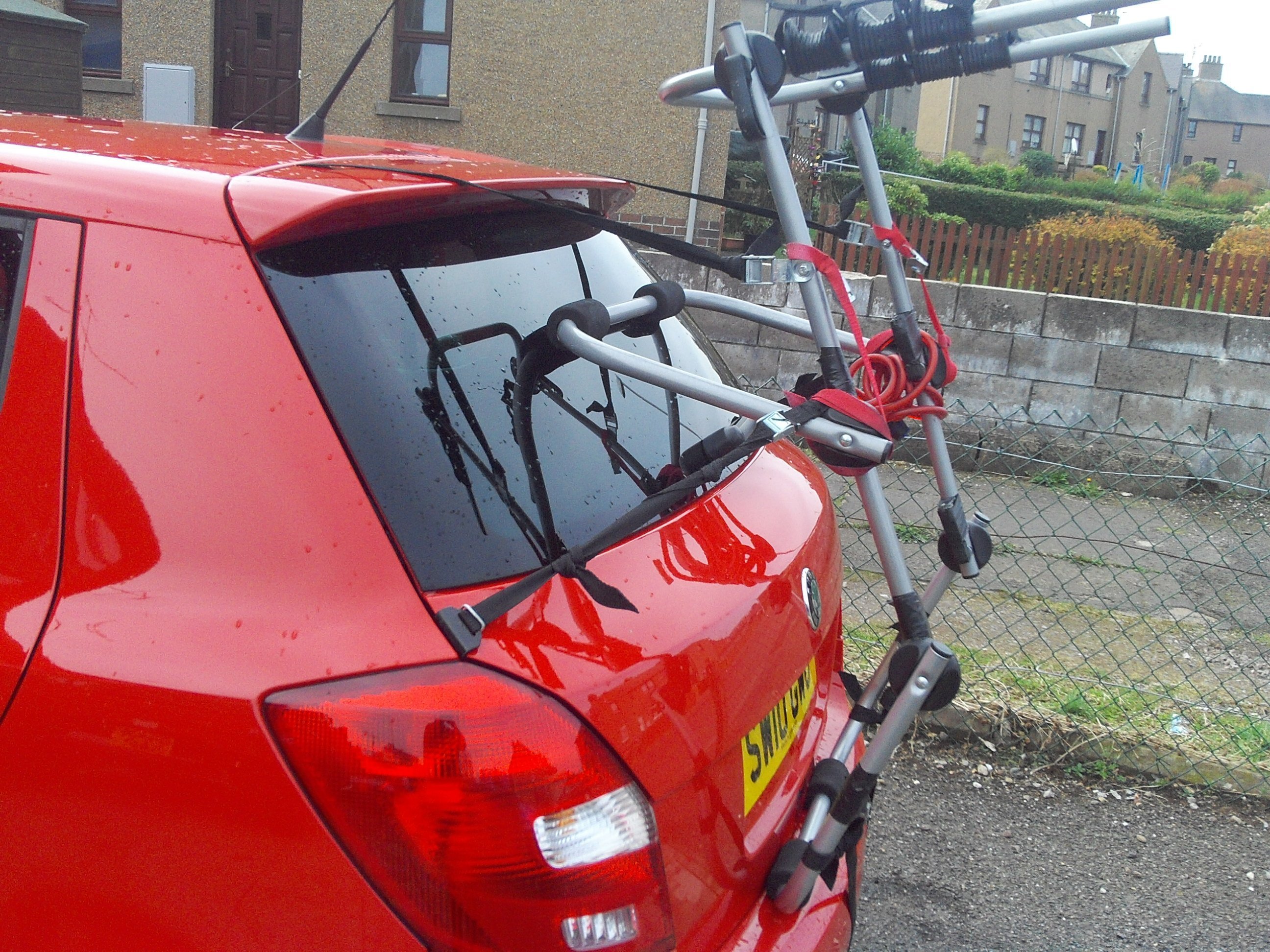

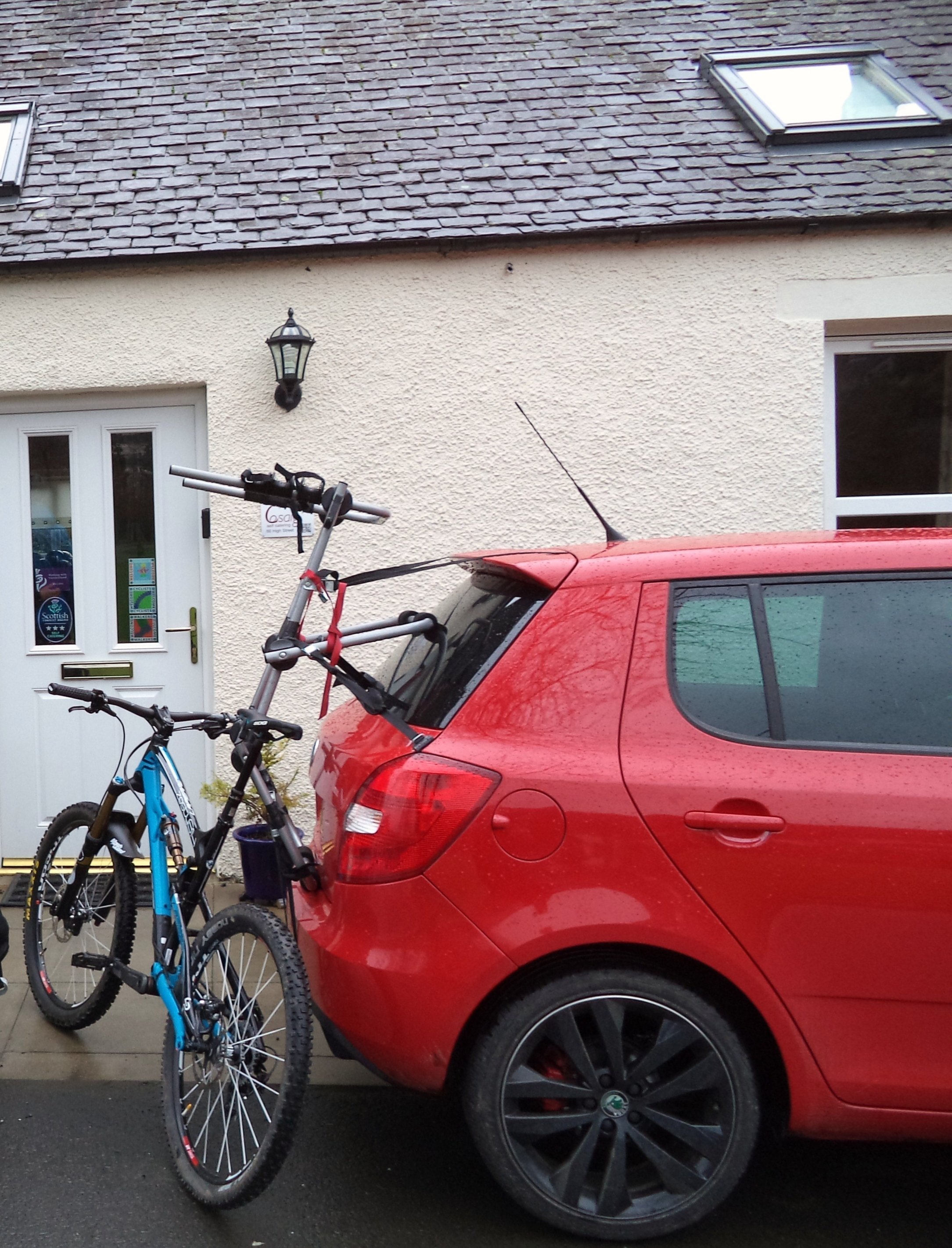

Rear carriers can be ugly and you need the bike high enough to not obscure the rear lights and reg plate. Unless using a trailer board which you need to get wiring for.
Then consider the spoiler and the fitment and you maybe need to disable the rear wiper.
You could get neater than this.

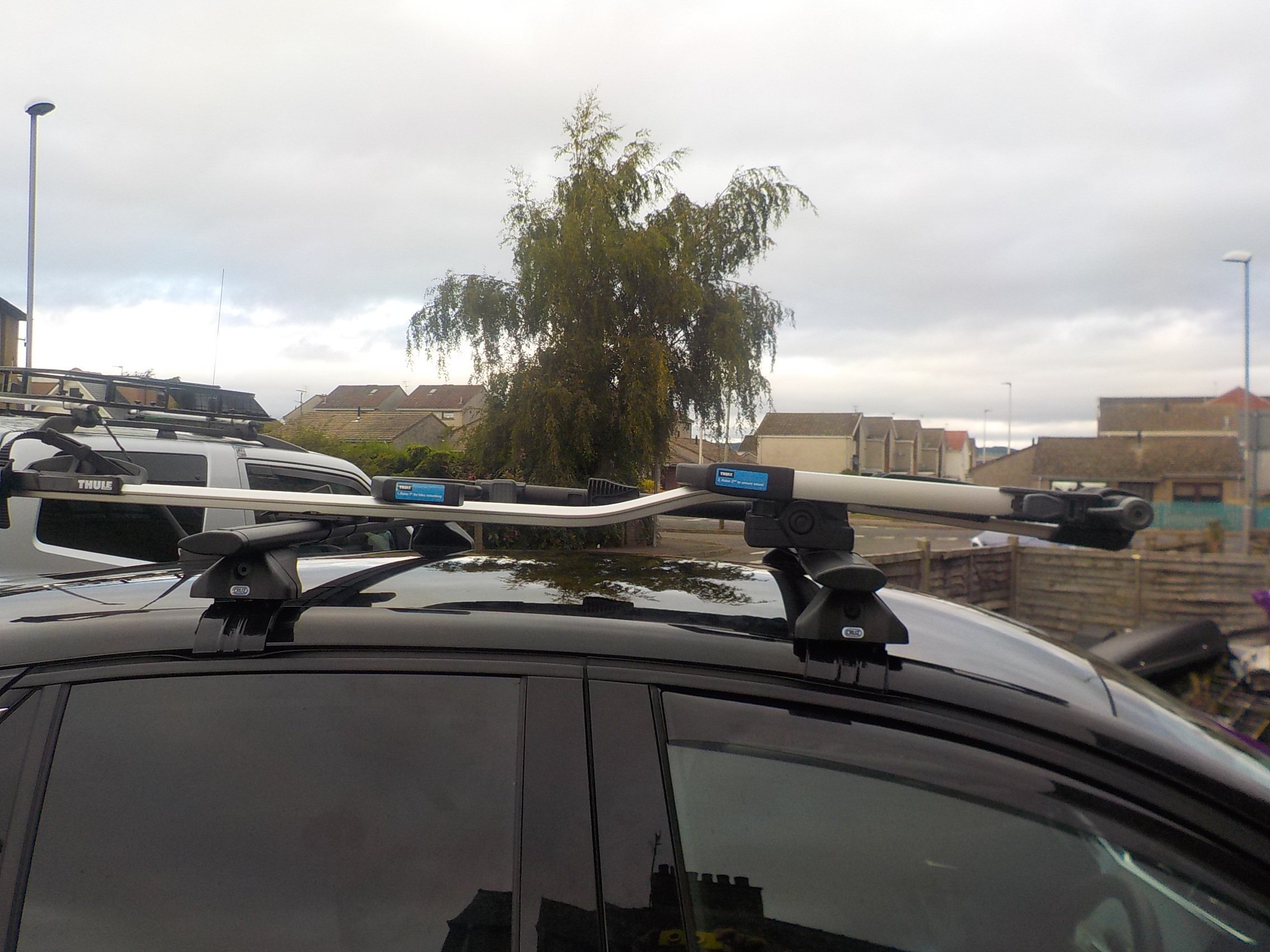

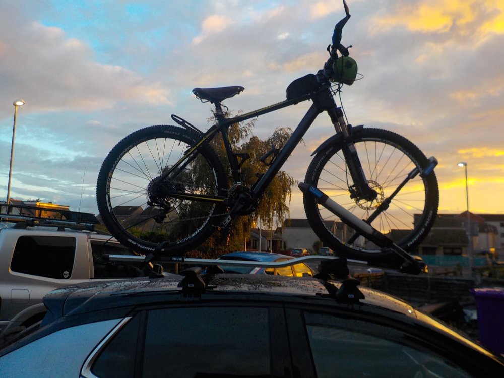

Thule to a good platform one now.
'Thule Outway Platform.  '
Bike is too wide on the back of a Fabia with both wheels on.

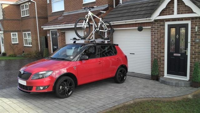

The roof mount looks like the best option. My bike is pretty long.
I just really don't like that the roof bars have those extra metal straps that wrap around the roof into the top of the door closure.

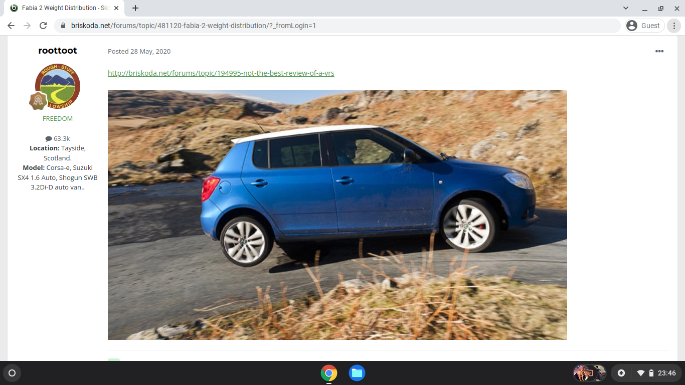

@roottoot The ballast on the pic of the blue car... will a vRS have them? any idea what the purpose is?
The Blue car is a vRS.  The weights might be off your car already if the previous owners removed them.

Roof Bars.
They do not scratch the paint.  You have rubber under them, or if it comes without cut rubber from an inner tube or put helicopter tape under.
The fitting is a hole  in your door jam and a pin on the roof bar fitting that fits in it.  then the bar tensions down.
Plenty threads on here on the subject.  Including ones where people bought the wrong fitting kit if you use the search function.
