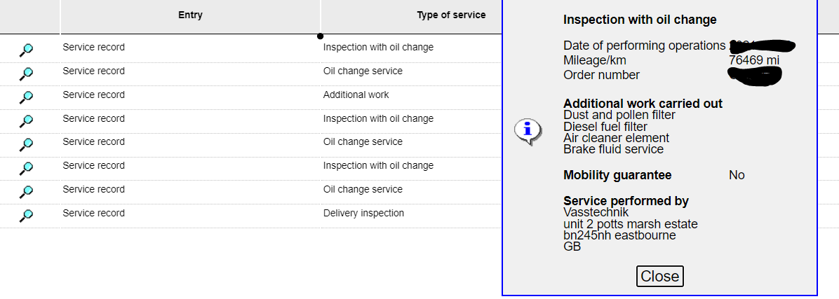

erWin will state the type of service as well as additional items such as DSG Service, Haldex, Spark plugs and cabin filter. They can also add custom notes if need be, for example I done a DSG service + clutch pack recently so updated the online service history to state this.

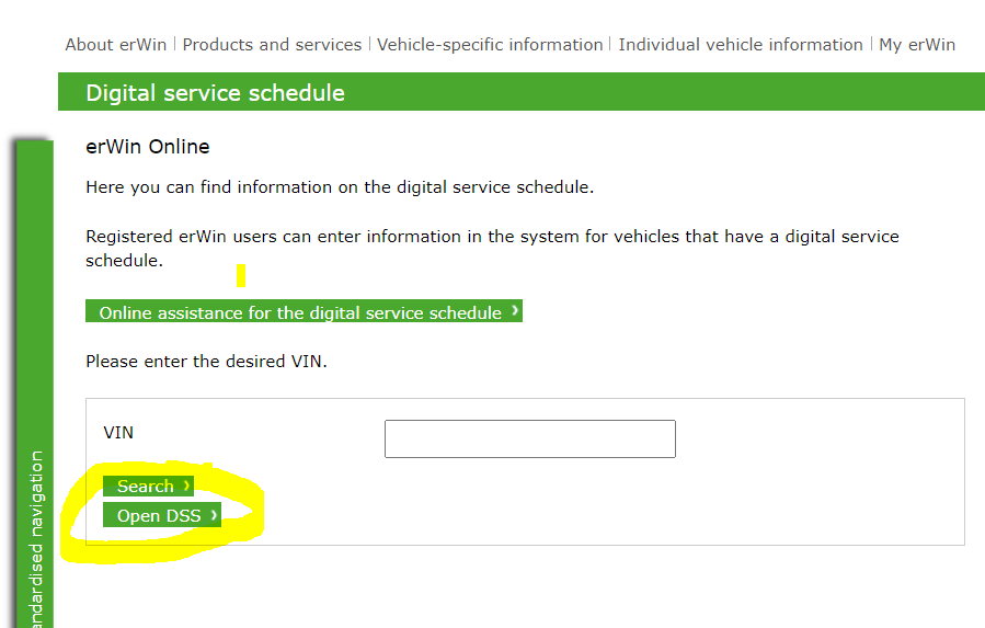

When you login, click products and services, and select Digital Service Schedule. then you get this page, put in the VIN and then click
Open DSS as highlighted below, this will pop up a new window and the use the magnifying glass on the left to see what has been done
Edited by paulski
Thanks for that screenshot - it prompted me to check my access again to verify that I absolutely do not have the option, as I remember looking before - I was right, completely missing the option. Changed my registration from individual to company though and it is now present.
Thank you all for the comments.
With your guidance I've managed to access the DSS page in erwin.
