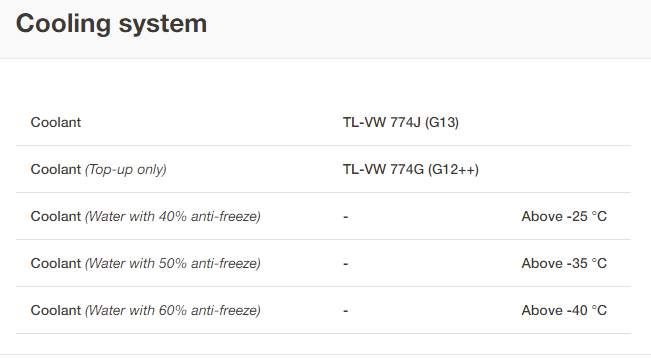

am i right in thinking that (g13) is the correct antifreeze for my car?
or is it (g12+) ?
problem is i just looked at the header tank on my car and it looks like a (watered down pink) and the one that on line sites are recommending are (purple)?
which one is correct?
cheers kev
or is it (g12+) ?
cheers kev
I only lost about a cup of coolant when changed the stat. In any case I have a bottle of the appropriate g12/g13 pink stuff whatever is compatible.
Hopefully someone will be along shortly to confirm. You can top up with water also as the coolant is mixed with water when replaced ie when you have a cambelt/water pump change .
only had cam belt water pump and tensioners + antifreeze done a couple of weeks ago.
it gives you so many choses in colour so i had a look under the bonnet and its like a watered down pink so i didn't want to go and get yellow or what ever and its not compatible!
cheers kev

i have not long had the cam belt and water pump done and the garage put some fresh antifreeze in then, problem is the antifreeze that the garage has put in his pink and when going on line to order a gallon of it they are all saying ( yellow or violet ) all i know is it is supposed to be ( G13/G12+) ?
cheers kev
