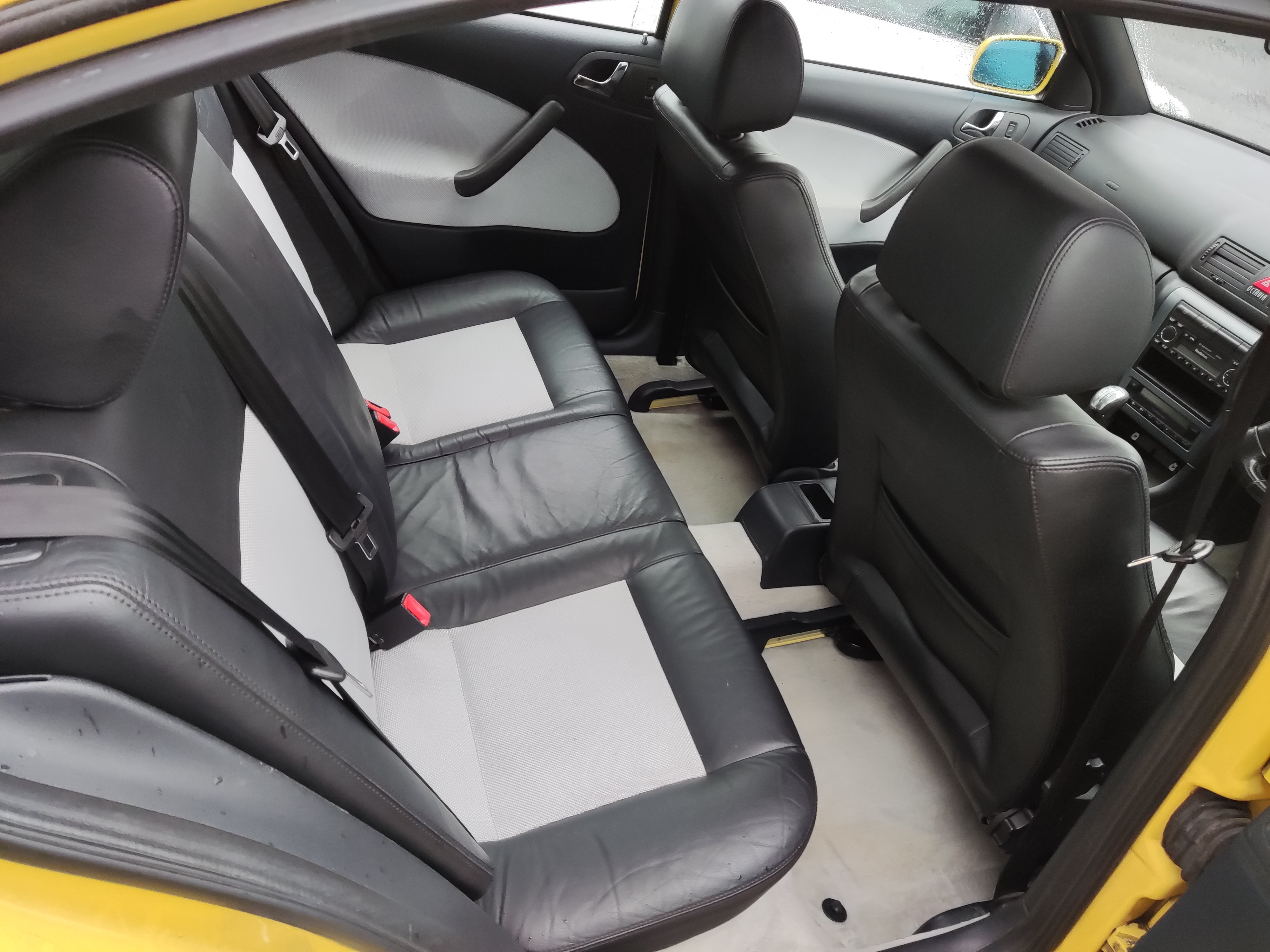

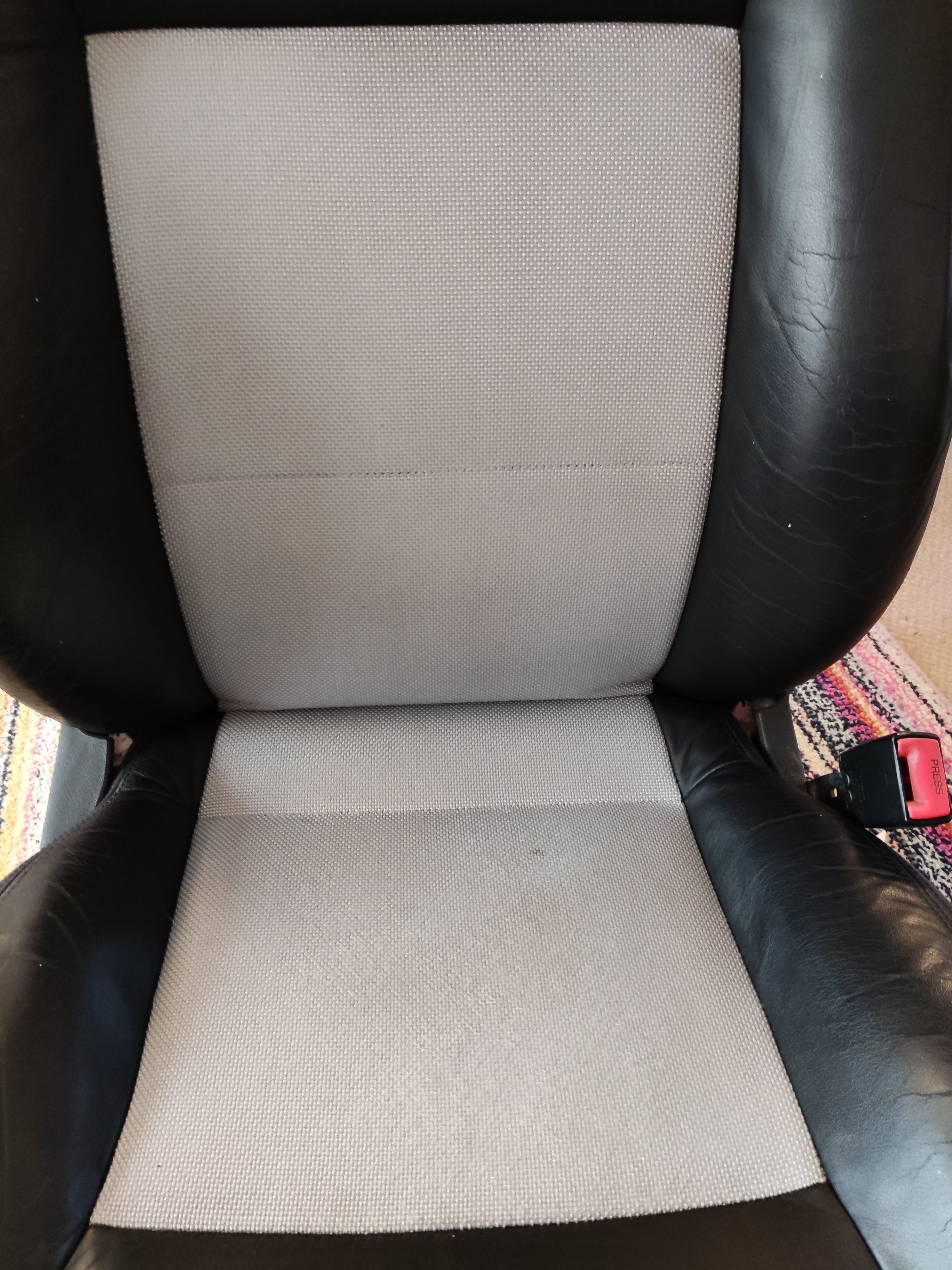

    Saturday afternoon update, I've clean the seats. The driver's being the worst now looks like something you'd consider sitting on.

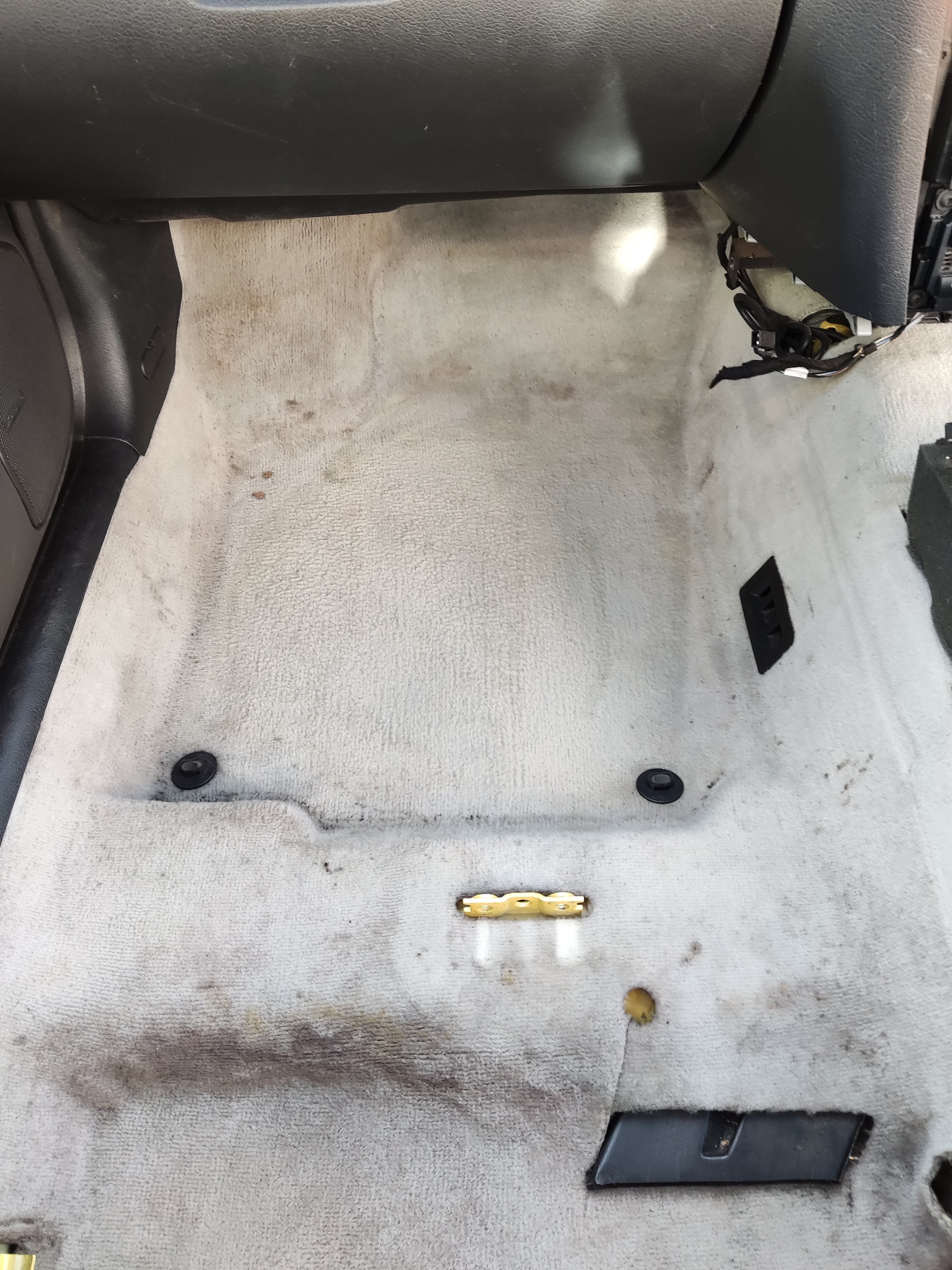

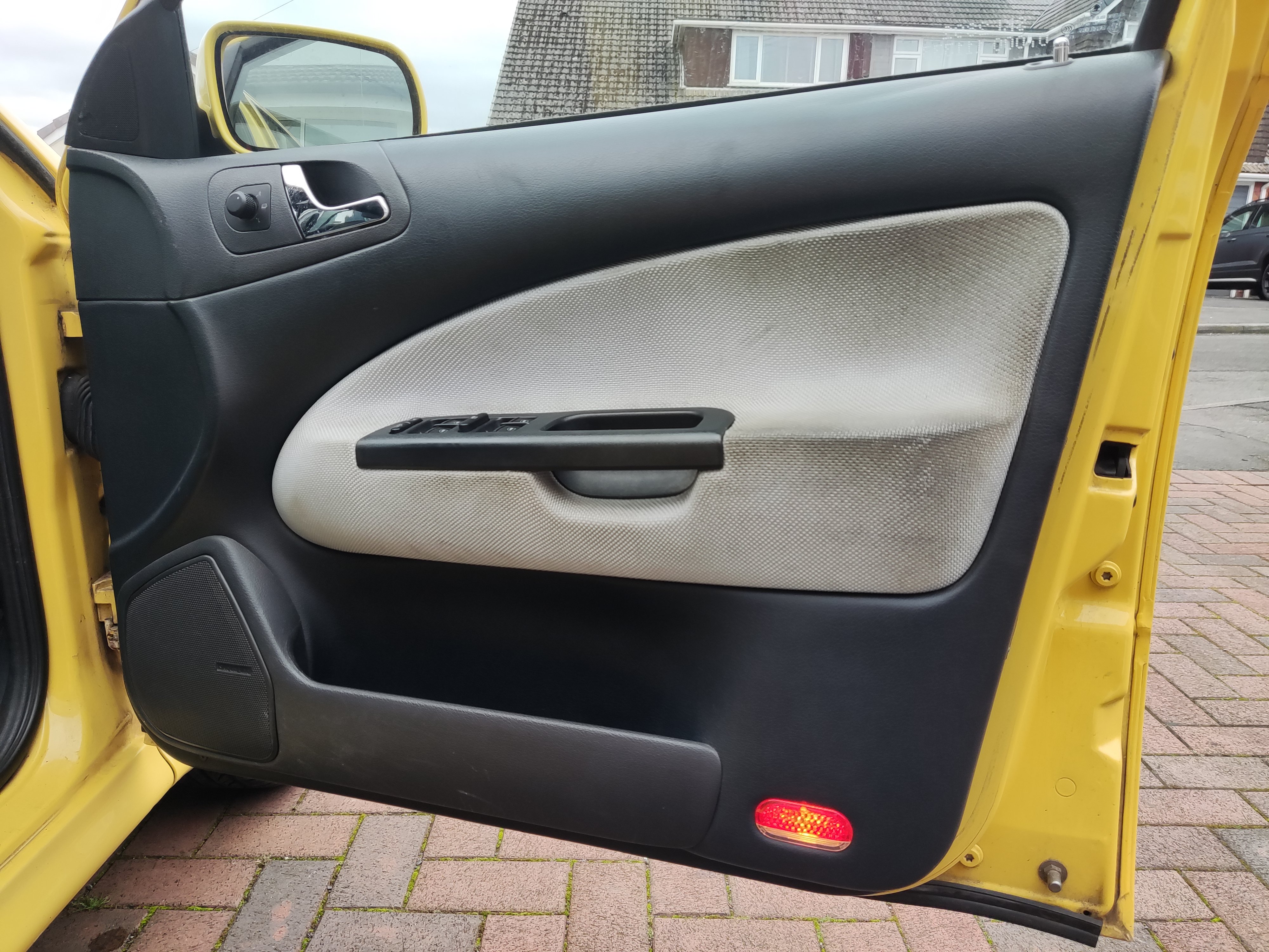

Hi Mike, to be honest it's quite dirty inside and the paint is dull on the outside.   I've ordered a bissell spot clean pro and a brush for my drill so I can do a good job of cleaning the interior.   I started cleaning it inside today but it's hard work without the right tools

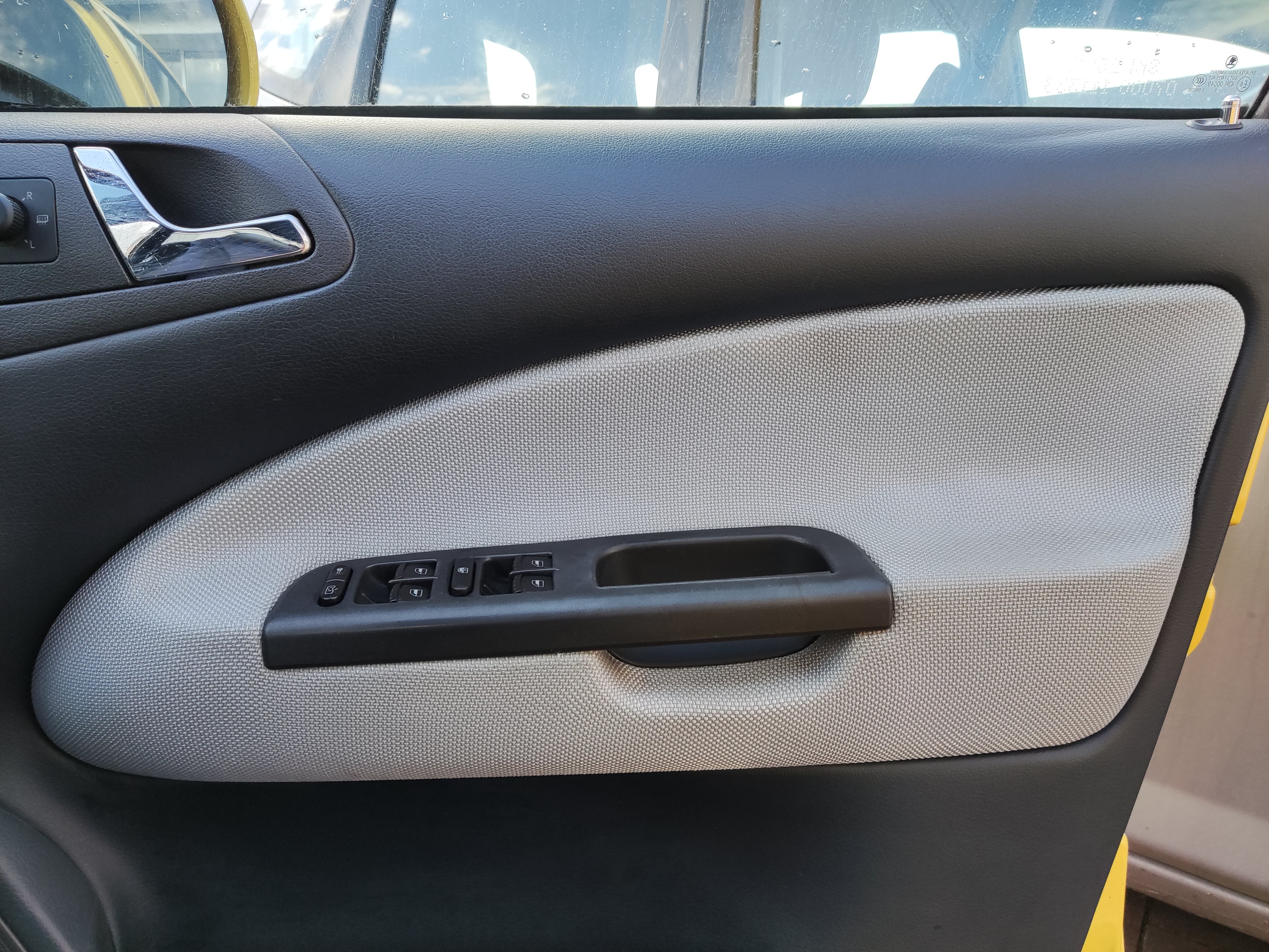

The driver's door card cleaned up nicely
I could do with tackling my door cards as that's a massive improvement.
Which brush did you use on the drill?
I only ordered the drill brush night, I used some random household cleaning brush I found knocking around the kitchen. I used autosmart g101 in a spray bottle and scrubbed it, then used a towel. I took all the seats and center console out this morning ready to clean the carpet next weekend after the drill brush and bissell extractor are delivered

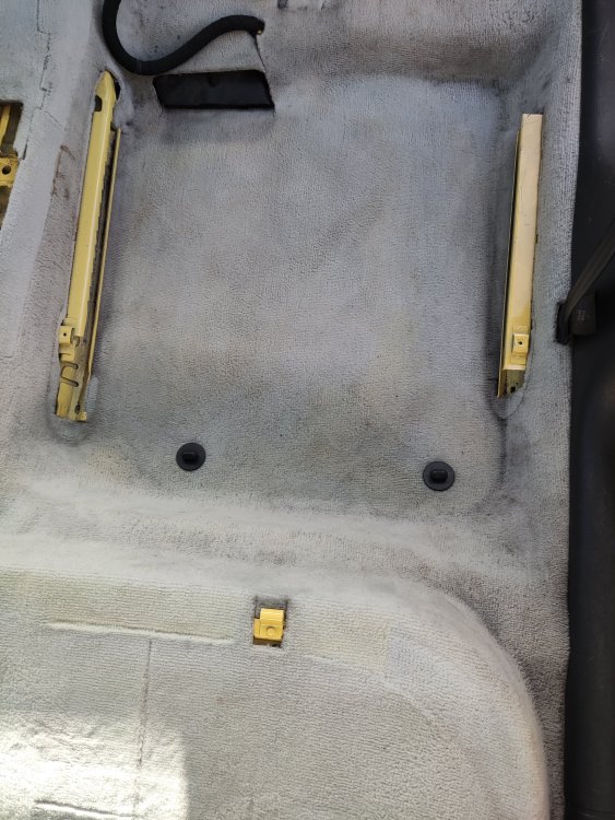

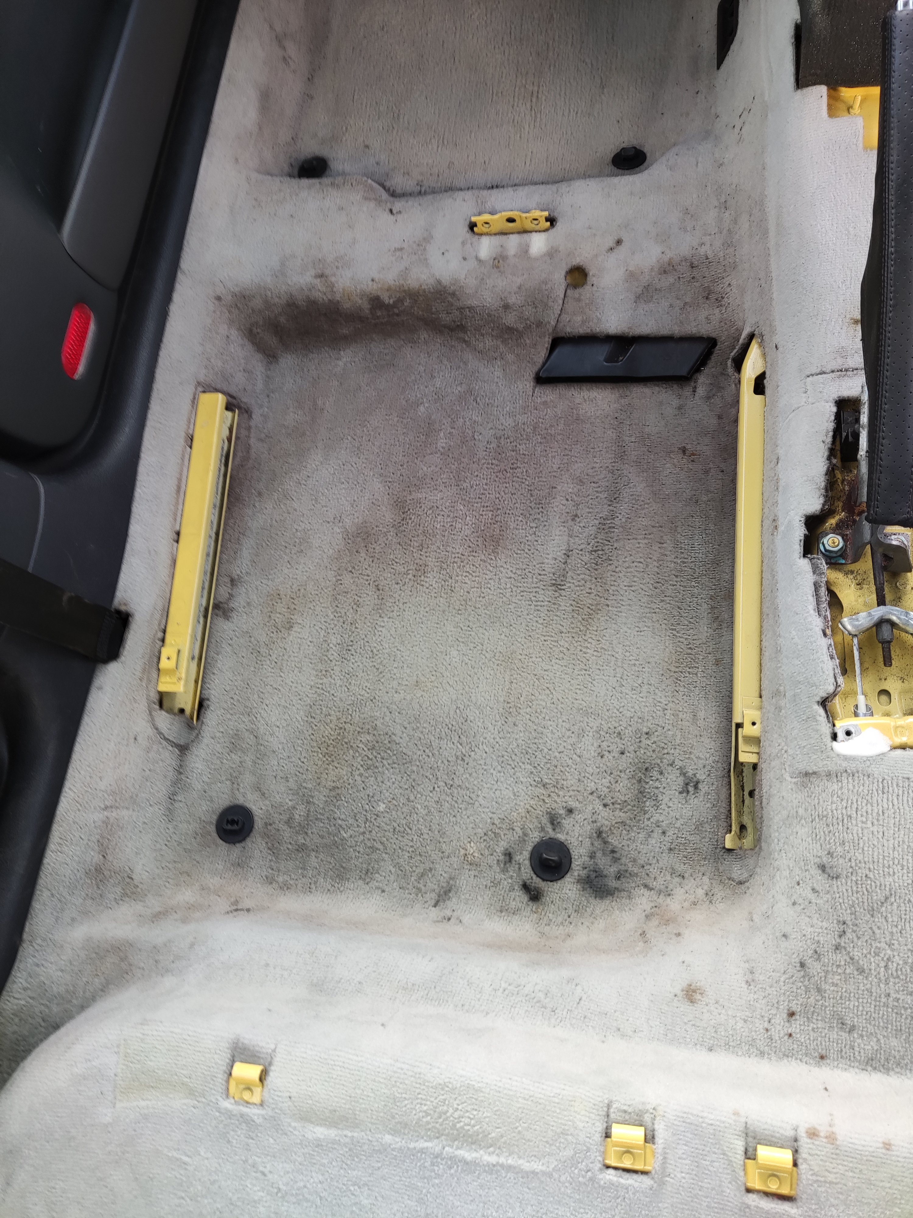

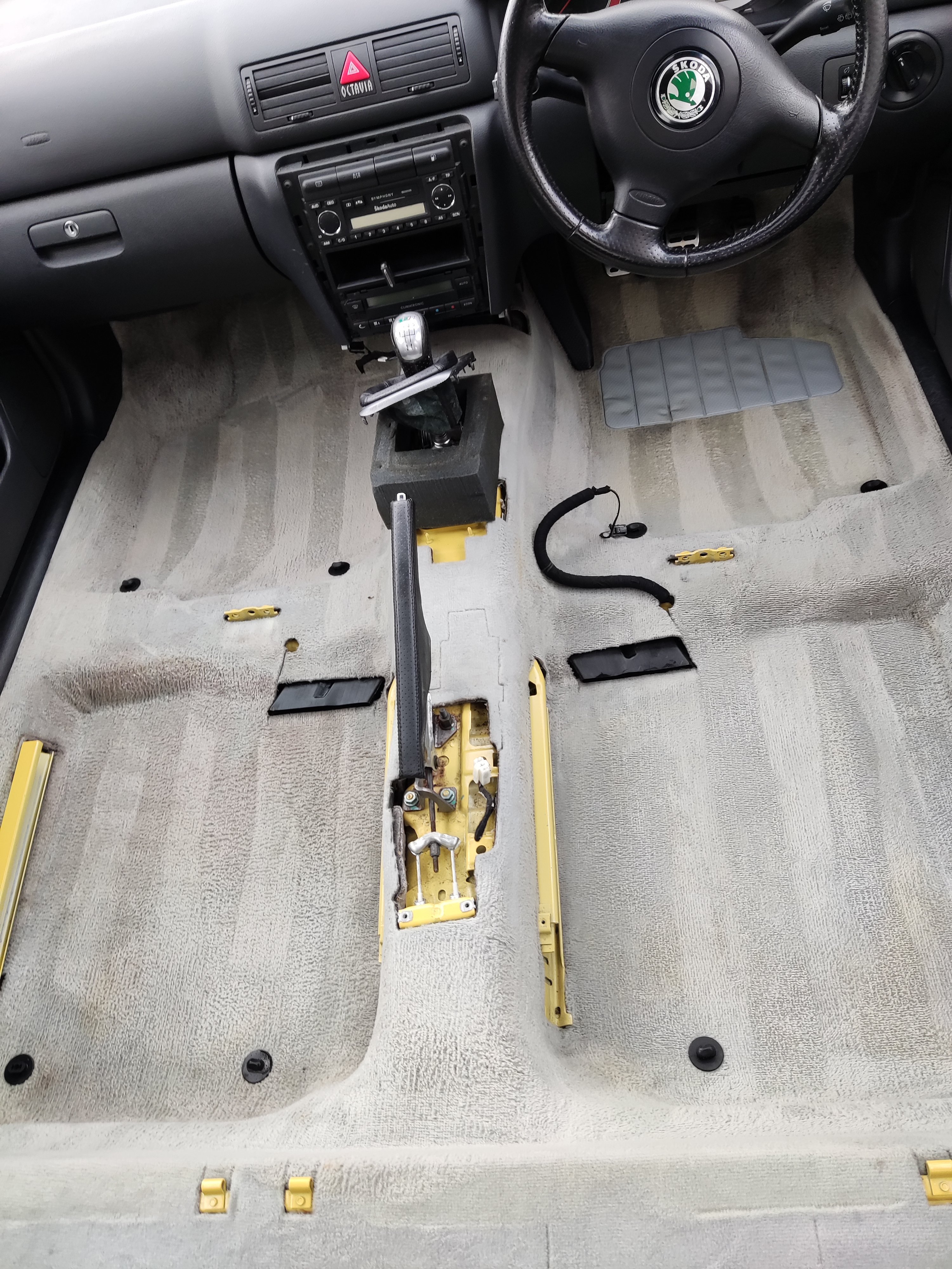

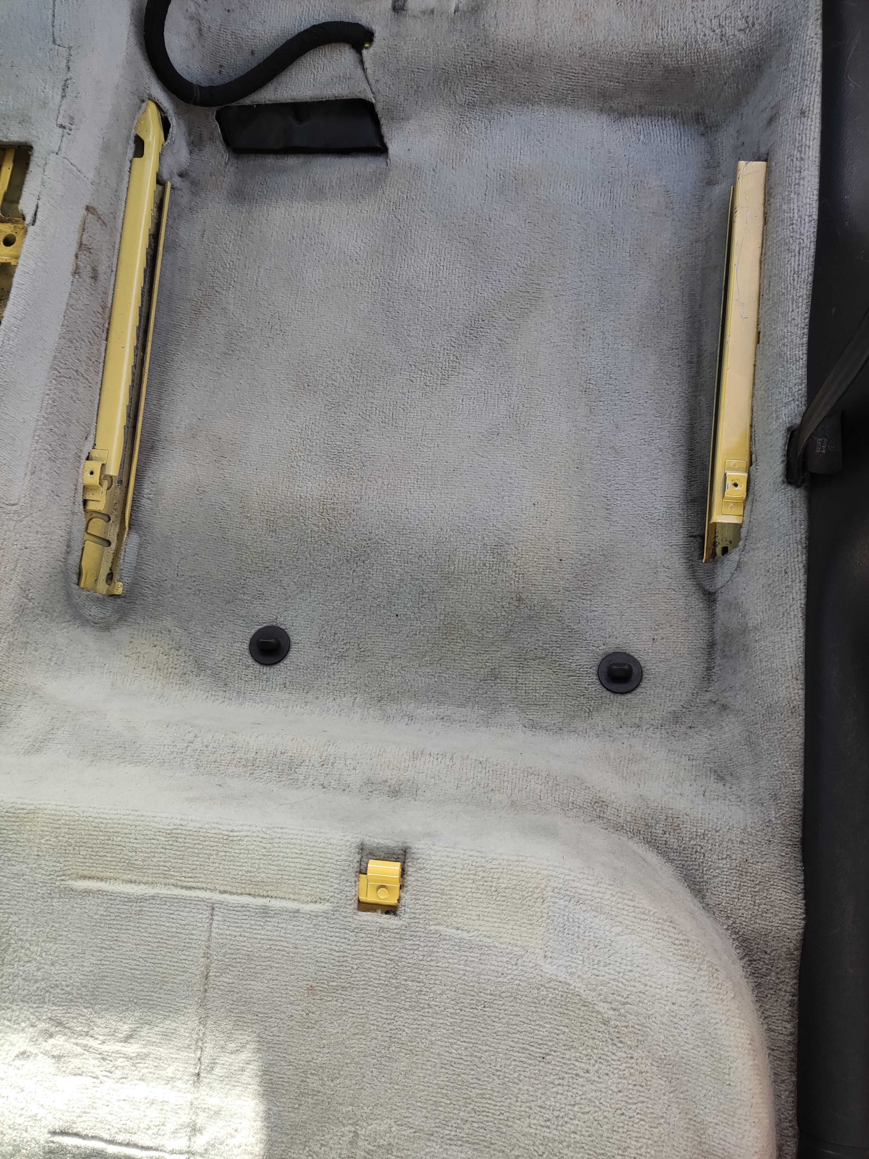

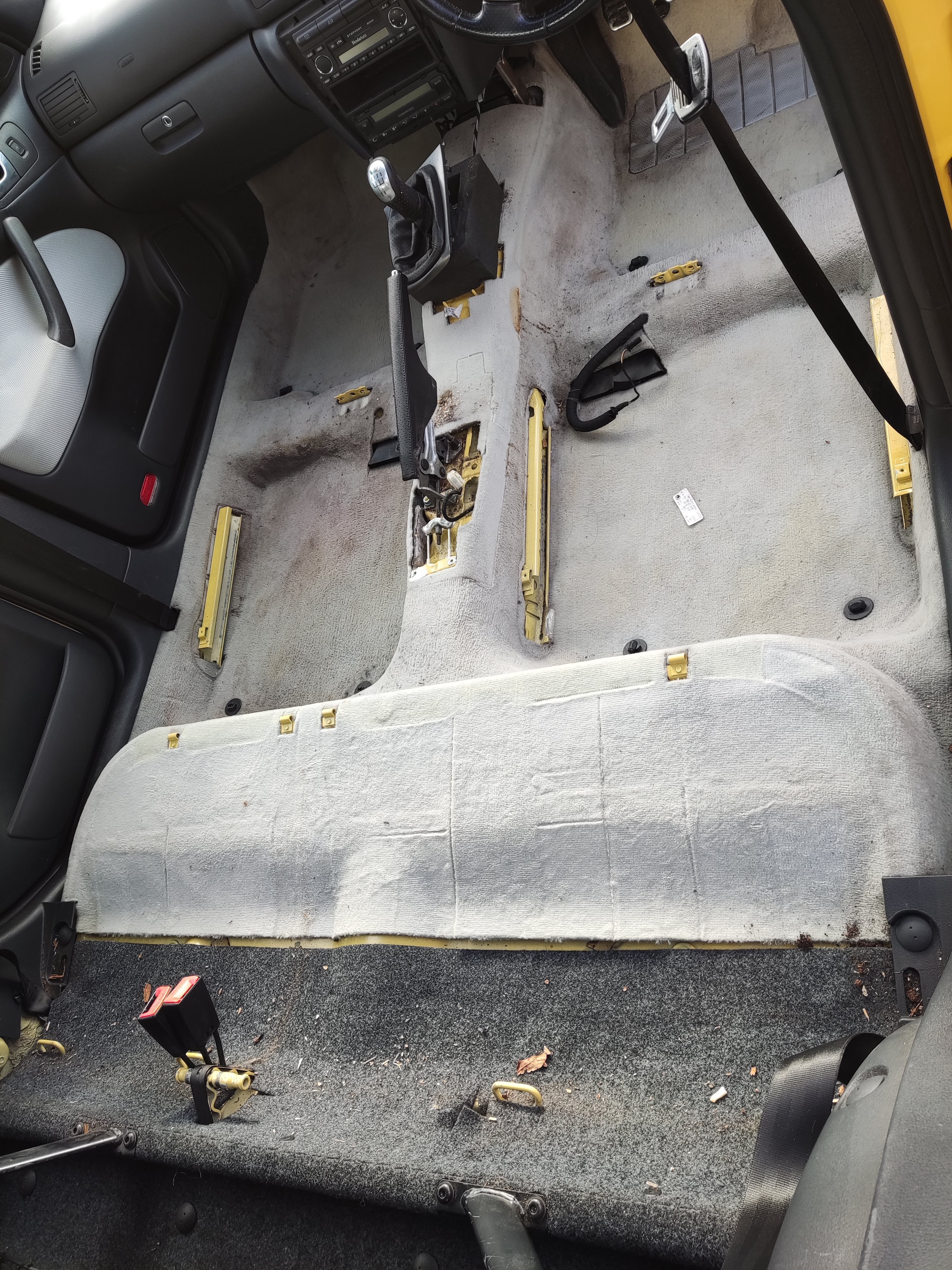

Sunday afternoon update, had a go at the carpet today...not perfect. There's some pink and yellow stains that aren't coming out but I'm happy with the results, it's nice to know they are at least clean.IMG_20220130_115708.thumb.jpg.9b0eb8cceca136025d1bd38b670c6778.jpgIMG_20220130_115723.thumb.jpg.66ea0d2c08a616b769dce63129d681d9.jpgIMG_20220130_115740.thumb.jpg.ca5c1d100bcc9200a23ff9e2420c904a.jpgIMG_20220130_115753.thumb.jpg.8859dd6f04325f7f2506fcc98b3cf79a.jpgIMG_20220206_124049.thumb.jpg.5b12d503e60160b2f9d15e4459a9cae0.jpg
Got a little bit more done this weekend, the weather has been crap though so not as much as I'd of liked.IMG_20220213_150427.thumb.jpg.e33a132ee48e00ed2d08129a2a6e65e0.jpg

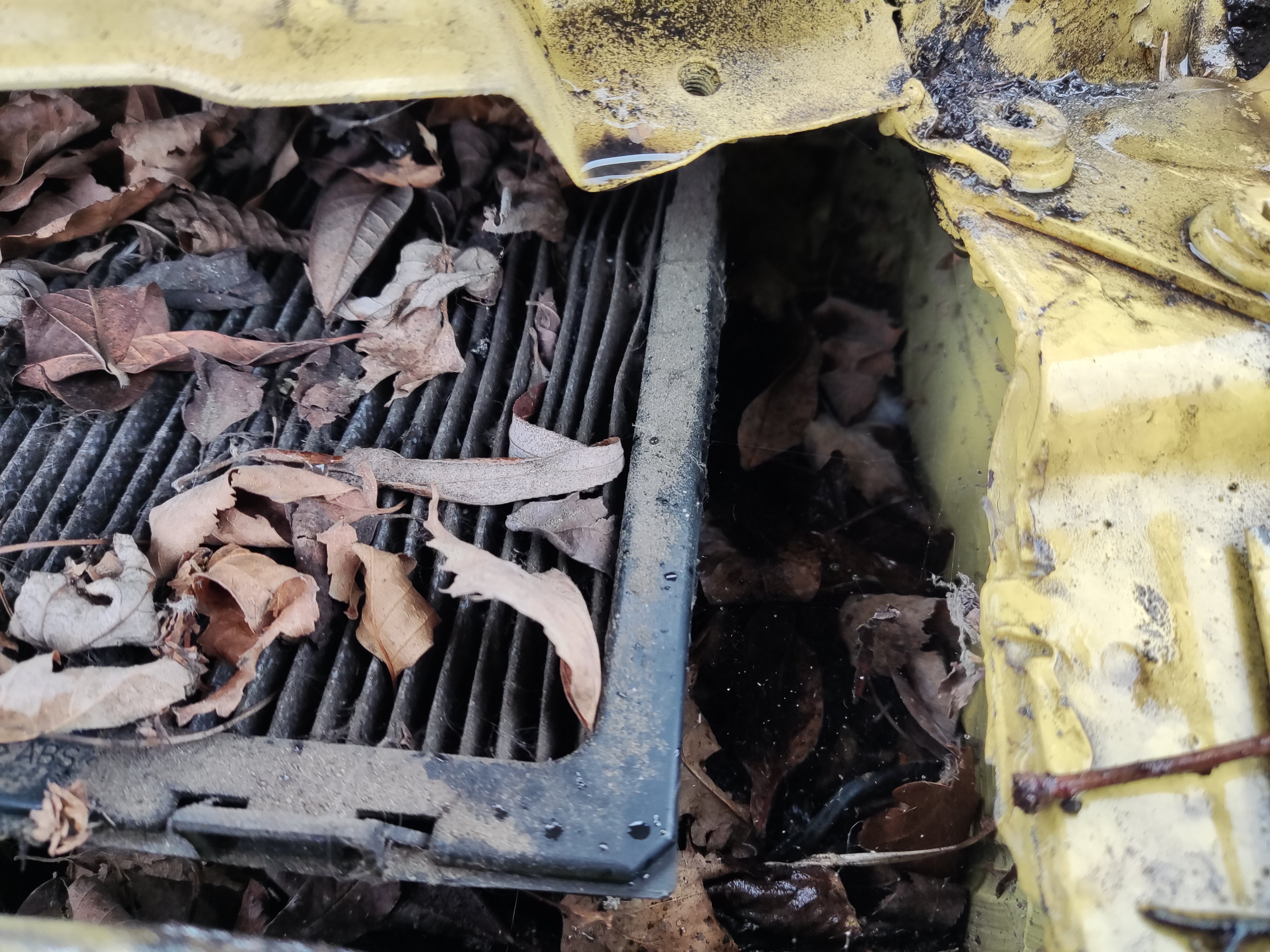

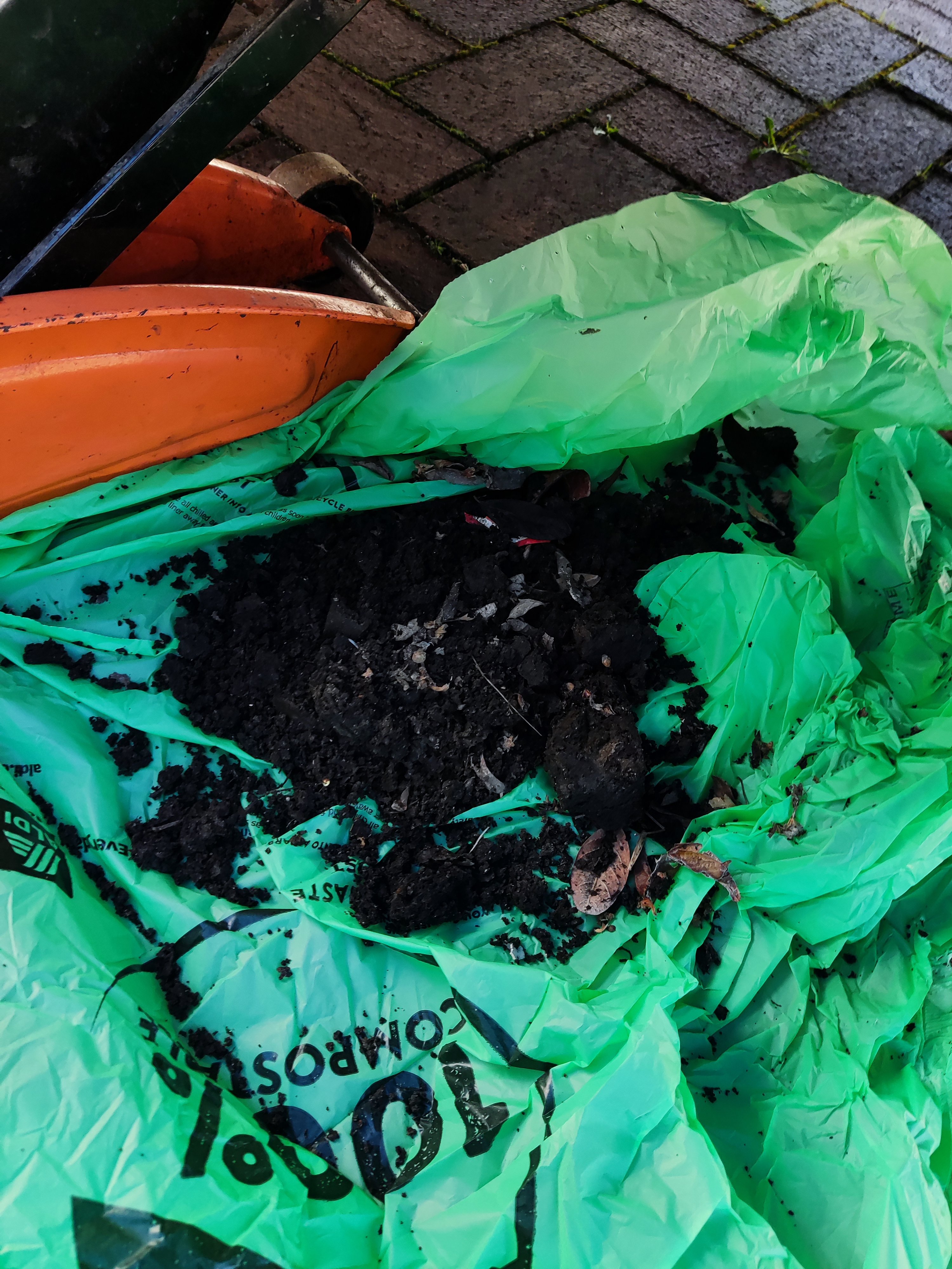

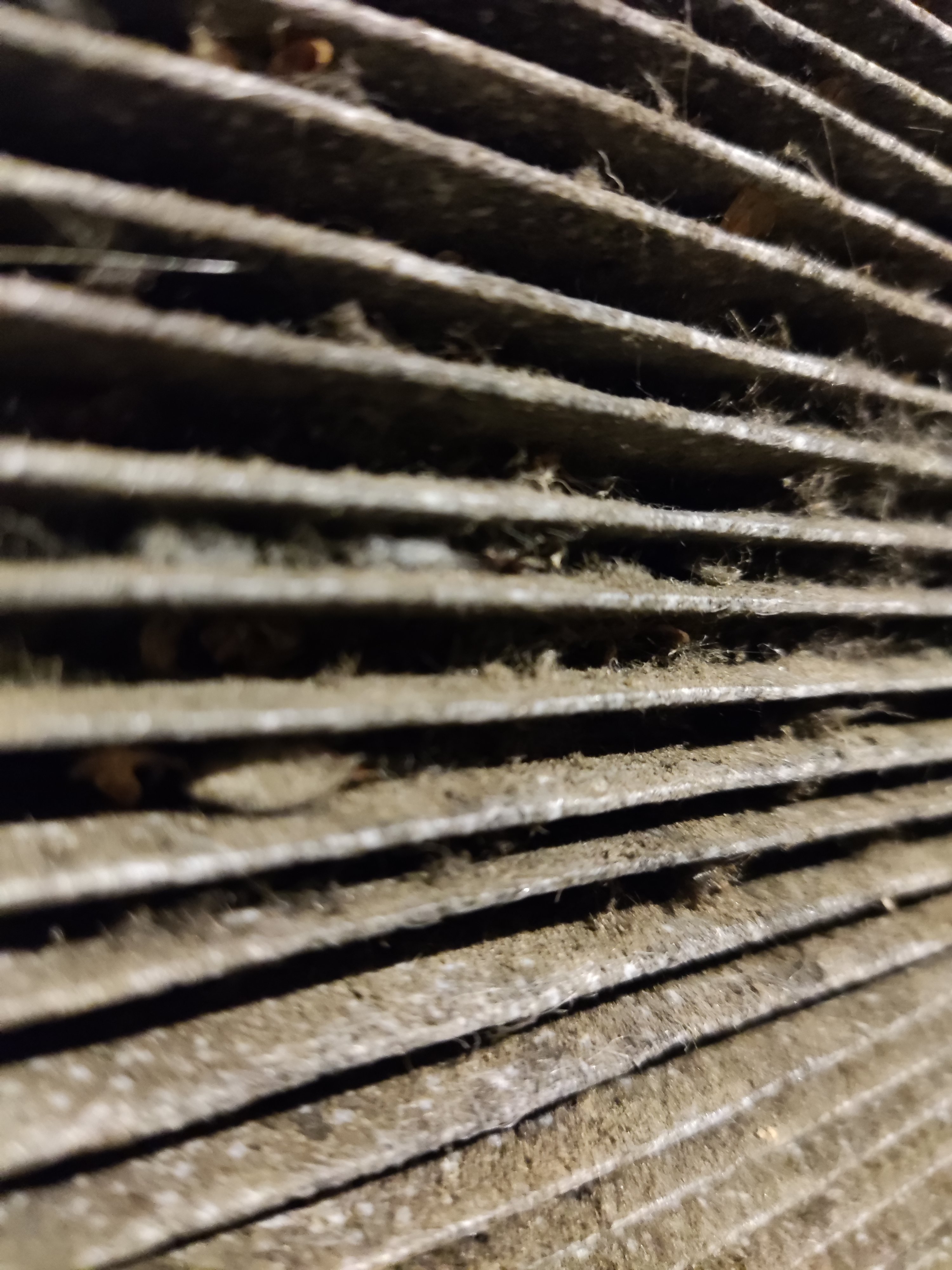

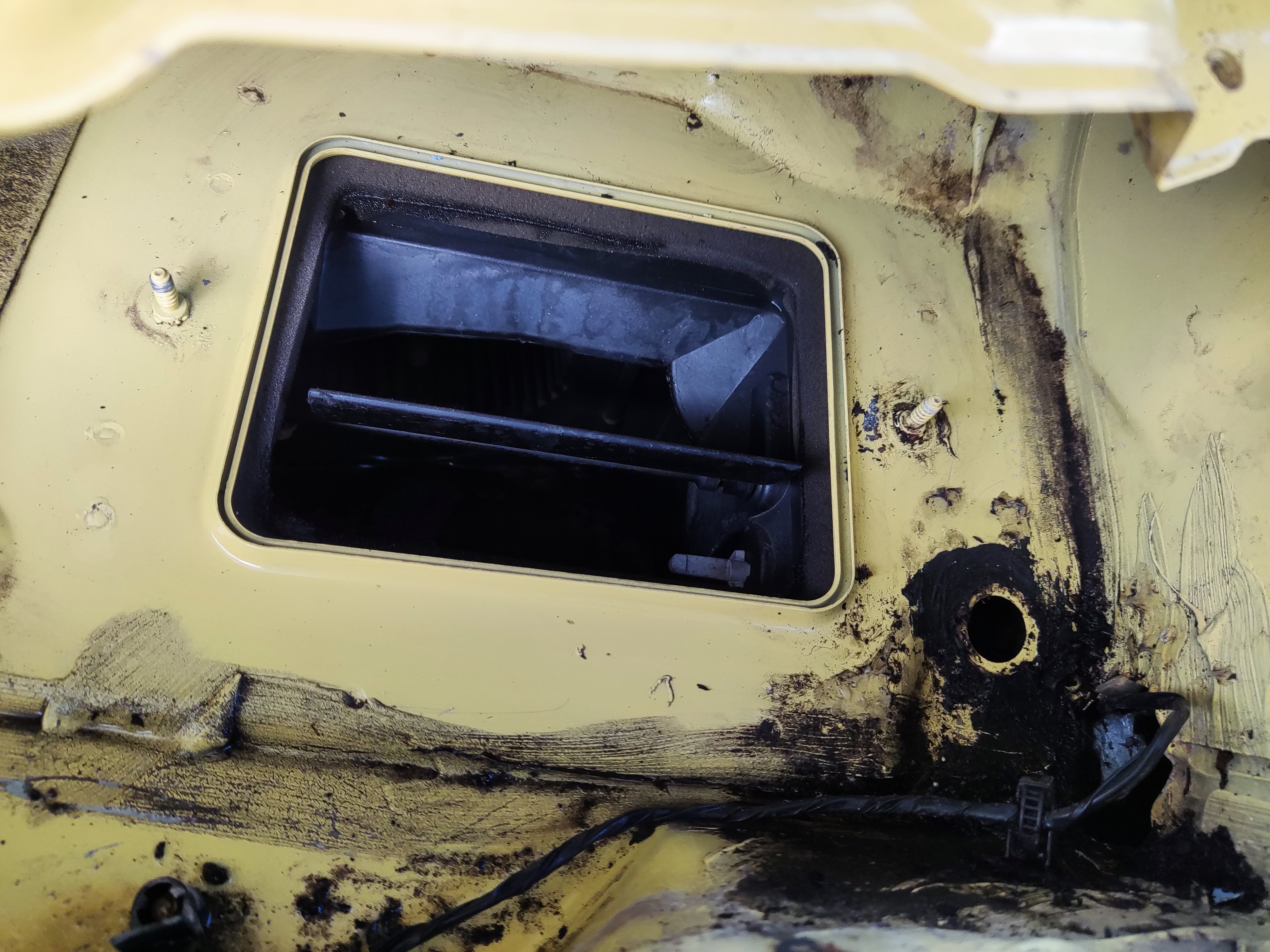

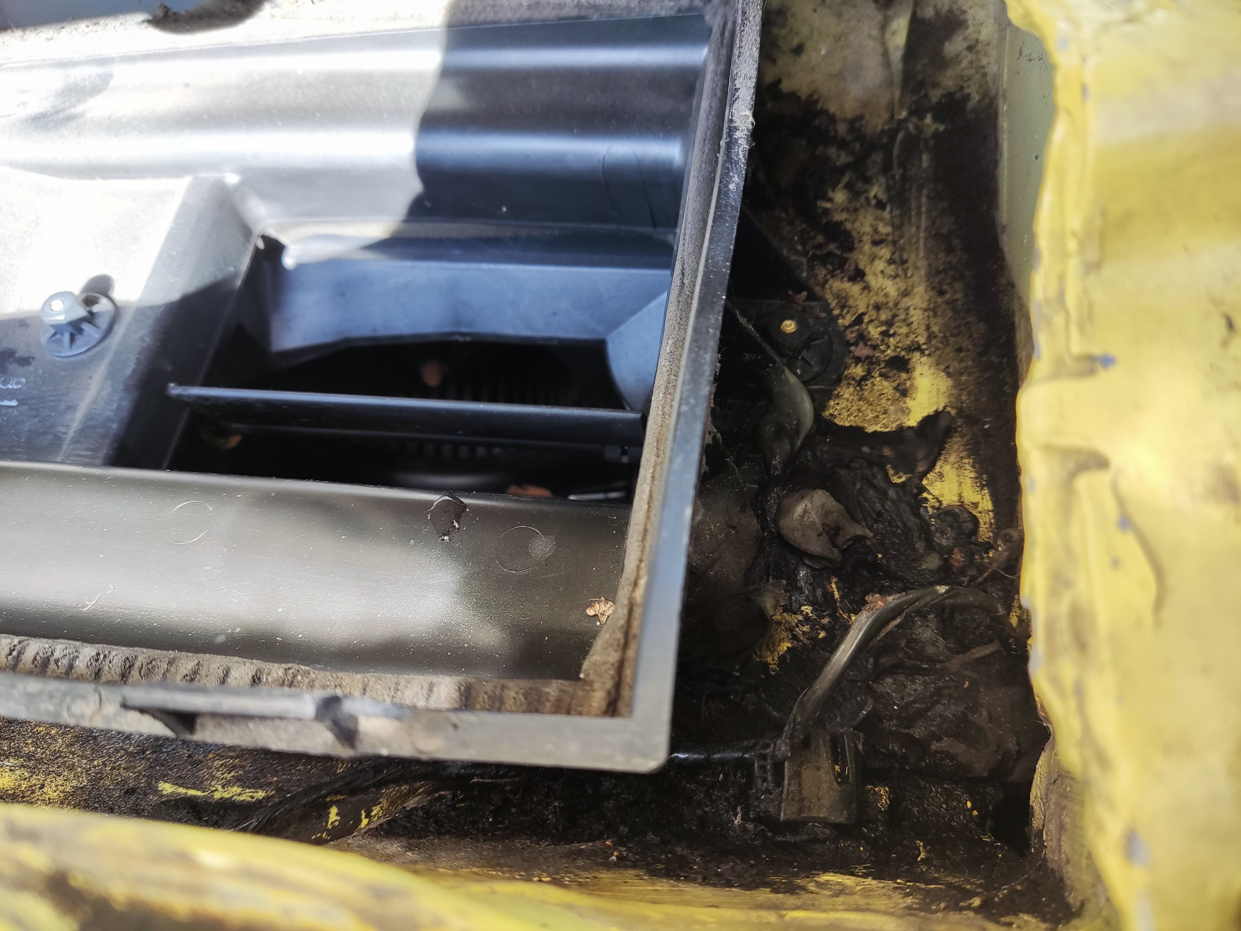

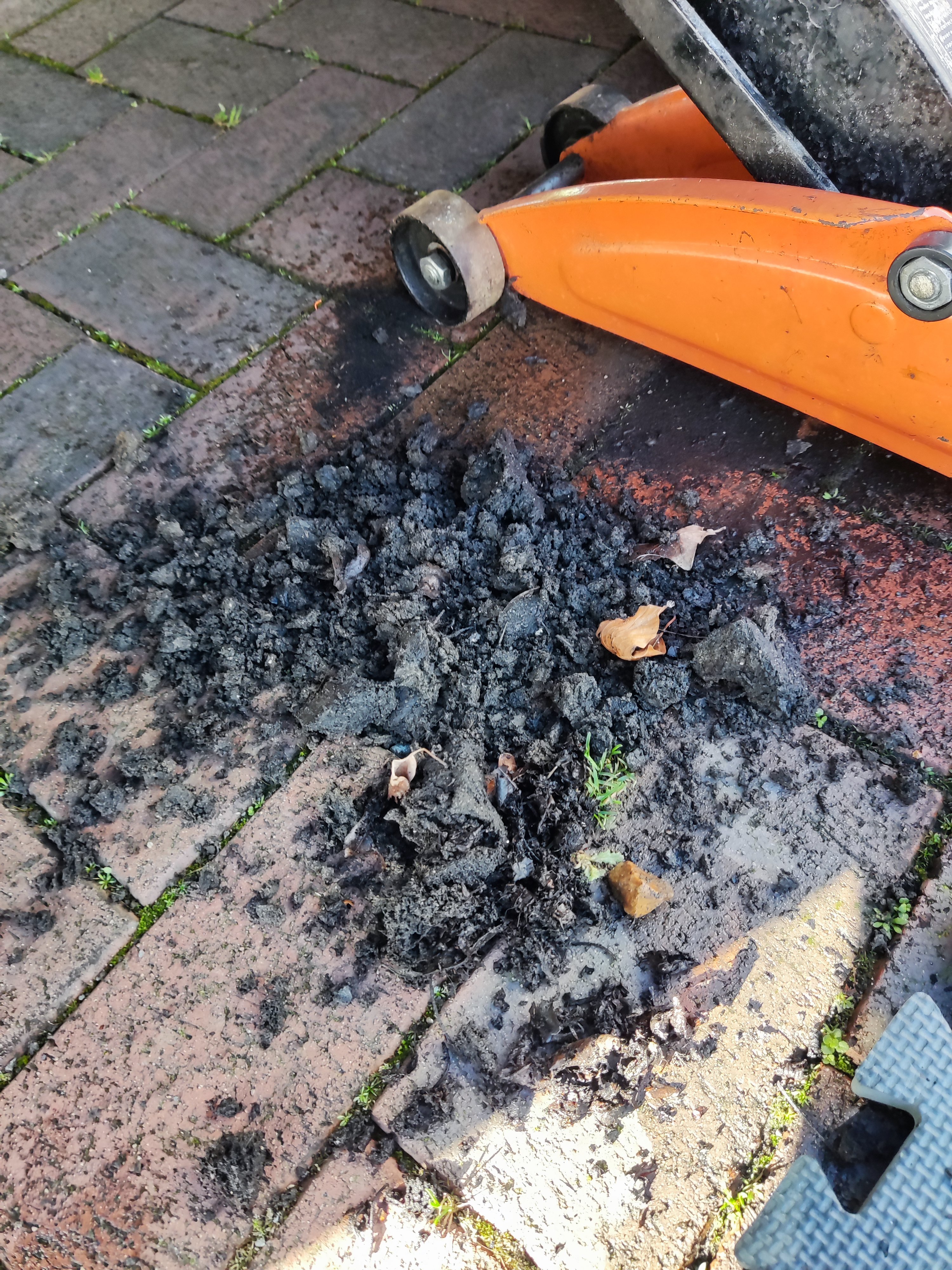

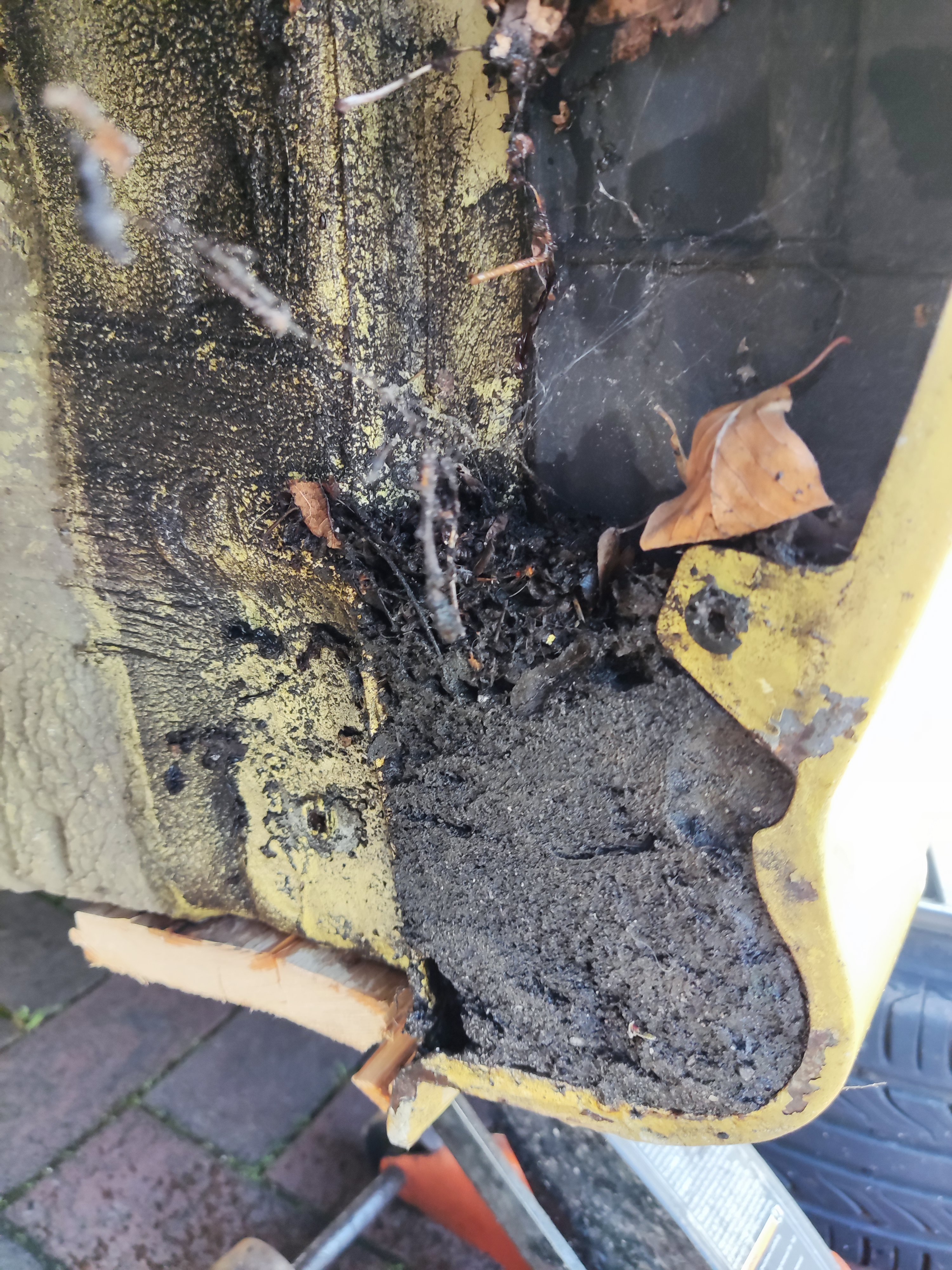

Interior back in, I've got water in the front passenger footwell though.IMG_20220213_142933.thumb.jpg.b41120e938cb928109db22d6f8d8c927.jpgIMG_20220213_143022.thumb.jpg.431a5ba84a7684578860ccd8ac3a463f.jpgIMG_20220213_143050.thumb.jpg.f02bcff148d7aceb2ff7c15607ef96f3.jpgIMG_20220213_143030.thumb.jpg.c1fec567c3bfbf32847368ab268bf3f5.jpgIMG_20220213_145954.thumb.jpg.ca8942ca5c39cb10a23b18e8ee38d8e7.jpg
Not a suprise to find this mess. I've vacuumed it out but the rain was too much to do a proper job so I've just made sure the drains are unblocked and put it back together without the filter in.
I haven't checked the door membrane yet so it could be leaking through there. The central locking doesn't work on that door and I wouldn't be surprised if someone has been in there to look at it and not stuck the membrane back down. I had a mk1 Leon cupra about 10years ago and I remember that leaked and I fixed it with some really sticky stuff that comes in a roll, anyway I guess it's the same deal to fix Octavias too.
I think I see why. ;) You seem to be on the right lines, with the note that the LHF arch liner needs cleaning out from the rear edge bottom.

That's some good progress so far and cleaning the carpet is something I keep meaning to do...
As for the crud behind the scuttle panel, that looks like it's never been done.  I don't think I've ever seen one so full of gunk and removing it all can only be a good thing.

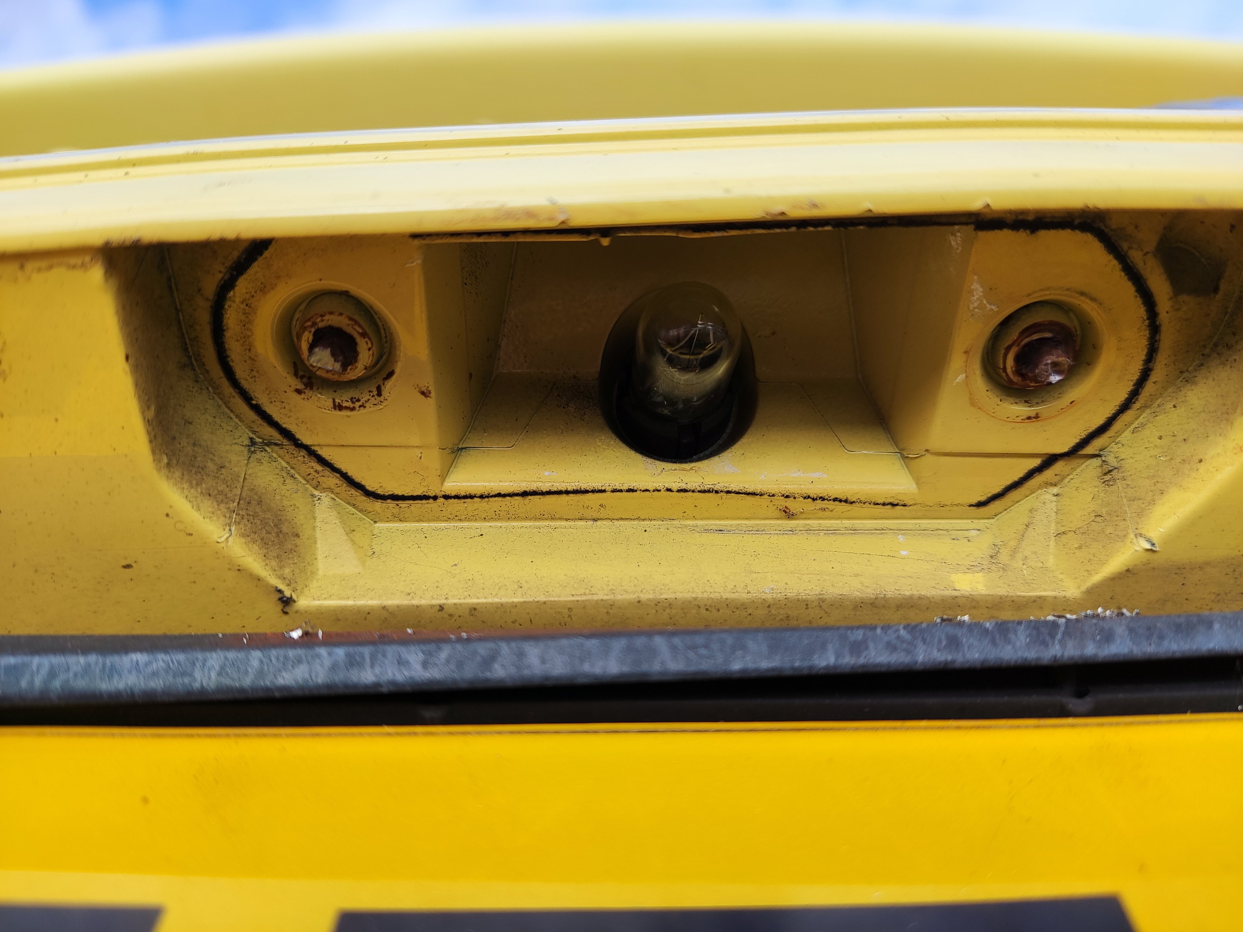

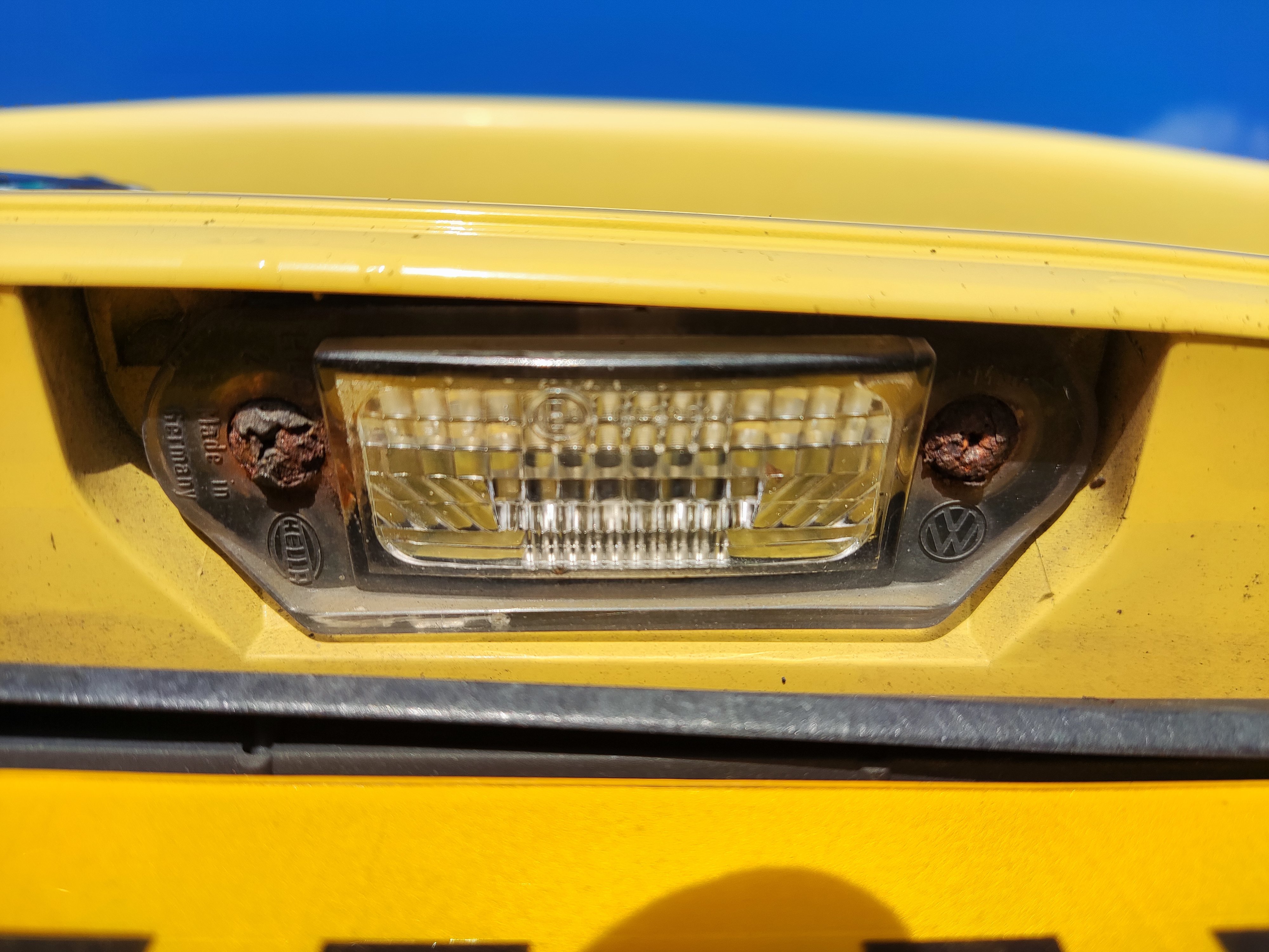

I've been at it again today, Mot on Monday so I thought I'd better take a look at the lights. All the lights apart from one number plate light worked, not a problem I thought, I've got spare push fit bulbs.IMG_20220219_130733.thumb.jpg.9fa7f9755faf1bd42b72644bc0c2b902.jpg
Ah that's not what I wanted to see.IMG_20220219_135457.thumb.jpg.7d53f67a4da3562a4638a0e153c42132.jpg
Hmm the bulbs replaced but how am I supposed to get the rest of the screws out?! Anyway tested the new bulb and guess what...the other one blew. Never mind, drilled the heads of the other side and replaced the bulb.   So both lights working but 4 screw "ends" to remove. I know I thought I'll pull the cover off the inside of the boot lid and see if I can remove the handle/trim panel and get a better look at it off the car...well blow me I could have changed the bulbs from inside the boot lid cover and left the screws alone, what a ******.
At this point the weather is taking another turn for the worst so I did something I hate doing, I bodged it by sticking the lenses back on with silicone, not my best work and something I will be fixing properly at some point in the future but at least I'm heading towards an MOT with some optimism.

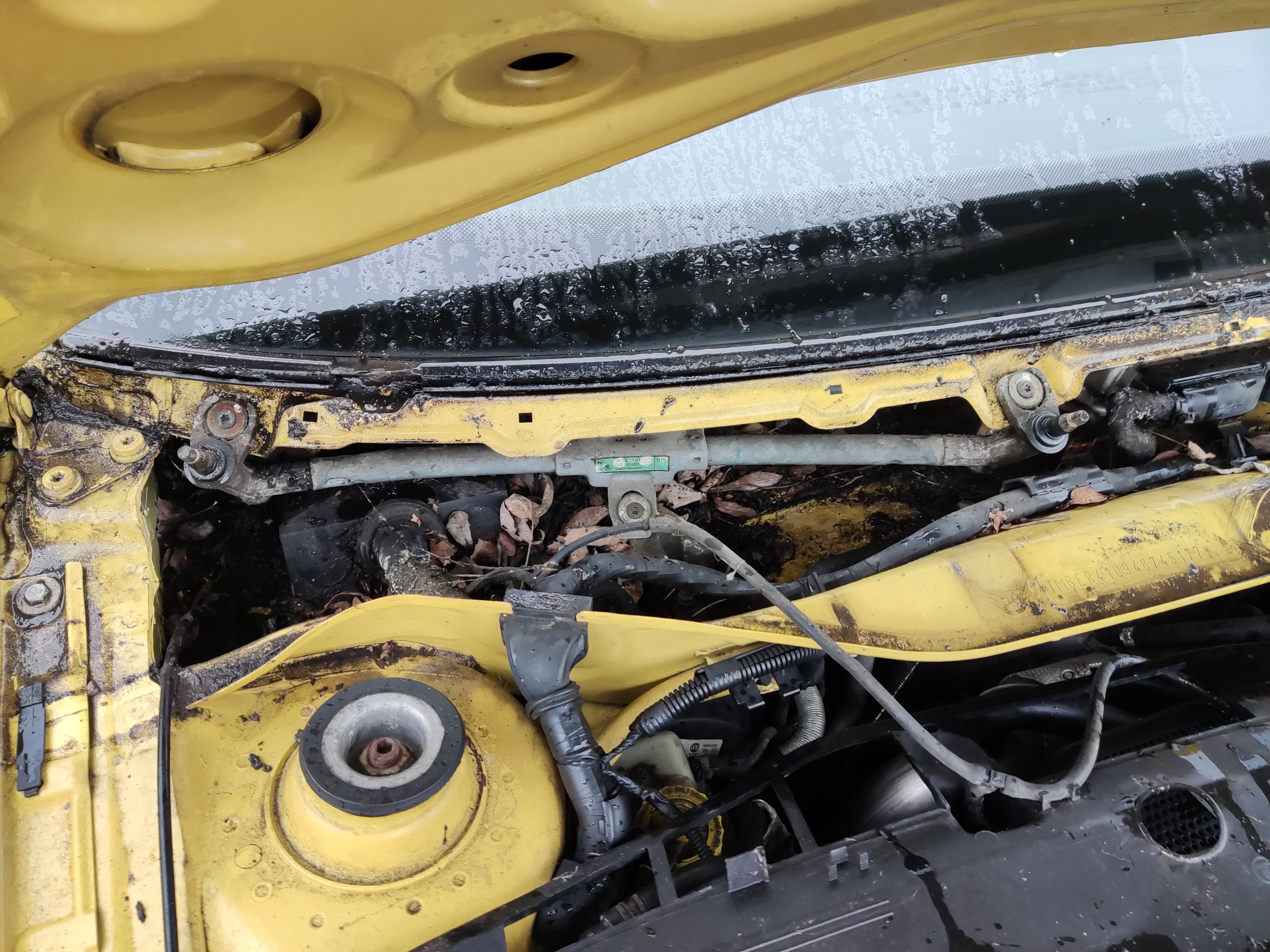

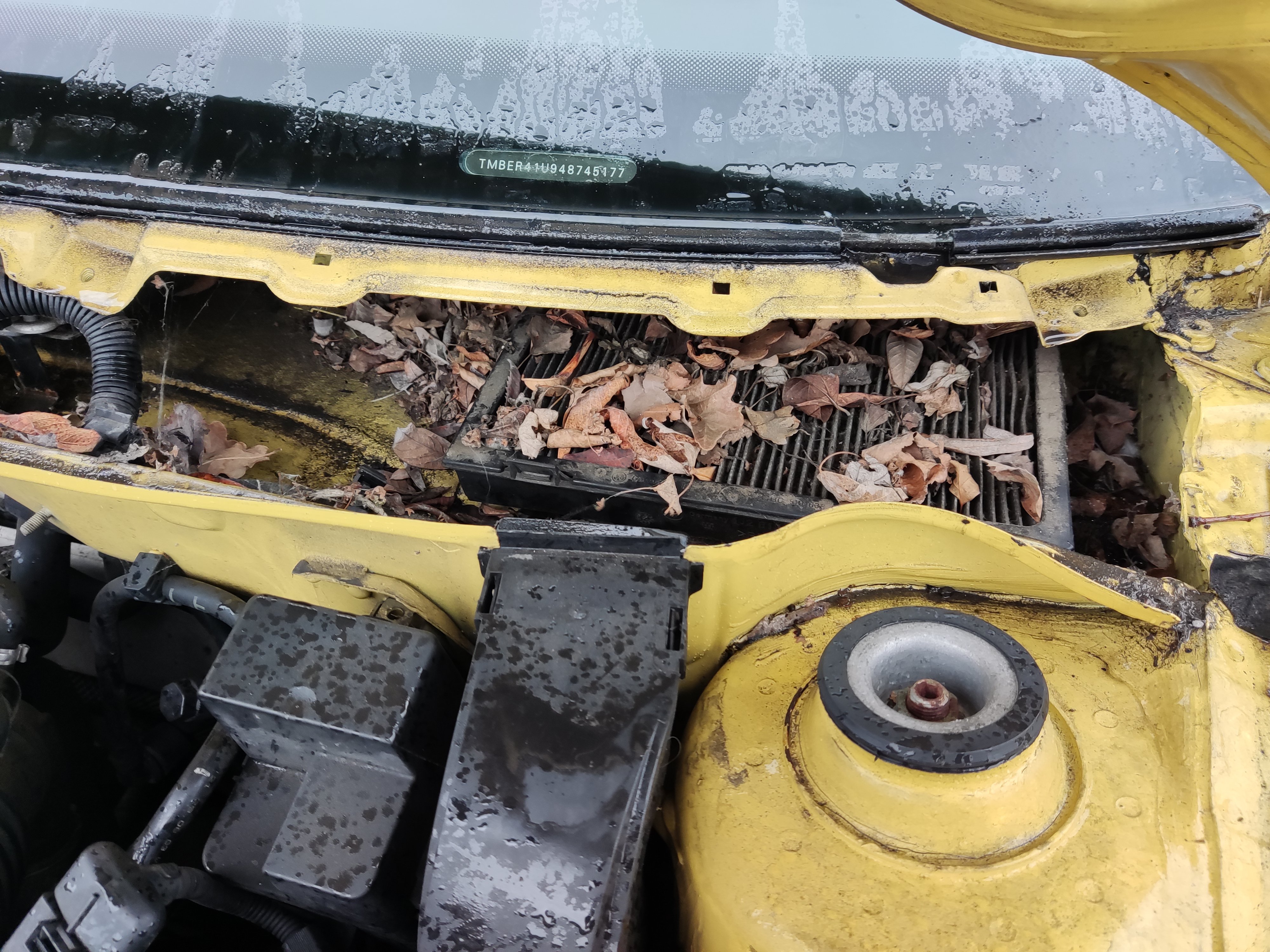

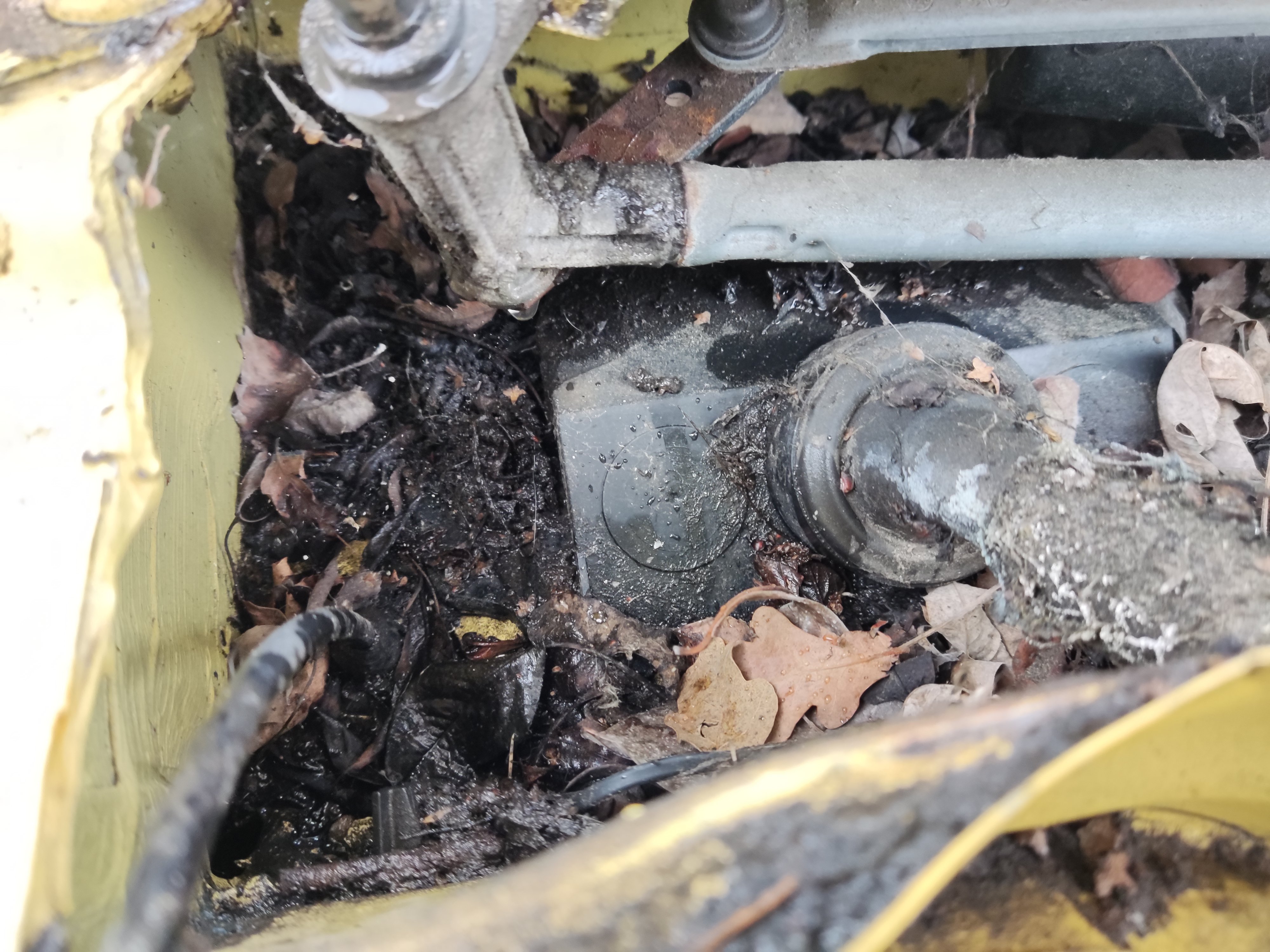

I also spent a bit more time on the scuttle leak.IMG_20220222_125140.thumb.jpg.601aa290fe31d96727f8ad39f8b03799.jpgIMG_20220222_132026.thumb.jpg.a801bbcba5199782cdd3ba882e906415.jpgIMG_20220222_132824.thumb.jpg.6a01cbcfb54fdd9023943ccb75280e6d.jpgIMG_20220222_132940.thumb.jpg.cd98e21c416501c7c2c565aab6e9c73b.jpgIMG_20220222_132946.thumb.jpg.df8c414004d6a9d103b43f685ff7d082.jpgIMG_20220222_133411.thumb.jpg.ffd2d175325ebfee74743baad243f4ab.jpg
I need to replace the grommet that's missing near the heater filter. It was full of silicone but not water tight. I've stuck gorilla tape over it for now as it's the best I could do. Anyone know what grommet is supposed to be there and where to get one from?
I can't help you with the grommet, sorry.  I just wanted to say well done for removing all that crud from the car.  It must weigh 2kg less now that all that mud & stuff has been removed!

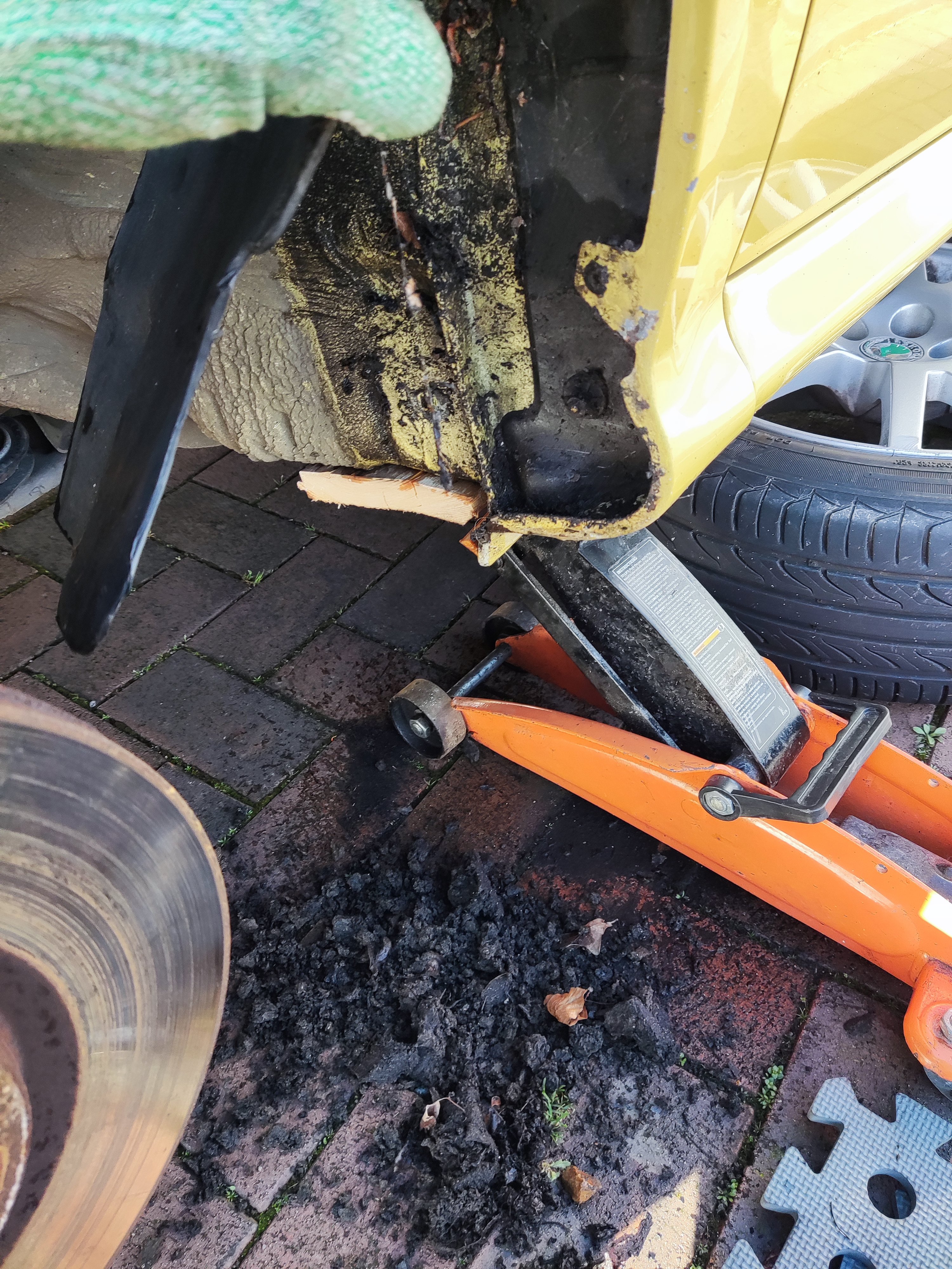

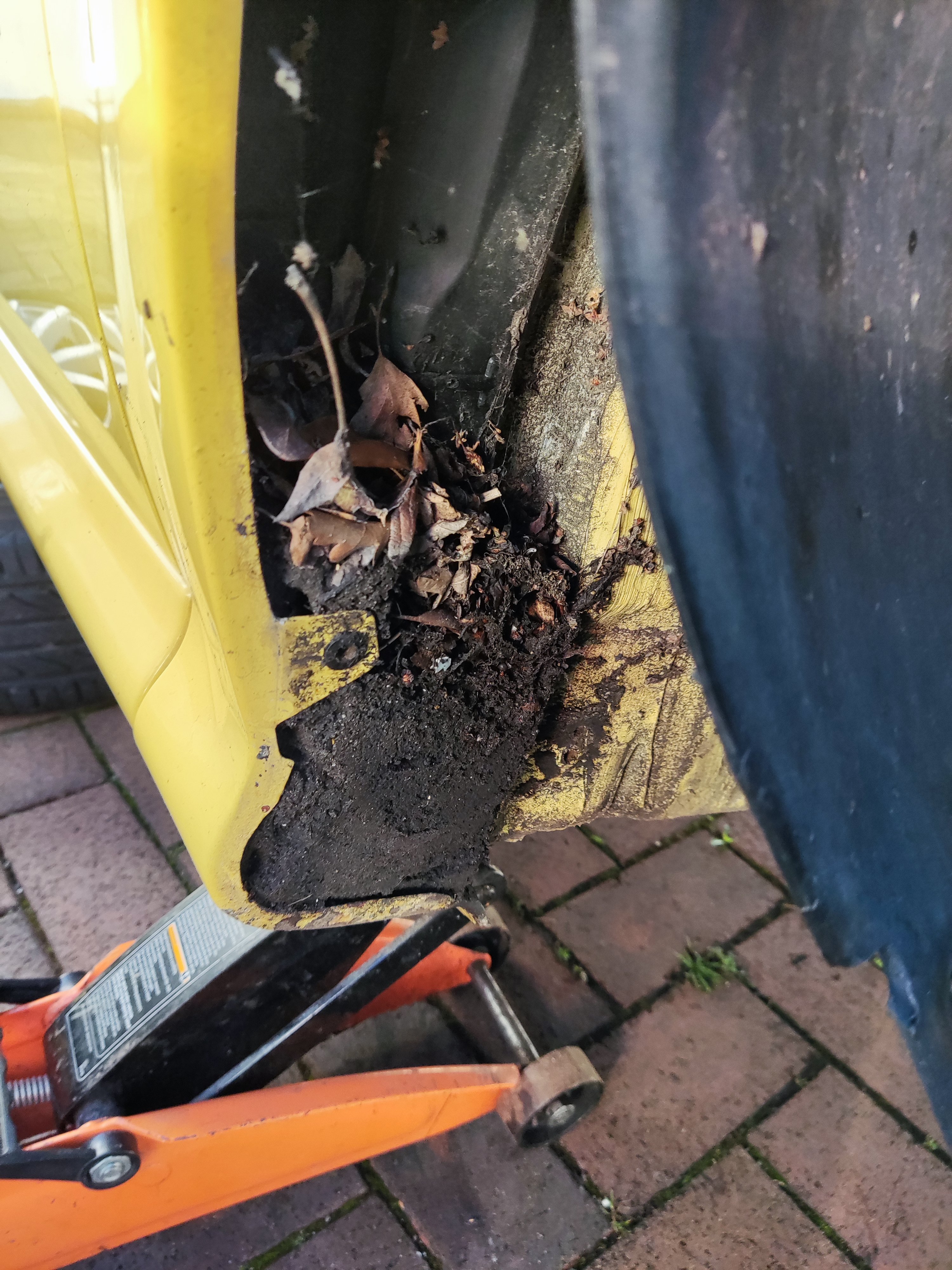

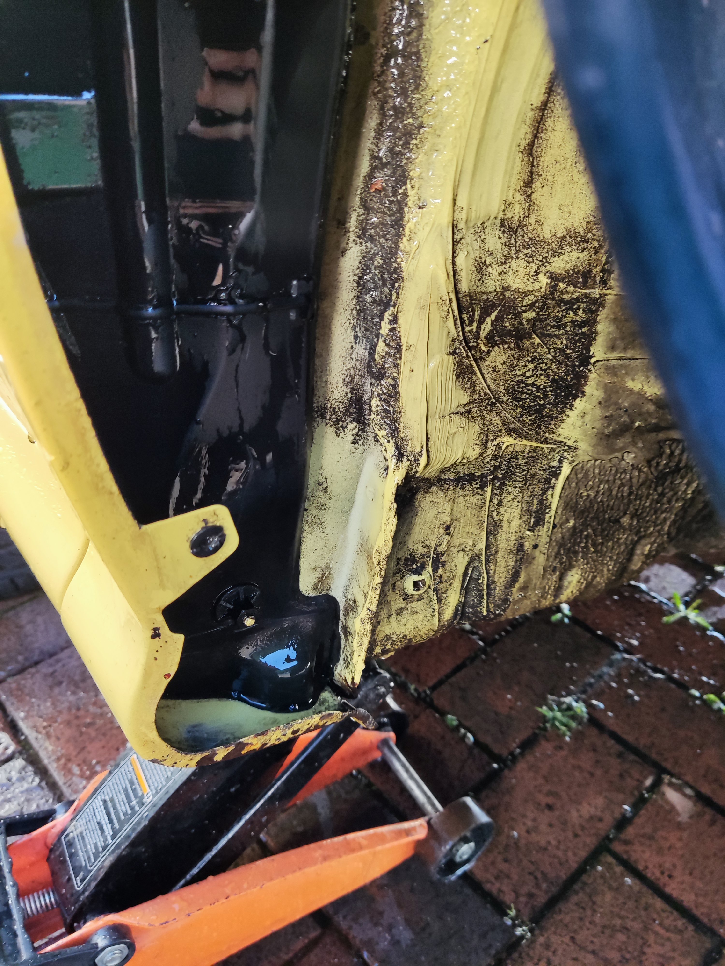

Yeah there was a lot, still got the driver's side arch liner to clean out too.

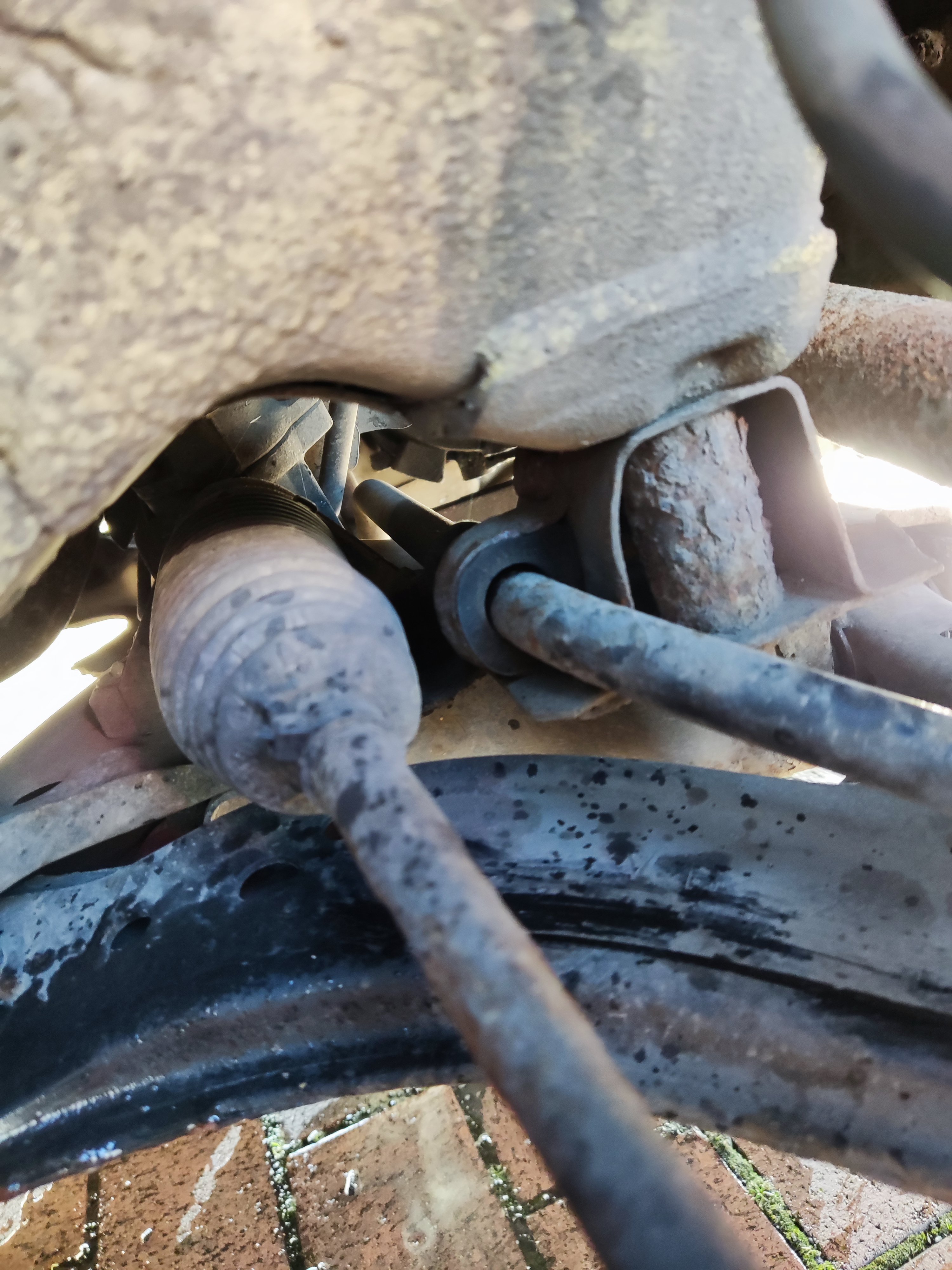

Just got back from a family trip to IKEA for dinner, it's the first time properly driving it. The front anti roll bar bushes need changing, I can here them banging at slow speeds. I'll measure the ARB size and the size of the grommet tomorrow and get some ordered.

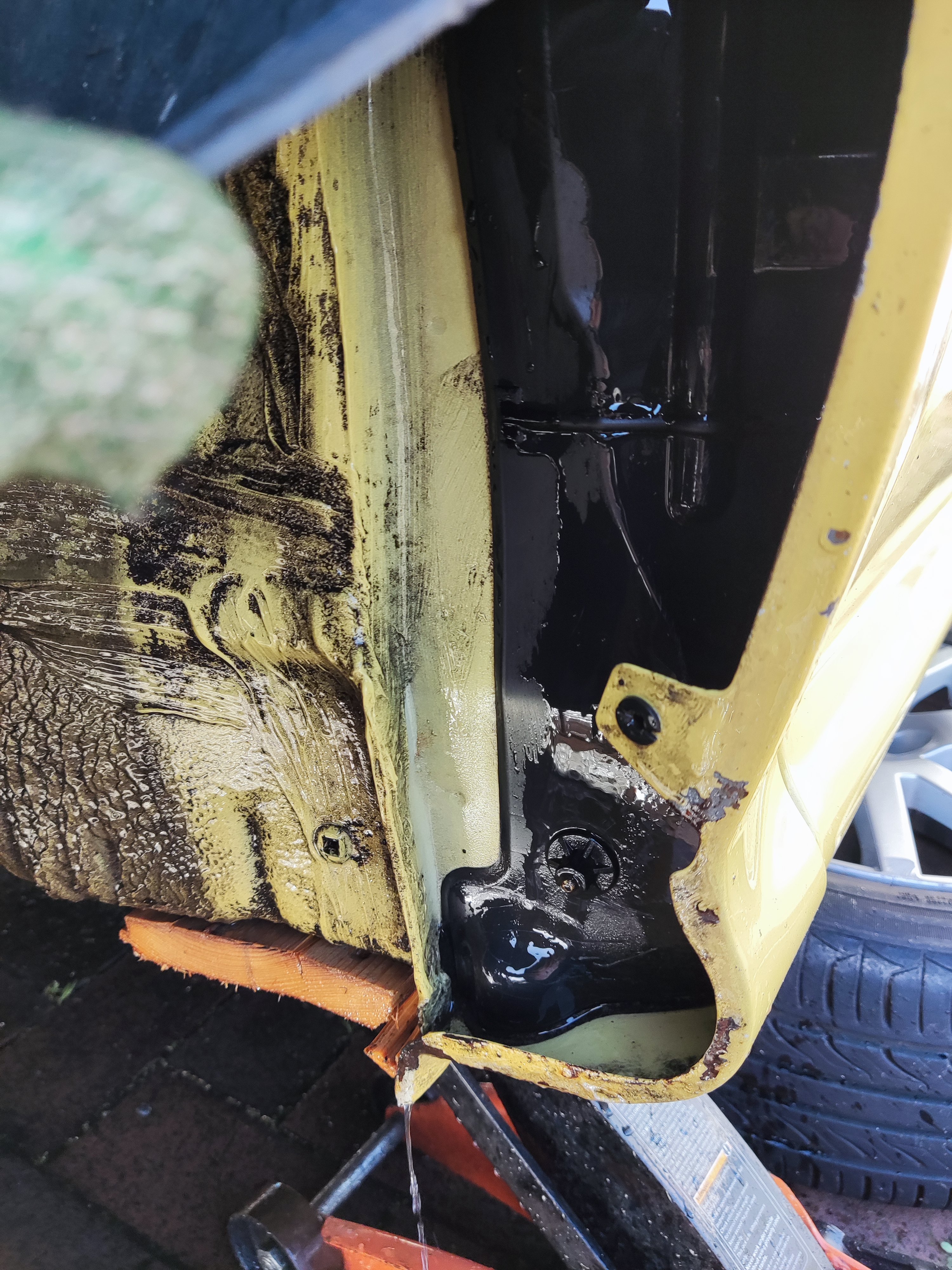

Back at it today. Got the driver's side arch cleaned out.IMG_20220223_093348.thumb.jpg.cff2b05c7a977bcae8f0ea8e6e491035.jpgIMG_20220223_093559.thumb.jpg.d0f6d36ee53b811daaf028209b7a19d5.jpgIMG_20220223_093906.thumb.jpg.e7f93aed6cb98e3fed607aef518cfa55.jpg
I've measured the anti roll bar, it's 20mm.IMG_20220223_093912.thumb.jpg.01e8b598614b808f659b79213d17a680.jpg
the missing grommet seems to be 20mm too, they sell a box of 100 for £2.69 at Screwfix, I only want one😂.

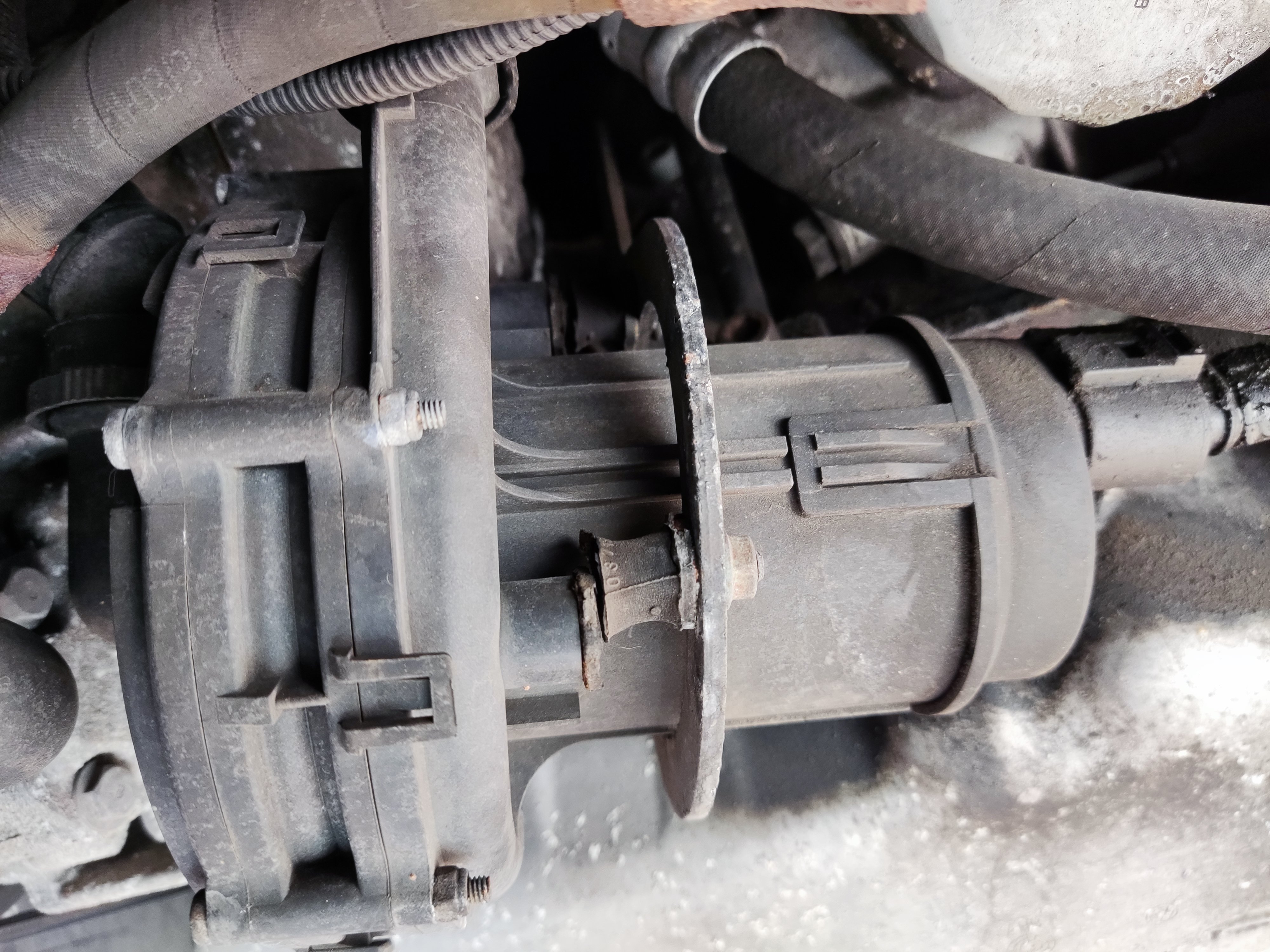

Also noticed that the sai pump mounts are broken, not sure what to do about that yet, I'll search the forum later.IMG_20220223_092901.thumb.jpg.e8b417e691faeb640c7952e01f33ddcd.jpg
Some people remove the SAI as it can be easier than fixing it.  There's a link here,

ref the airpump most motor factors will keep fuel pump bobbins in which will fit and couple of quid each (fixed mine)
I have read about all the engine bay deletes and I can see me doing that in the future but it looks easy enough to replace the mounts on the pump for now.   It seems like if if don't get the car remapped after the deletes it will probably throw a code even with the resistors in place.   What I'm saying is I'll get rid of all that extra gubbings when I'm more comfortable with the idea and I've got a plan.  The engine bay does look a lot tidier when it's all gone that's for sure.
I think I've found the correct mounts for the sai online, they're cheap so I'll order some and see how I get on.
