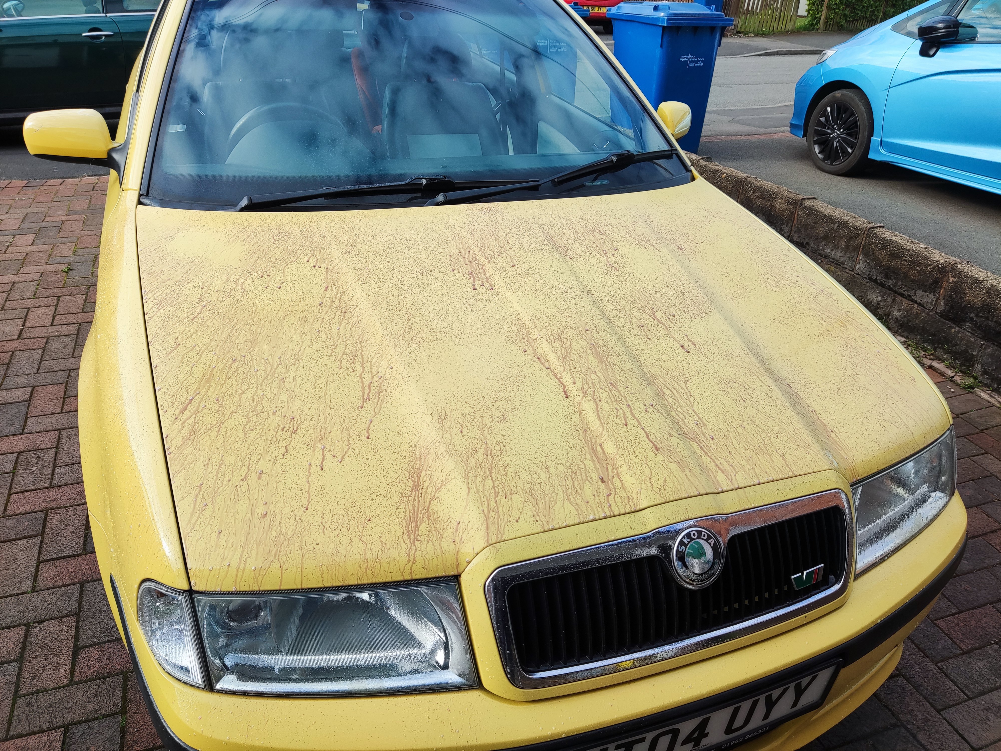

I used the autoglym magma yesterdayIMG_20220415_085439.thumb.jpg.aeaf706a770632cf1b0c9e261f1db4b6.jpg
The car was absolutely covered it big iron particles like someone has been grinding metal next to it so I ended up using the entire bottle just to get the bonnet done, this is probably due to me not using it effectively and wasting it but I did follow the instructions on the bottle. I started off giving the entire car a spray with it, that was probably a third of a bottle. I left that for 5 minutes then jet washed it off, it did remove loads a stuff but not all of it. I decided to concentrate on the bonnet which was the worst panel. After a lot of hard work and picking at it with my nails (I really didn't want to do that) I've managed to get it looking clean at lastIMG_20220415_111945.thumb.jpg.c4ccfa26ec06c88a24673d289099b5a3.jpg
It's hard to get the camera to focus but trust me it's clean and ready to polish.IMG_20220415_111837.thumb.jpg.697df91be441d6b7a45141d24f3f9fba.jpg

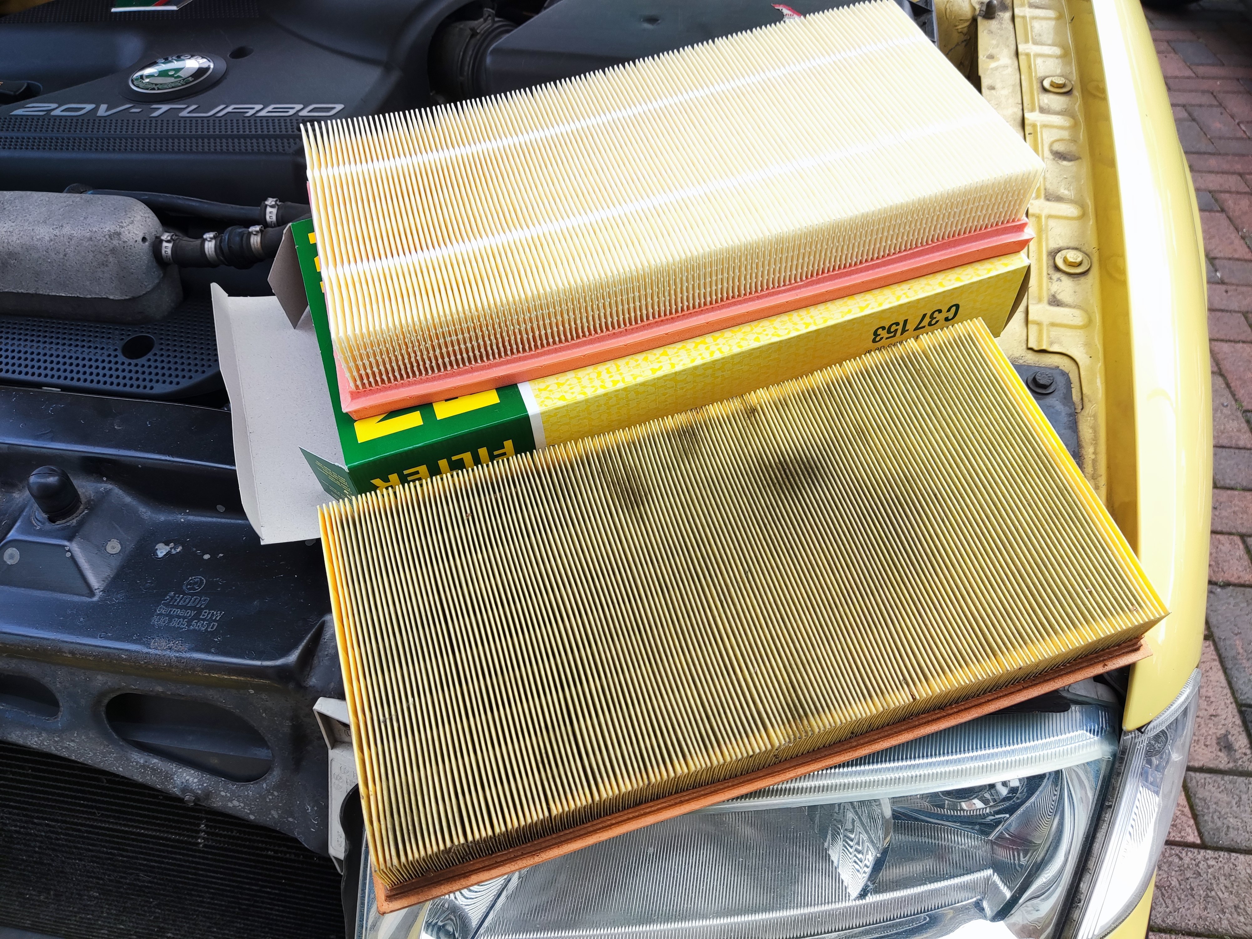

I've just popped a new air filter in today too.IMG_20220416_163810.thumb.jpg.69c603939c60c637f04b6e23a7e8ab95.jpg

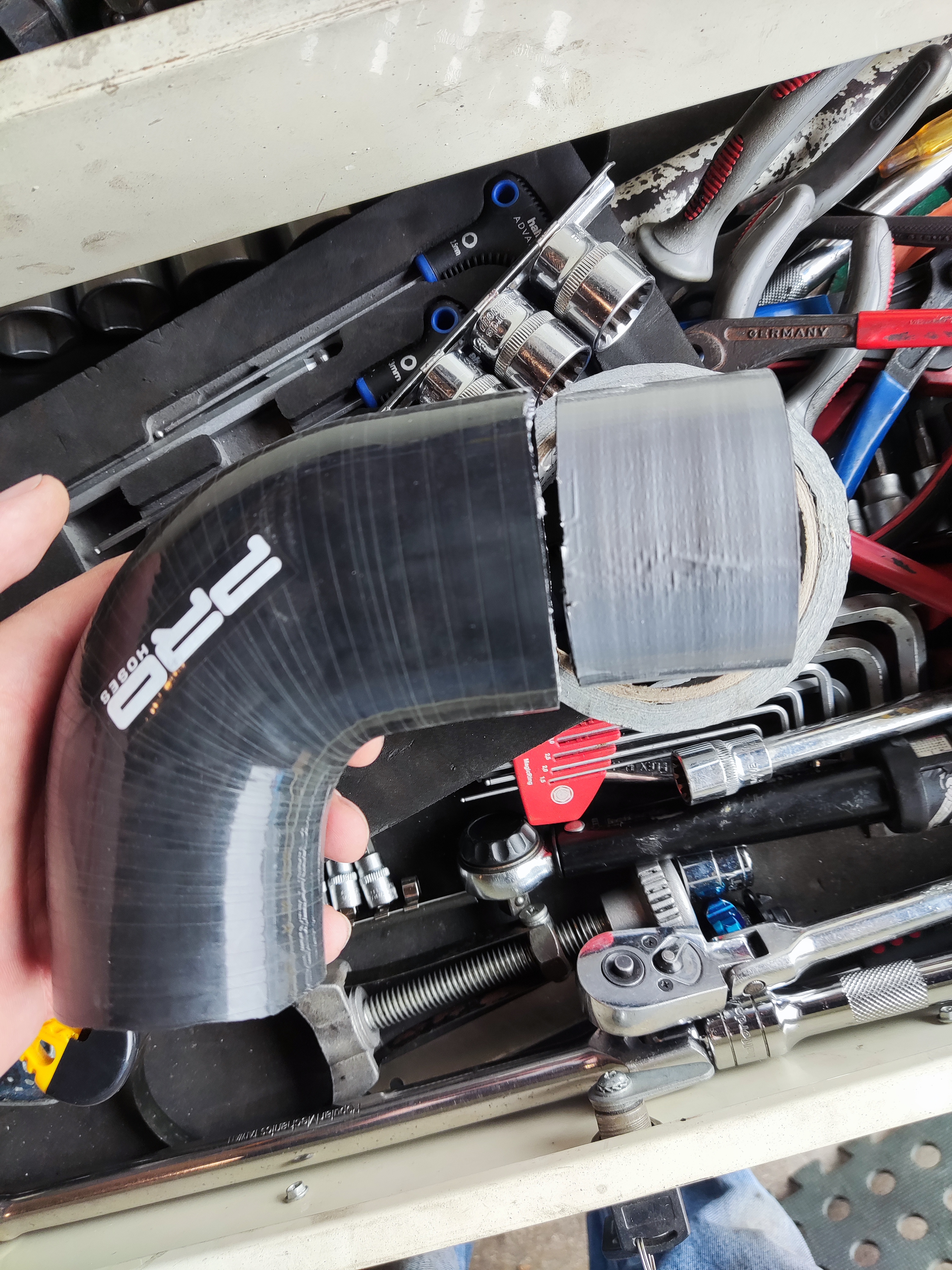

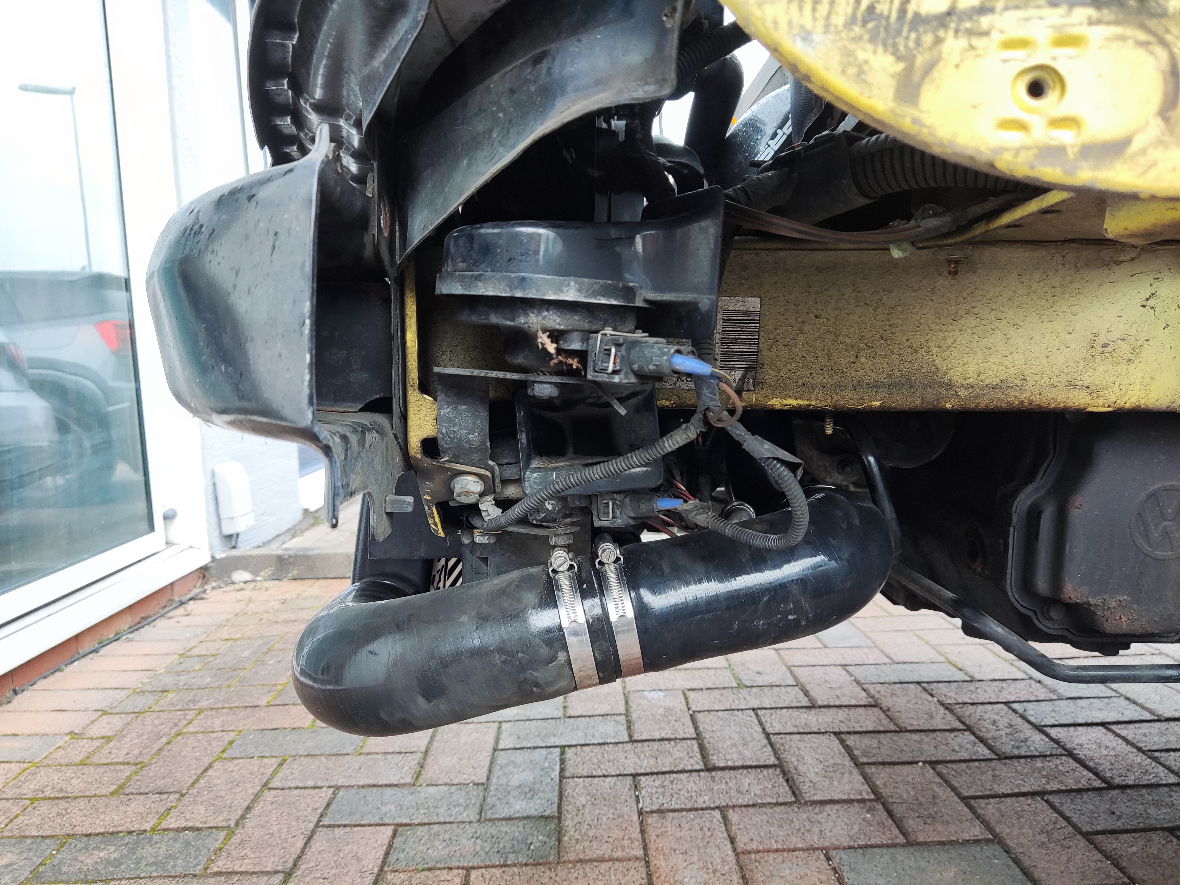

    I had to trim the new turbo outlet pipe by 40mm each end, duct tape happens to be the correct width I cut down the original dump valve hose and managed to get it back on the dump valv

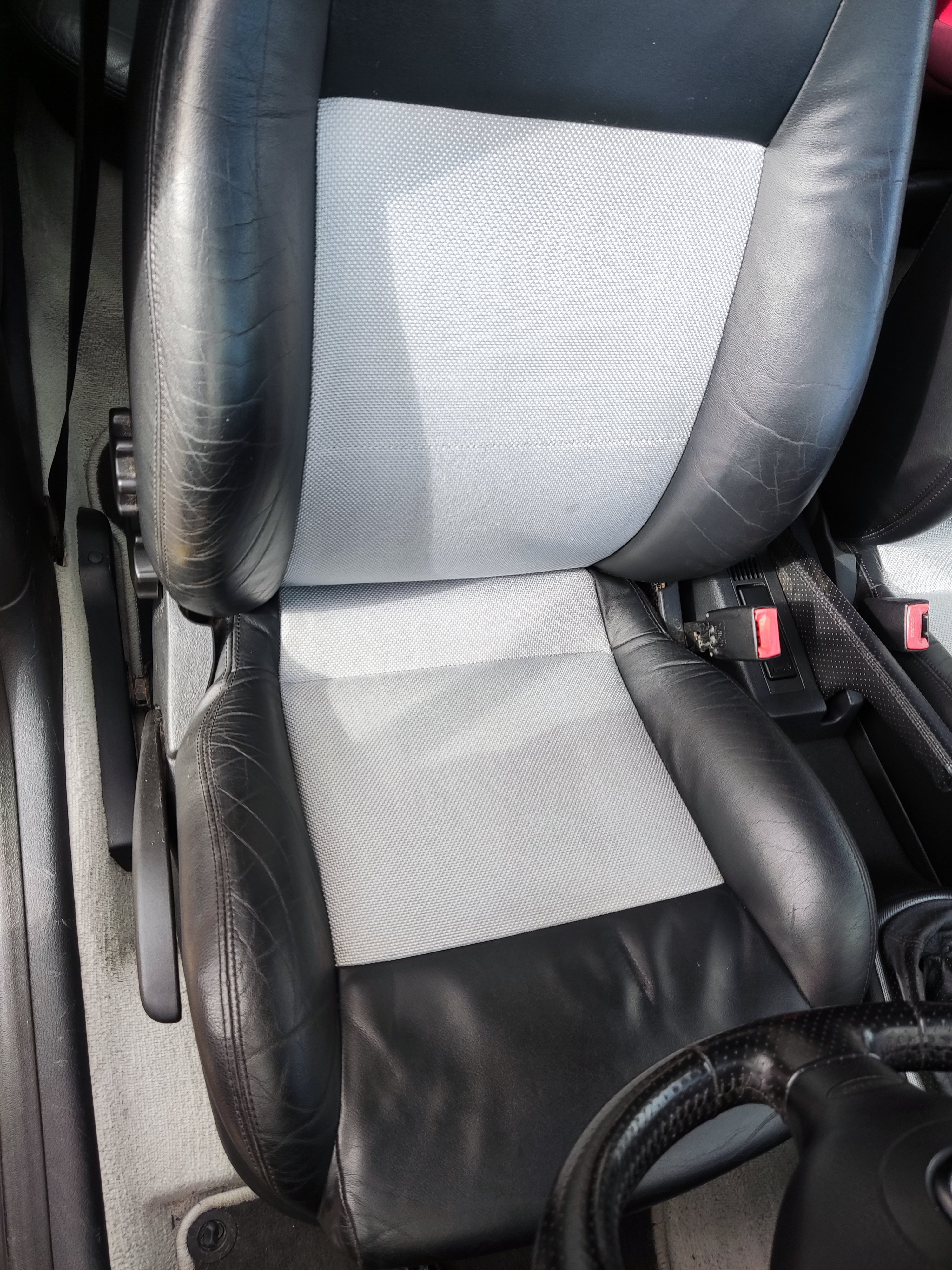

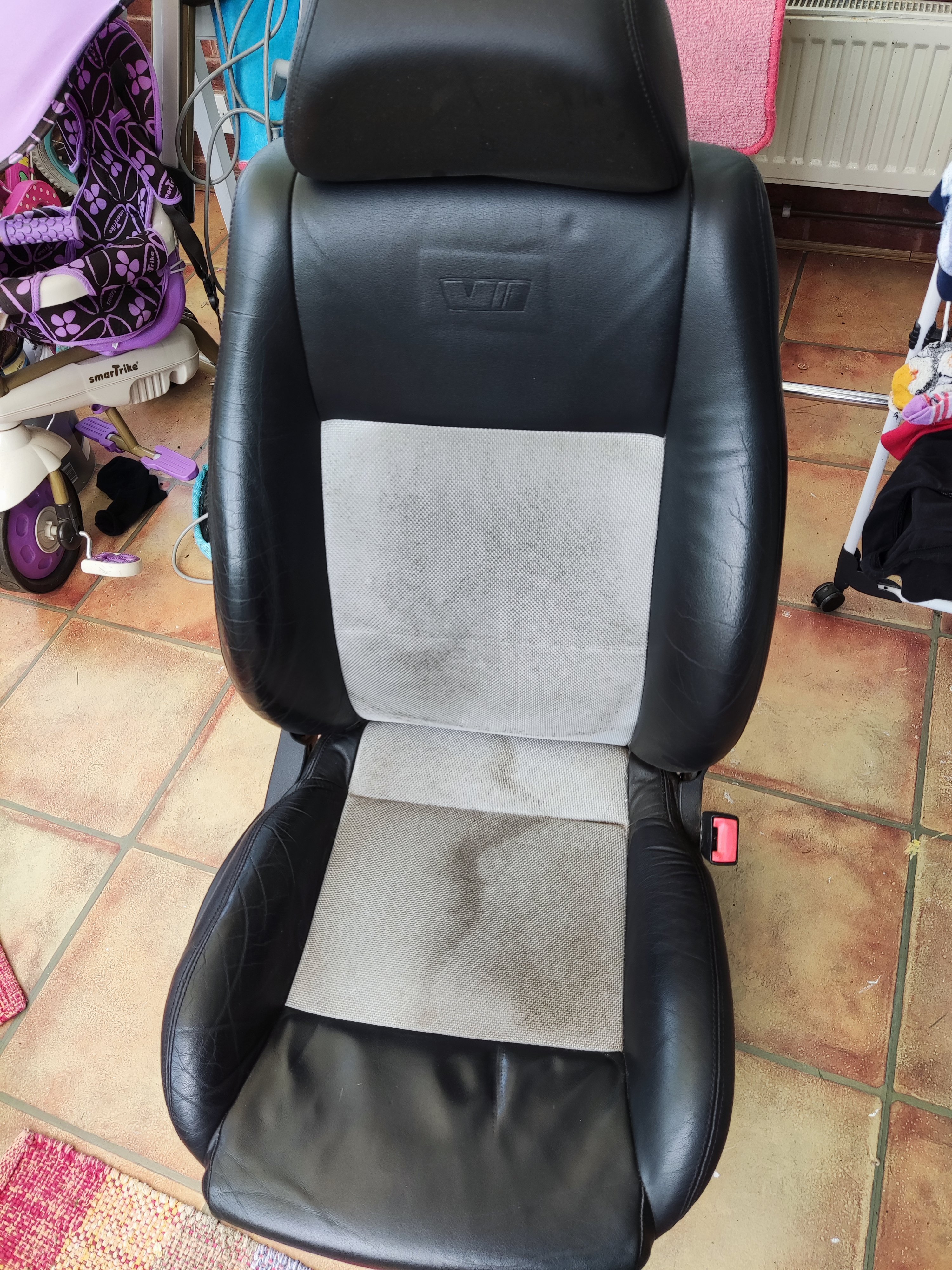

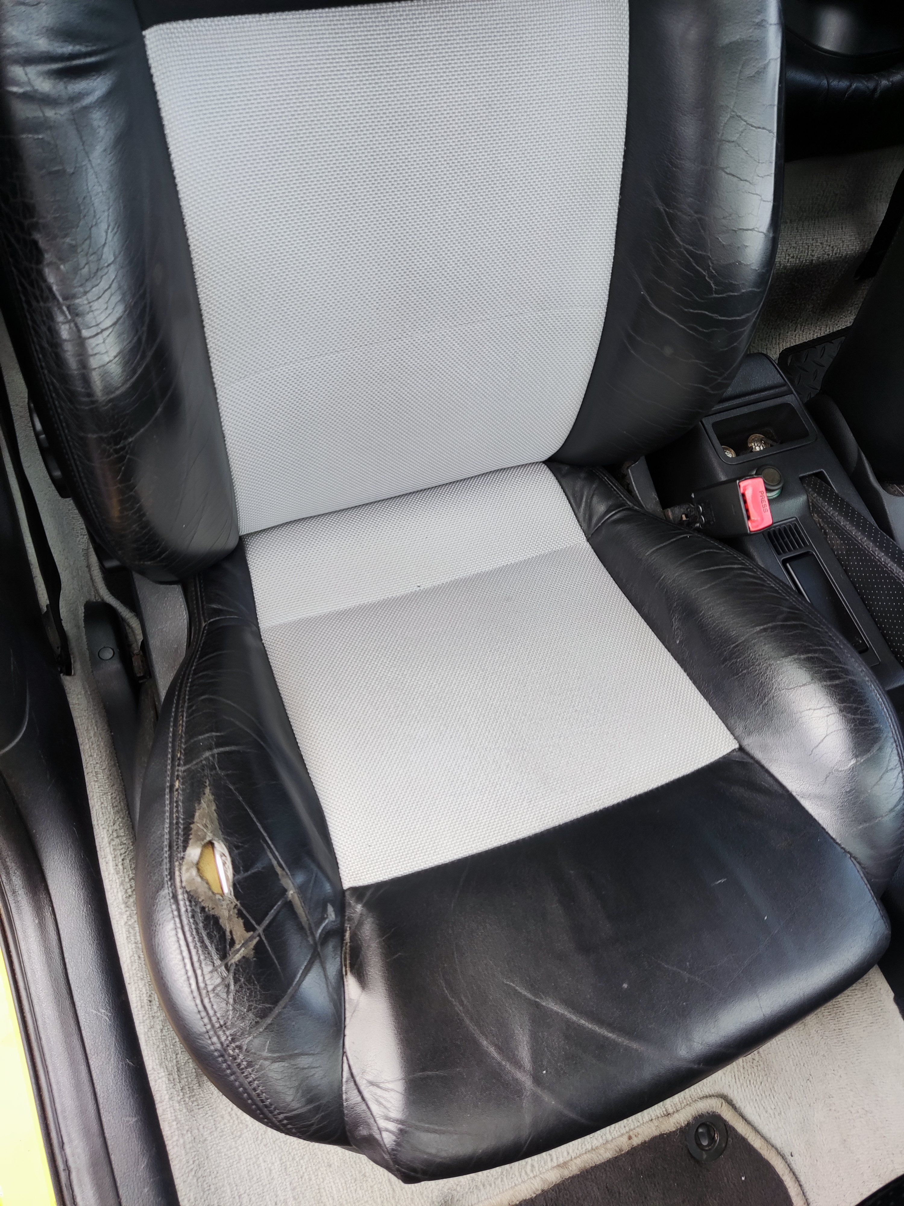

    Saturday afternoon update, I've clean the seats. The driver's being the worst now looks like something you'd consider sitting on.

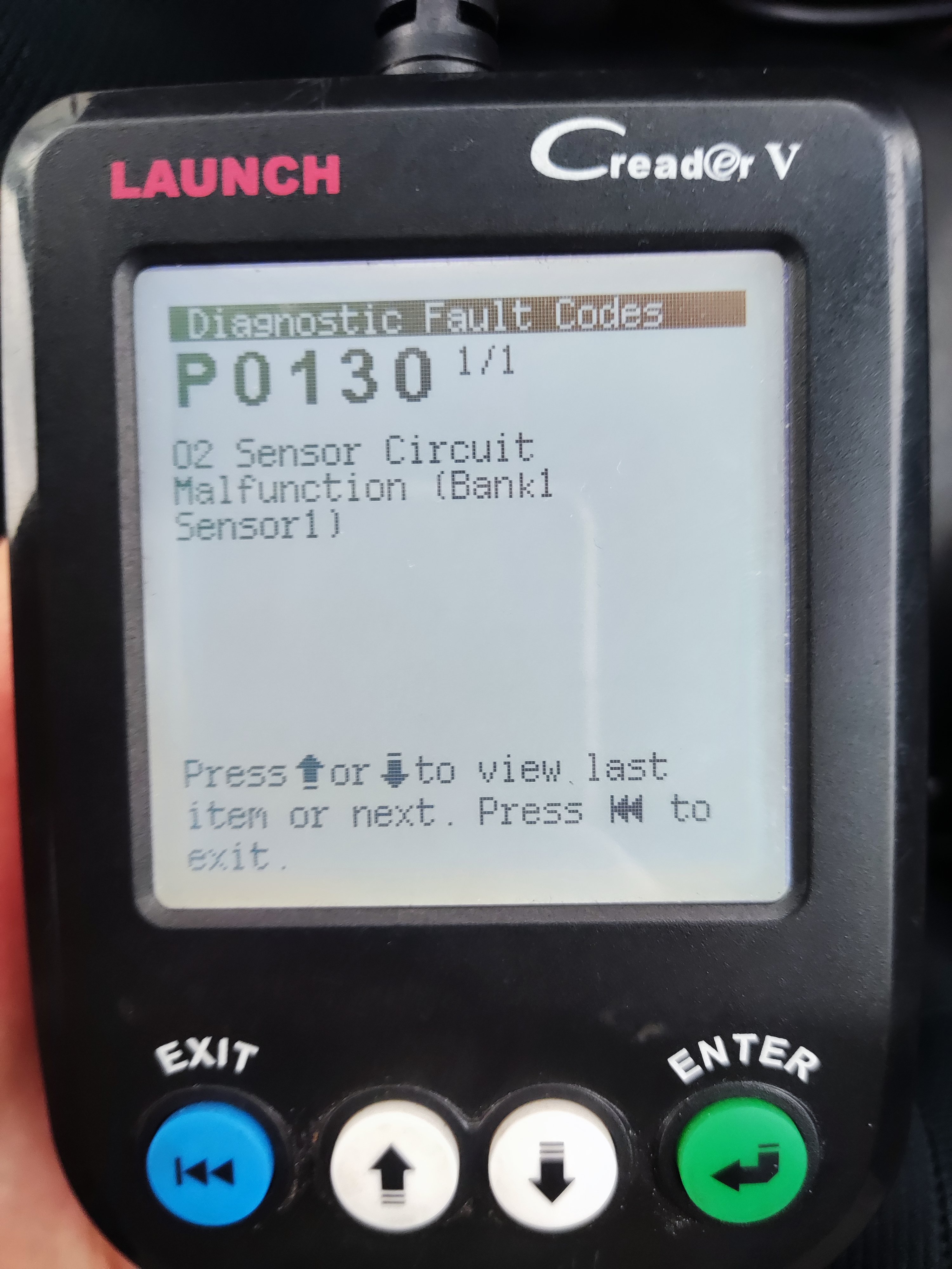

    It has been a while hasn't it...hello again.   Where I left off with an o2 sensor fault, I bought a new Bosch sensor and that was sorted.   I've done a few bits and pieces over the

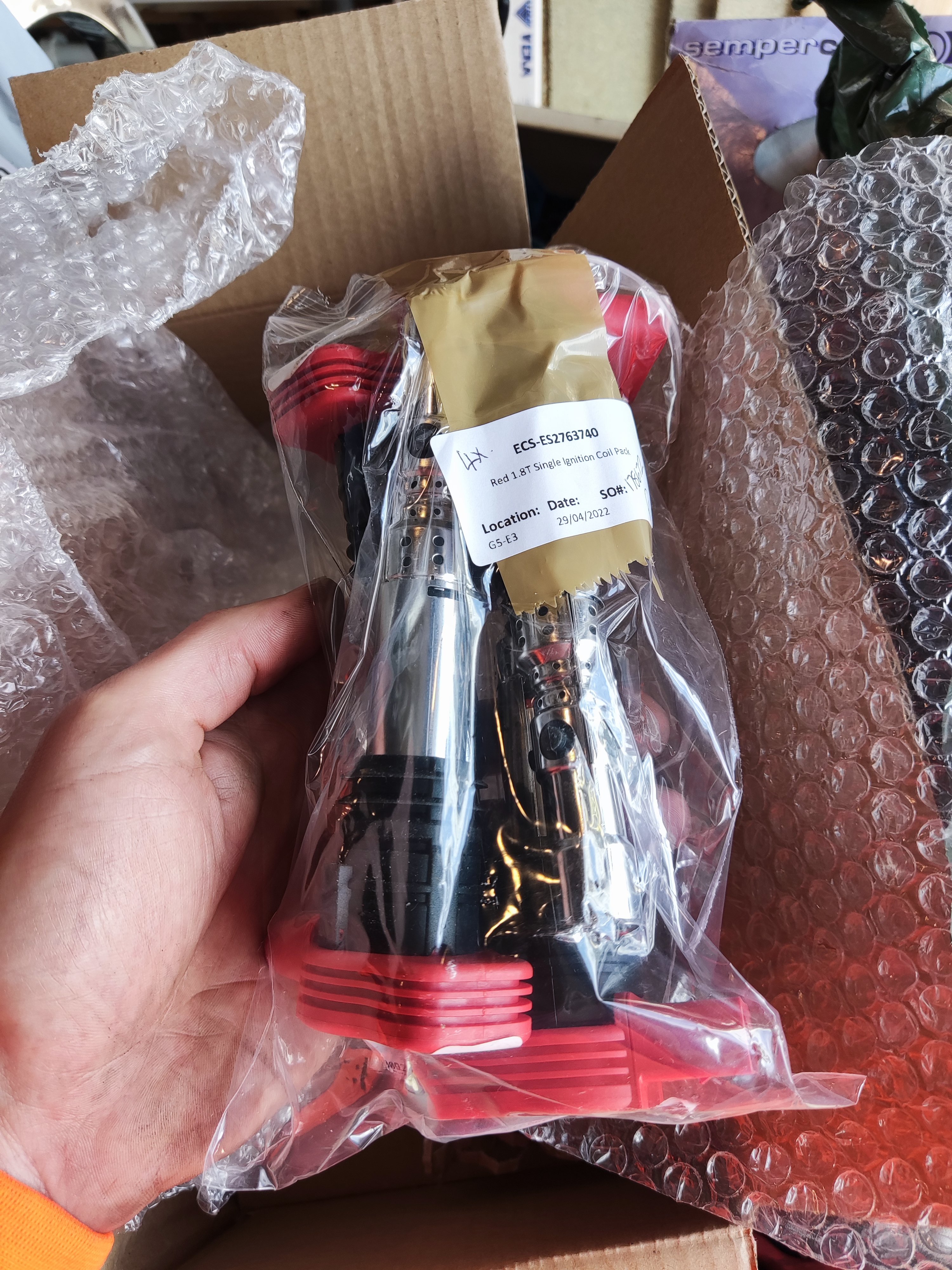

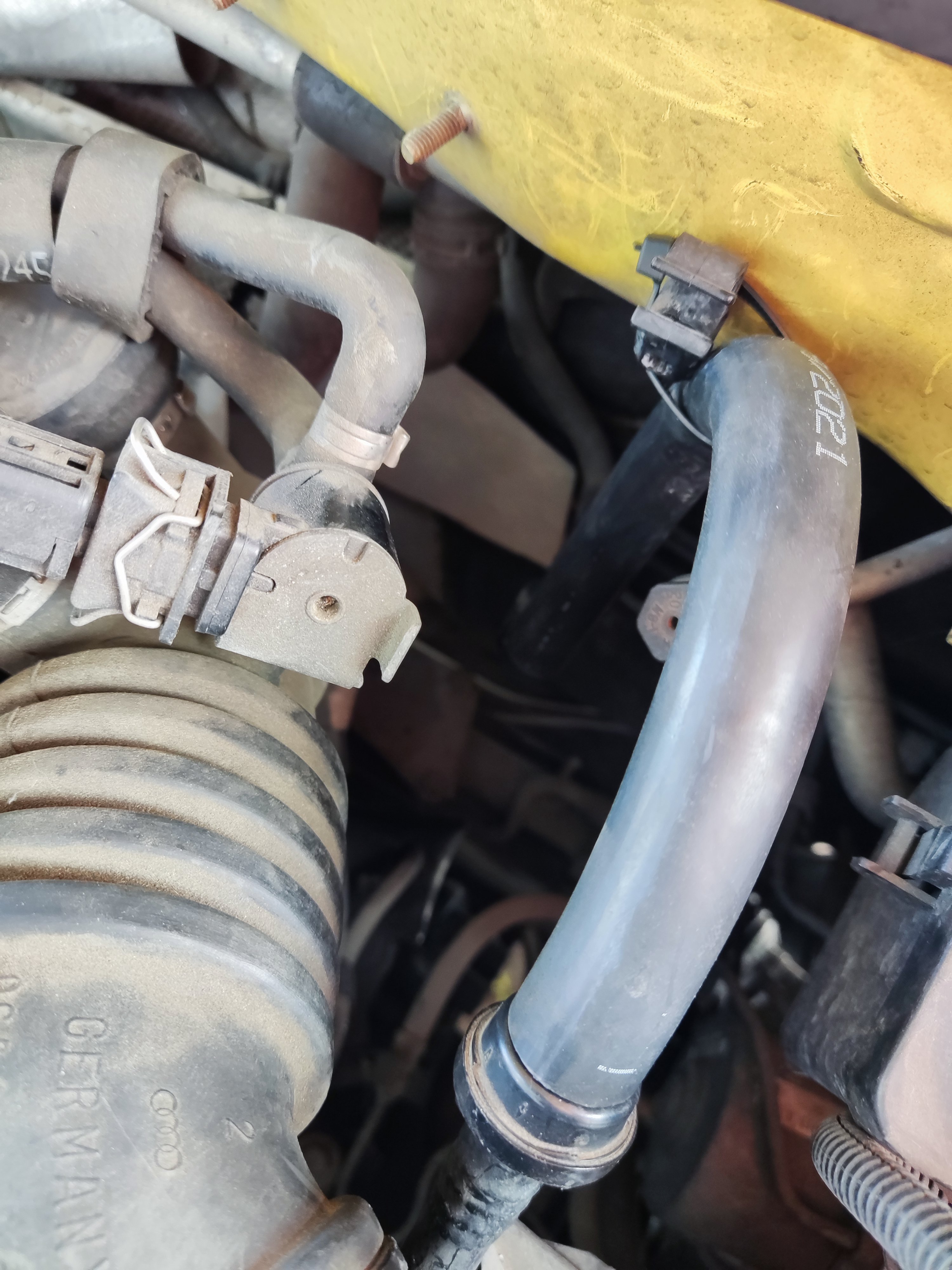

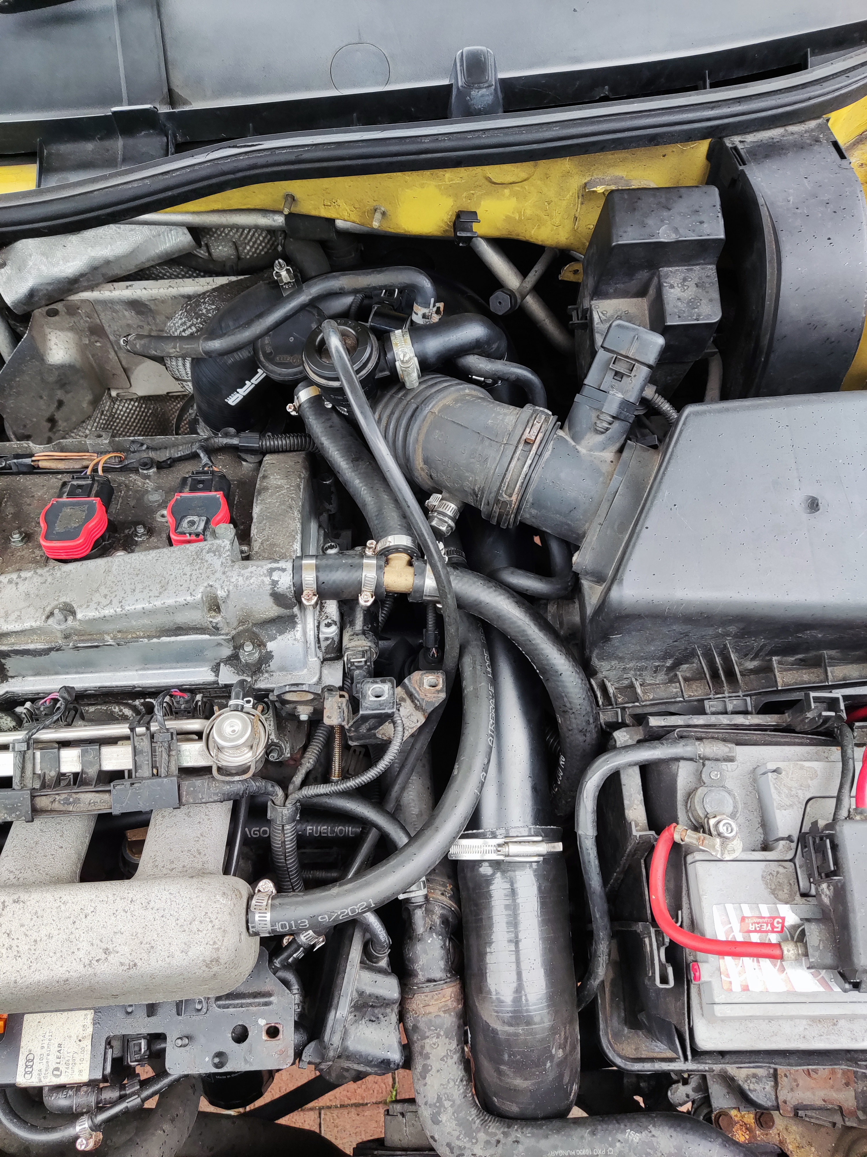

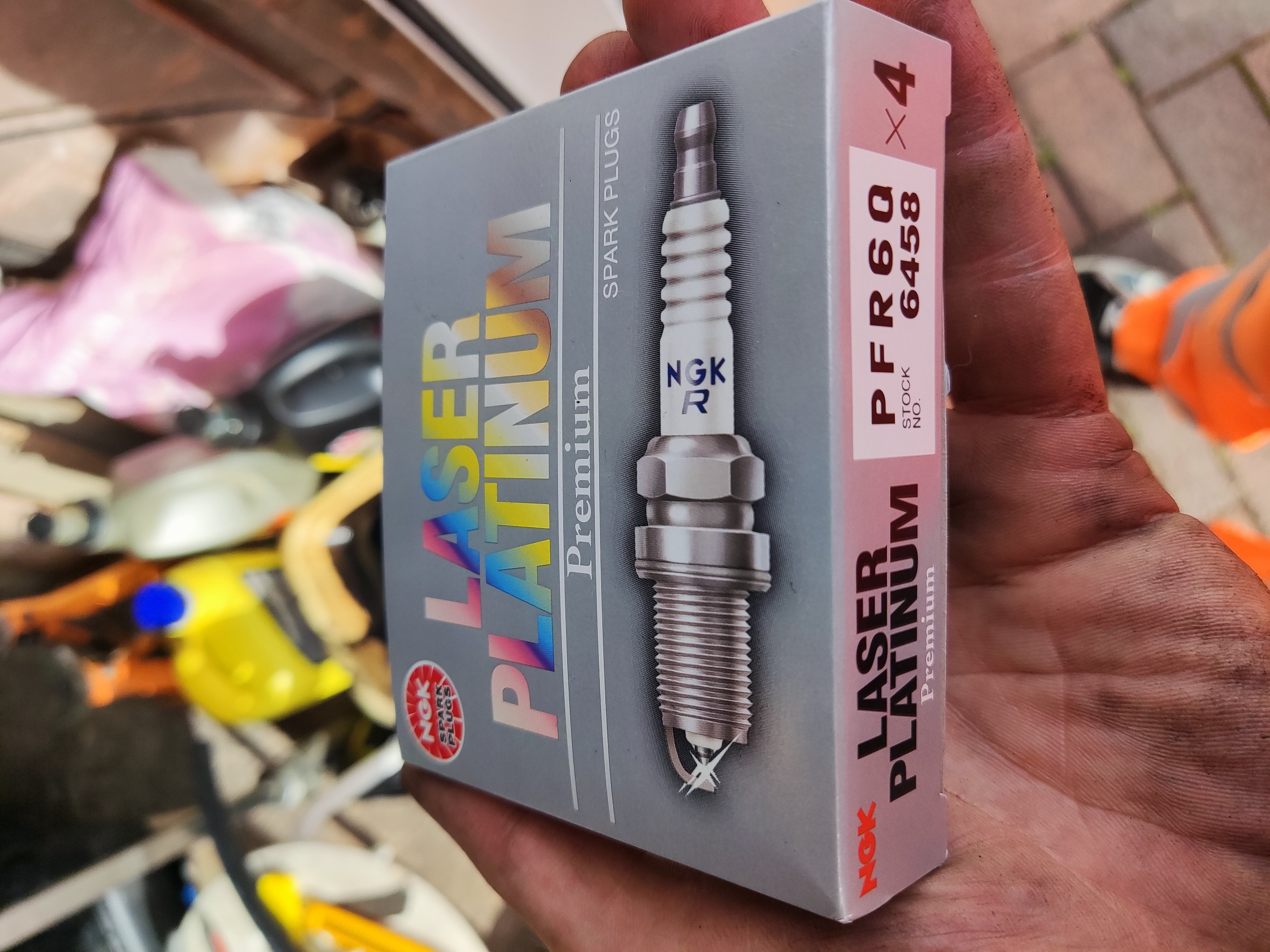

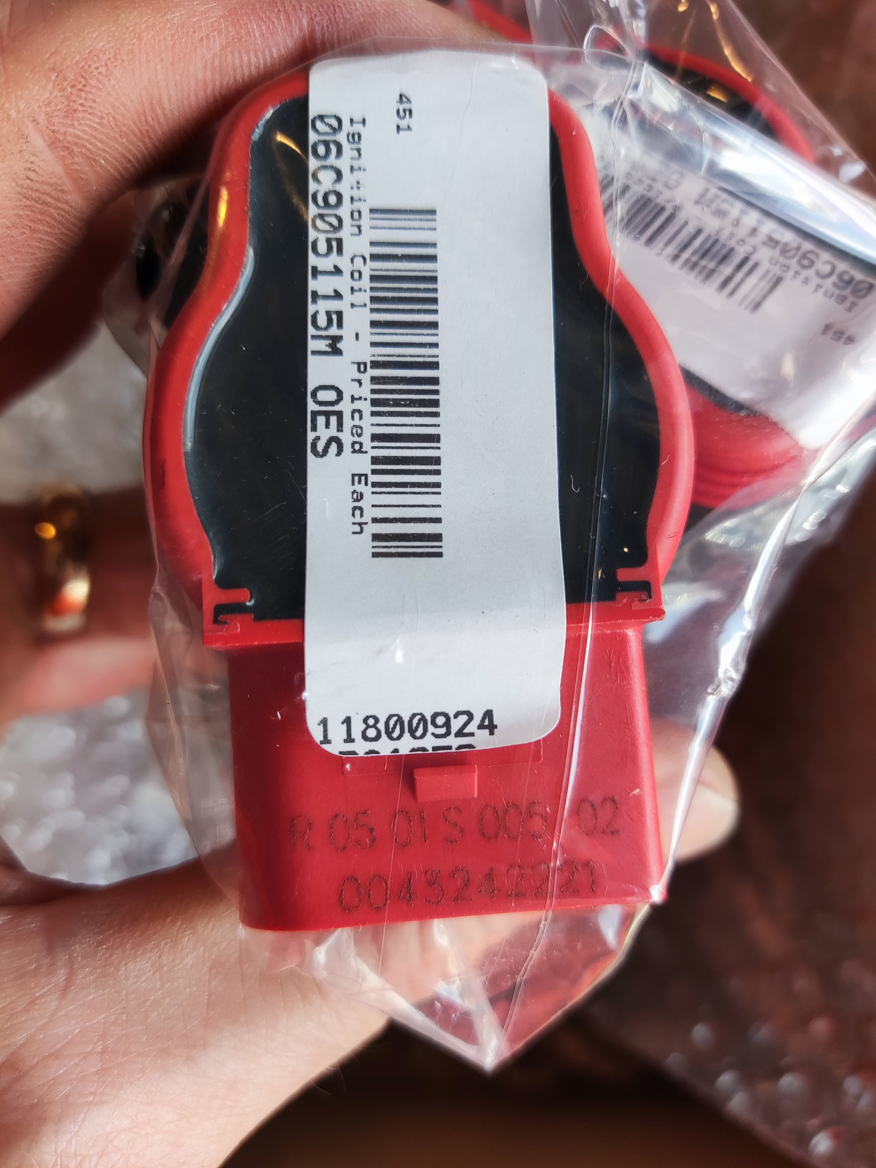

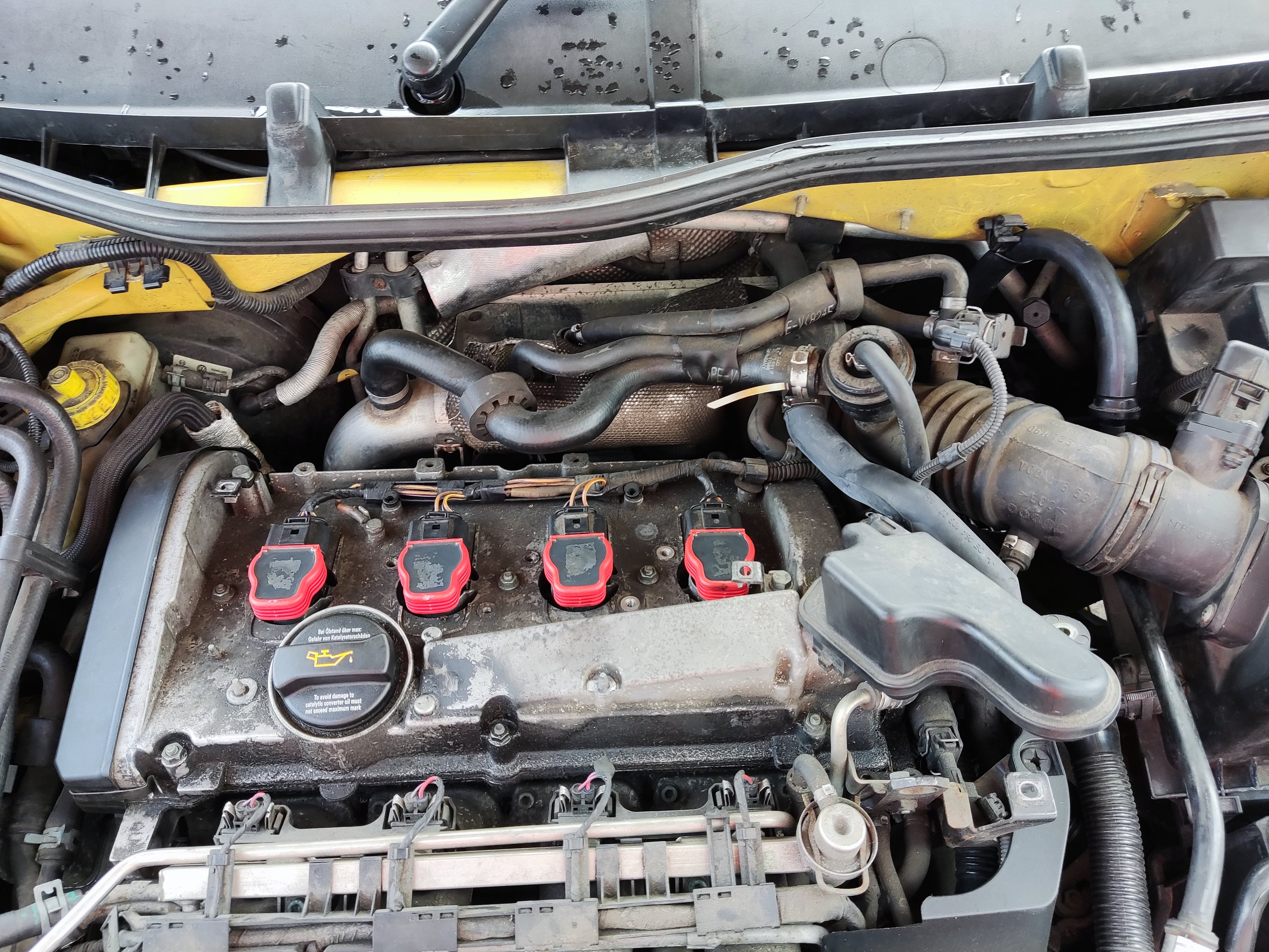

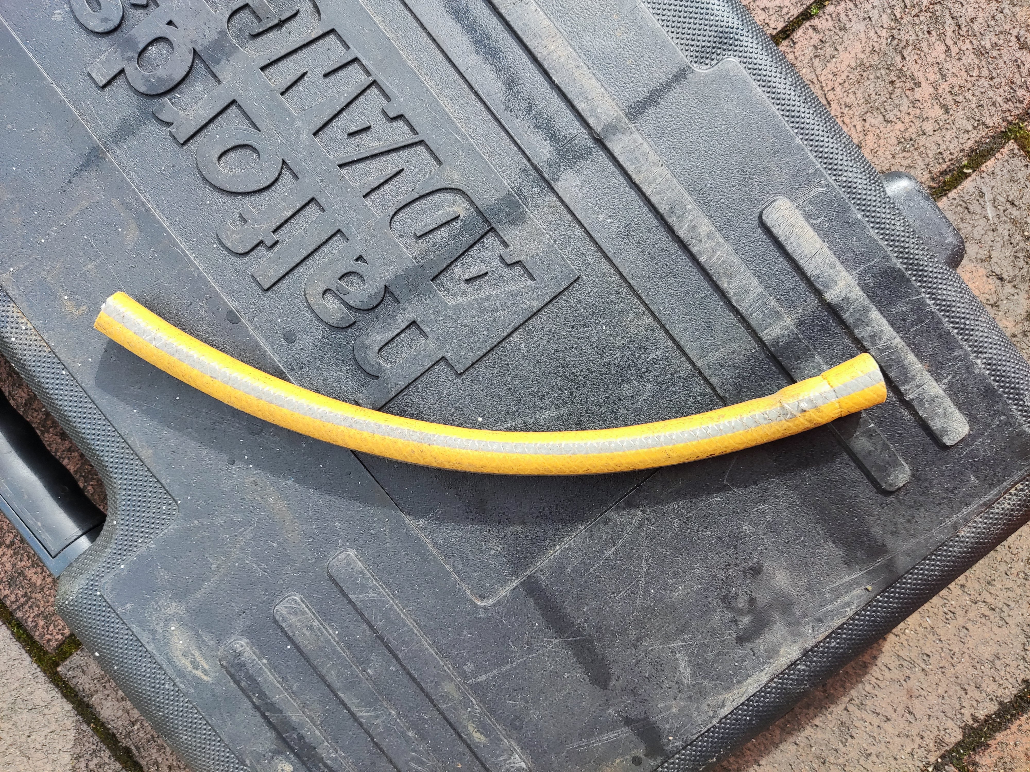

I had some parts arrive, new coils from awesome GTi and vacuum hose for the brake servo from eBay.
The brake servo vacuum hose is 1/2 inch so slightly too big so I wrapped electrical tape around the fittingsIMG_20220504_160137.thumb.jpg.306906a6385da9fdd3fc486ef1ffd396.jpg
a couple of layers had the pipe fitting nice and tight. I put a cable tie onto the bracket for the old pipe the stop it rubbing on anything. This isn't the ideal fix and I'll probably change it when I do all the deletes but for now its not leaking from a split hose so it's good enough.
IMG_20220504_155359.thumb.jpg.fdd9fc45444fa28bc2659b41c05772bc.jpgIMG_20220504_155410.thumb.jpg.8ae4f1e7d84e6fed14b7dc8ef8fa71f6.jpgIMG_20220504_162016.thumb.jpg.829a6a3c18c927ba137afaf39f6e15cd.jpgIMG_20220504_163442.thumb.jpg.3bd46a37a5e47e402022360e564d3046.jpgIMG_20220504_163430.thumb.jpg.052851ce68c600c0587578f8f2637fd8.jpg

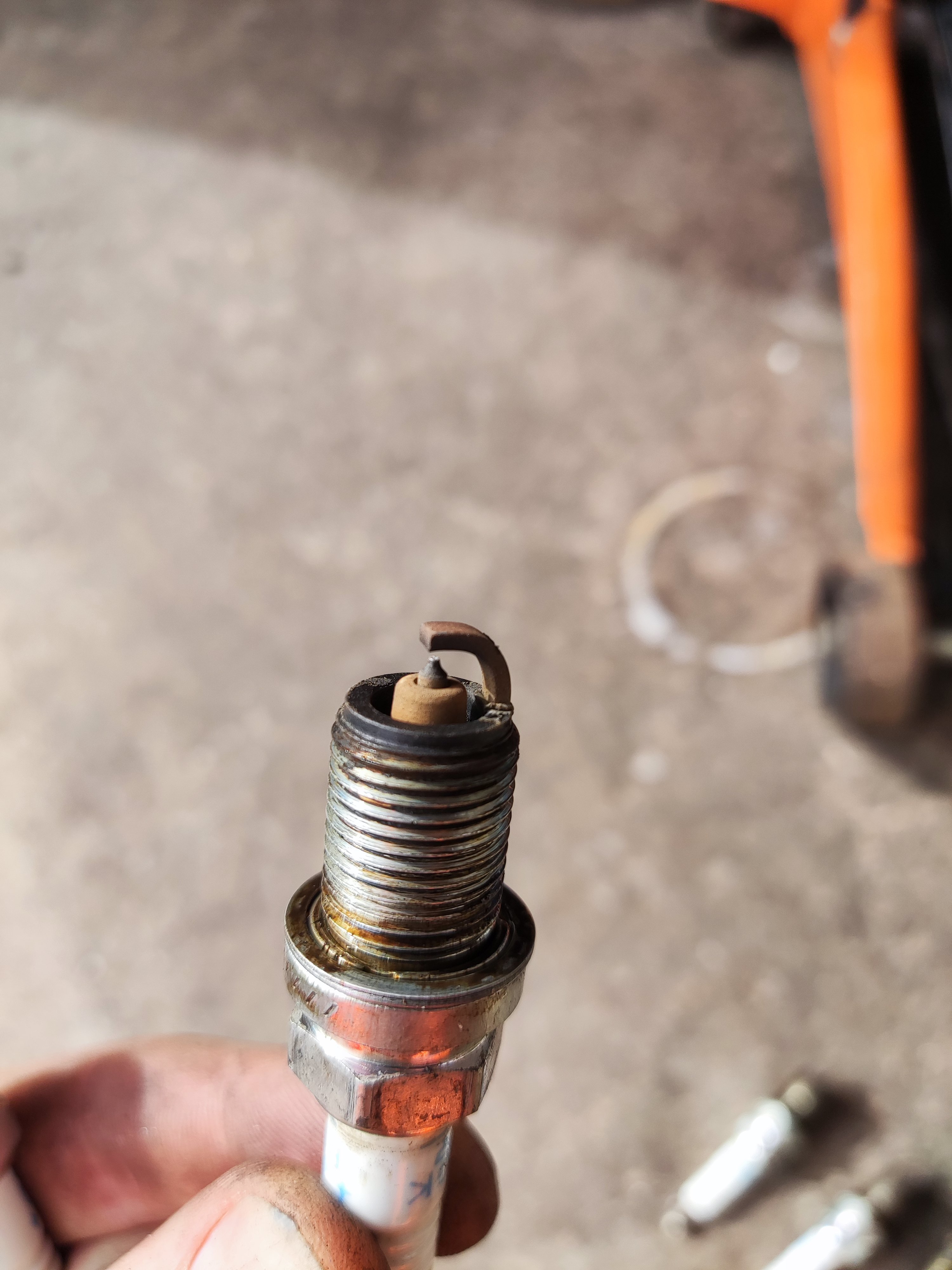

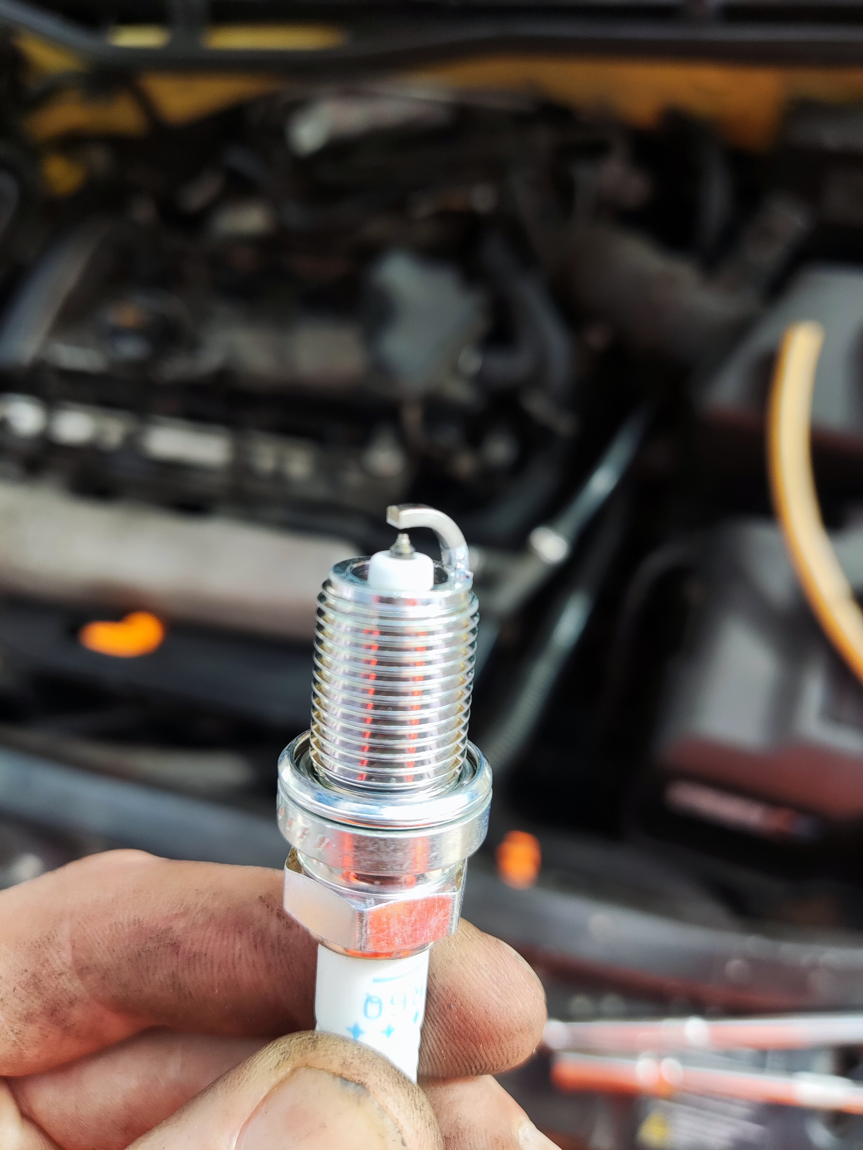

got some new standard plugs to go with the new coils. I had to make a new spark plug insertion tool because I've lost the old one I had, a length of hose pipe is what you need.IMG_20220504_163726.thumb.jpg.4baa14041e93c7830d18486fb84f7120.jpgIMG_20220504_164037.thumb.jpg.c56a58db3c8b0ccebd2e5fc04183c3c6.jpgIMG_20220504_164456.thumb.jpg.3fb5eface0f6a8b02b0d3af8661b1da3.jpg
got the new coils in cover back on.

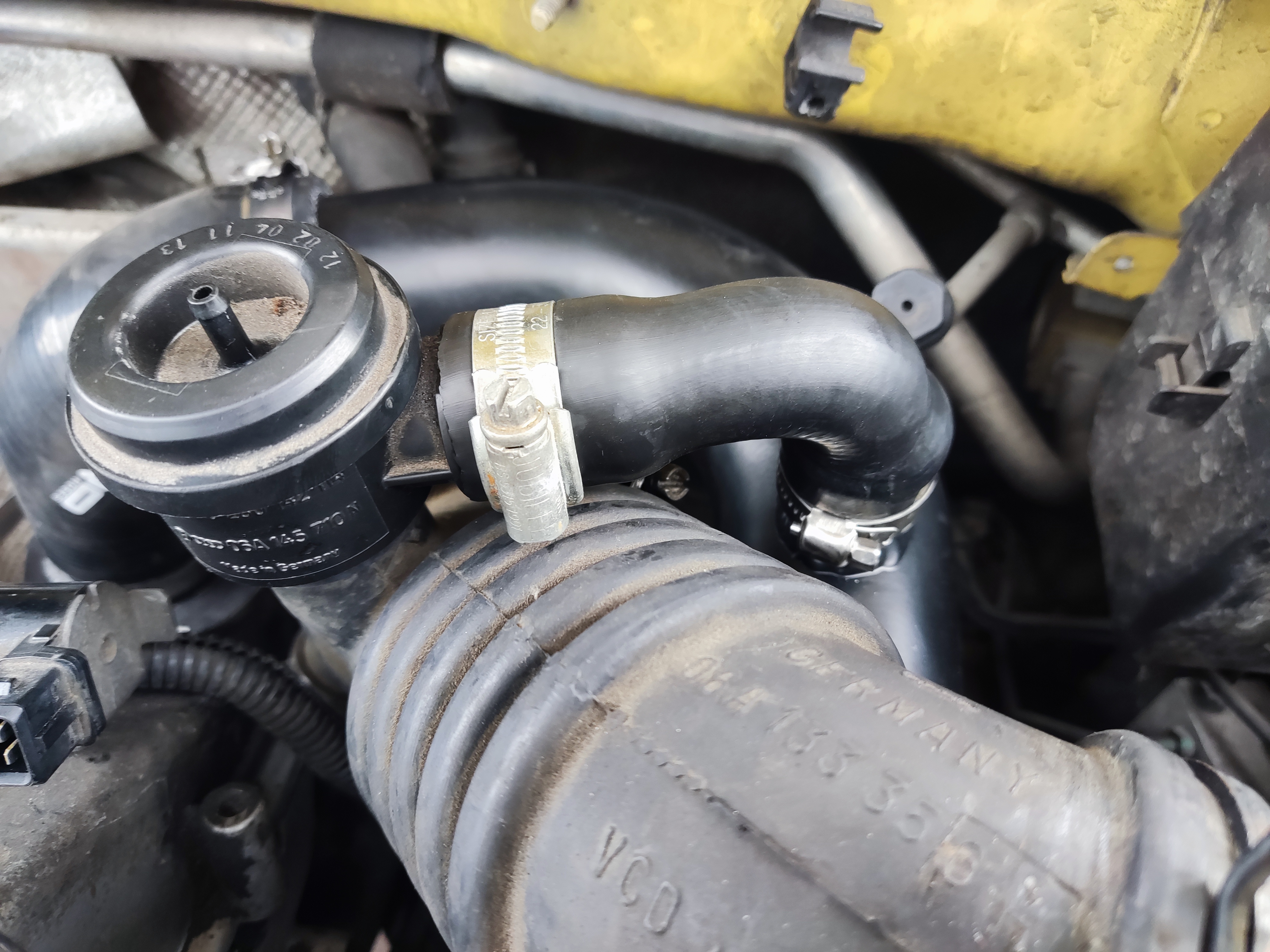

I've been on a drive hoping there might be some improvement but the car still gets to 3000rpm and seems to reduce the boost. If anyone can shed some light on what the cause may be I'd appreciate it.
I've noticed that when I come off the throttle suddenly it makes a whoosh sound like a dump valve, not sure if a standard car should do that. Maybe it shouldn't and there's a problem with the recirculating value. Maybe I have an issue with the boost control valve...

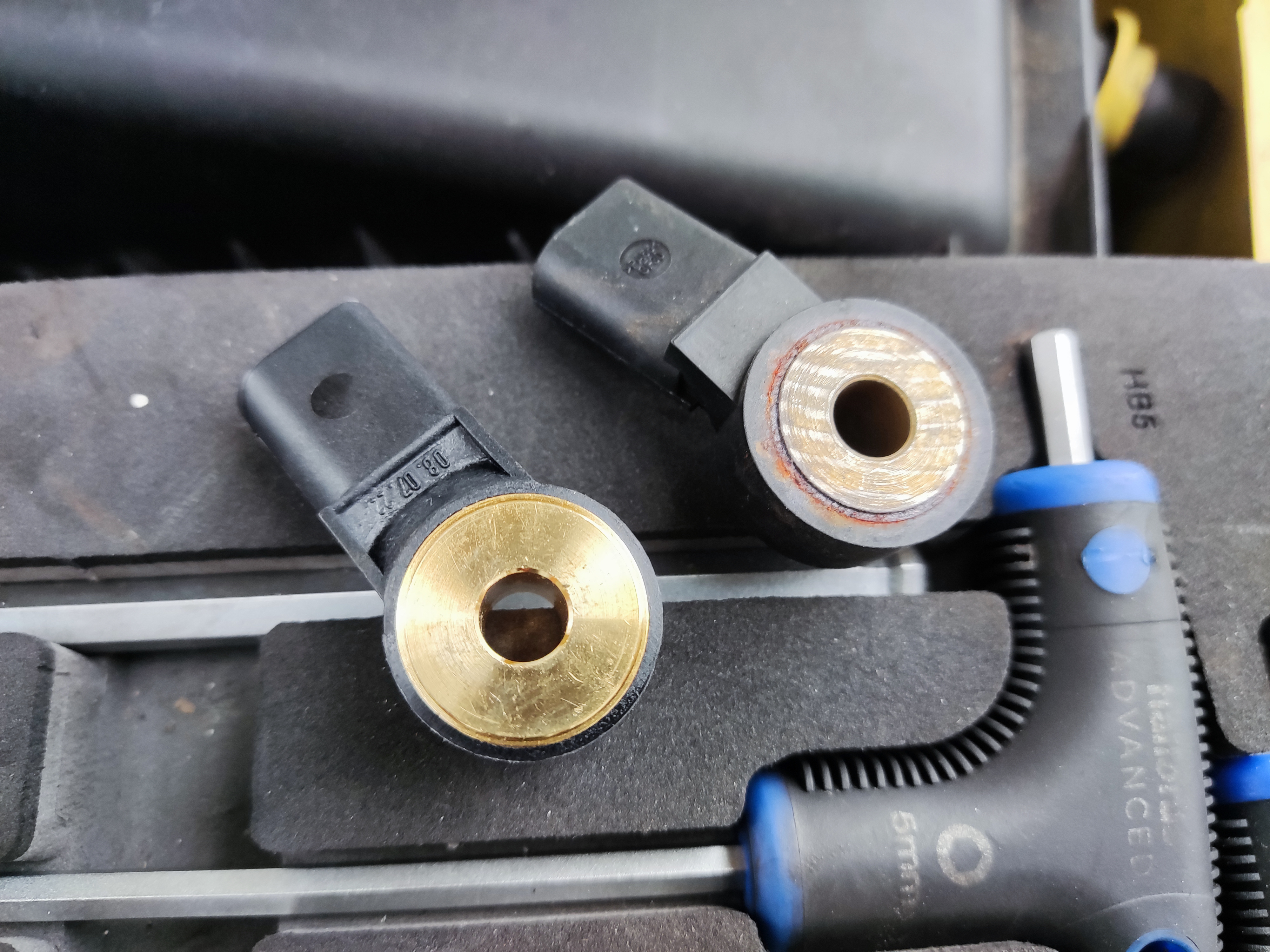

An update about the boost issue, I've done data logging with visual me7 logger and I have found that the car is over boosting between where the boost starts coming in and 3000rpm then it falls back and follows the requested boost. More diagnosis is needed but that can wait.
I've got some other things sorted, picked up a decent driver's seat from a breaker and cleaned it upIMG_20220611_162204.thumb.jpg.f8c4f10129b1fe4f3371b0adf7a7833e.jpgIMG_20220611_170722.thumb.jpg.309bba19d8cb96c421f7921de1cc8e71.jpgIMG_20220611_173908.thumb.jpg.a66eb3e271e64ad56469aeaf6c42b4ee.jpg
the car looks loads better just changing the seat.

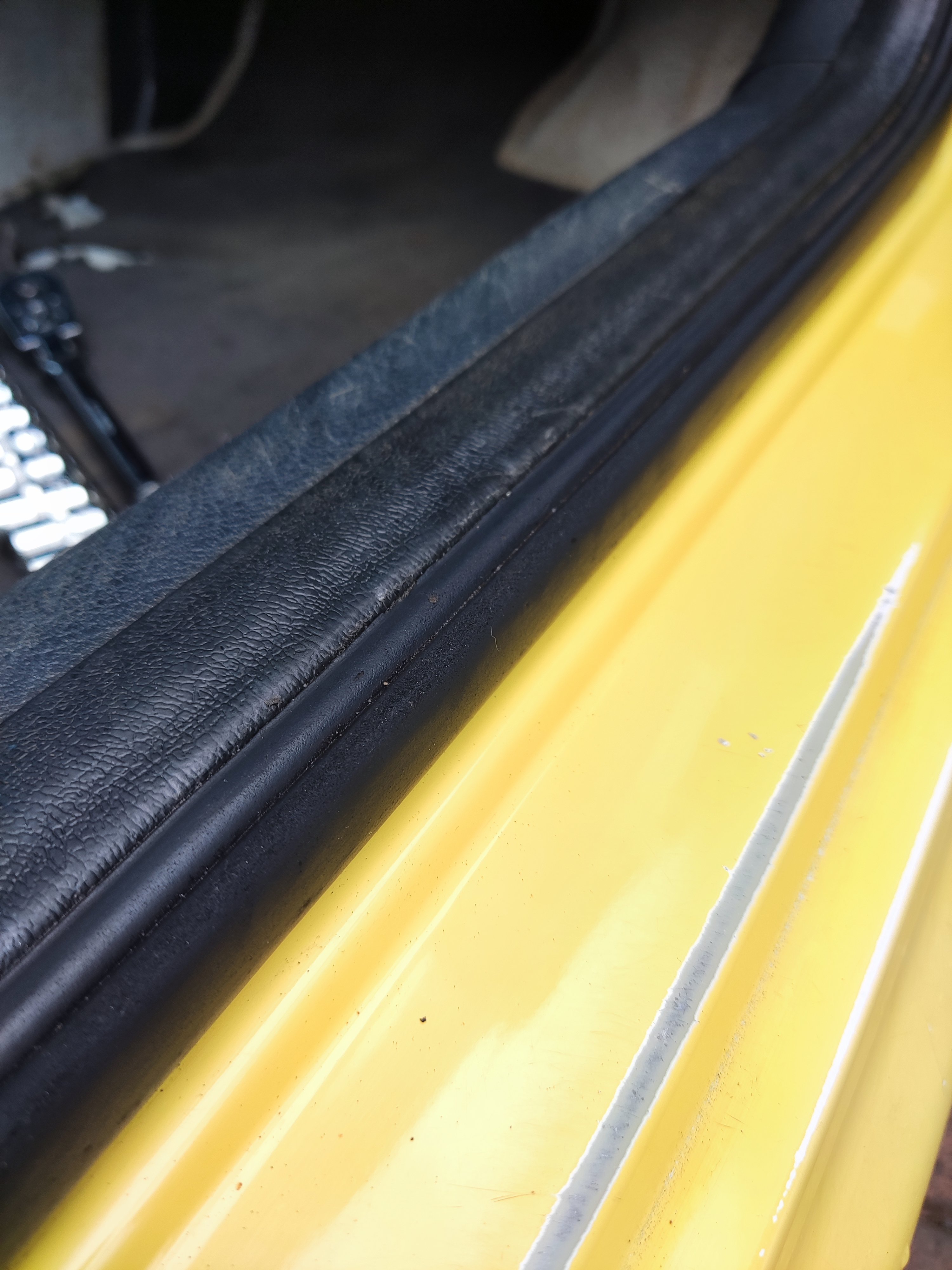

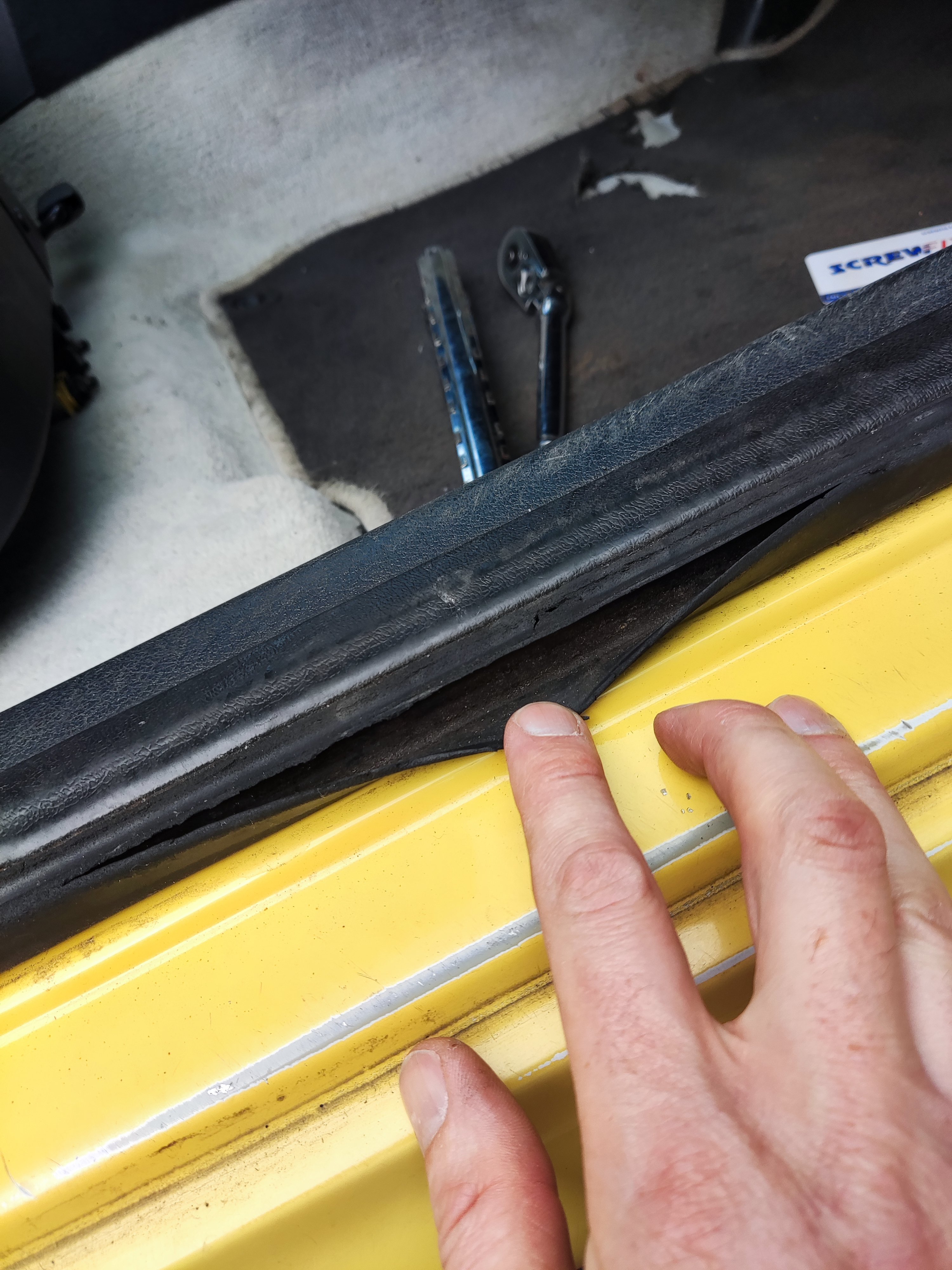

Picked up a door seal too
IMG_20220611_170732.thumb.jpg.af9fe82ba79c2cd870a84a86460ee235.jpgIMG_20220611_171357.thumb.jpg.c2d1401b0ceb4a4e039f5855c8039522.jpg

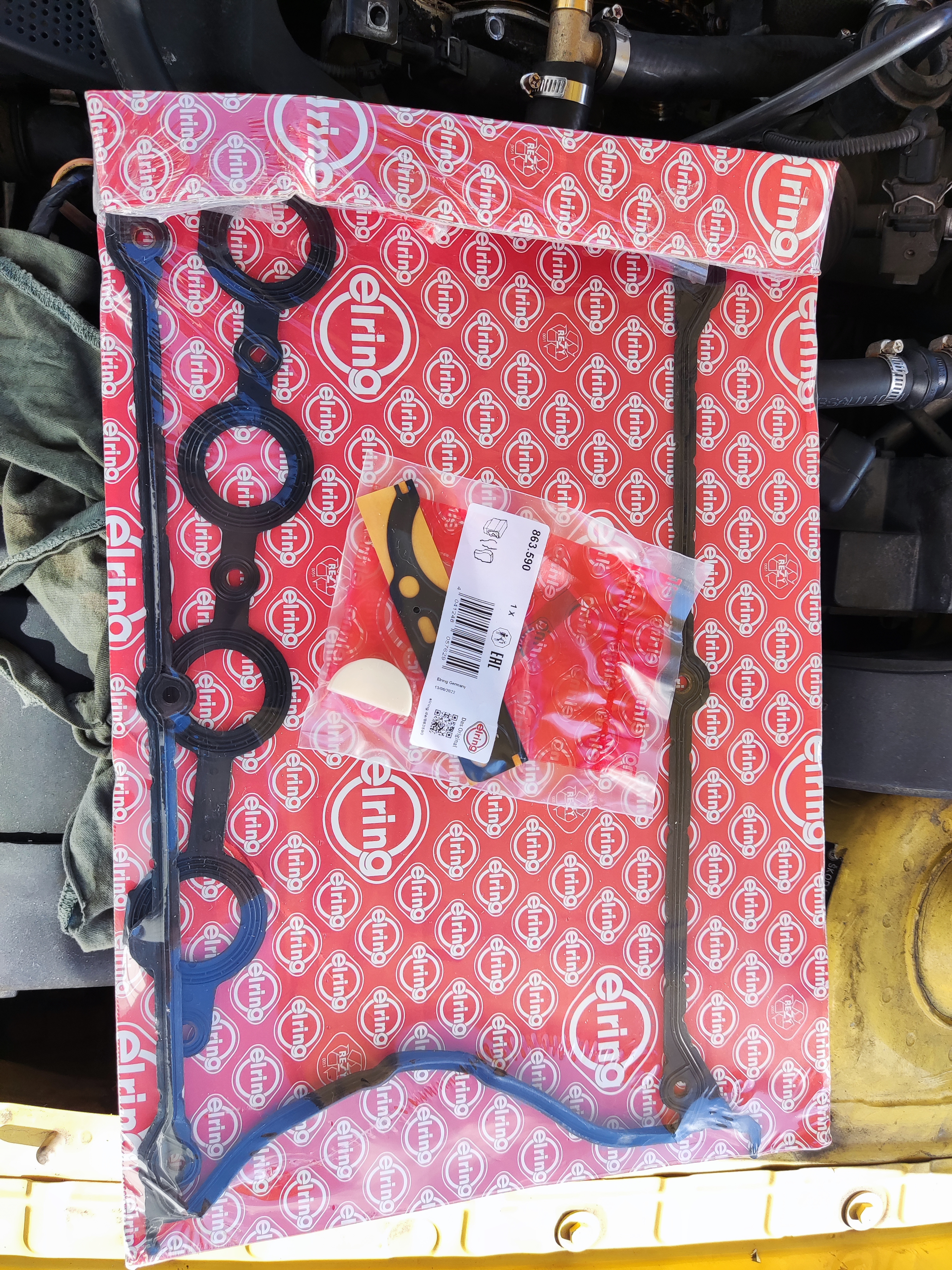

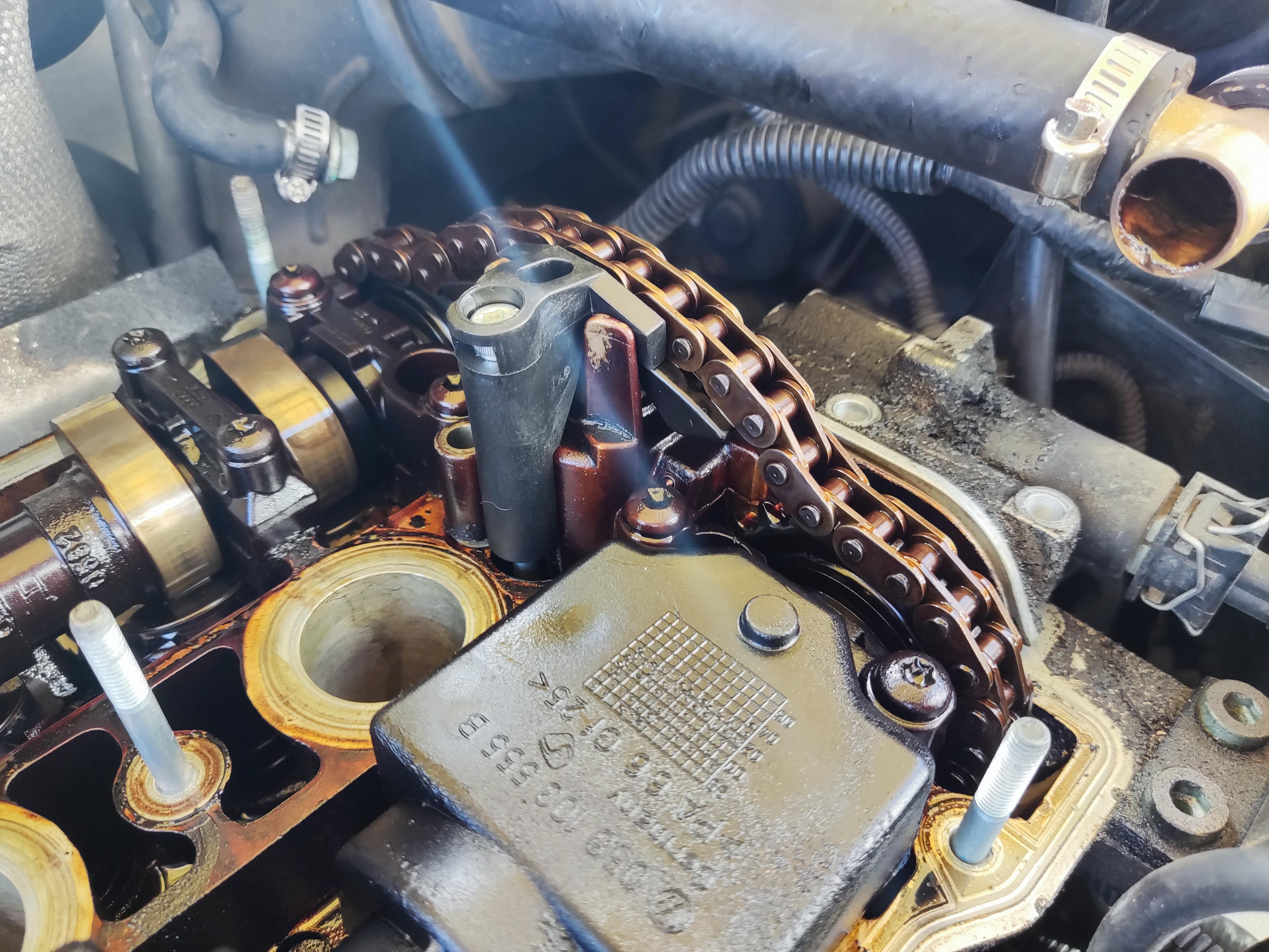

I've been thinking for a while that there was a lot of slop at the engine so I've rebuilt the dog bone with poly Bush's, it's loads better now.
IMG_20220612_091203.thumb.jpg.f6e5a299fca42765a4d48b34f4868a33.jpgIMG_20220612_091354.thumb.jpg.c5497bd3c2452a7b63caab4088725984.jpgIMG_20220612_091403.thumb.jpg.1dcd7e1d26c534a458360ce3e486b3bb.jpgIMG_20220612_095614.thumb.jpg.2bcf26849805ce8e9573a511c109f3b4.jpg
That's it for now, the boost issue is next, I'm thinking it might be a boost/vacuum leak so I'm tempted to do all the deletes. I'm thinking of getting/making a boost leak tester as well though so maybe I'll do that first and see what's going on

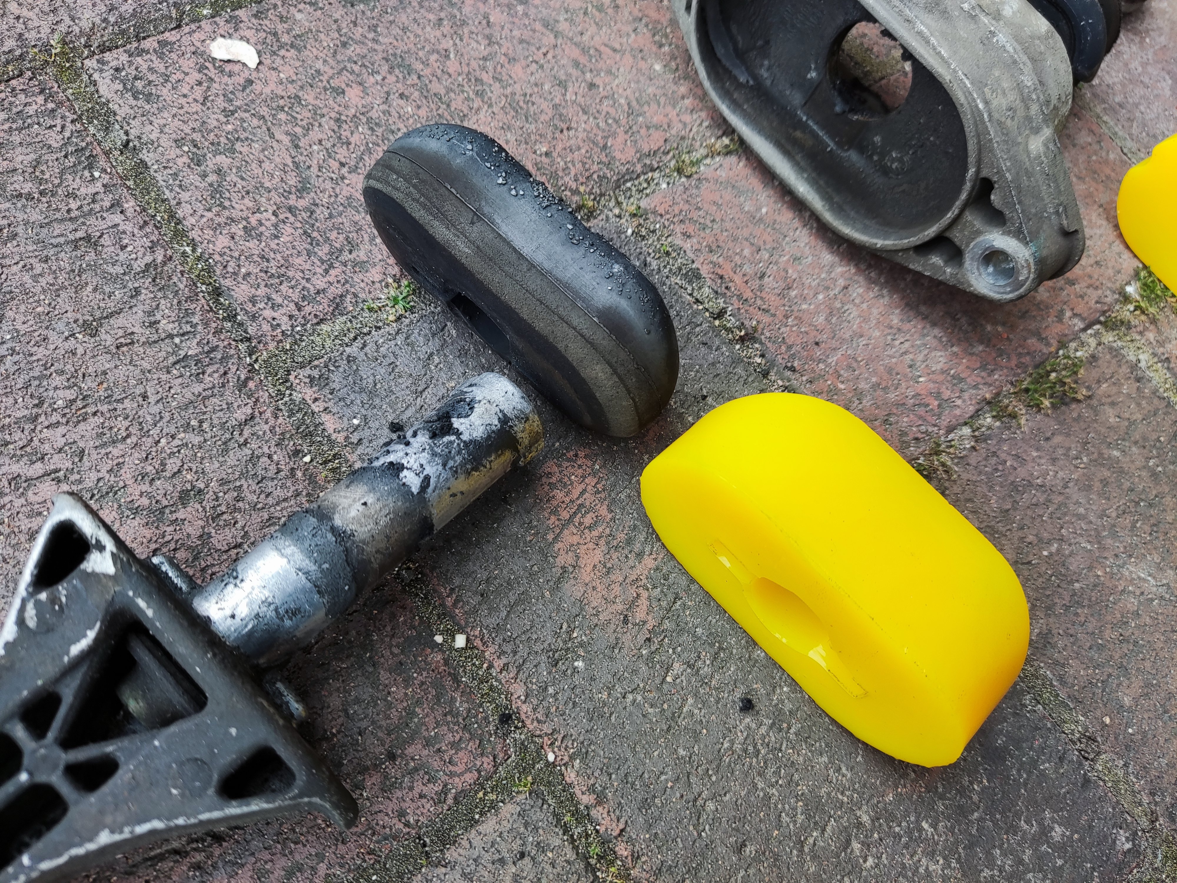

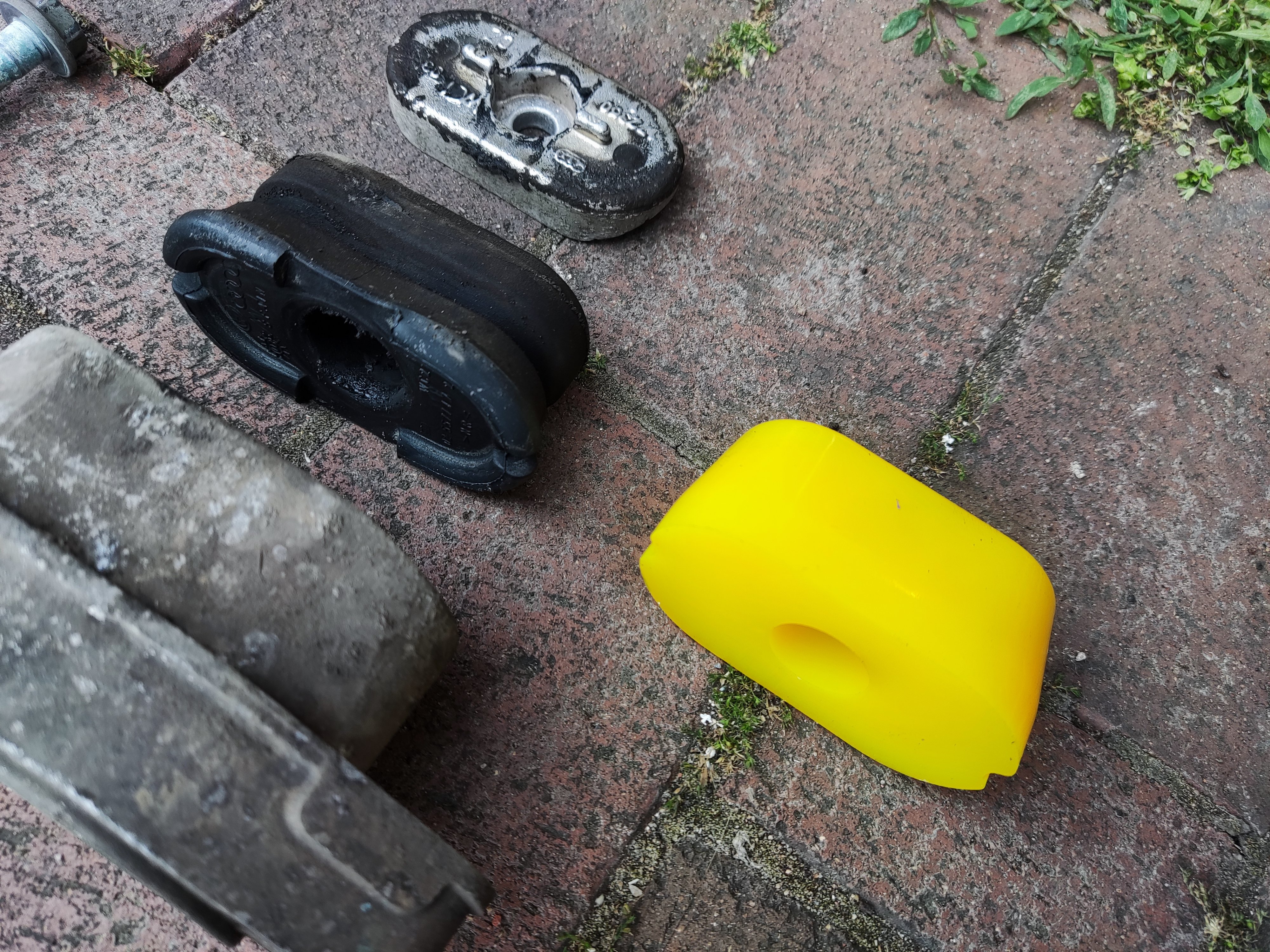

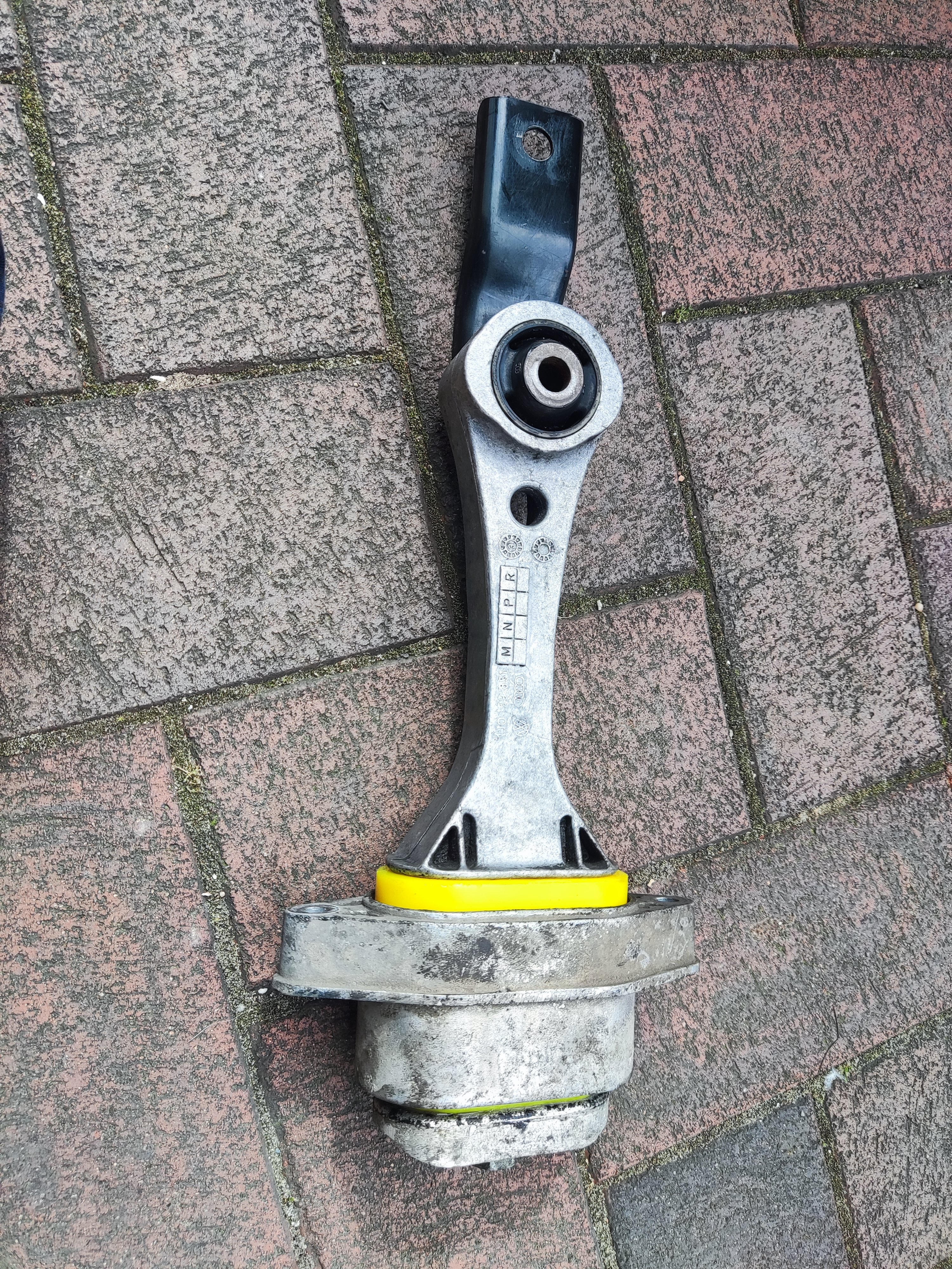

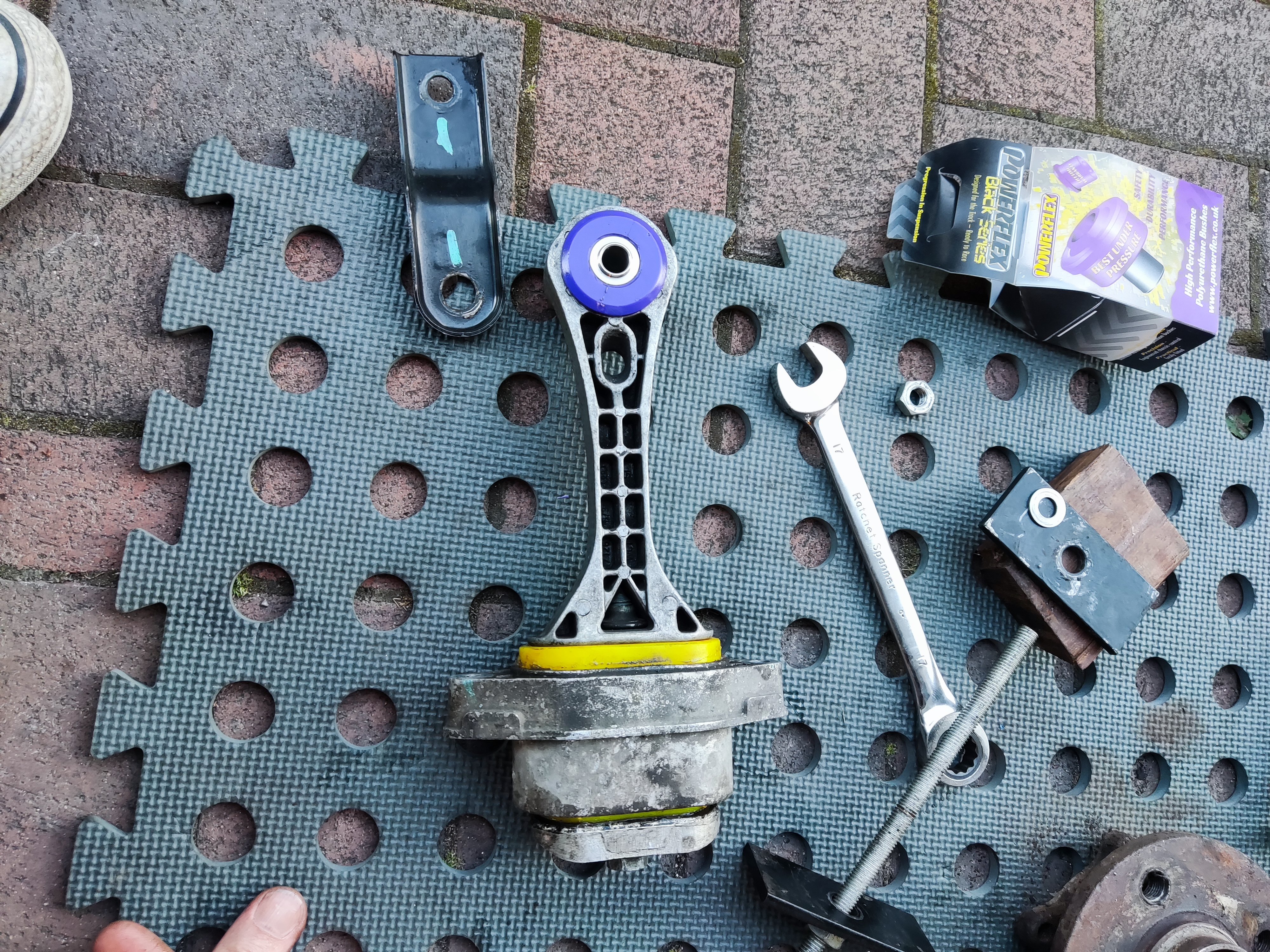

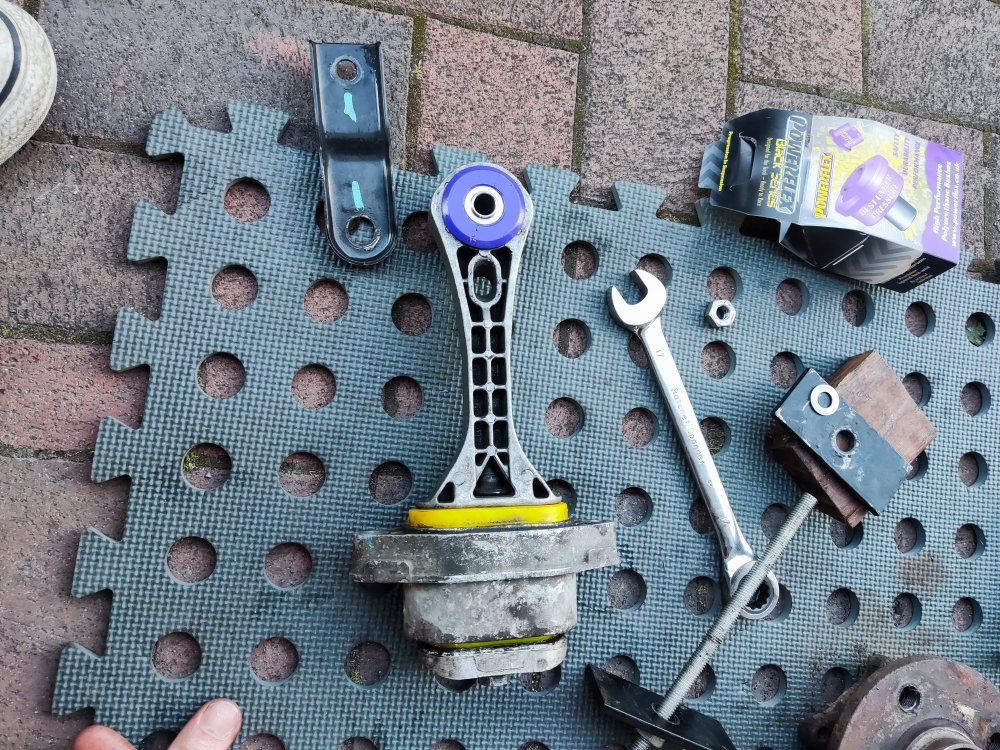

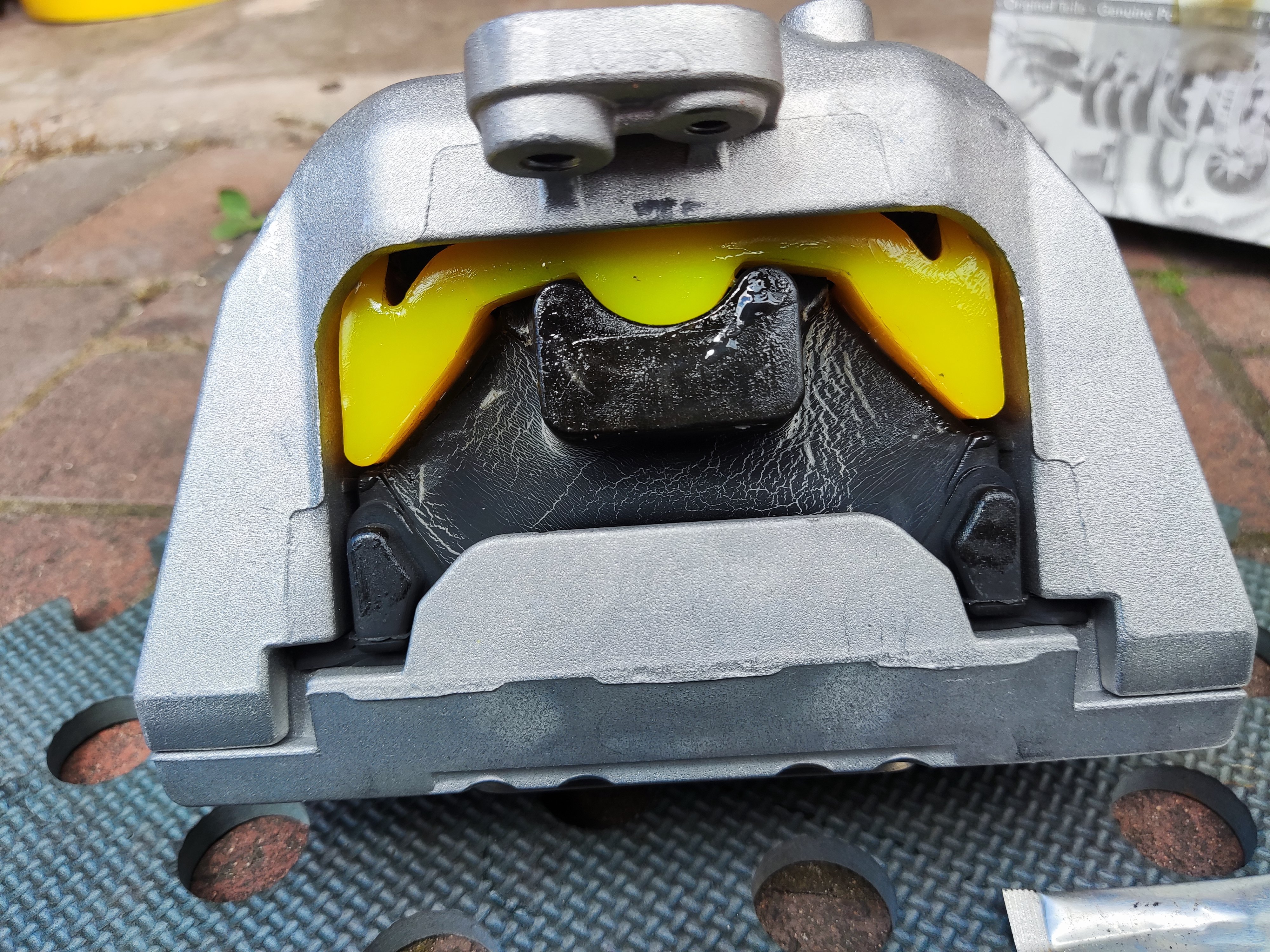

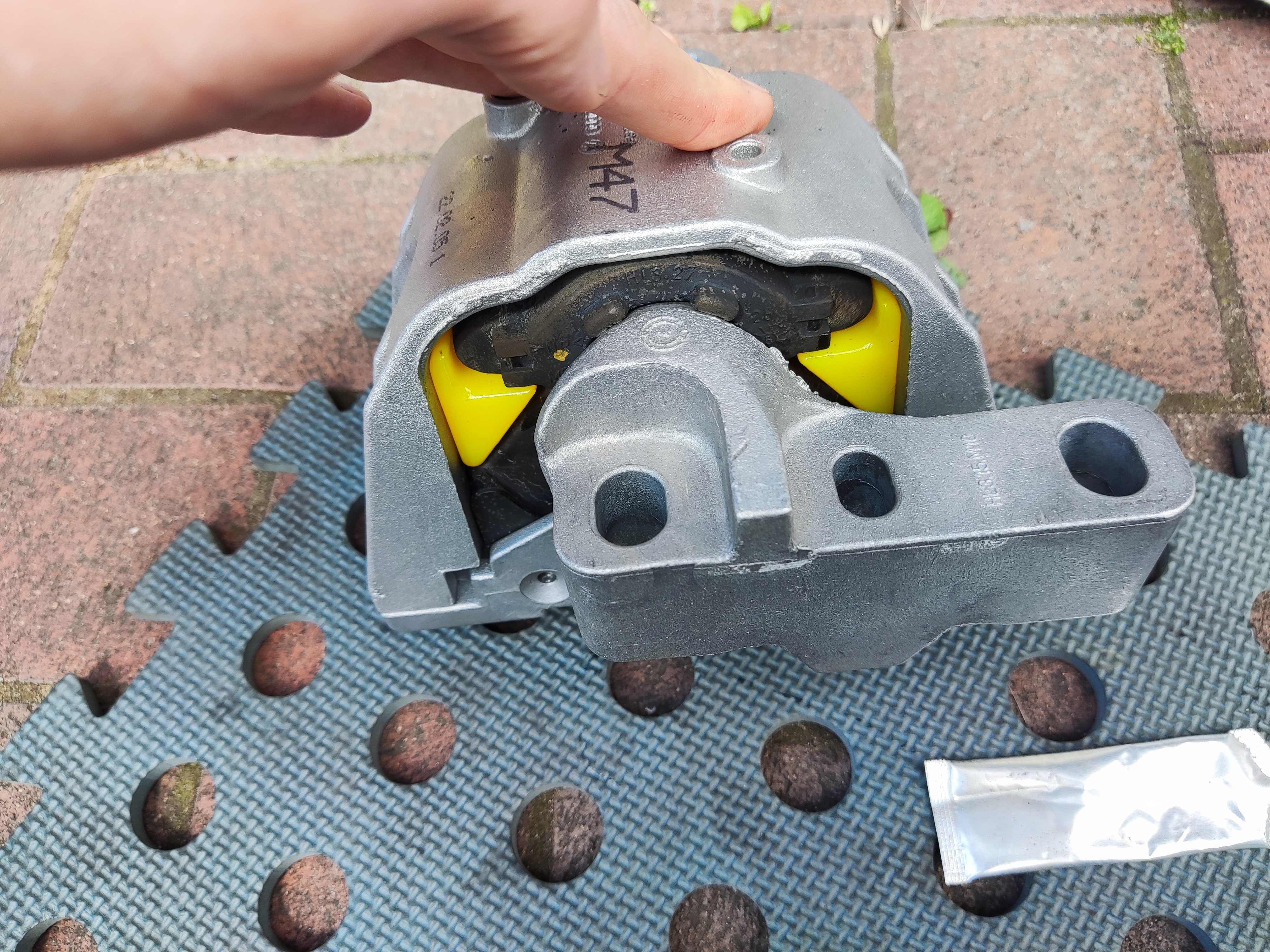

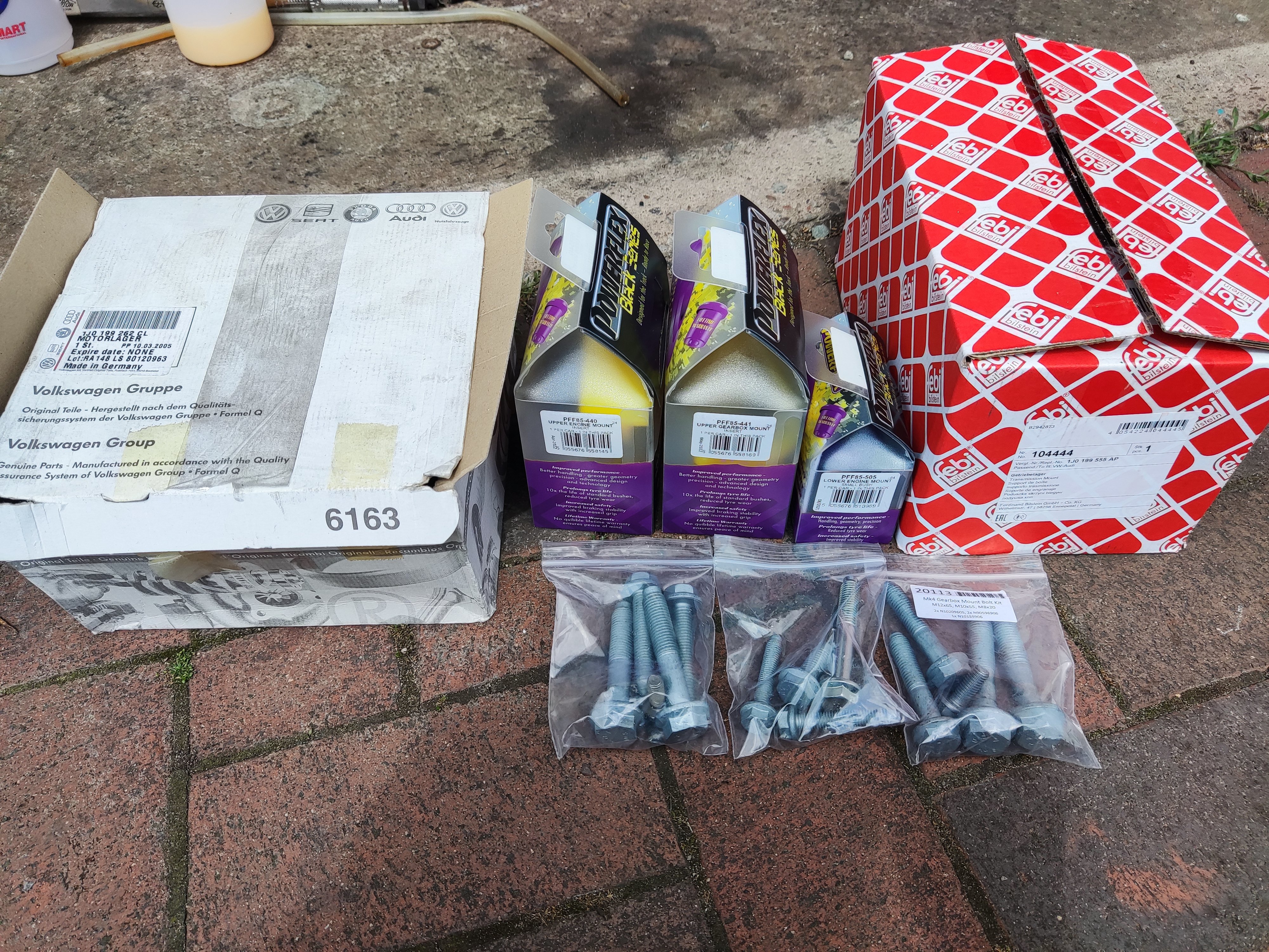

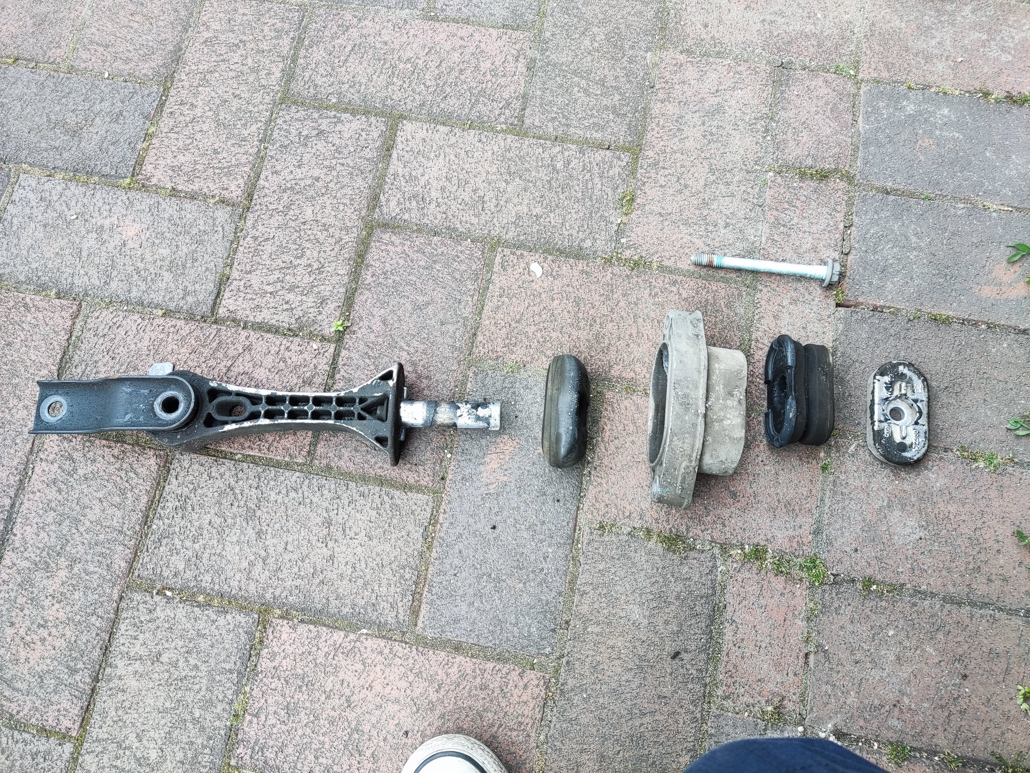

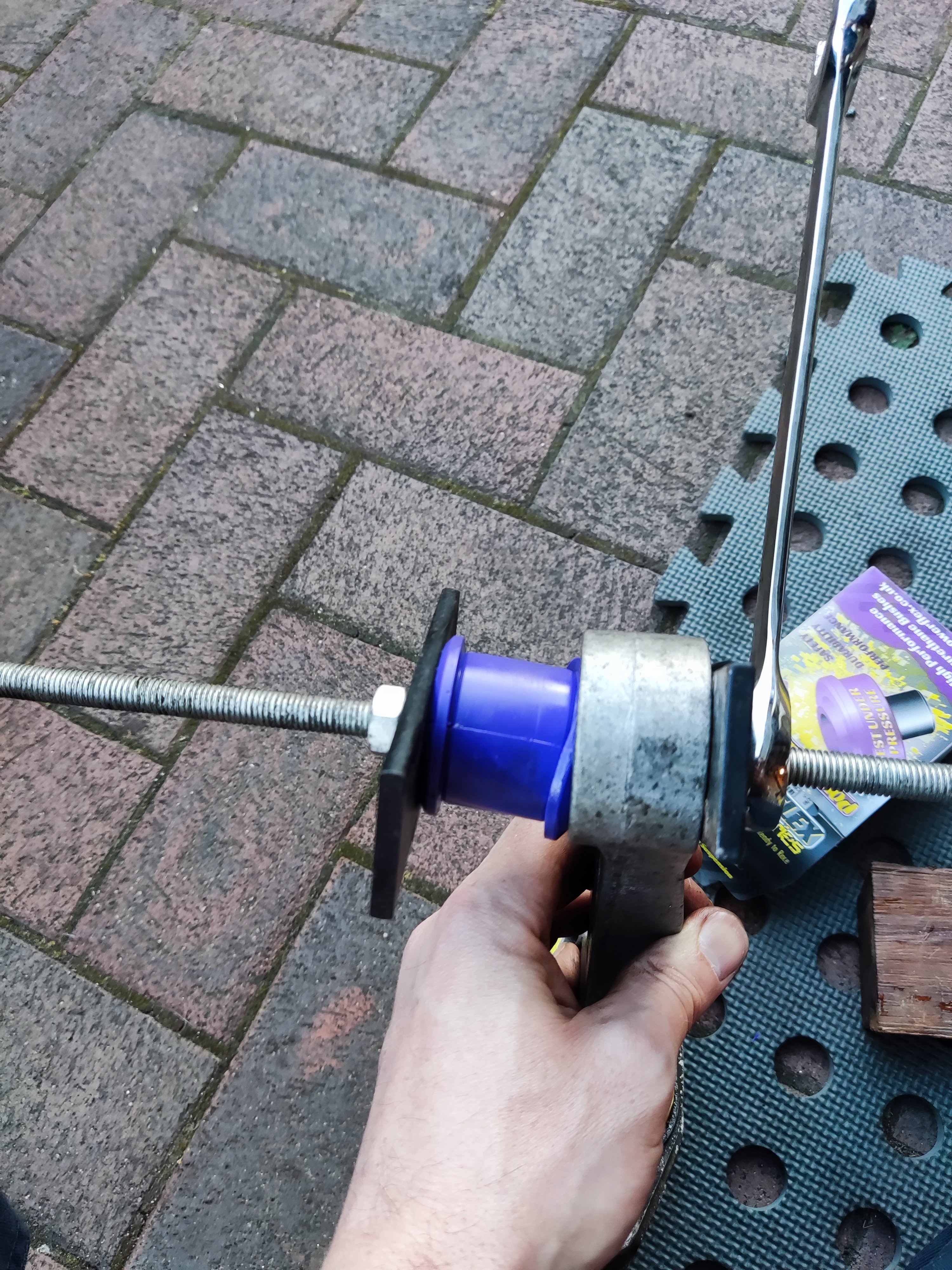

After changing the one bush on the dog bone the engine didn't move as much but I still wasn't happy with it. I've now changed all the mounts and used all the powerflex bushes and it's much better than it was. I bought a genuine engine mount, a febi gearbox mount and all the new boltsIMG_20220707_135616.thumb.jpg.8bf09ea9c2c455cb140d5c8004af6faf.jpgIMG_20220707_140146.thumb.jpg.b975e702551cb193a4da5526d07c73bd.jpgIMG_20220707_140159.thumb.jpg.4667ea6bb141761ce39a2c85af2d6c69.jpgIMG_20220708_204136.thumb.jpg.c1e85b584ec3b690b922da5c9f6176a9.jpg
The hardest part is getting the purple bush in and out of the dog bone. I used an old gen 2 mini wheel hub as an anvil to knock out the old one and some threaded bar with big washers to push the new one in.IMG_20220708_202452.thumb.jpg.5677be03ac61b2f5f3fd27c203992e71.jpgIMG_20220708_203525.thumb.jpg.e9d000341ec6ab62047aa6cdd45229f4.jpg
I did all of that a couple of weekends ago. This weekend I've been busy with the old laptop, I had an engine warning light come on last week IMG_20220723_152101.thumb.jpg.982f69d19dcee290d773346fcada20d7.jpg

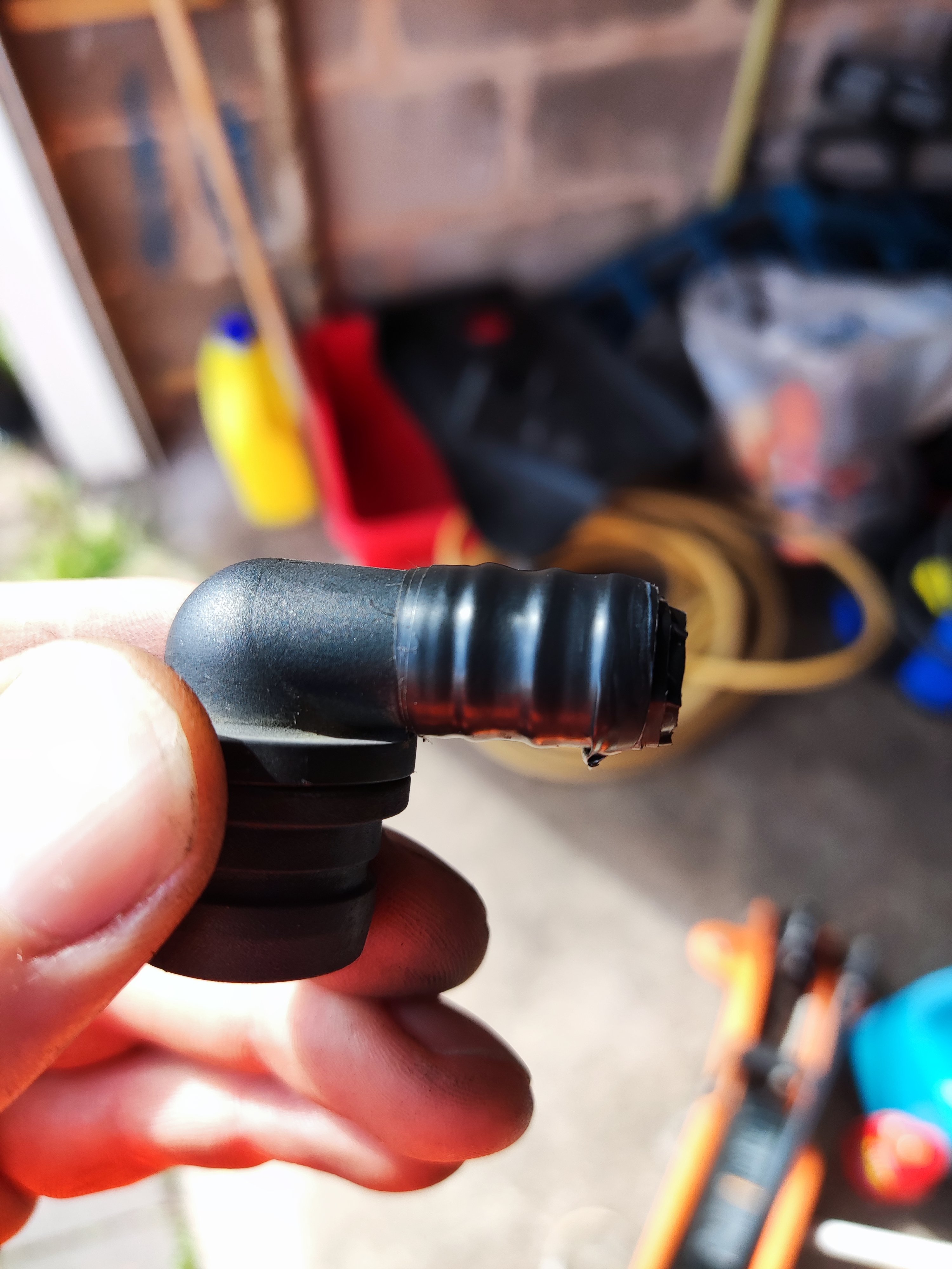

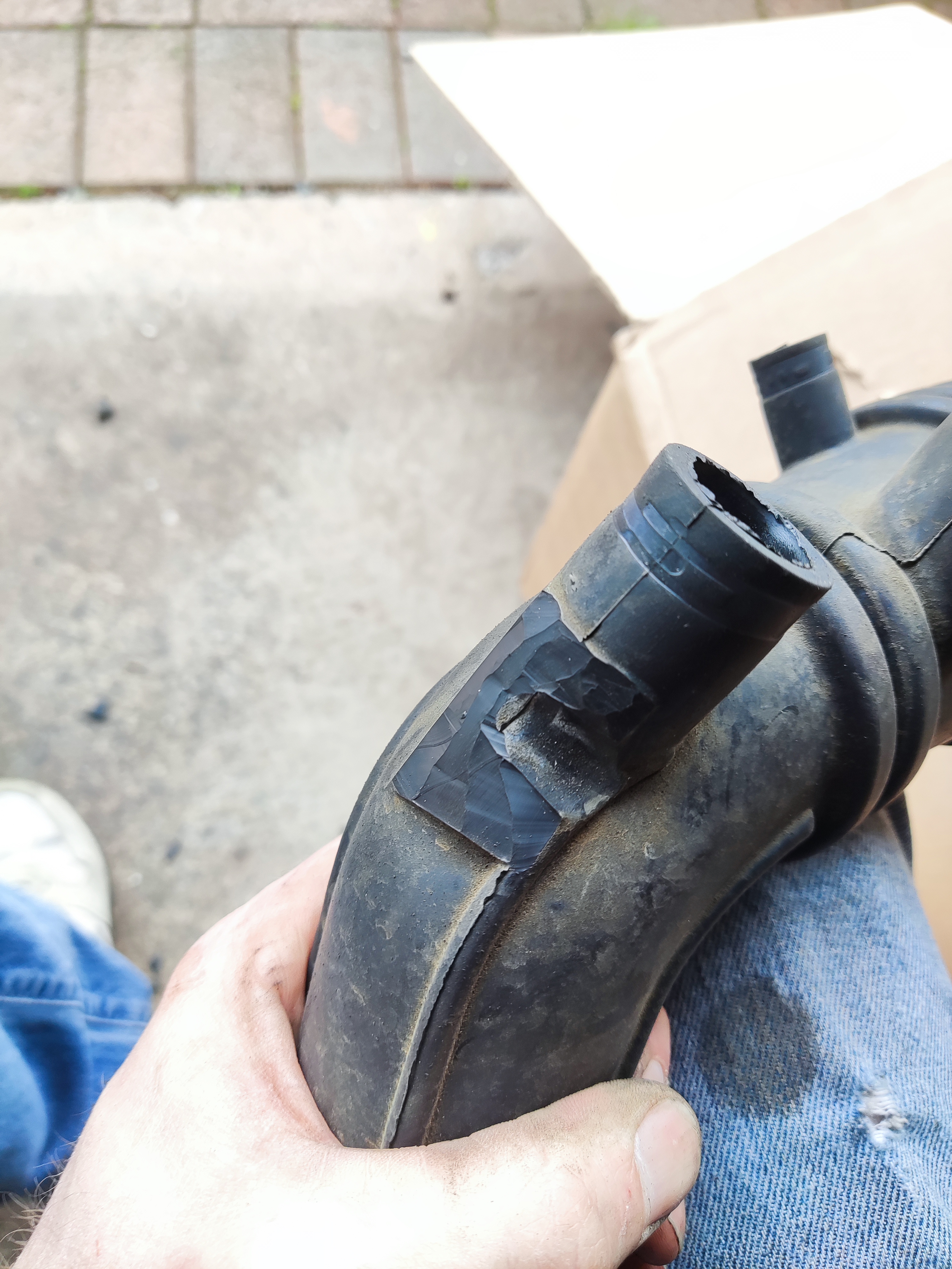

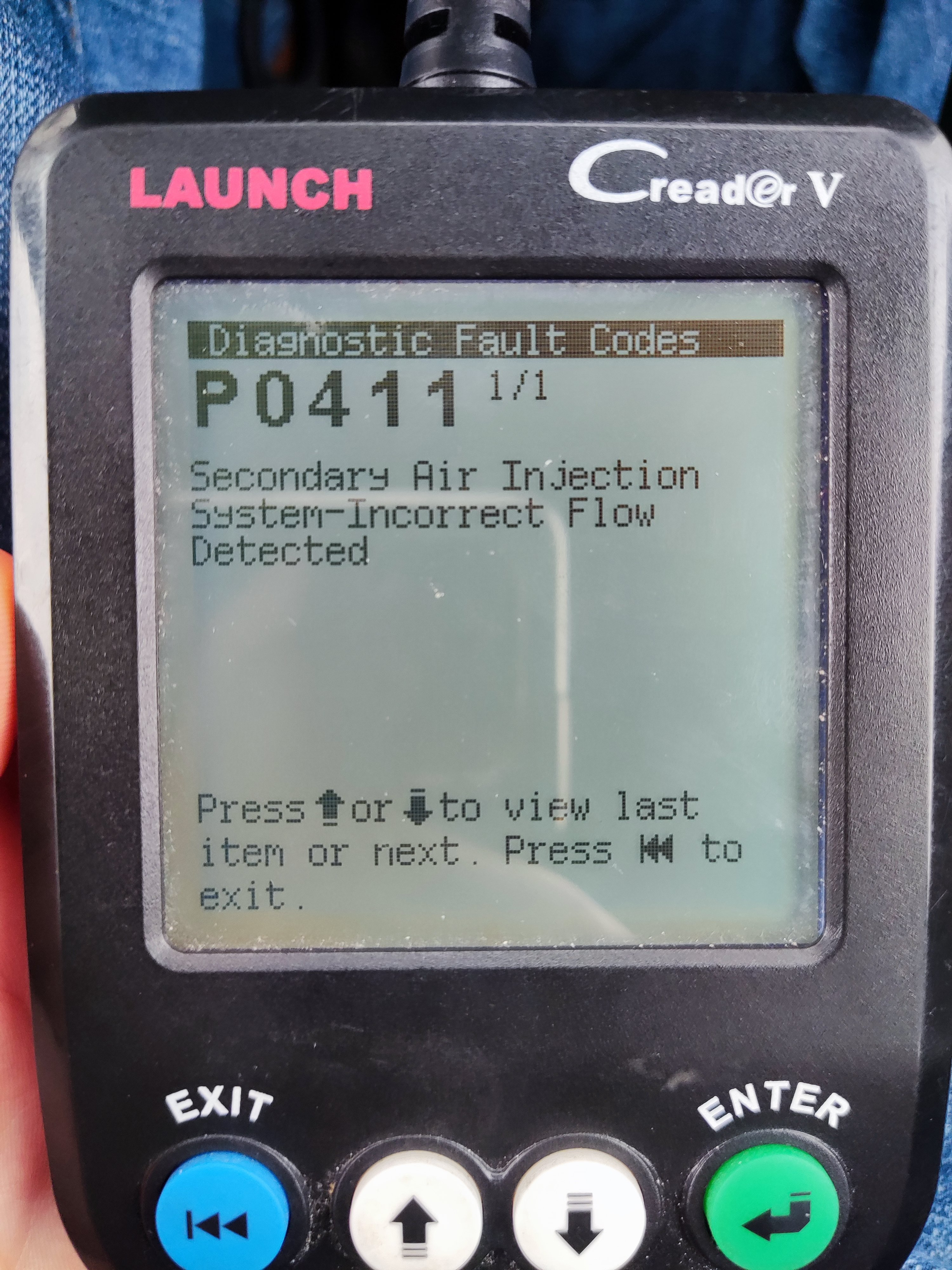

I don't have vcds yet but this ancient code reader pointed me in the right direction. It hadn't occurred to me that it was quieter than normal on a cold start but the pump had stopped working. So I put my big boy pants on and flashed the ECU for the first time with a map that I'd deleted the sai from. All seems to be well so far...
Something else I discovered which is obvious but I wasn't sure about until now is that my car came with some kind of stage 1 map on it. Up until now I'd done a few data logs, I just presumed I'd got something wrong as the boost was showing more than standard and the afr didn't seem right, it turns out I was logging it correctly though. I confirmed it looking at a standard map I downloaded to the one on the car and you can see the difference in load request and lambda request.
As this post has reach the 50mb of pictures I'll make a new post showing what I've learnt about mapping later but as it stands Ive put my car onto a standard map with sai delete, I want to learn how to remap it myself and the best place to start is with a stock map. I've also got a blanking plate to remove the sai hardware but I haven't touched that yet
Edited by Ben99Felicia
I'm impressed with the engine mount swap.  What sort of cost was it for the parts and how long did it take to do?

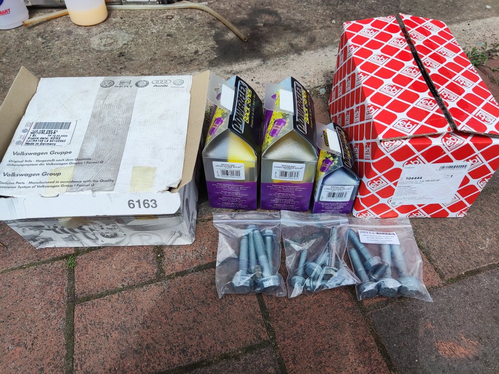

Well I paid £50 for the engine mount, £62 for the gearbox mount, £105 for all the poly bushes including the one I changed last time on the dog bone and £52 for all the bolts so £269 all together. Expense when you add it all up but cheaper than buying the aftermarket mounts like the 034 from awesome which works out to about £450.

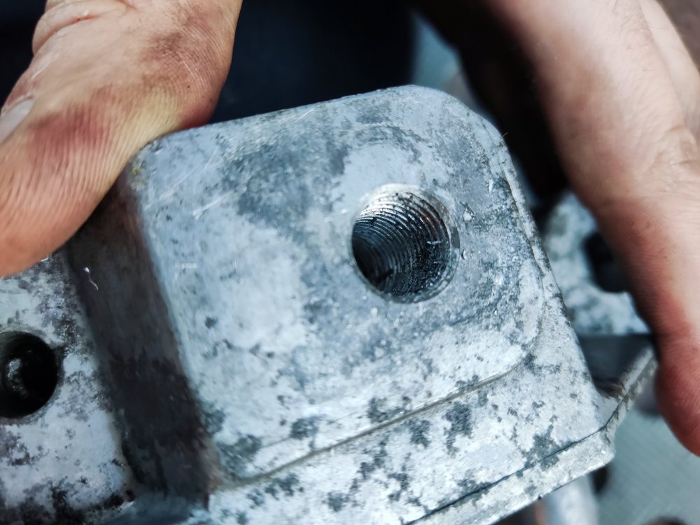

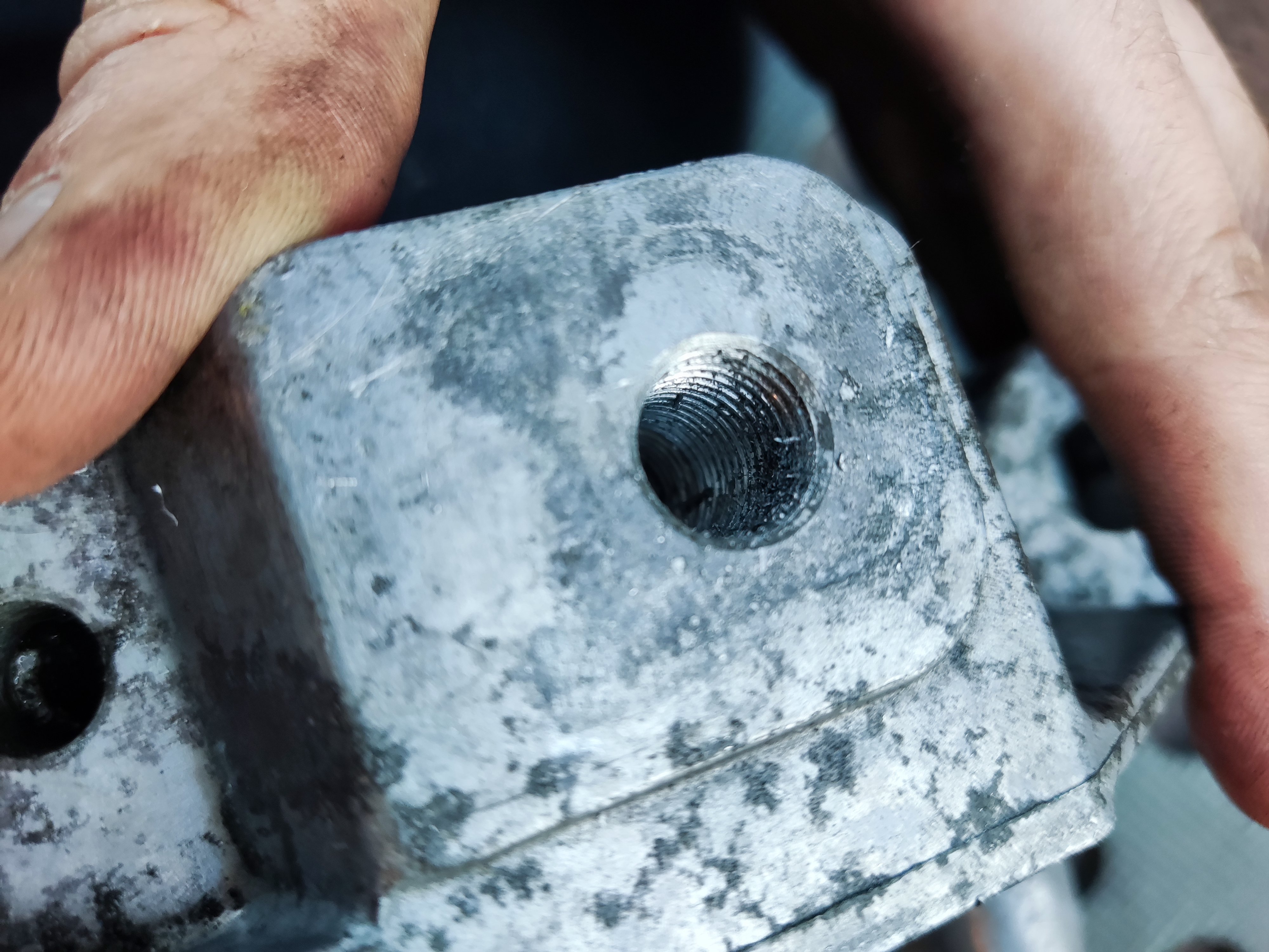

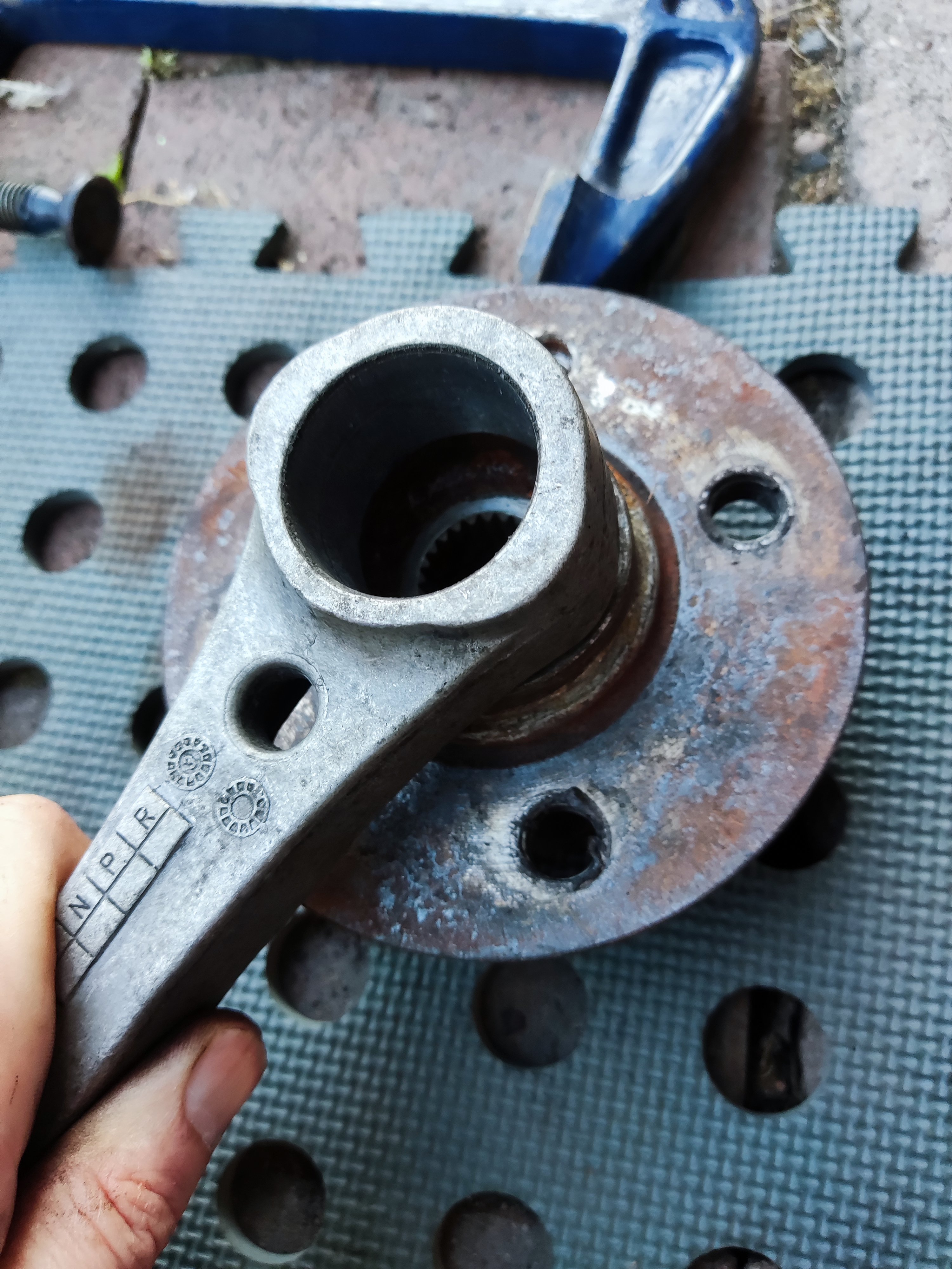

It took me slightly longer than it should because I forgot to mention I stripped the thread on the engine mount bracket and had to go get another from the breakersIMG_20220708_204529.thumb.jpg.bb8770b107e60d5b052c910bb64159ee.jpg
It took forever to get this part out and the replacement back in, anyone that has done a cambelt will know what I'm talking about. I've learnt a lesson about taking more care with bolts lining up properly. It's easily 3 hours work if nothing goes wrong.   I need to take a look at the other bushes and the drop links now because there's a clonk when I go from left to right to left like going around an island for example, I did already change the antiroll bar bushes for rubber ones but I'll probably change them again for powerflex.

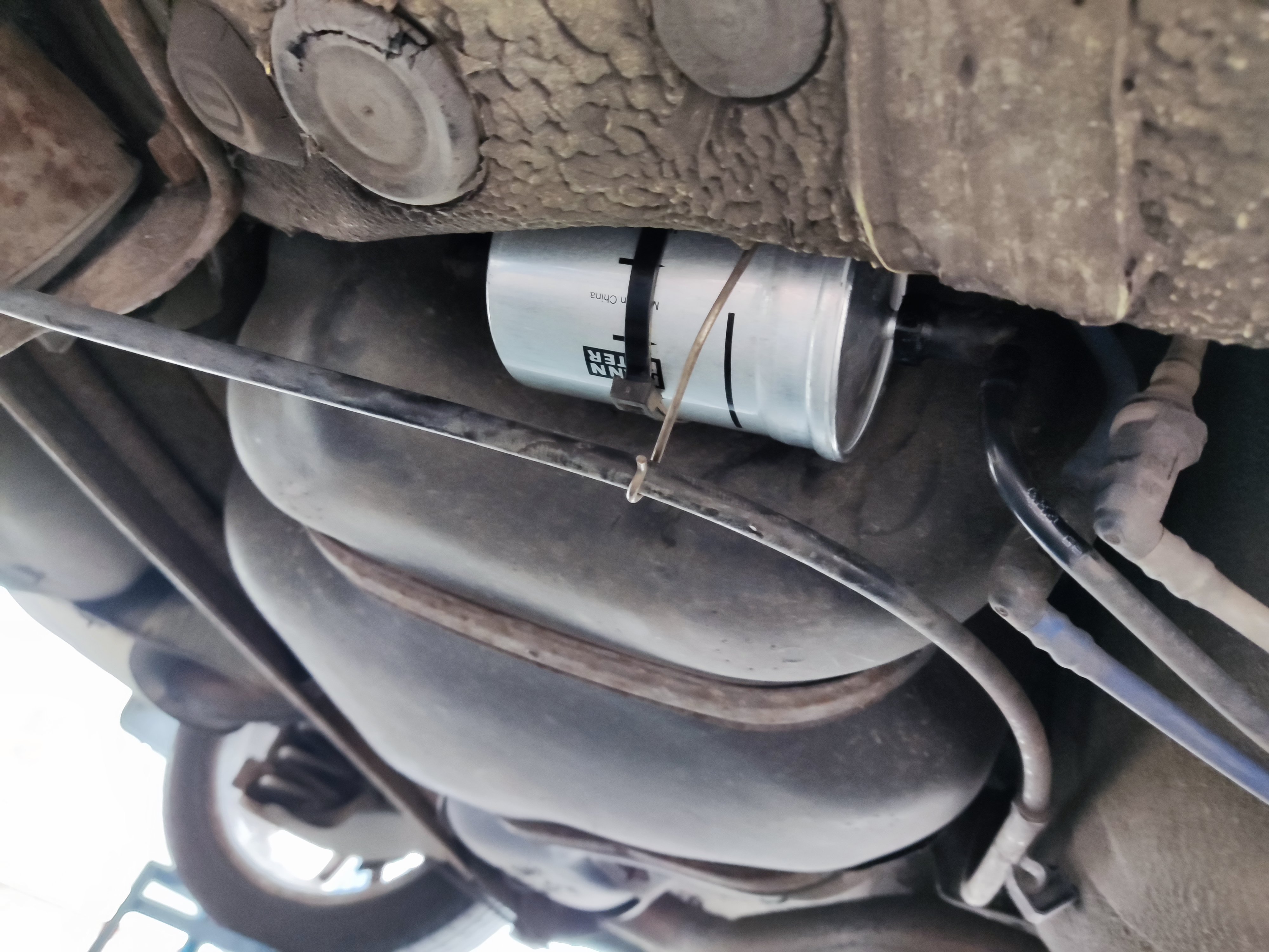

Oh and I fitted a new fuel filter tooIMG_20220618_084850.thumb.jpg.e65168a55e11f5ba2306bca48c6ec7a2.jpg

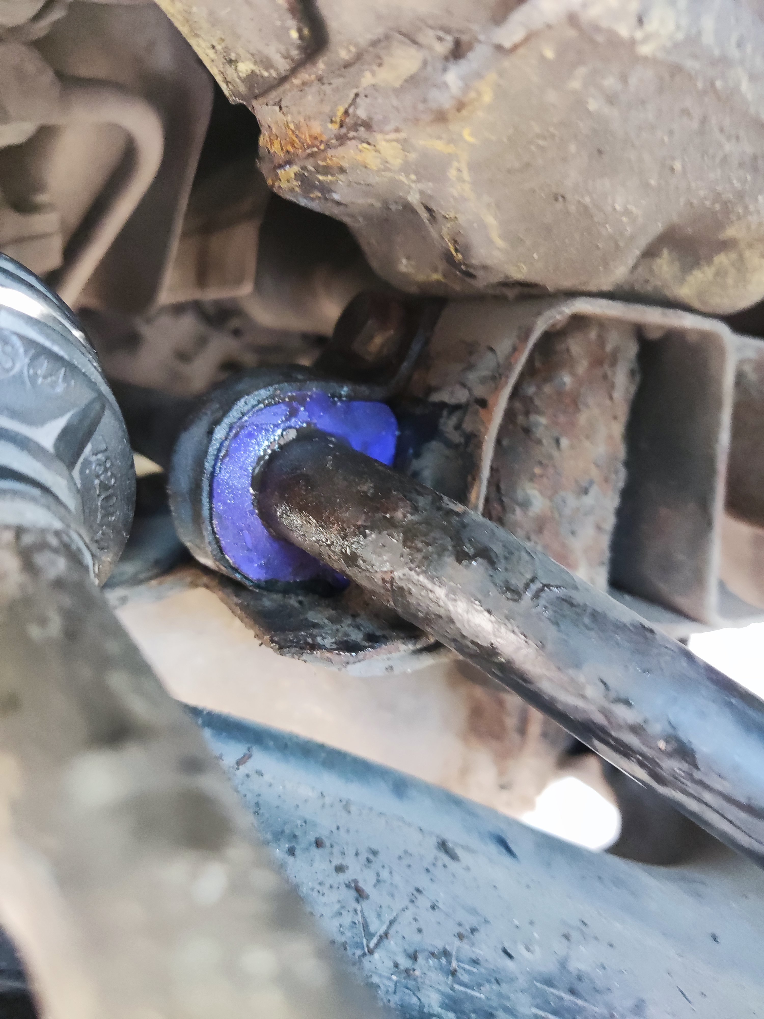

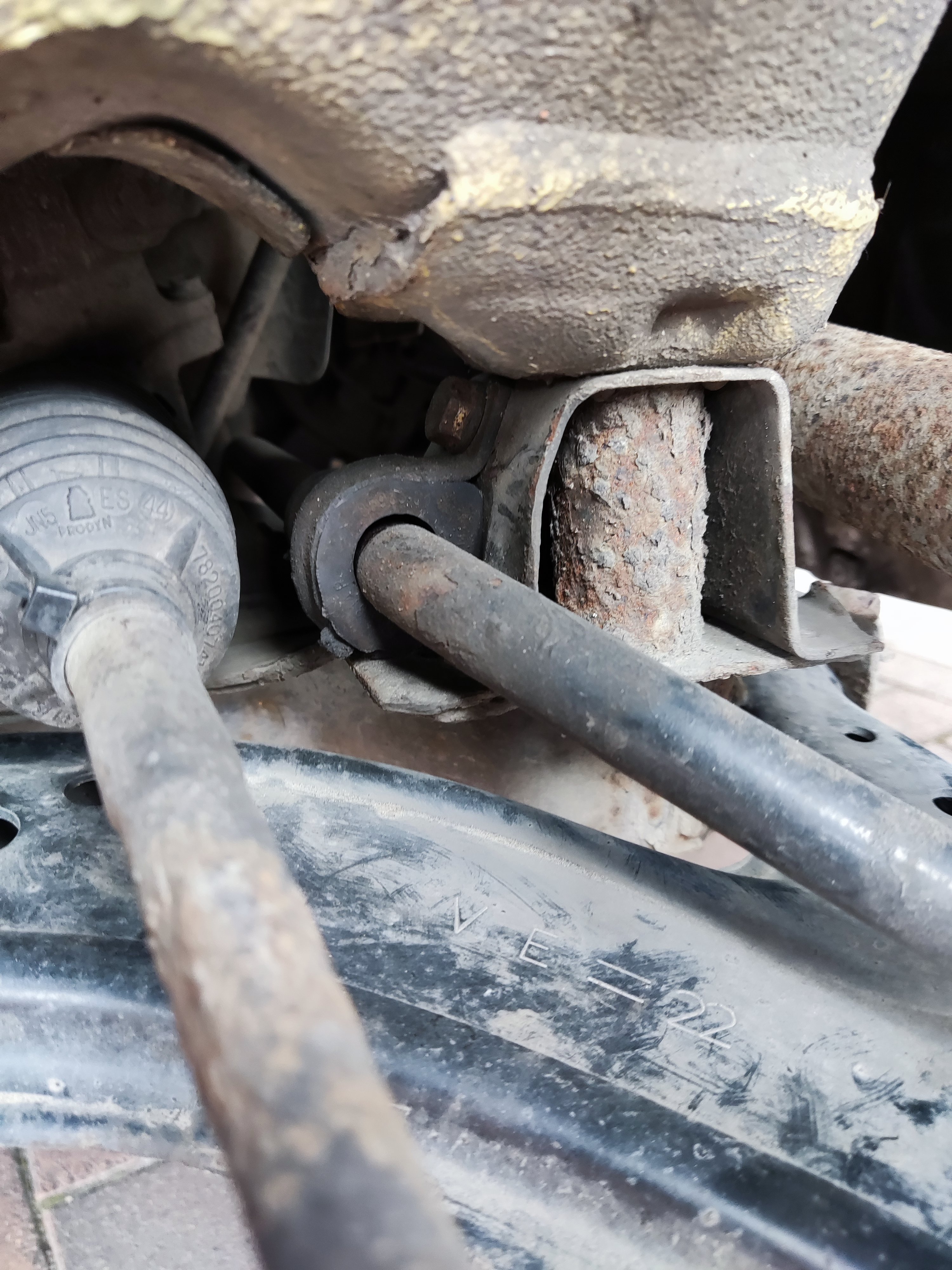

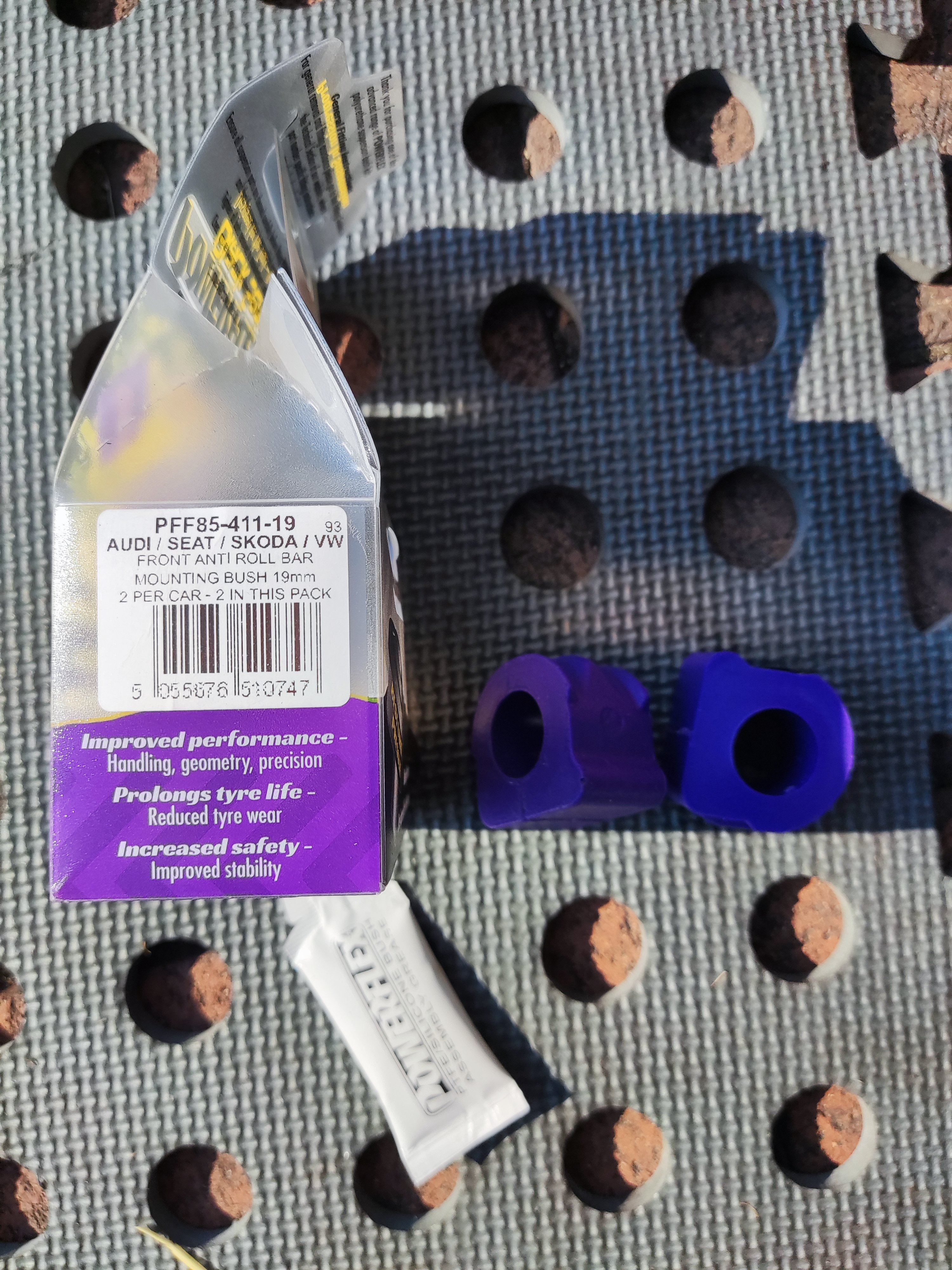

The front anti roll bar bushes had gone bad again so I've changed them for powerflex onesIMG_20220730_102052.thumb.jpg.097acb0970d1afff574aed5fe58e2e18.jpgIMG_20220814_093128.thumb.jpg.ca47bcf50885364df20cfbdbaeabddf9.jpgIMG_20220814_094040.thumb.jpg.4d4d7a9d180500f1db23d2c2277fcc81.jpg

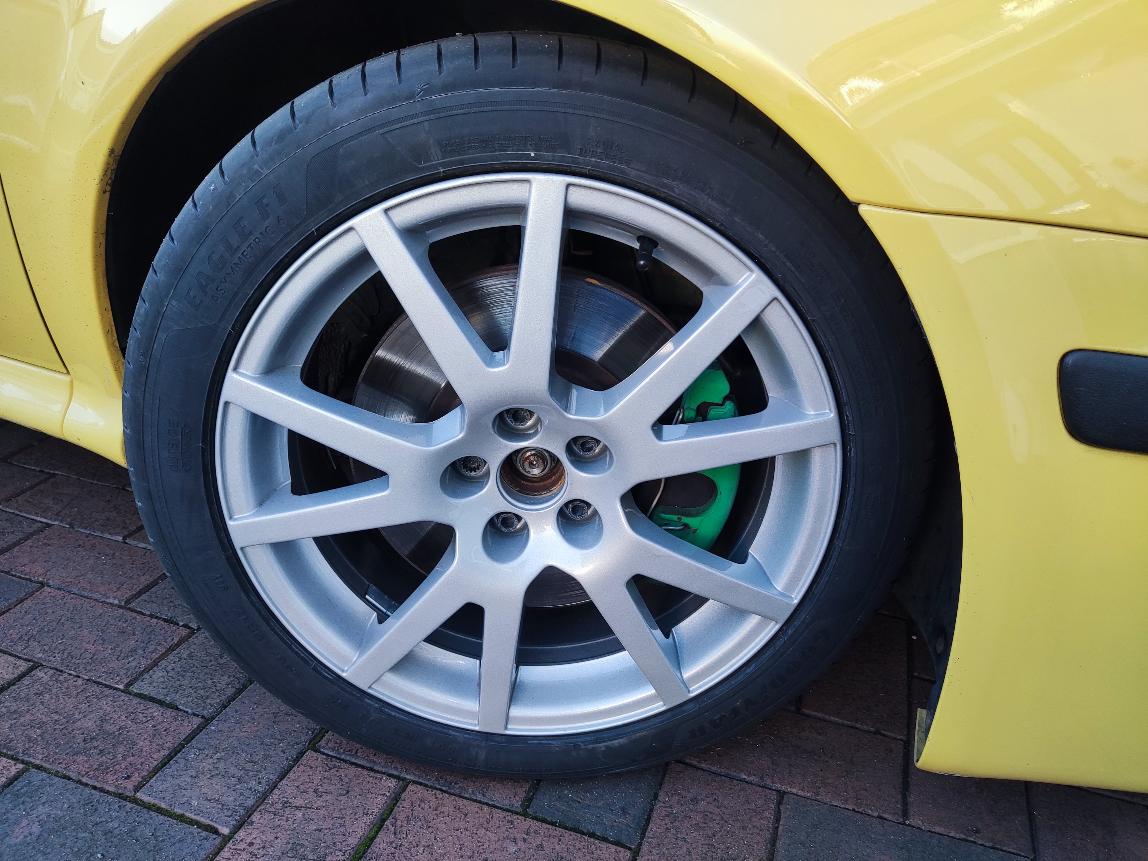

The best thing I've had done is new tyres and wheel refurb. Like an idiot I forgot the before photos and the new centre caps haven't arrived yet but you get the idea.IMG_20220910_183511.thumb.jpg.a30684bef552c54a3a181b75992719a4.jpg
I went for 225/45/17 Goodyear eagle f1 asymmetric 6, got them from Halfords as they where the cheapest at £72 each. I had the wheels power coated the standard colour. I'll get some better pictures for the next time to, they aren't even clean in this picture but never mind they still look a lot better than when they had curb rash on every wheel.

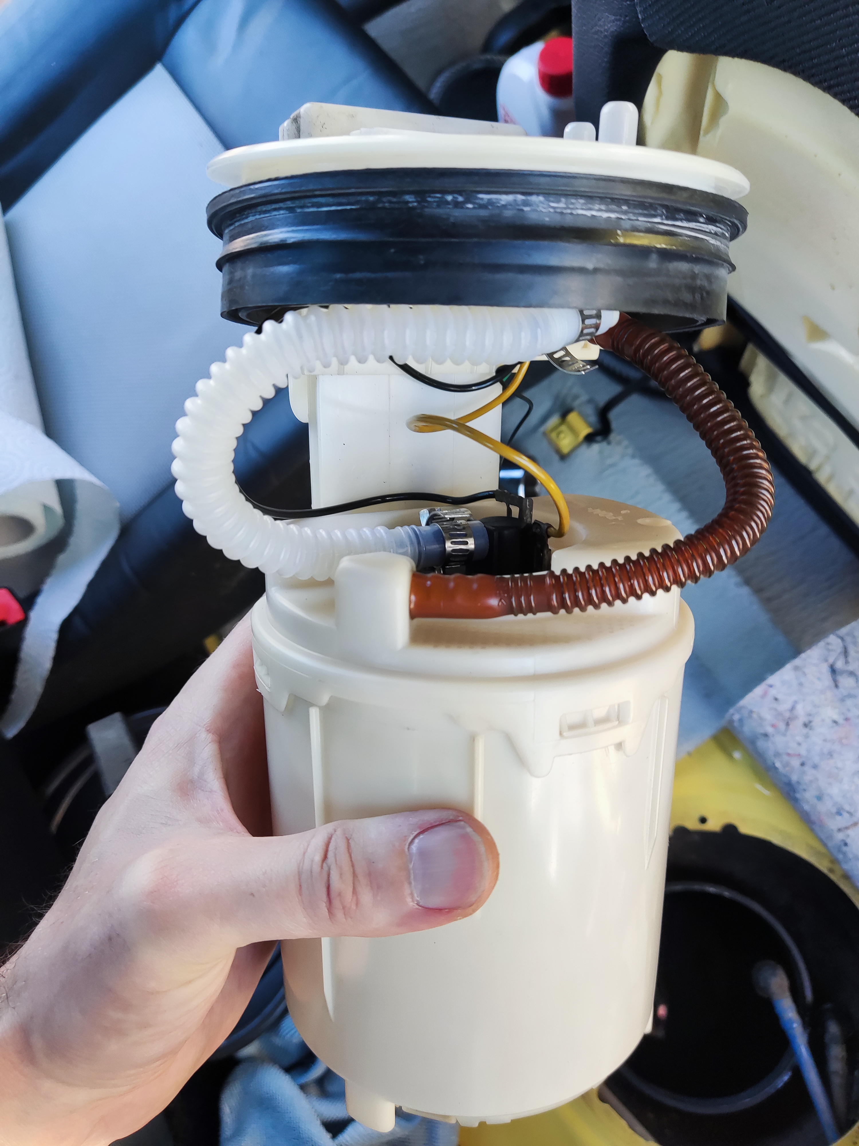

new uprated fuel pump, didn't really need it but it's done now so...

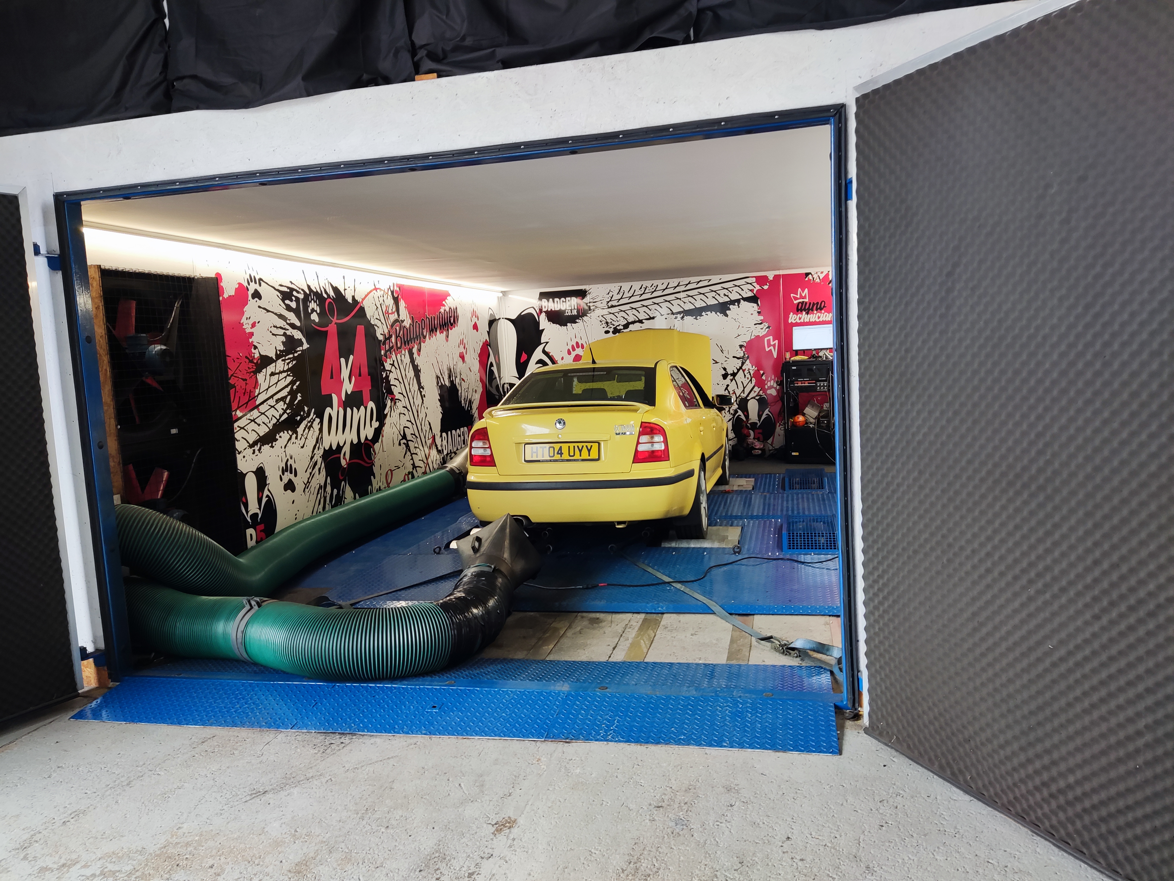

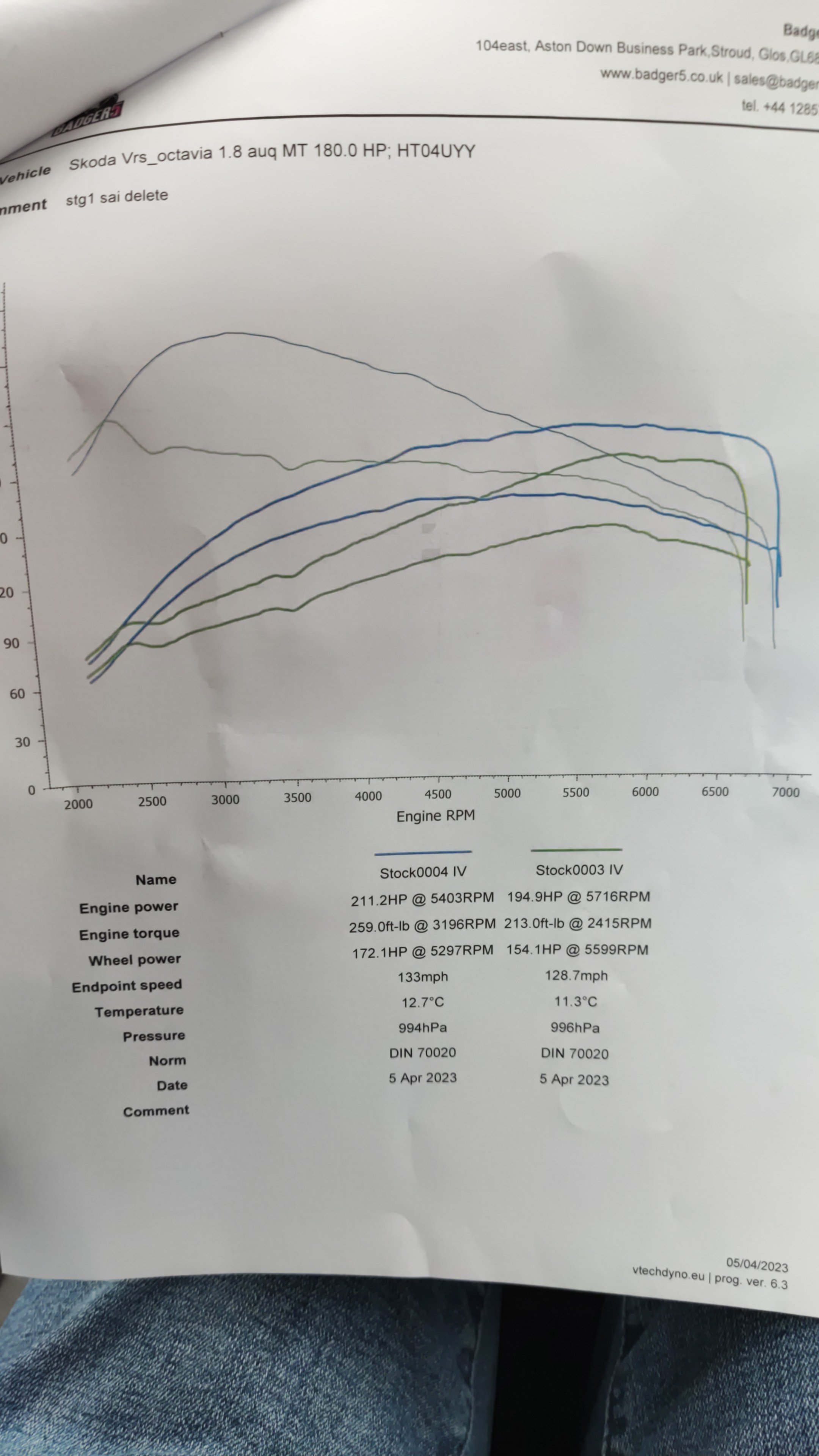

I chose badger5 because I'd heard good things and they didn't disappoint, Bill remapped the car and it runs spot on now making a healthy 211bhp and 259ftlb.
Which fuel pump did you go for?  I currently don't have an issue but it's a job I've been meaning to do as a preventative measure.
Also, those figures look good for a Stage 1 map.  Having seen claims of 220/230 bhp from a Stage 1, it's refreshing to see a realistic set of numbers.  I bet the car drives very differently now.
Edited by skinnyman
I bought the APS 265lph from jjc race and rally on ebay. I paid £63.14 at the time which is a bargain, the price has gone up to £88.15 now. Demon Tweeks sell it for £84.50, for some reason the website say its not compactible with my car though, there are 2 versions one for 2wd and 4wd cars.
My car is standard apart from a cat back exhaust so it was only ever going to make around 210bhp, he told me a front mount intercooler, sports cat and some bigger injectors (injector duty cycle was getting pretty high) should get me to around 240bhp.

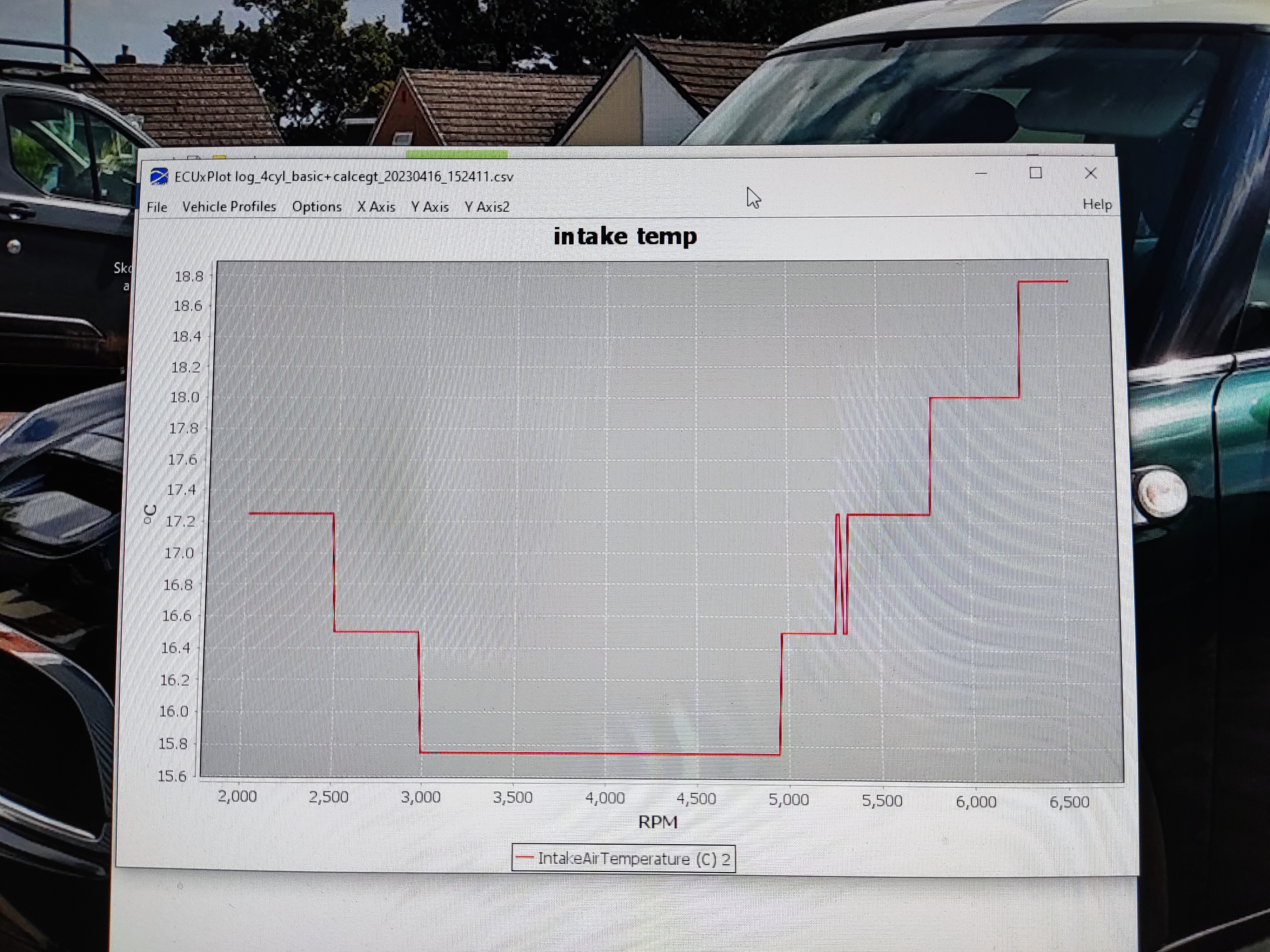

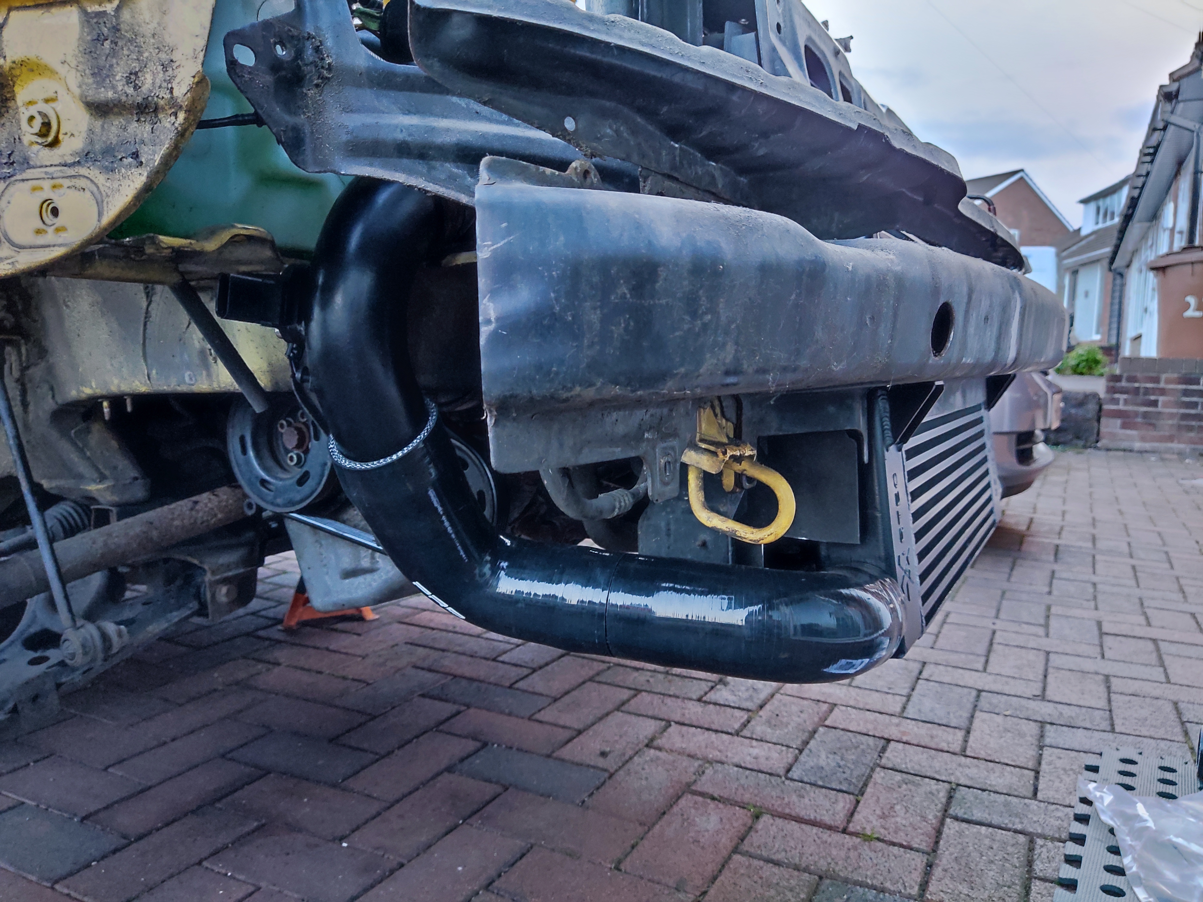

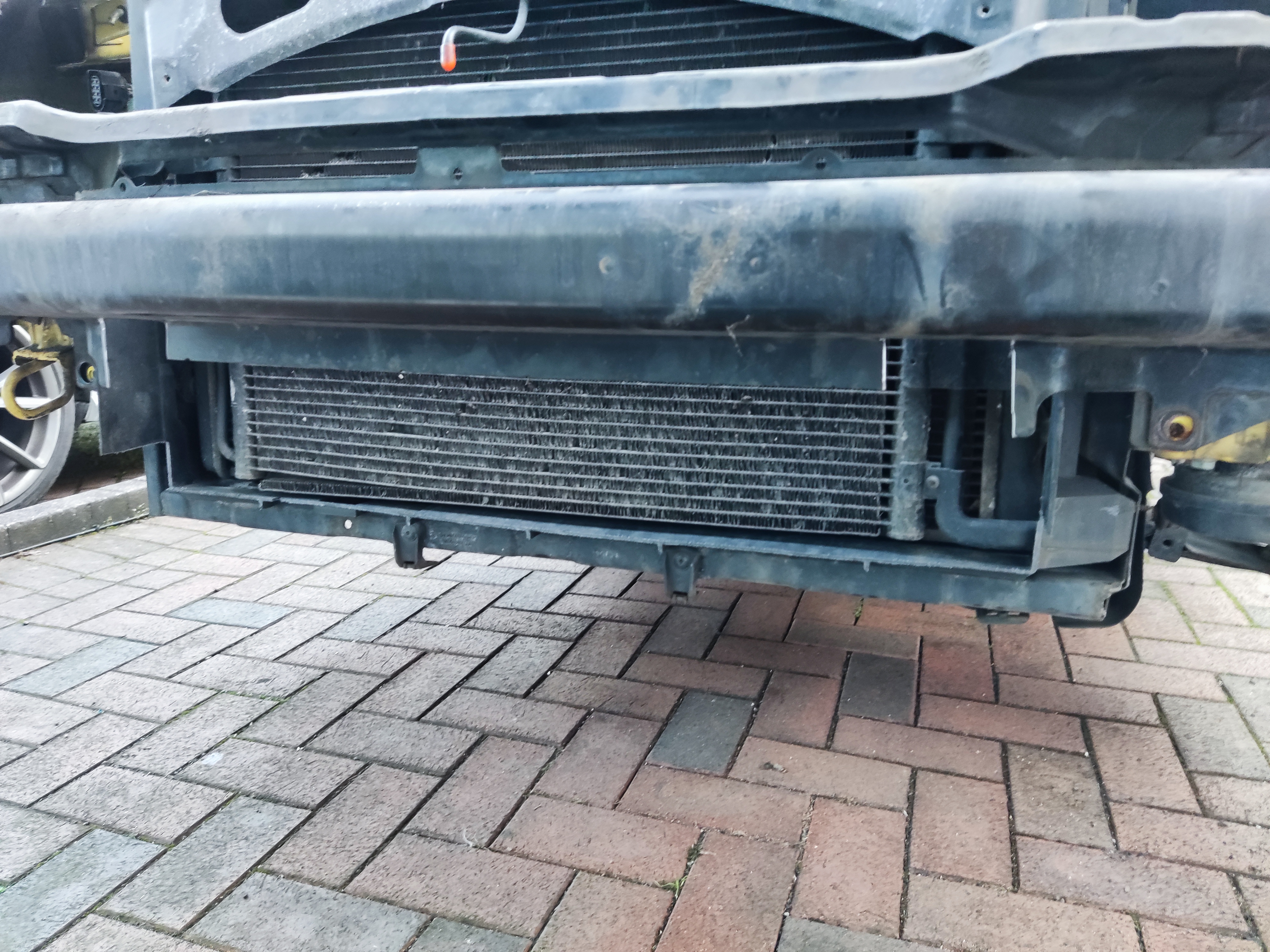

Airtec intercooler install

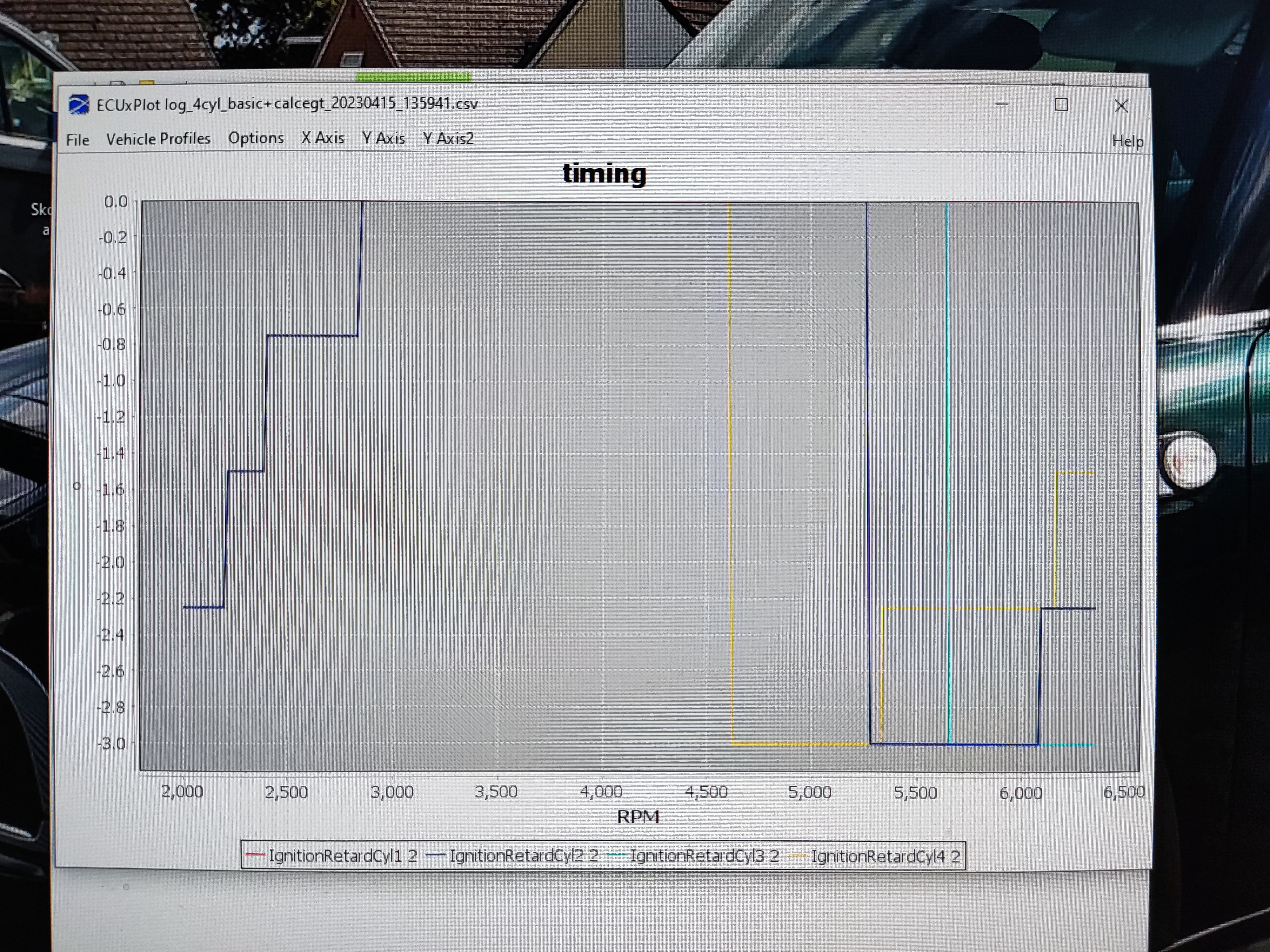

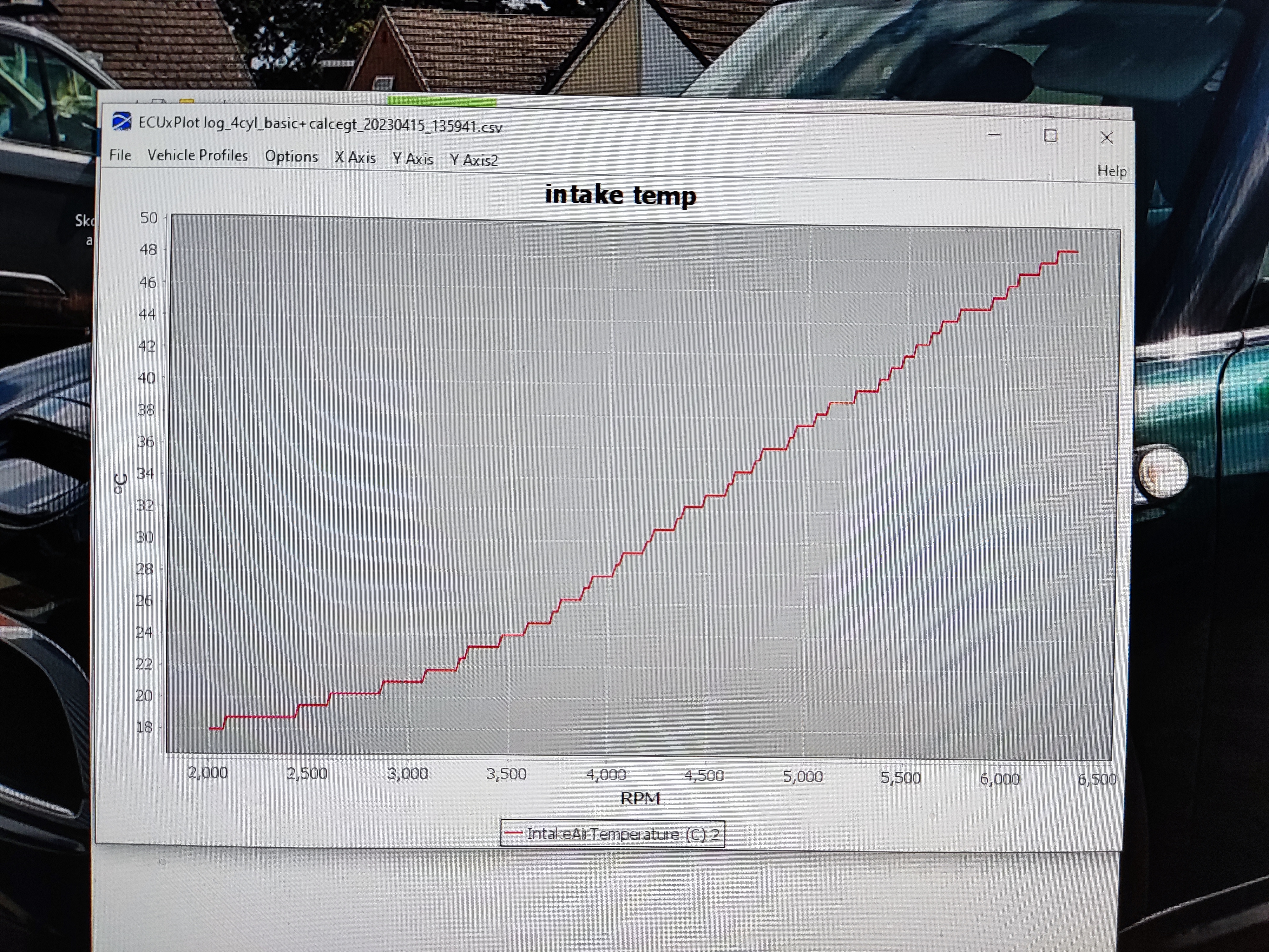

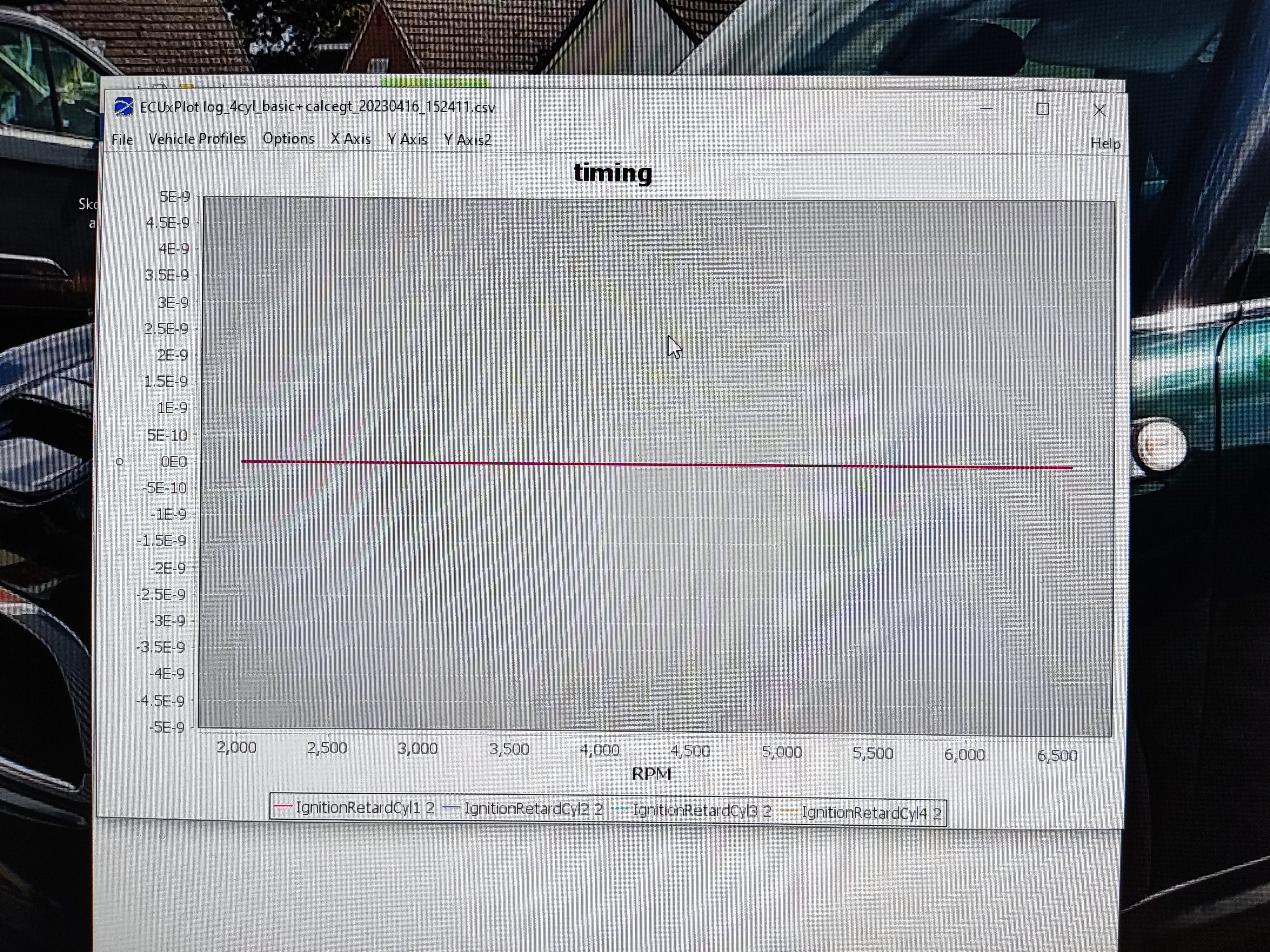

The intercooler is installed and the results are really good. I'll start by showing the before and after data logs because aside from the kit looking smart it really is all about the performance after all.
This is the air intake temperature with the original side mount intercooler. Starting at 18°C it steadily rises to 49°C by the end of the pull, an increase of 31°C.
This is the log from today with the new front mount. I'm suprised that the intake temp actual went down from 17.2°C by 1.5°C to15.8°C from the start of the pull and didn't show any rise until after 5000rpm where it reach a maximum of 18.8°C a total rise of only 1.6°C
The result in these lower temperatures are also evident in the timing logs. This graph shows the timing pull on each cylinder during the high intake temperatures, the ECU is pulling 3° from the base timing because it is detecting knock, this is reducing the power that the engine makes.
With the new intercooler the ECU isn't detecting any knock 🙂

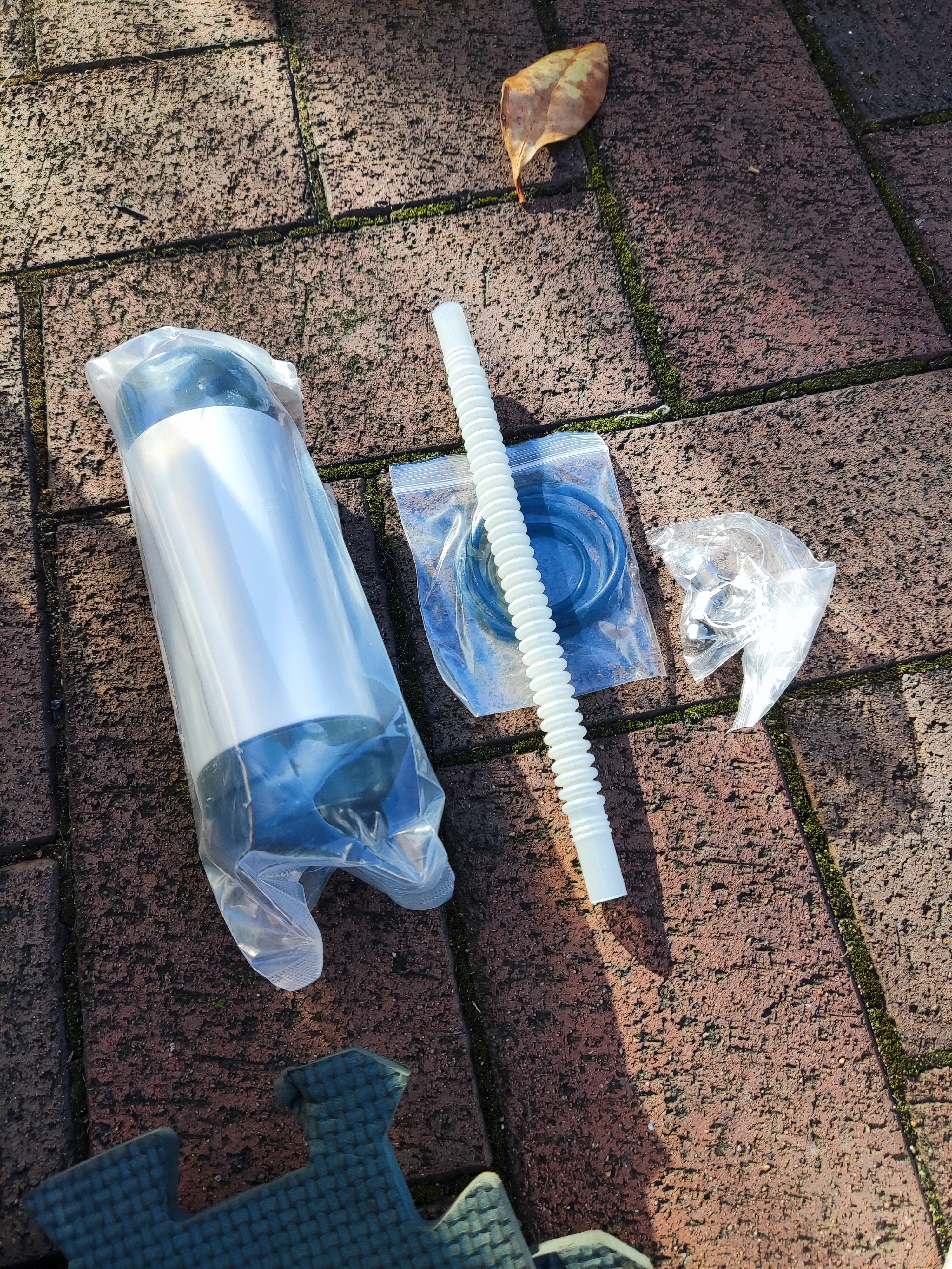

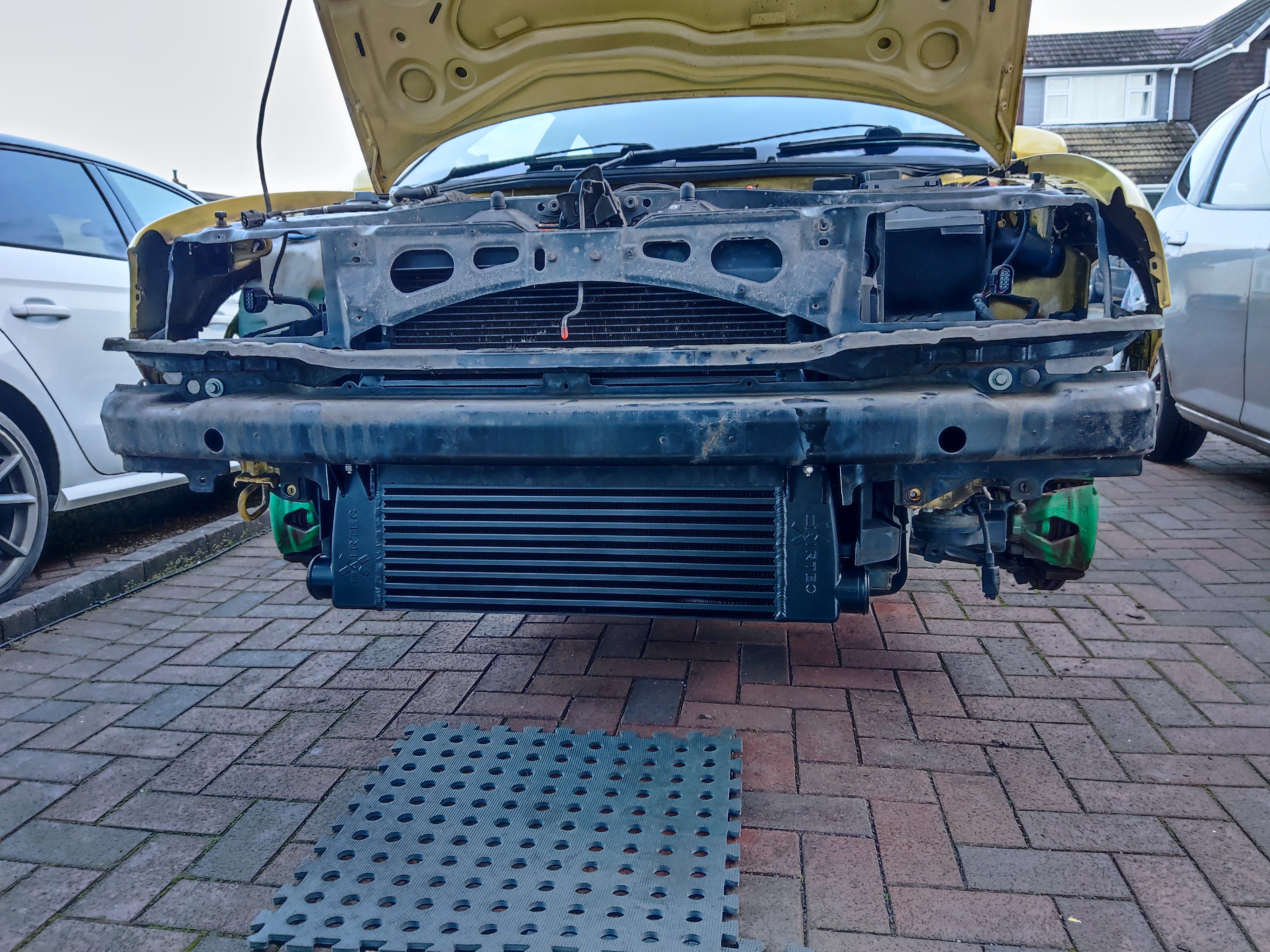

Here are some pictures I took during fitting the kit. I had to trim the crash bar for the intercooler brackets and the plastic cowling at the bottom
The pipe work on the cold side was very easy to fit
I has to trim the corner of the air vent on each side of the bumper to clear the intercooler bracket
I shaved part of the turbo intake pipe to clear the new turbo outlet pipe

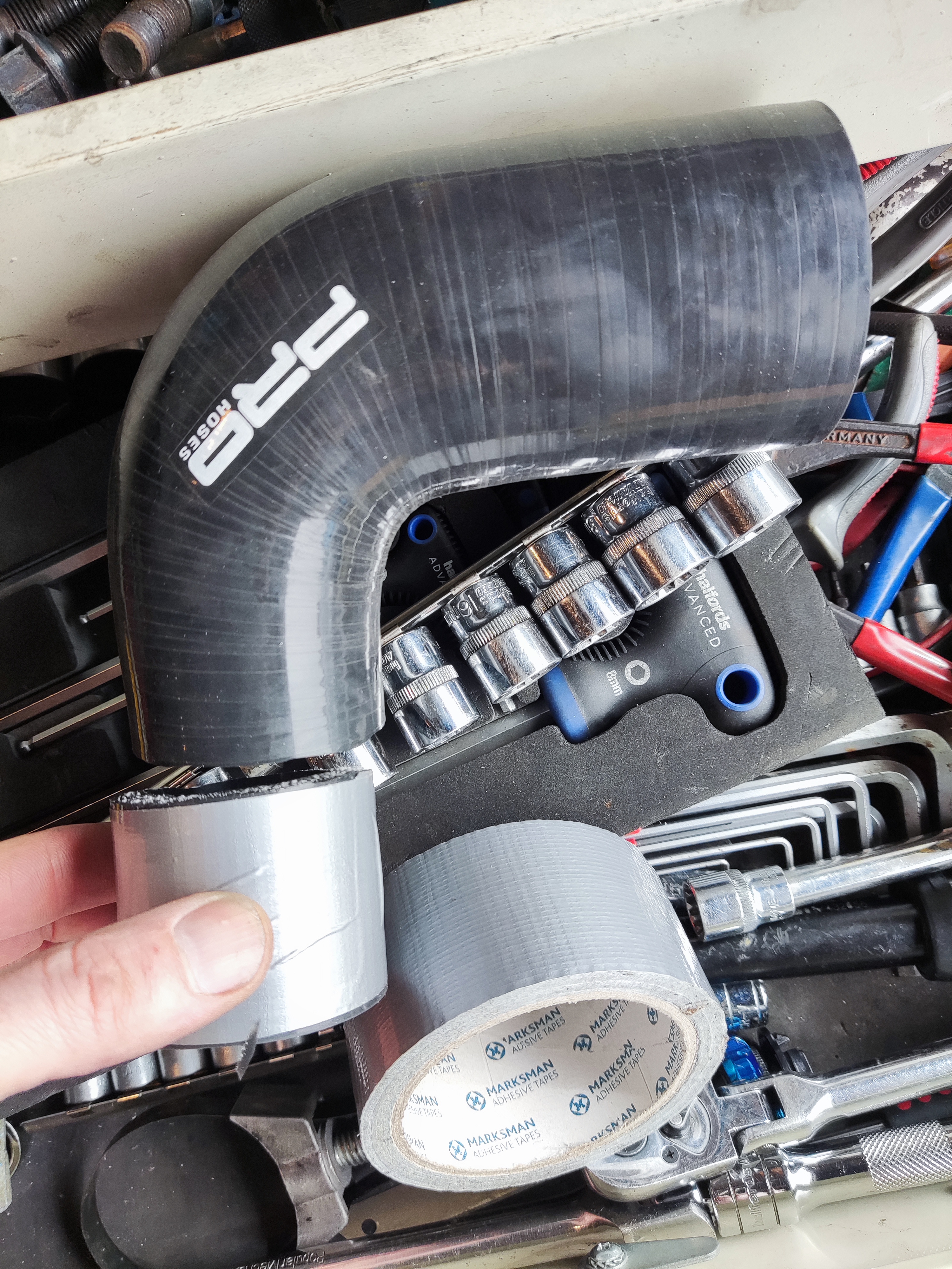

I cut down the original dump valve hose and managed to get it back on the dump valve and new intercooler pipe by swearing at it and using boiling water to heat it up
On the hot side I had to flip both of the horns by taking them off their brackets and remounting them upside down
Finally I had it all put together, this section took the longest to work out, its very tight in there now and I'll reroot some of it at a later date to make it easier to work on
Pretty sucessfull weekend, of course of knocked all of my knuckles off but thats a small price to pay

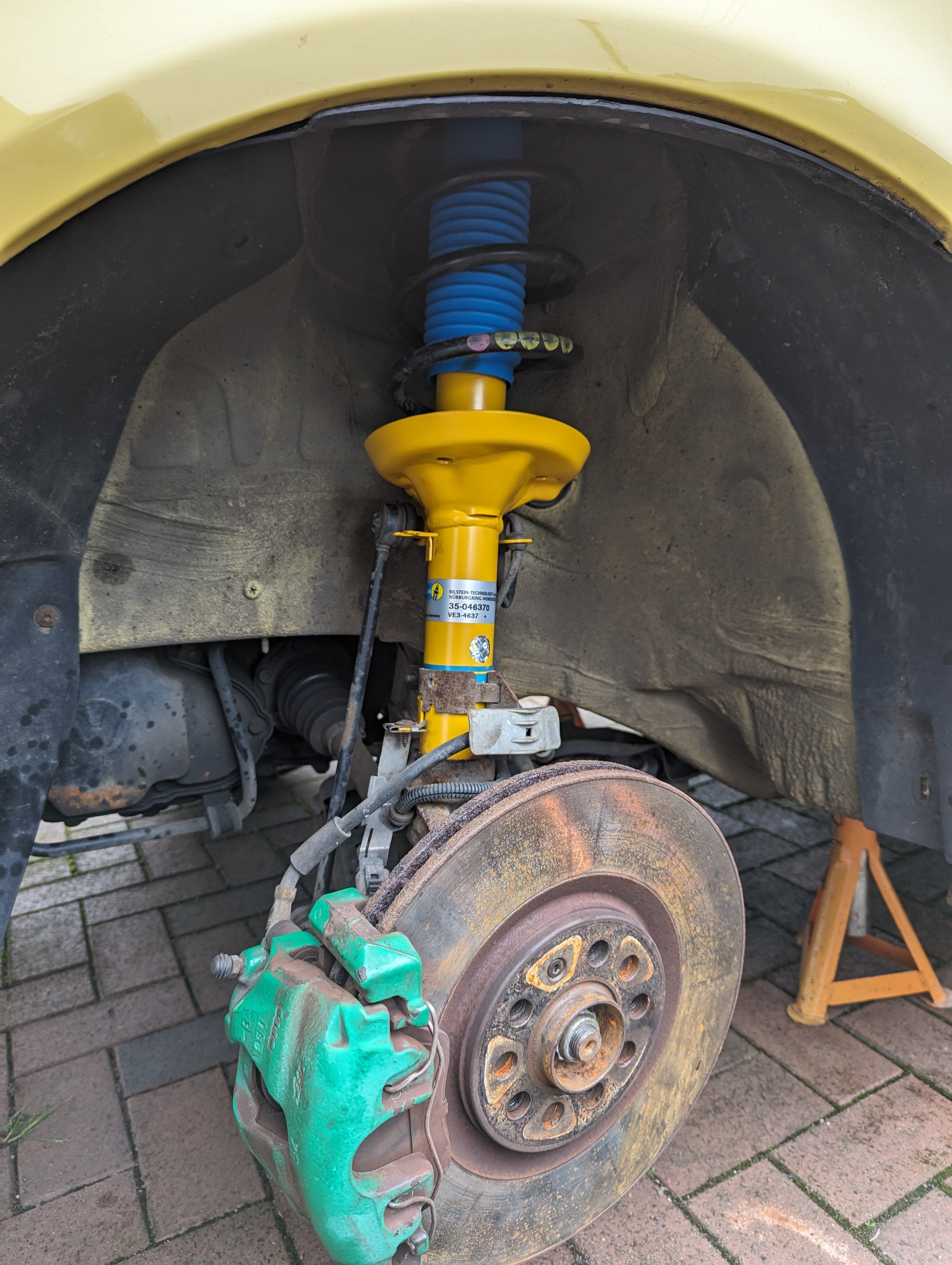

Car season is here again yay

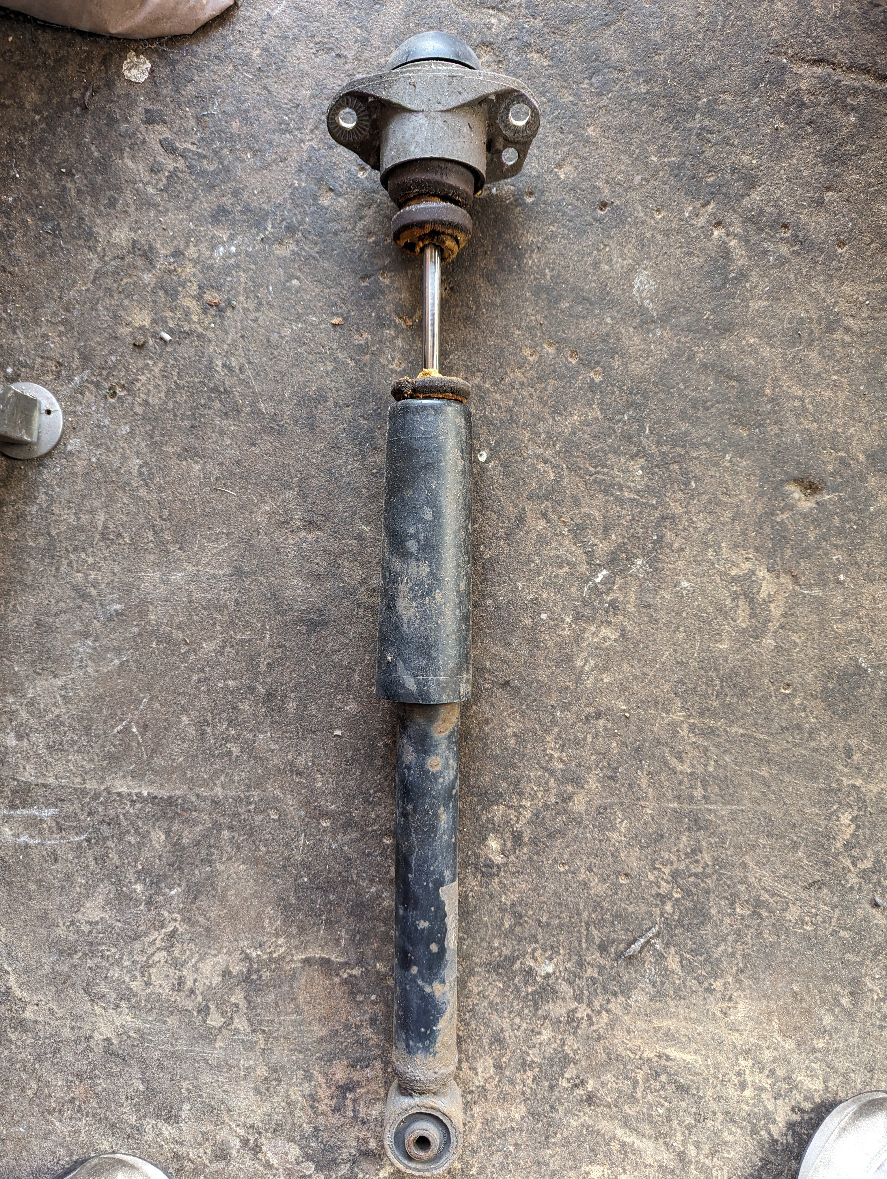

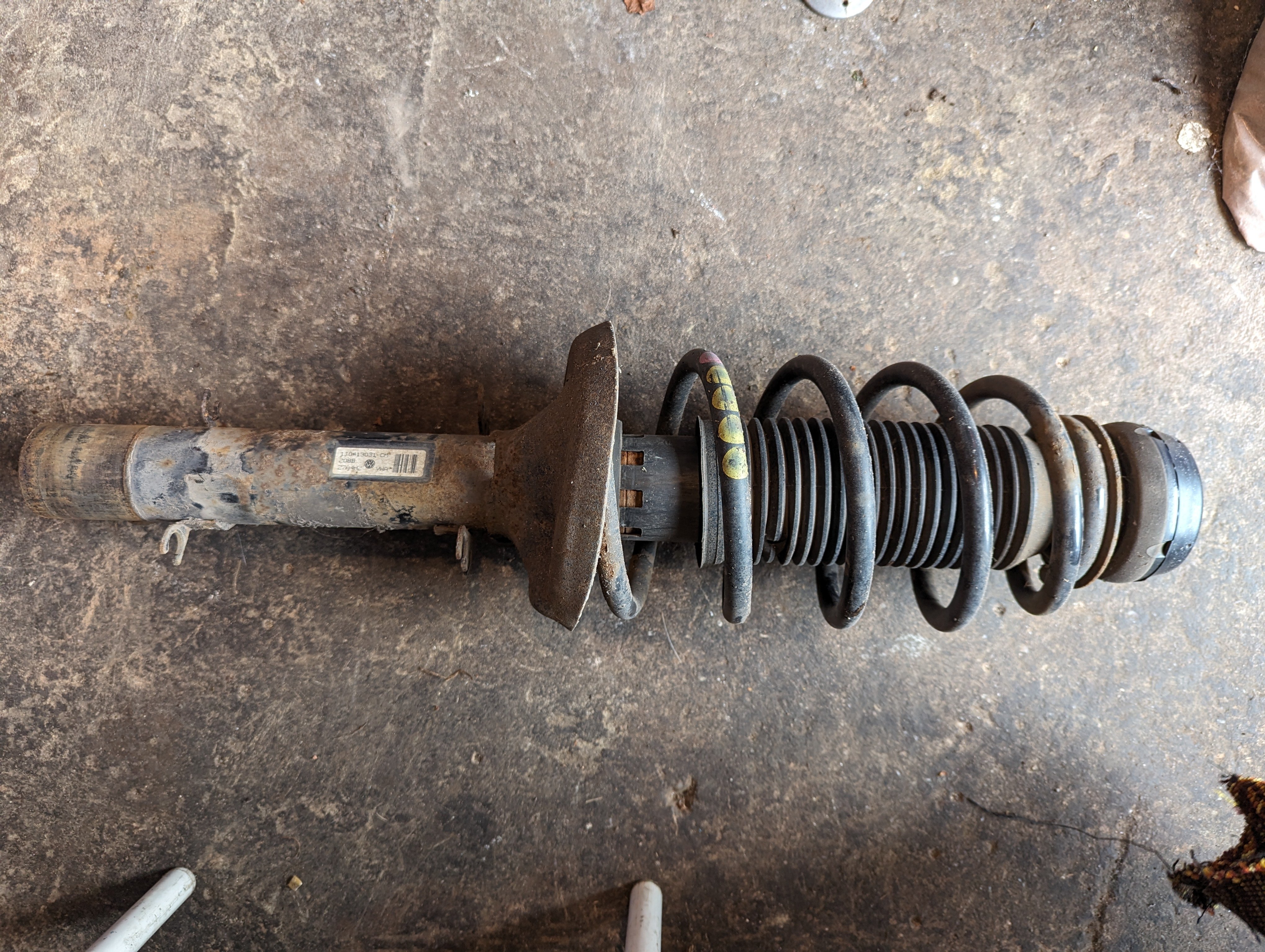

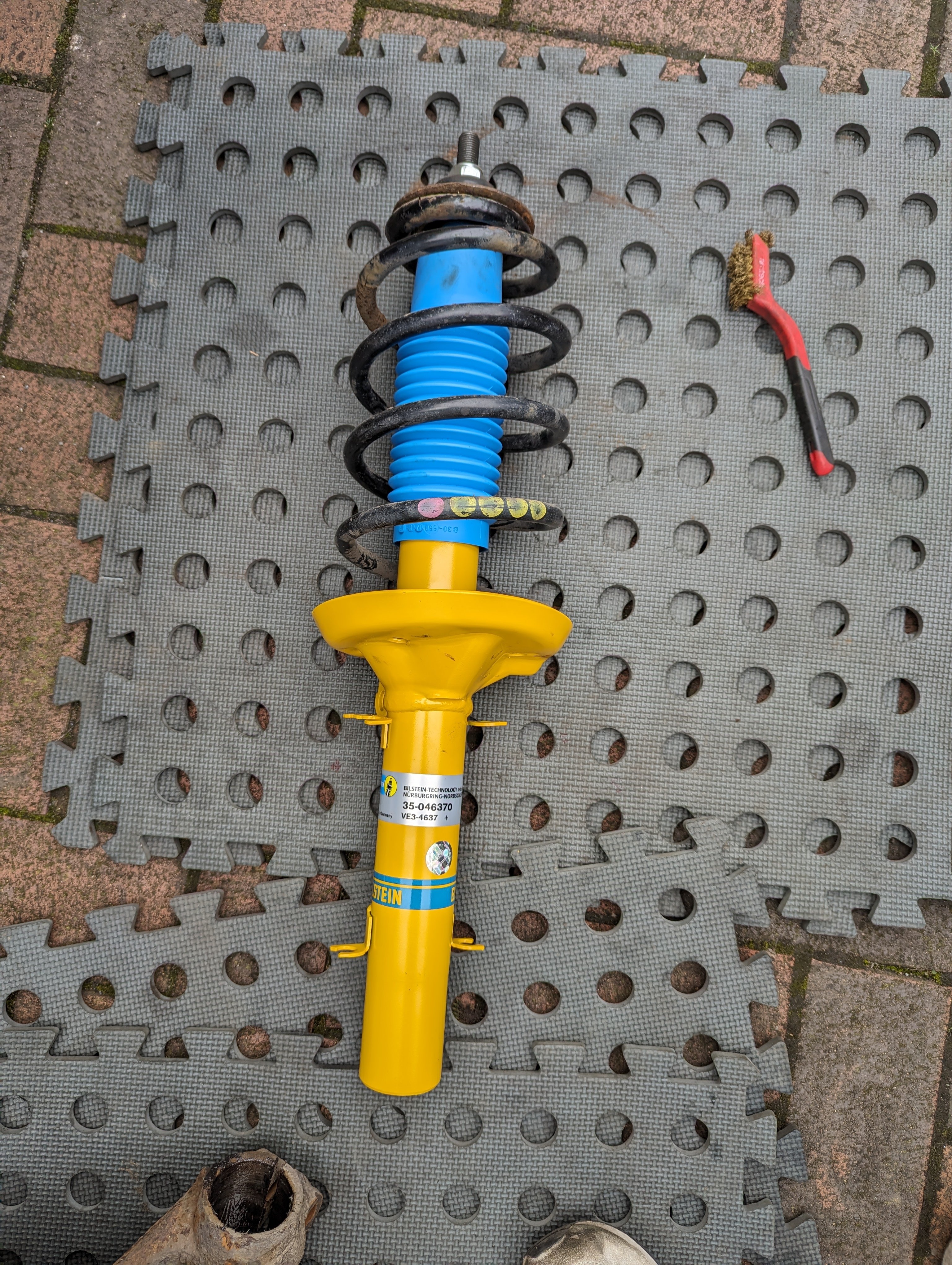

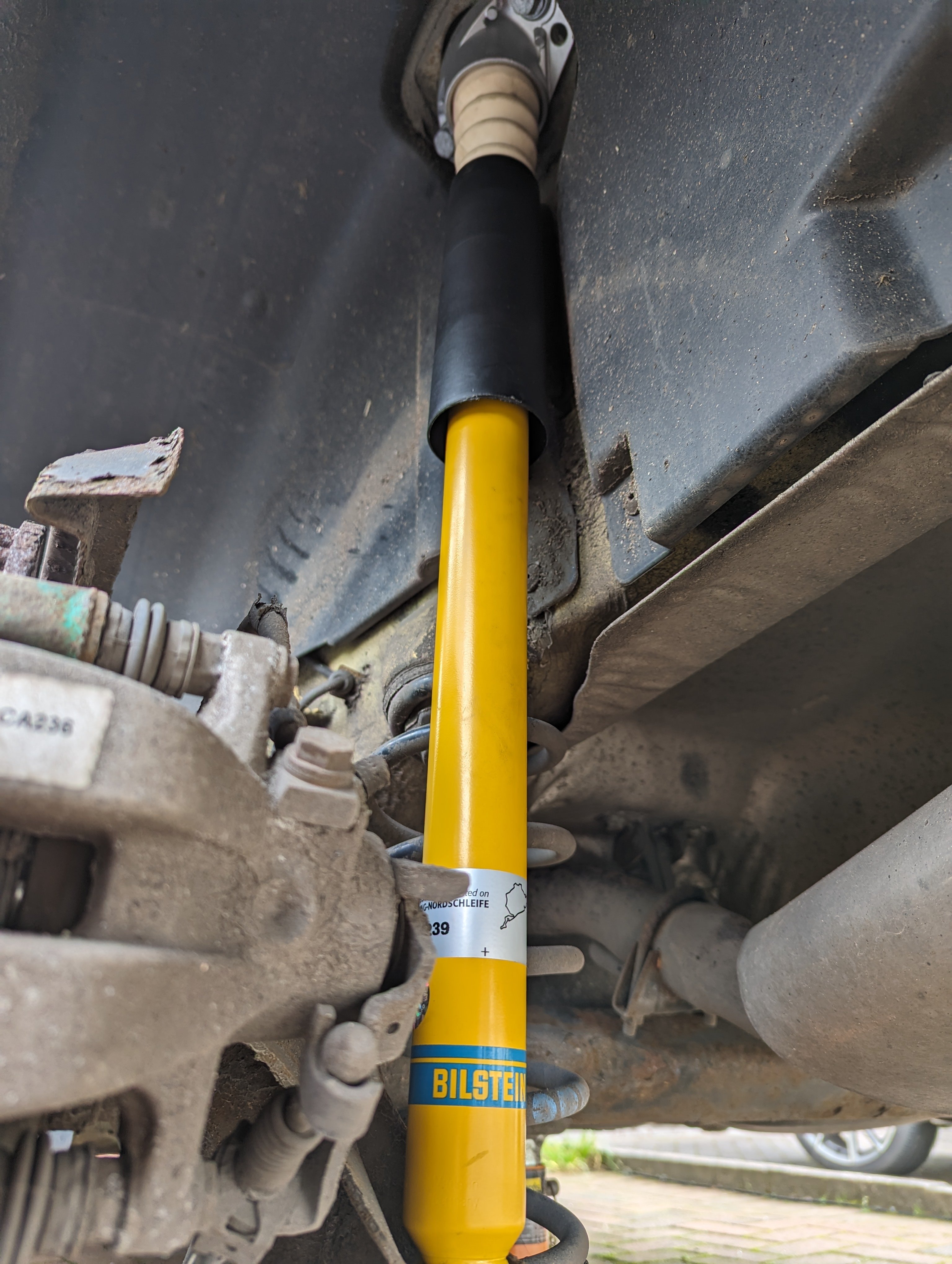

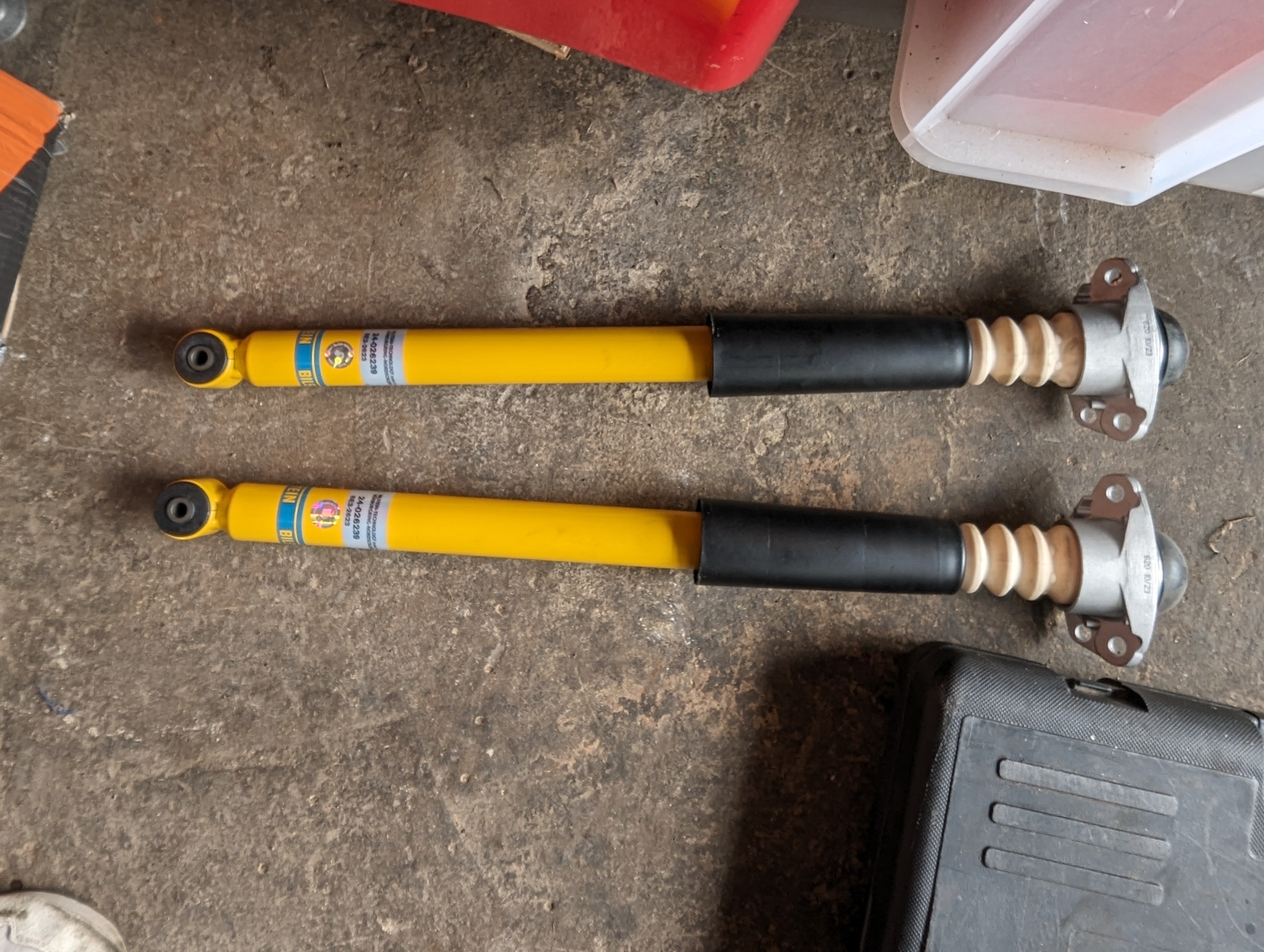

Got some bilstein b6 shocks fitted today
The old shocks don't feel like they were doing much, I've not quite finished fitting the new ones yet so I have test driven it but I bet it's a big difference
