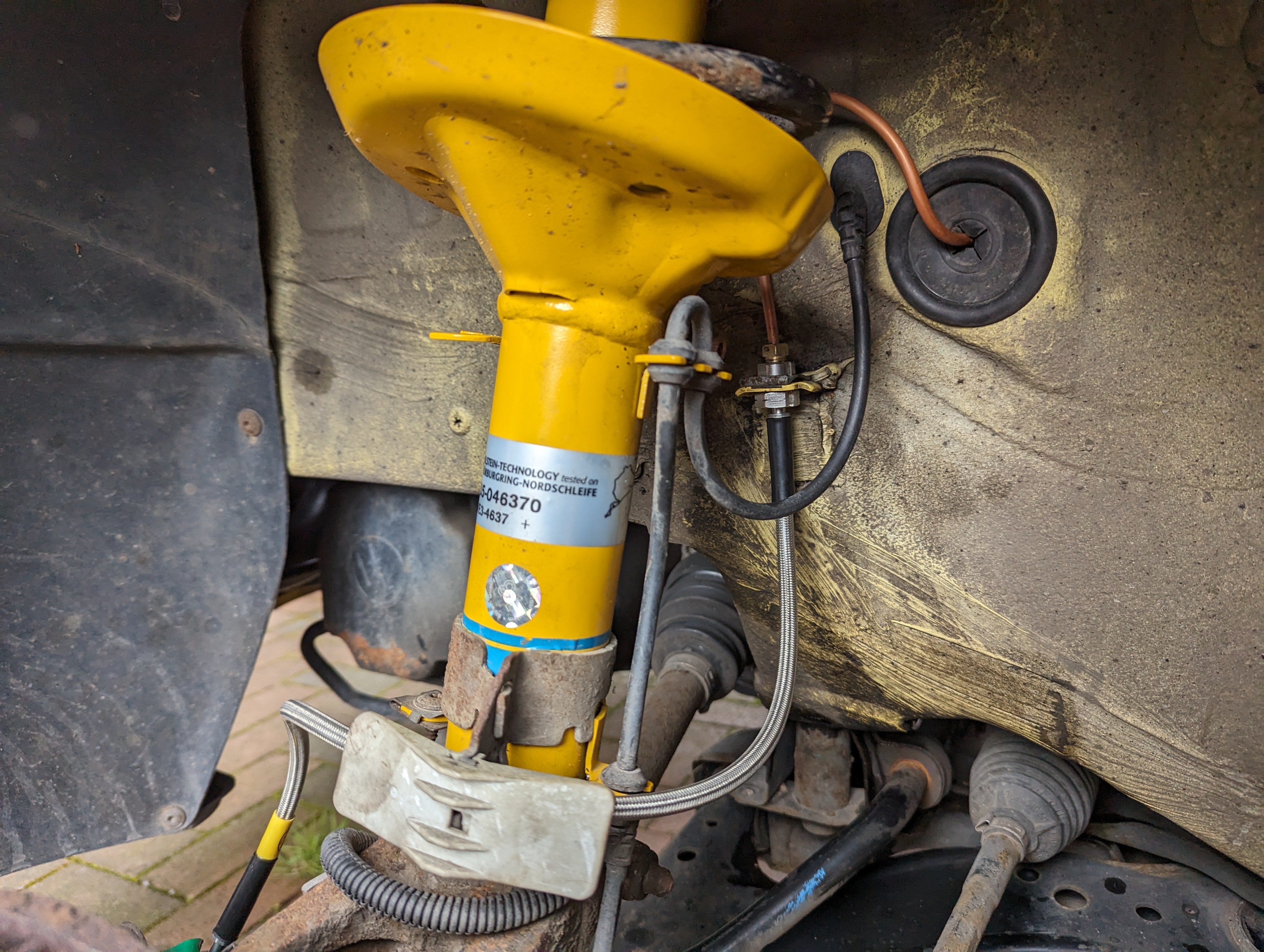

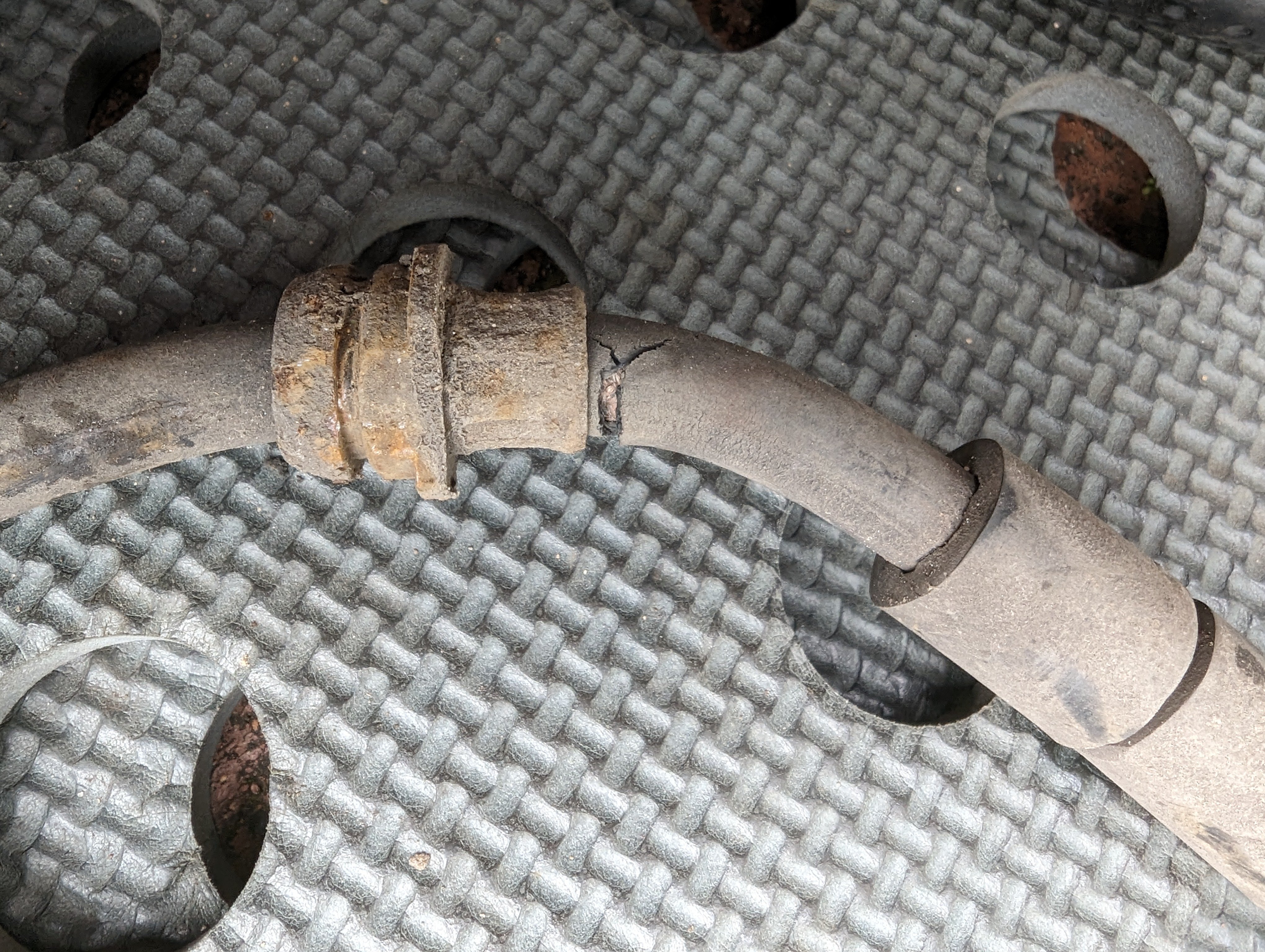

I noticed when I changed the shock absorbers that one of the front brake hoses was split

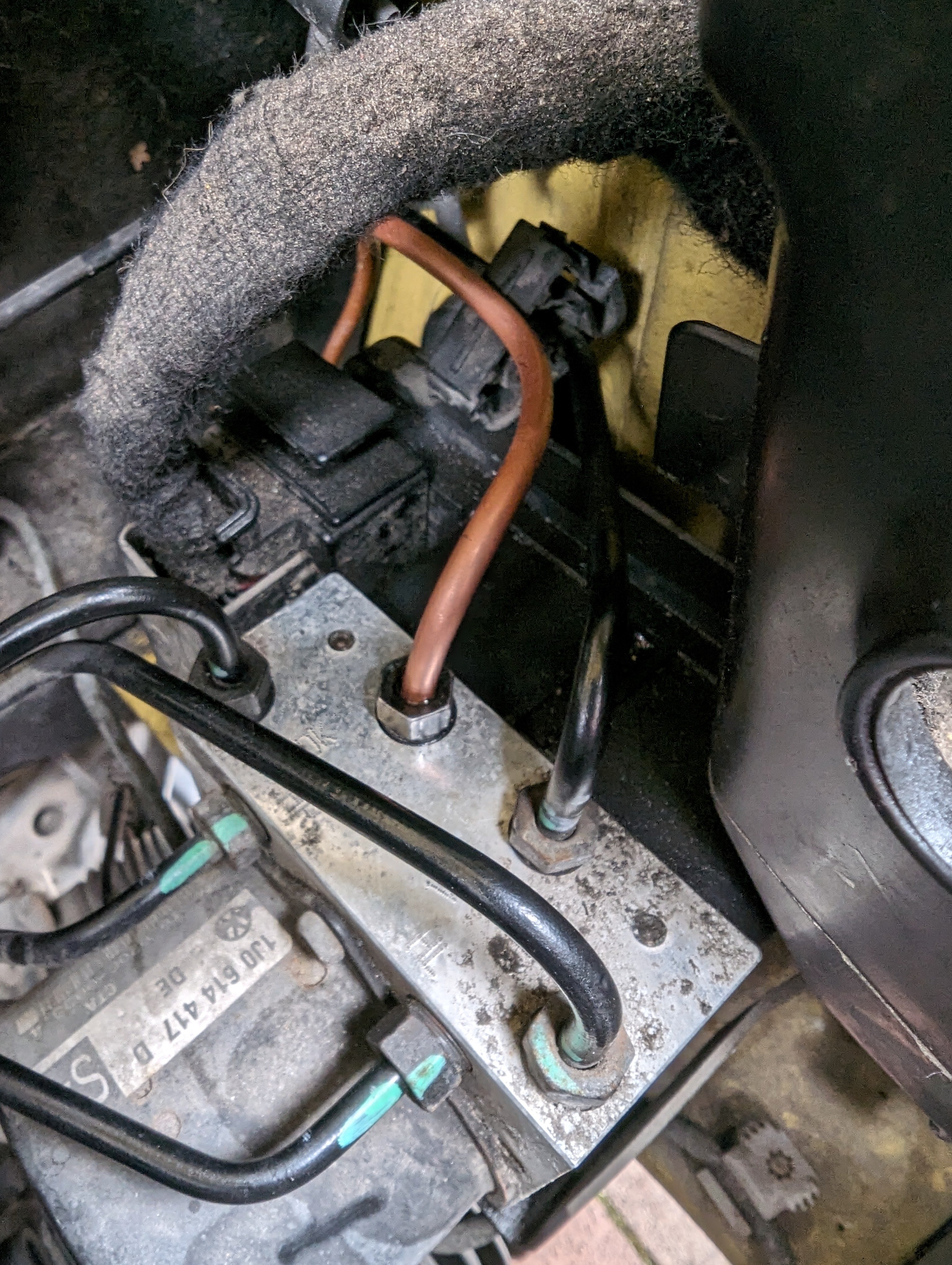

I bought a set of braided hoses to replace them all, I've only changed the fronts so far because they are a pain to take apart with damaging the hard lines. I broke the passenger side one and had to make a new pipe, I'm glad it wasn't the drivers side because it would be a nightmare to replace

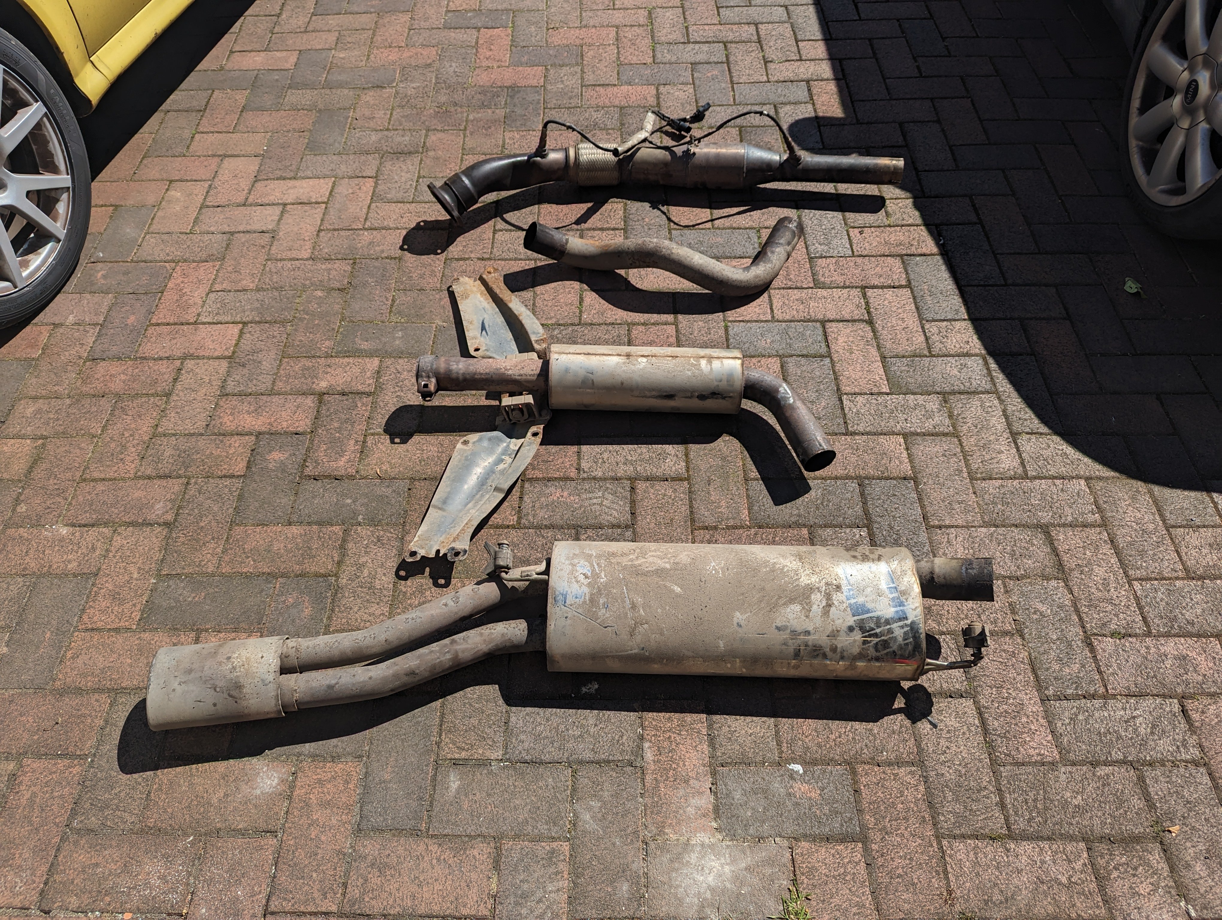

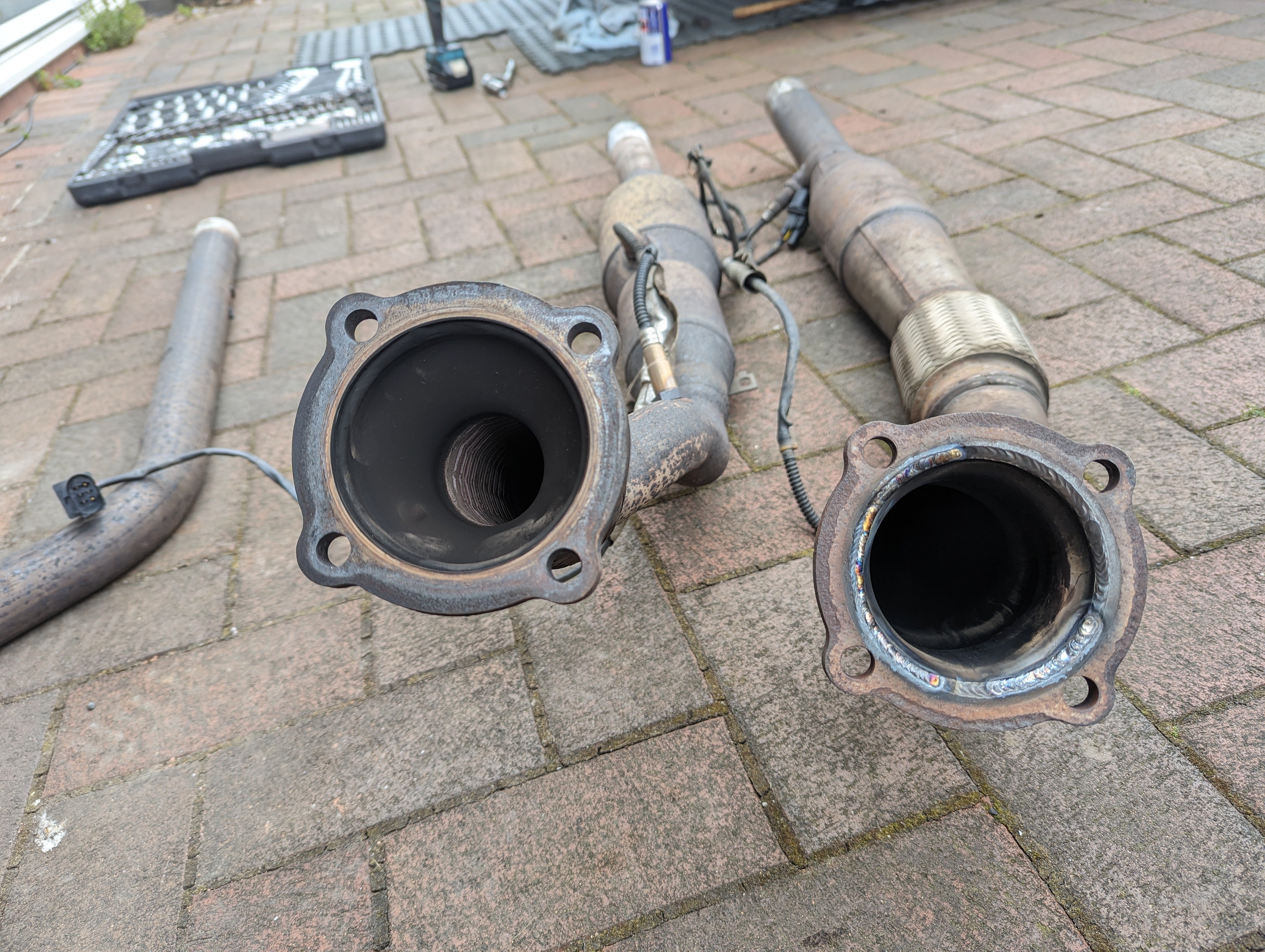

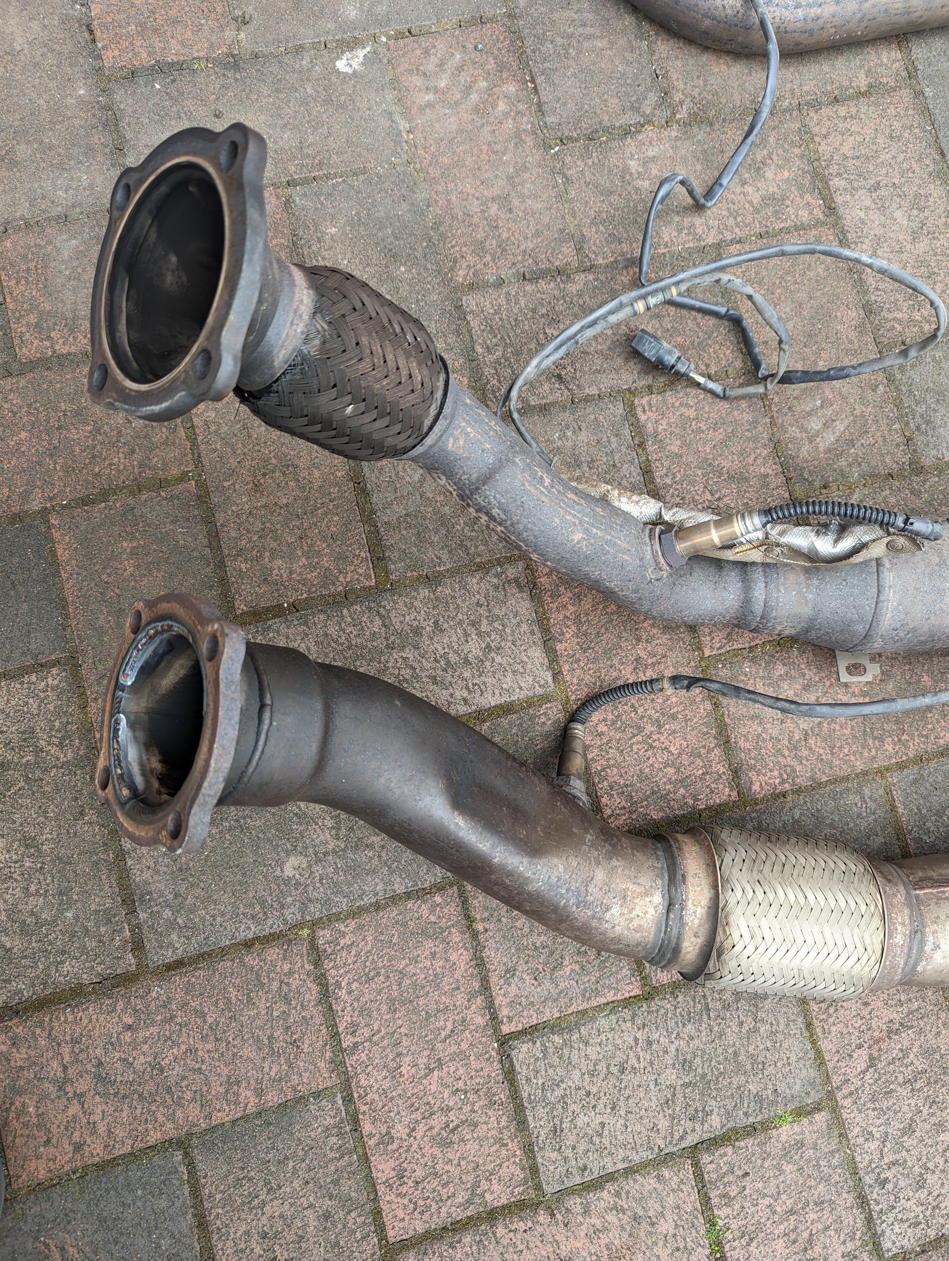

I've also got a second hand full Mitlek system 3" sports cat 2.5" resonated cat back
after a bit of cleaning and welding it was ready to fit. As you can see the downpipe is a lot bigger than the standard one
Ive done a data log and I estimate 20+ftlb of torque and 10+hp, it certainly made boost for longer and the graphs make it look like 30ftlb and 30hp but I can't see it being that much and I'd prefer to be realistic about it, only a dyno could really saypoweroldexhaust.png.836fac6b27400c8877dfa618c768bf38.pngpowermiltek.png.b0af2f92c4b28c76376a81df8358b497.png
