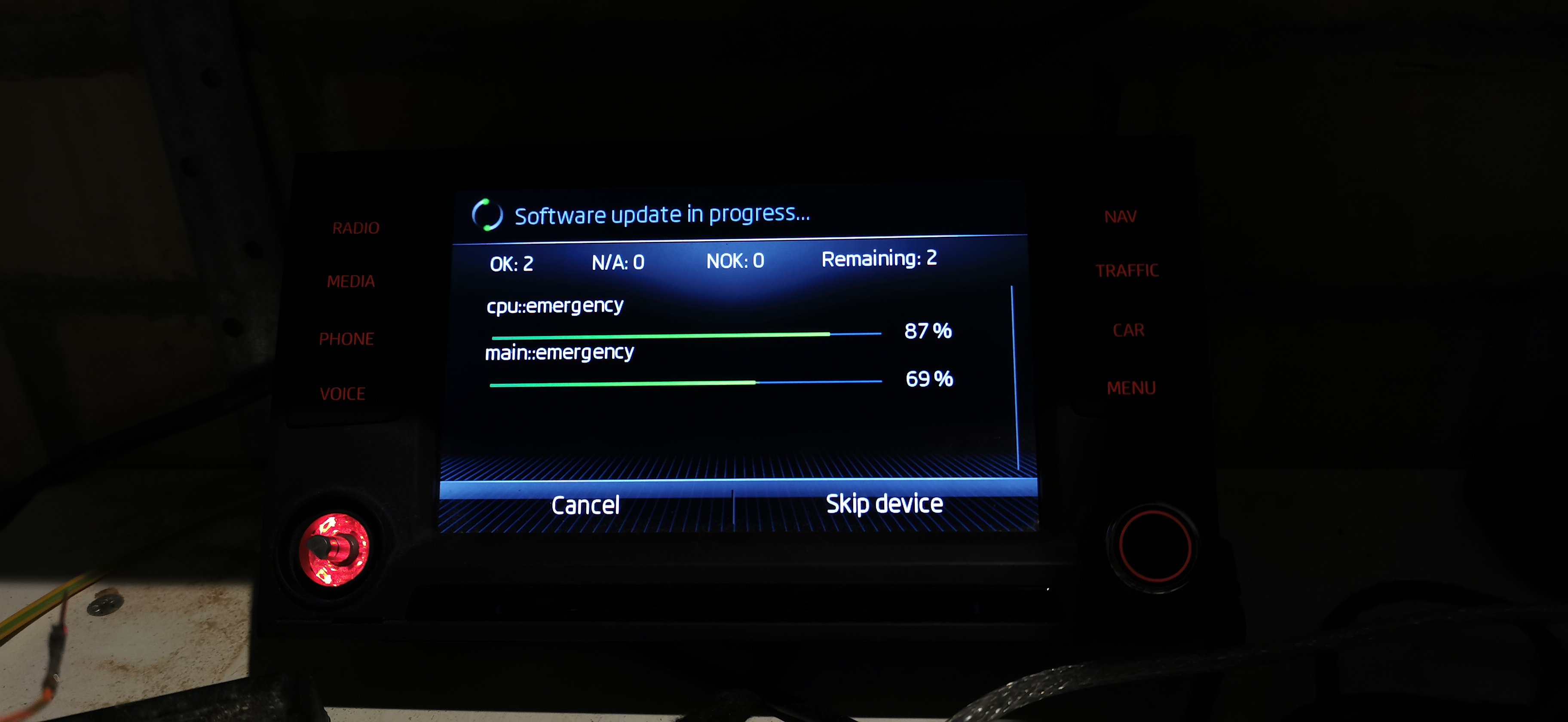

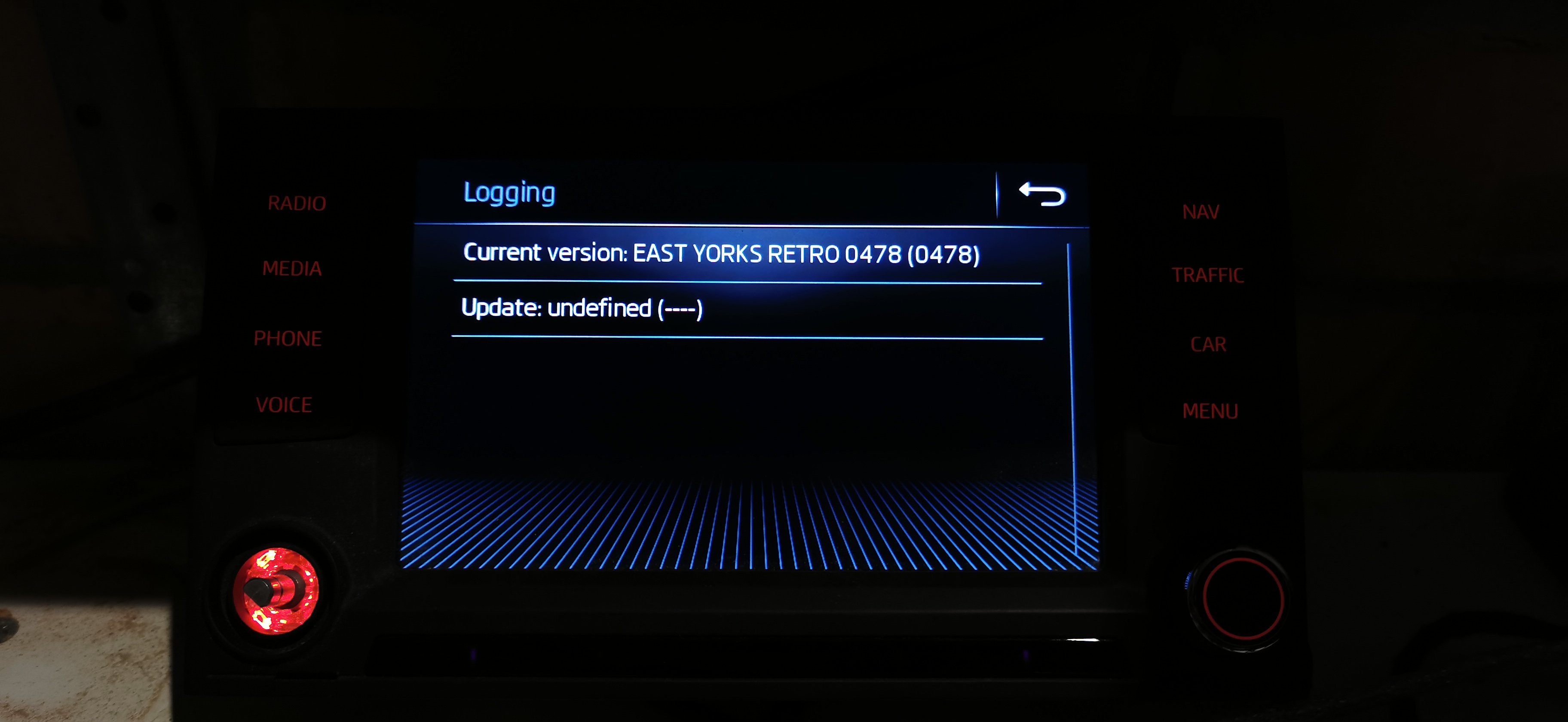

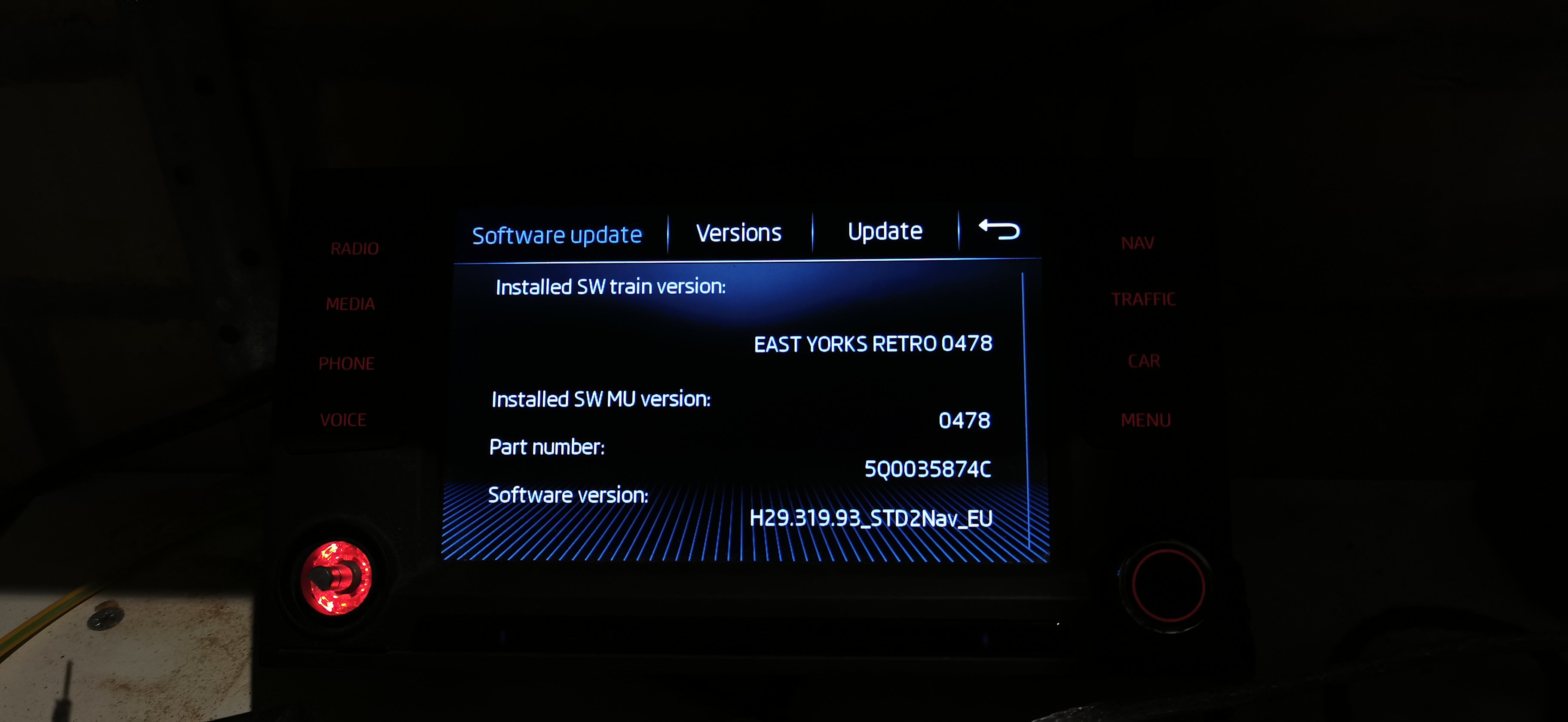

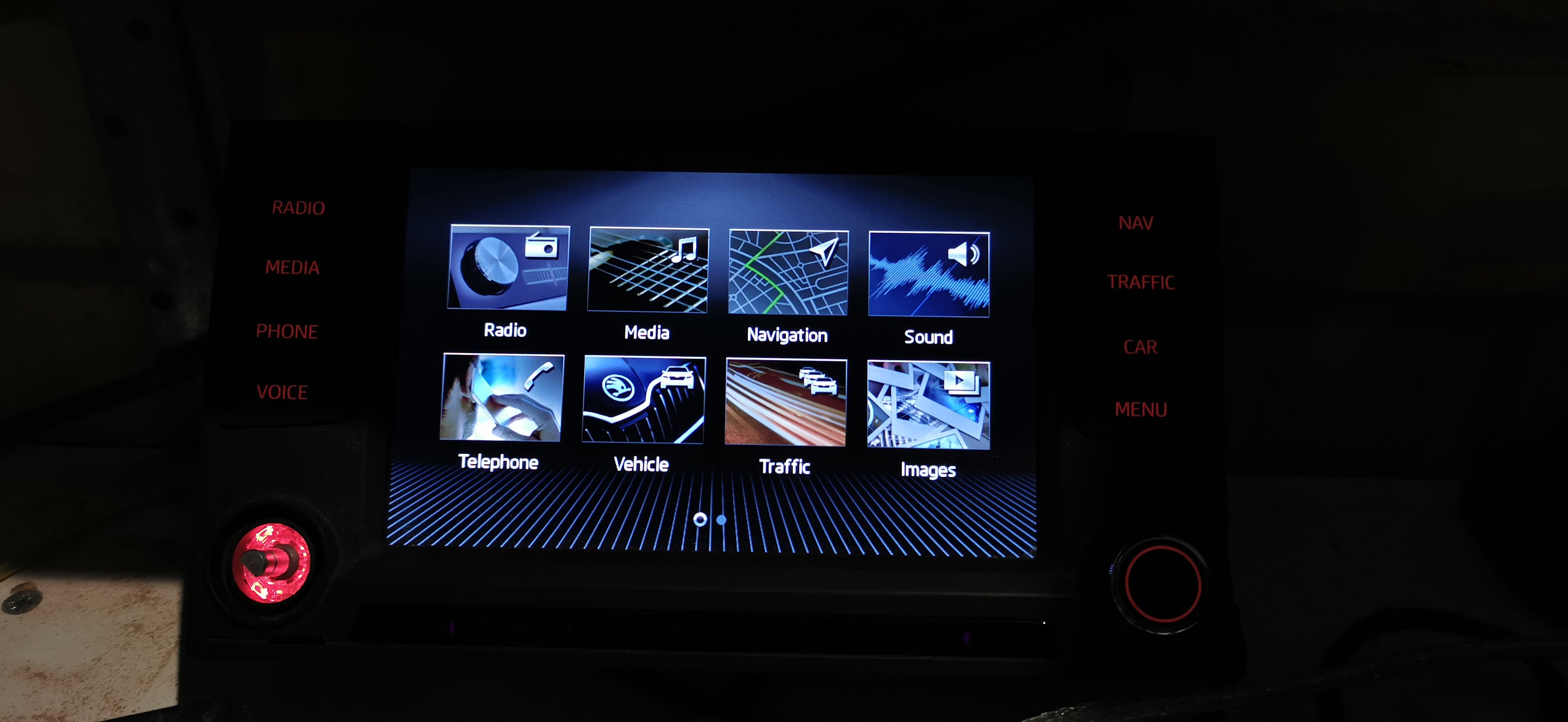

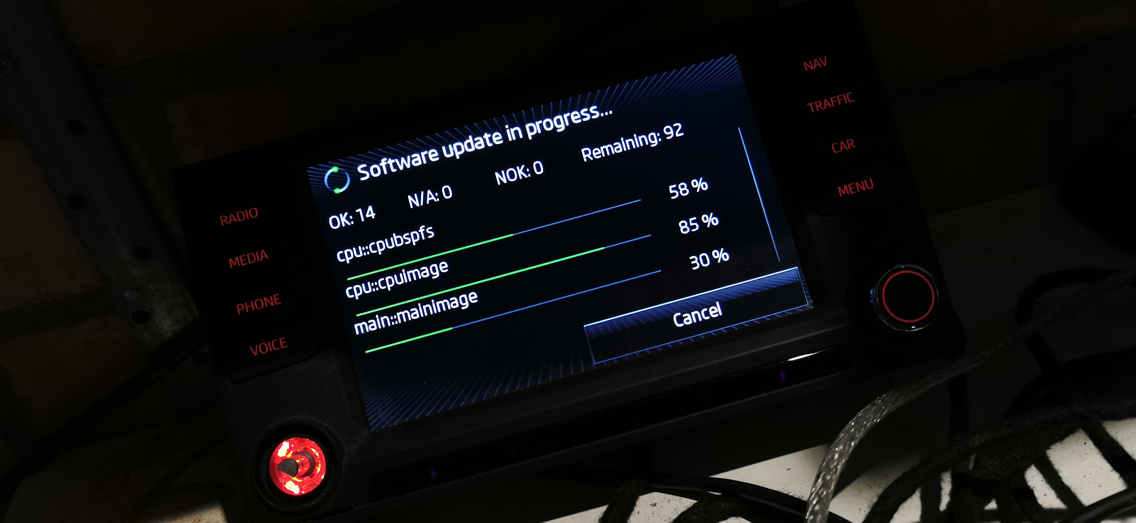

MIB2std updated from 0241 to 0478. Aswell as adding the newer type menu, this software update allows the use of a later display with "app" button & also allows units with MOST (fibre-optic) to function with a virtual cockpit. It also functions compatability improvements & bug fixes.
Completely error free, as it always should be.
