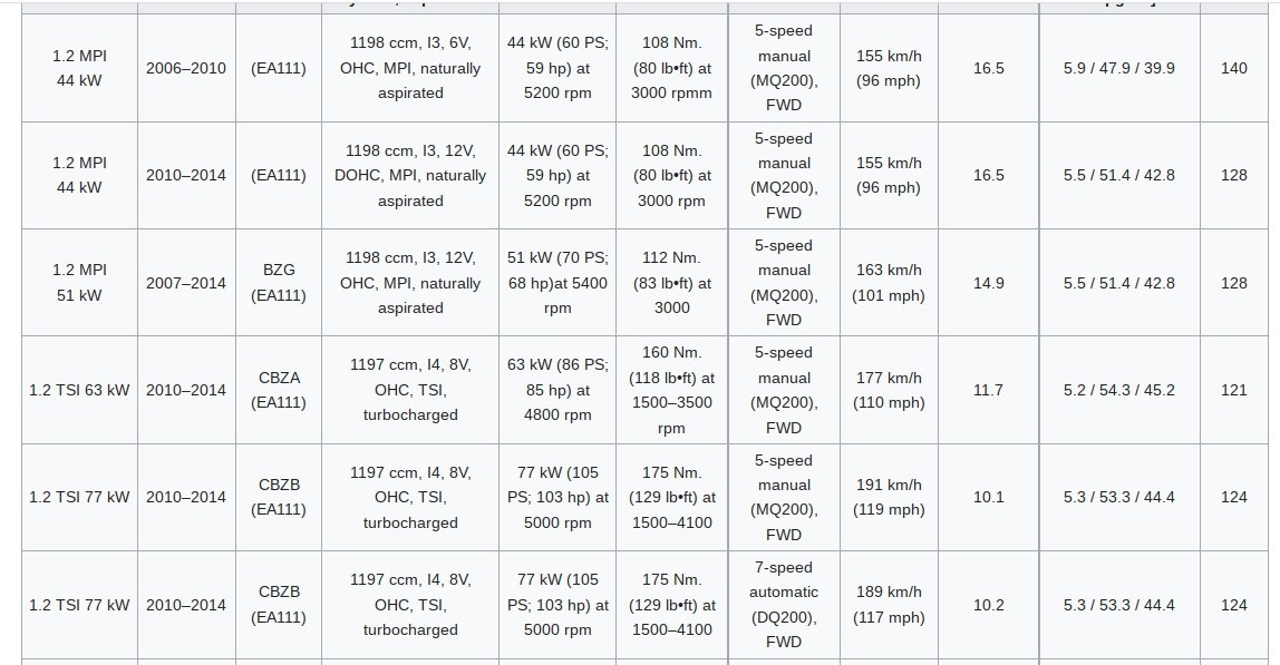

Confusion can be from 103 bhp / 105 PS if that is what you have.
It is a Cam Chain Engine.
(Plenty threads in this section on them. Plenty about chains and rattle and early ones to 2012)
From the Wiki page.

Based on the options, it can only be this one:

Try putting your car registration into parts suppliers like Halfords and Opie Oil (to name two) and that should bring up your car's details including engine number including the type code (CBZB).  You always need to cross check any information you get as all databases have errors and omissions (particularly parts catalogues, even from the part or car manufacturers).  And of course cross check any info you get from any web source, particularly if it's from me.

You have a 2013 Mk2 Fabia 1.2 TSI  Euro 5 emissions so a cam chain and not the later 1.2 TSI with a cam belt.
