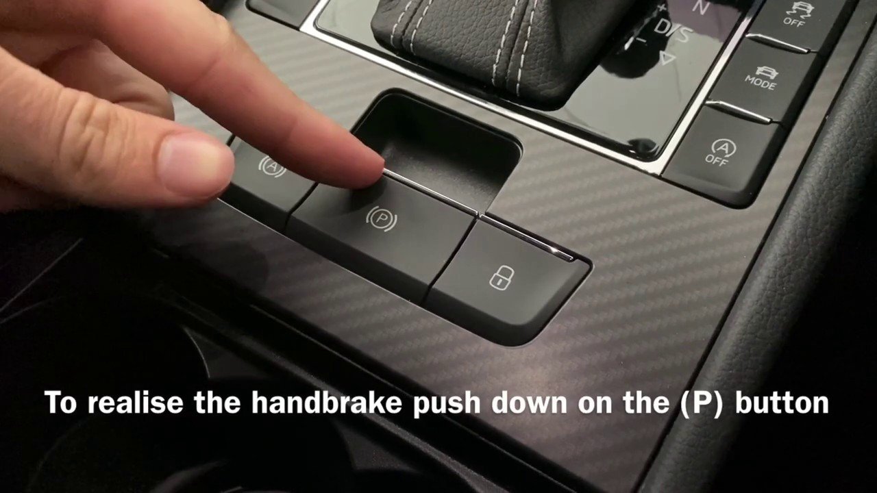

Tried on my way home today. If you turn autohold off the parking brake doesn't engage automatically at any point. Shifting to P or even turning off only applies the parking pawl in the gearbox.
Root, you say autohold doesn't hold the car. That's exactly what it does do no?
Pressing the button with the (A) symbol next to the one with (P) applies "autohold" - this automatically applies the handbrake when there is more than 5% inclination of the car.  You'll see a green (P) symbol in the dash when this is active. The button also lights up orange.
Apply the handbrake manually by pulling the (P) handle. The (P) in the dash is red at this point. It should also be red when you turn off the ignition after the autohold has applied the handbrake.

I have pressed the "A" button to the left of the "P" button and the missing functionality [ i.e the automatic application of the electronic handbrake ]  has returned.
Taa Dah !
Thanks to all for their help, I must have inadvertently switched off the "A" button
