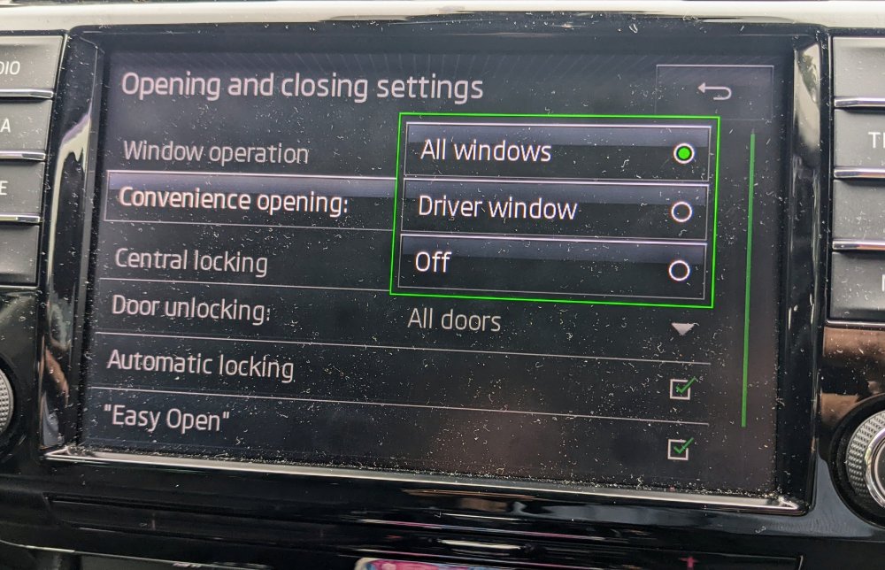

I find the feature (open/close windows remotely) very very handy and use it a lot.
If u don't like it - u can turn it off in the "Opening and Closing settings" in the Car Settings.  Change the Window operation "Convenience Opening" to either Off, All Windows, or just the Driver's window.
Interesting, as you mention All, drivers and off, mine opens only the front, both sides via remote, and ill check later to see if i have the same options as do you!

Here r the available options.  Not sure how urs is doing both front windows.....
Figured it out, had mine on all, but, my childlock was on for the back, so that must override the all, hence it opens only front both!
