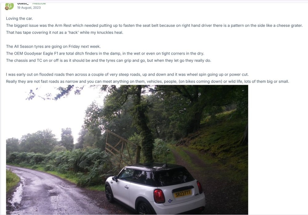

And these Goodyear Eagle F1 "designed for VW etc". Had Eagle F1 on my focus st2 wagon about 10 years ago and they were pretty nice too.
