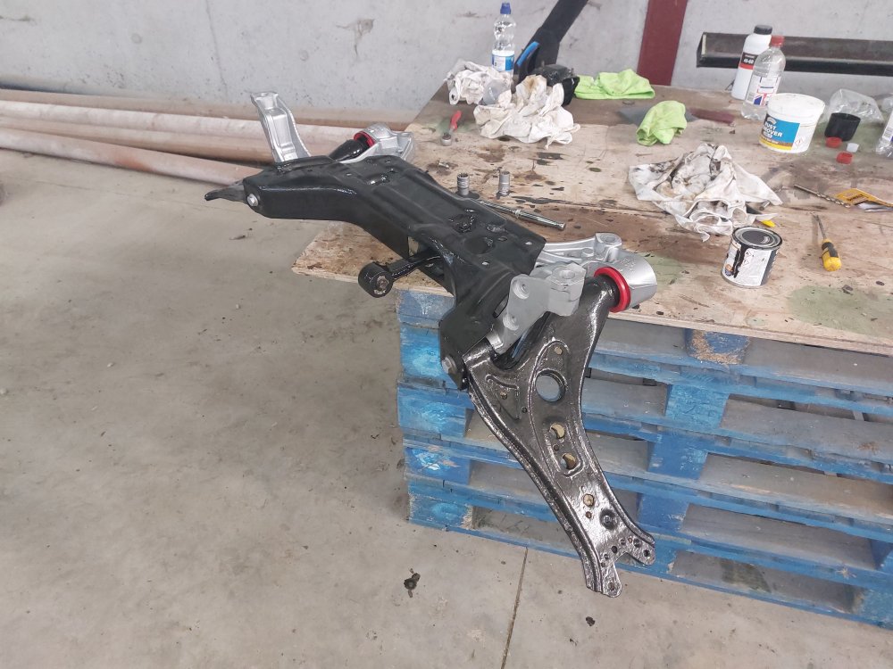

1 hour ago, DieselMonte said:
When I did my bushes I put the Wishbones into the consoles and put that into the subframe
That might be your solution here then Stewart, 'cos that way you can get a better angle to start them going in, without the subframe in the way, by the look of it.
Just be aware that front alignment will be affected if the consoles don't get refitted to the chassis in the same position as they were when they came off.
There's 5mm of slop in the two mounting holes of each console-to-chassis.

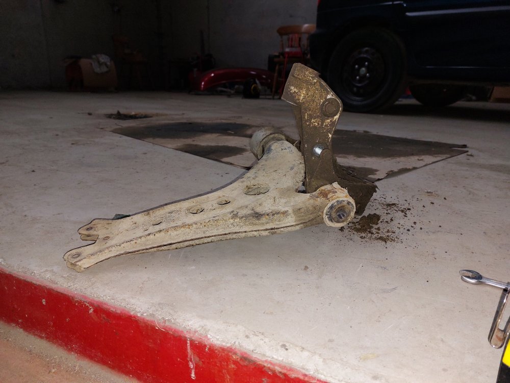

I assembled mine on the bench that way, but iirc when I removed the old ones I had to remove one stuck to the console.
If it can be removed like that then it stands to reason it can go in that way.

That's how it came out of the car.

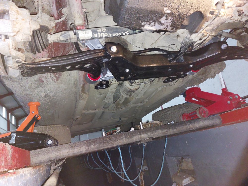

Yeah tried the washing up liquid I was using silicon spray as well slippy as chit lol I've got a heavy duty ratchet strap coming tomorrow hopefully that will give it the extra force it needs I dont really want to go down the route of stripping out subframe if possible.
Yeah, ratchet strap should do it.
Hi meant to update and say the hd ratchet strap did the trick and all sorted now thanks guys :)
