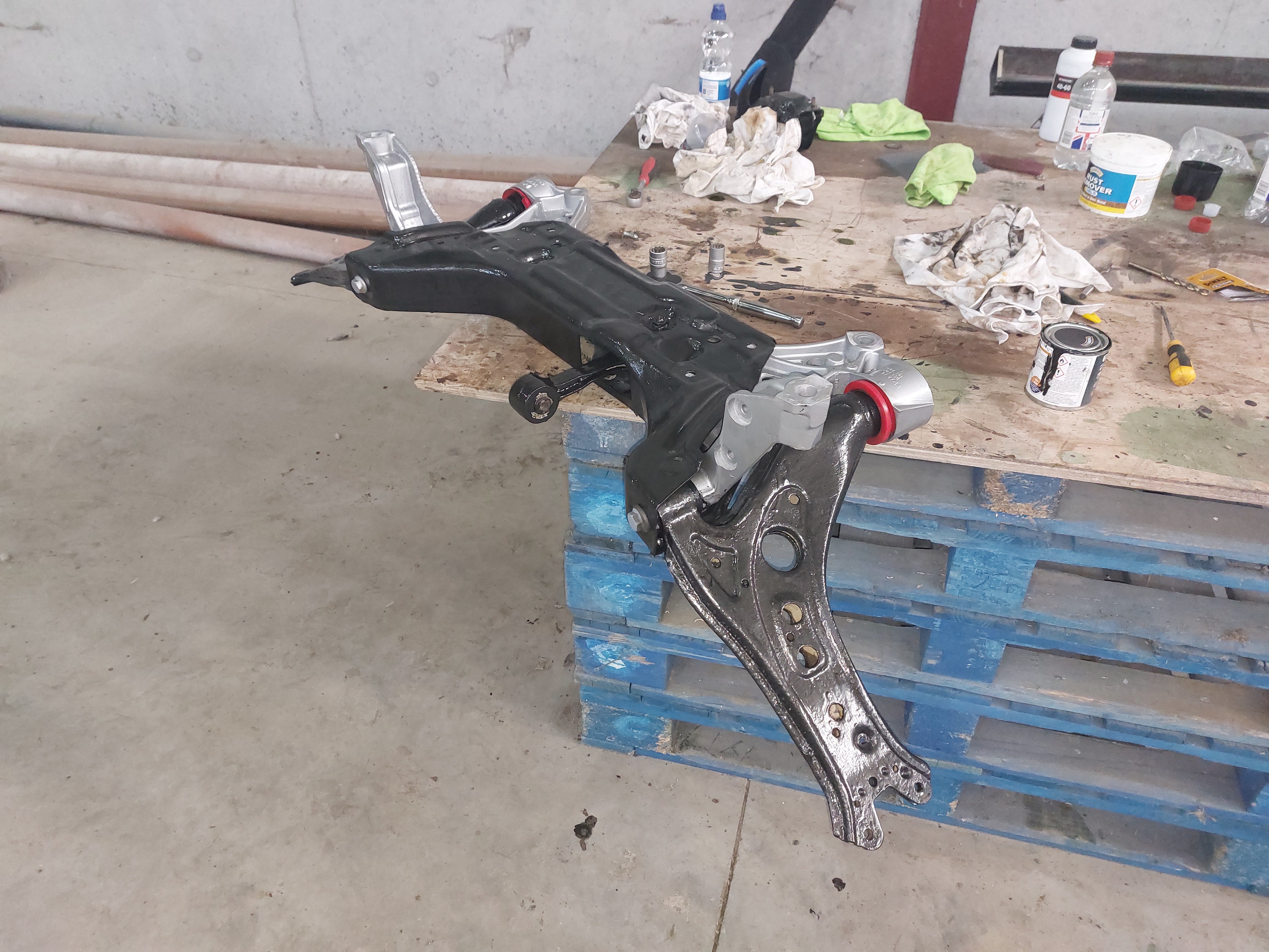

Pics? (Of the bush/insert/console)
I think the wishbone pin is parallel not tapered?, but maybe worth a measure in case there is a slight taper, and your bushes/inserts are the wrong way round for this?

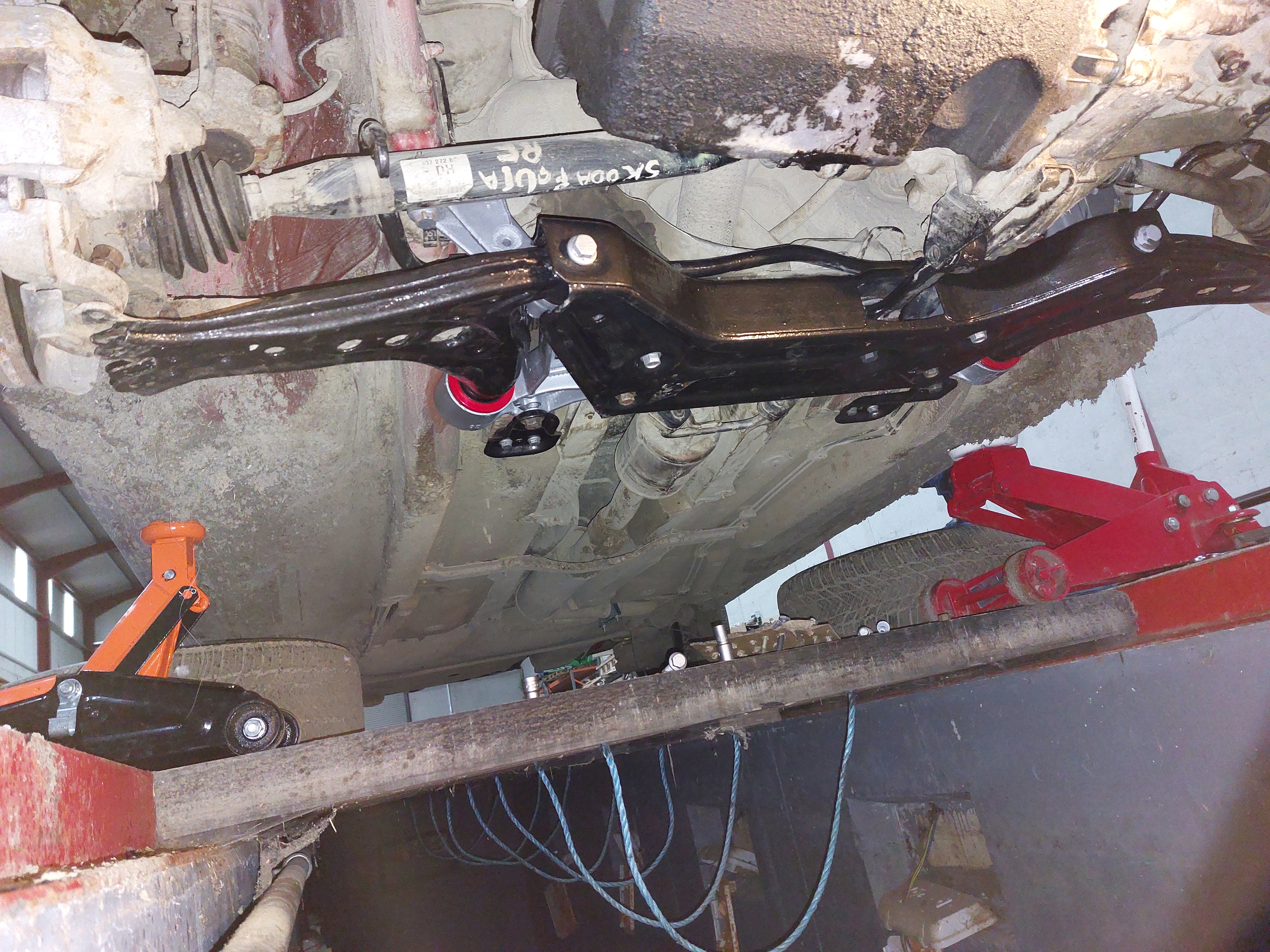

Uploading photos that'll hopefully give you some reference.
the psb bush inserts can only go in one way bud 😞
