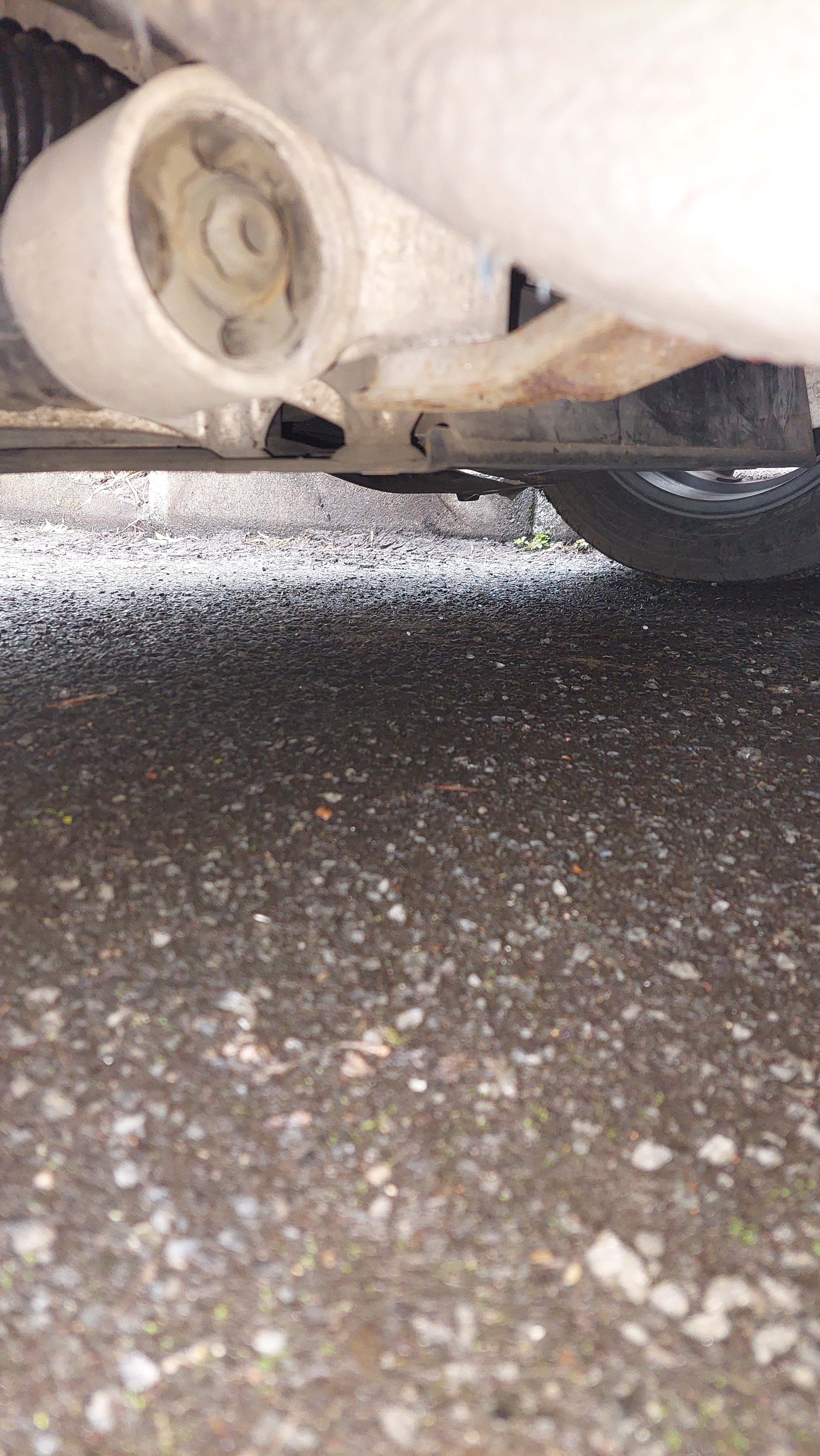

lol yeah i will want to replace those bolts thanks pete :) Quick pic of one of my console bushes.
  • Sponsor
Ah, not original.
I wouldn't expect any trouble from that design, so maybe look elsewhere for any noises you're hearing (or aren't you?)
Bit hard to tell from that photo, is that a crack in the top left rubber web?
Edited by Pete_Ex-Wino
I could only look quickly but I thought it looked like a crack in the rubber mounting as well and would be shocked if was noise from else where as ive changed everything last year as you may recall lol and yes i know I should have done these at same time im a doughnut.
  • Sponsor
That one does look like it has been there a fairly long time, but if it were original it would only have the two central up/down rubber webs, not that X-shape.
yeah i know the previous owner she had it for 13 years and says she has not had them changed so it must have been first owner which means they were changed within 5 years of new.

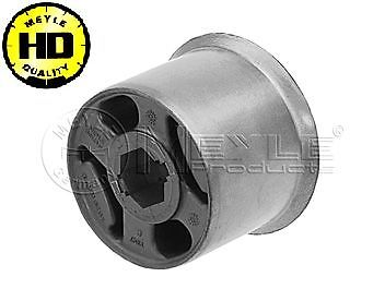

I had PSB ones on mine but found them a bit harsh. I changed them for Meyle HD ones.
58dba87f11249-Meylefrontbush-png-57d156f

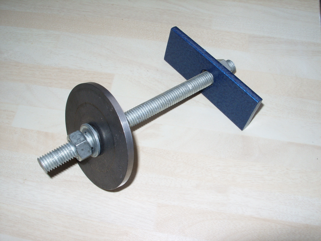

Went in very easily with a home-made tool.

In the factory workshop manual it shows the standard bushings have a moulded , I guess pimple is the best description , indicator (1) which you line up with a mark on the console (2). I assume as the TCA has a hexagon shaped locator this is to ensure the TCA sits in the correct orentation.
Looking at the PSB it looks like it is has a small cut out on the edge of the inner material to align the same way?
