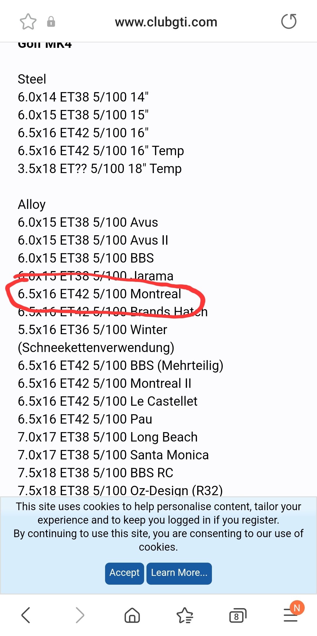

One other thing, what did things look like when you removed a 16" VW Montreal from your car, did you spot an adaptor to change the fixing bolt spacing from 5 X 100 to 5 X 11?, I've forgotten the PCD of these Montreal either 112 or 115, and if so, was it a VW specific adaptor that had built into it a bore diameter change to help centre these wheels?
Normally when you fit wheels that have a different centre bore, you can fit a "bore changer" into the centre bore of the new wheels and that will then fit snuggly to the car's hub centre bore, but if your car has already got an adaptor on that hub, there probably will now not be an centre bore projection, so that easy fix will not work for you.
I was under the impression that Montreals came in 5x100, no?

Not as far as I know, maybe in theory they are listed as being offered, but that was as far as it went.
Okay they were offered on the earlier Polo GTI ie 6N last of the true "VW" Polos before the change to the Fabia based Polos, in late 2001/early 2002.
Edit:- you will notice that none of the alloys used at factory on 9N Polo are on that list, these seem to be pre "new Polo" wheel options, or even dealer fit post sale options.
Montreals were fitted to Mk4 golfs, which are 5x100. Mk5 golf onwards is 5x112.

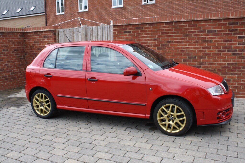

Pic of Montreals on a Mk4927989644_SideViewsmall.jpg.b7c4560143bd147c2cd673abec605937.jpg
All a fabia is under the skin is a b*stardised Mk4 golf.
Even better, a vRS on the same wheels.
The acid test would be to find out what the VW part number is on these rims, I wonder what the centre bore of the Golf Mk4 is, or if it is the same as a 9N Polo, if it is just a centre bore hole in the wheels that is too big, then fitting suitable nylon concentric bore adaptors to these wheels should sort things out.
Sorry but I'm pretty confident these were fitted from factory.
These Polo GT TDI are pretty rare so I've been monitoring them to see when they come up for sale on eBay, Facebook, etc etc to see what mileage they have and what condition they've been kept in, and they all have 16" Montreal alloys, every single one and I must have seen about 50 now. Their also isn't any adapter's either.
I've also had the car for 7 years now and only in the last 2 has it been like this so the alloy size isn't the issue in my opinion otherwise it would of been like this for the whole 7 years of my ownership.
I am however in agreement that they sold the Polo sport with the 15" Melbourne alloys as you describe but the GT model had Montreal.
