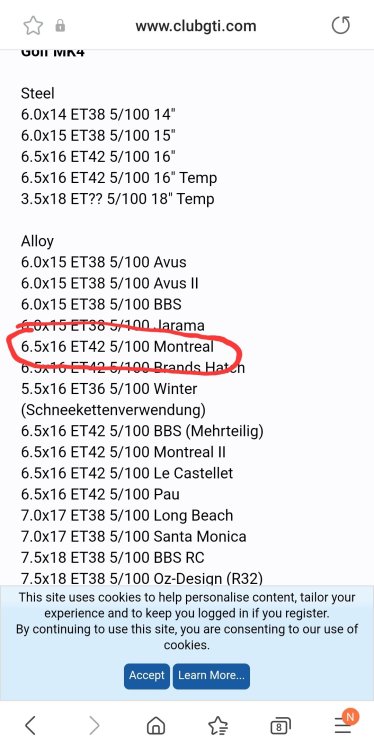

@Tomjones1995 Well, if it helps any, a standard VAG alloy will have the size information cast into the rim, something like "16x6.5J ET42 5x100".

    It's a difficult decision and what I've decided i'l do is purchase some new/ decent second hand alloys and see if that fixes the wobbling, rumbling and if it doesn't see if it's a wheel bearing.
