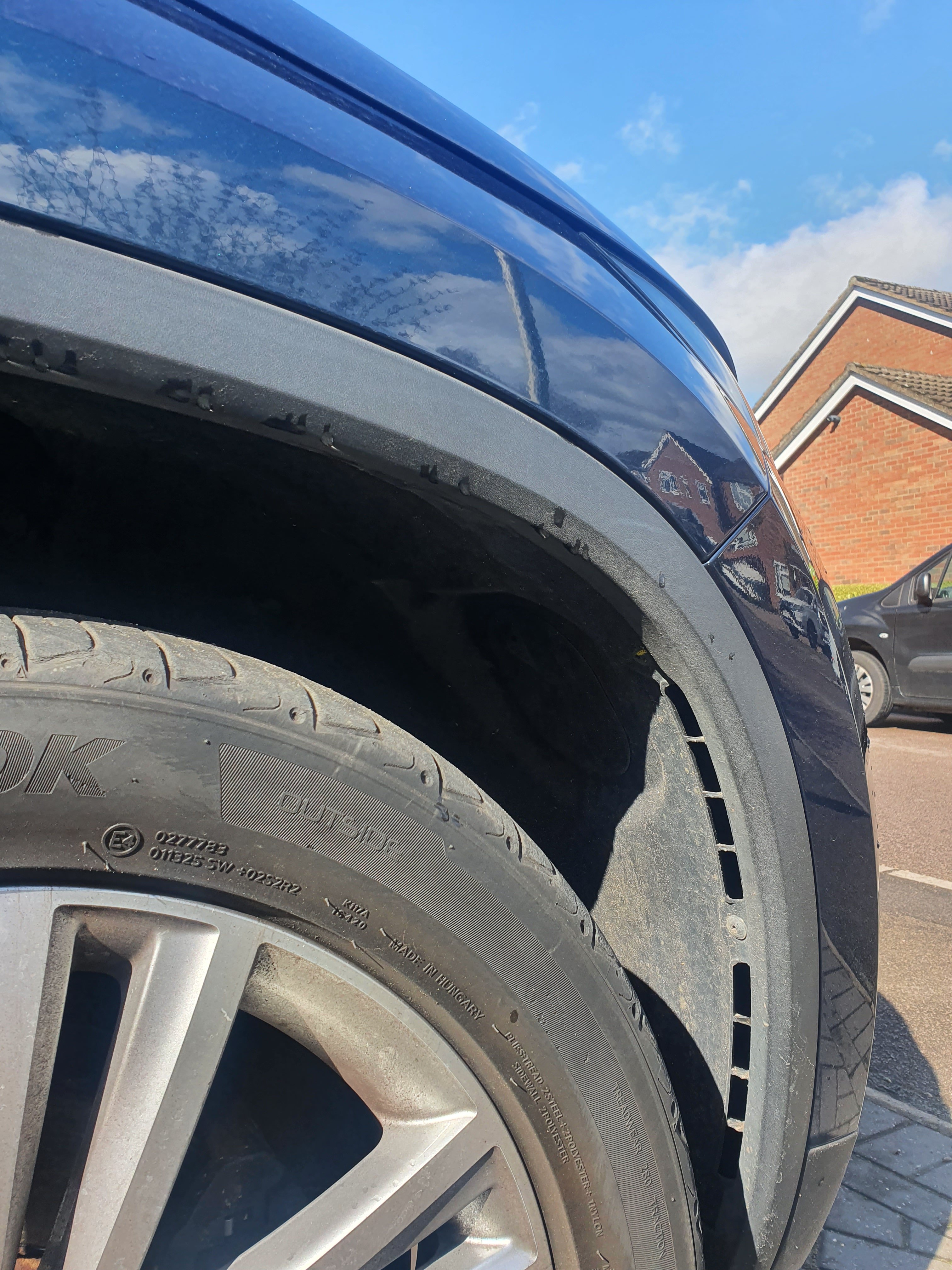

I've done a little search and can't seem to find a definitive answer. I noticed from the marks after a quick drive to the shops in the rain that my Kodiaq doesn't have mudguards.
Are they worth getting?  I'm was thinking yes but then I came across a couple of posts saying they were pretty pointless and didn't stop damage from gravel, and in fact trapped dirt.
I'm not worried at all about mud/dirt. I actually quite like driving a car that looks like it's been off road at times before getting it cleaned!!
It's just more about long term damage from stones, etc.
What are people's thoughts? Worth getting some mudguards fitted or not really bothering?

Definitely 'A'. The older ones will damage your car - see pics in the thread linked above by @SimonB68

I too have never seen a Kodiaq without a plastic wheel arch trim but be careful if you're a Karoq owner. Some Karoqs have plastic trims others like our Edition do not.
