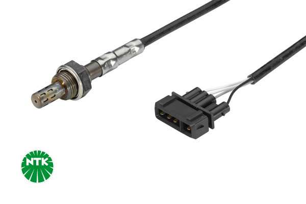

NGK LP42481
Yes but are the same?
Brand: NGK NTK
Manufacturer Part Number: OZA457-I1
Short Code: 0414
Product Type: LAMBDA SENSOR (OXYGEN PROBE)
Quantity Supplied: 1
Hex (mm): 22
Thread Diameter: M18
Thread Pitch: 1.5 mm
Placement on Vehicle: Rear
Number of Wires: 4
Cable Length: 516
Or the LP42481 of that store is a different model?
I asked the shop, the NGK OZA457-I1 is on the 6U0906265E but which is? LP-42481 or LC-9856?
No answer, so what must i choose? Why the store does not clarifies which NGK has?
There is anothe NGK in the market which covers the 6U0906265E is the No: 92142 (the OZA457 is No: 0414)

The programmer was sceptical about the Bosch and suggested me to buy the original (which was NTK) so i bought today from an e-store the NGK OZA457-I1 which covers the 6U0906265E plus it had some photos to check that is the same that my car had from the factory.
15_a_ntk_036_bmp.jpg?v=a3
EAN 087295104149
Trade numbers OZA457-I1
Manufacturer Part Number 0414
If an e-store does not have pictures and does not clarify which NGK is of their own codes then he can keep the LT-4593 or the CD-6789 or the DR-9821 or the NB-2940 etc product as a precious secret same as the coca-cola receipt.

I can not find anything on the internet about OZA457-EI1A/01.
The new sensor is almost identical to the old one and this makes me extremely happy!
I do not know so just a guess, the 1A/01 part might just be a reference to packaging, that is it is not a box of 10 or 10,000 but a packet of a single item.
Good to see it has the anti-seize already applied and protected.
