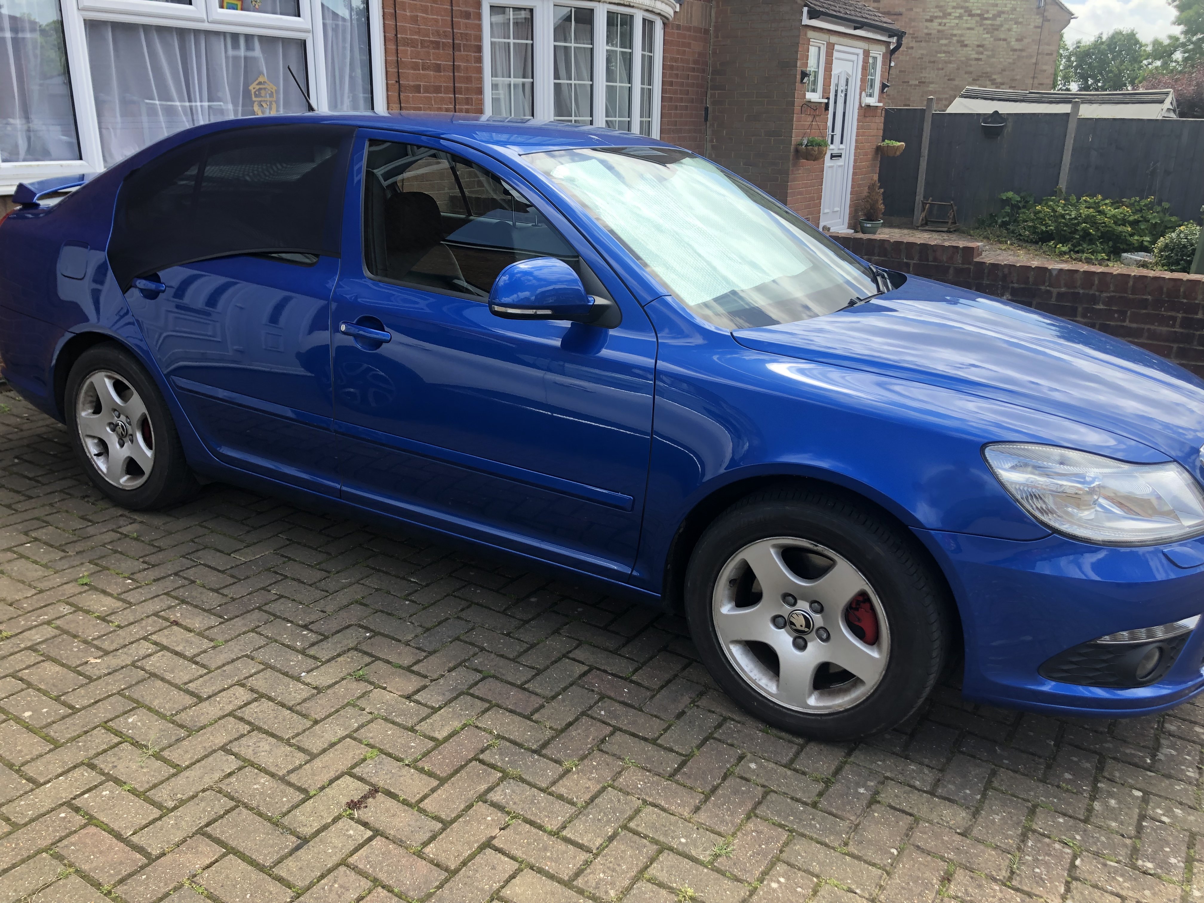

Mine is on standard suspension and the eldest complains of being travel sick on country roads. Only had it for 1 week and complaints already 😞
Gave them the choice of the VRS or a C250 and they wanted the VRS!

I have the black 18" Zeniths at the moment. They are crashy but look good.
My car has quite a few cosmetic mods (full RS+ kit with black front splitter, rear diffuser, honeycomb grill, sideskirts, black spoiler) so I think 16s would probably look out of place.

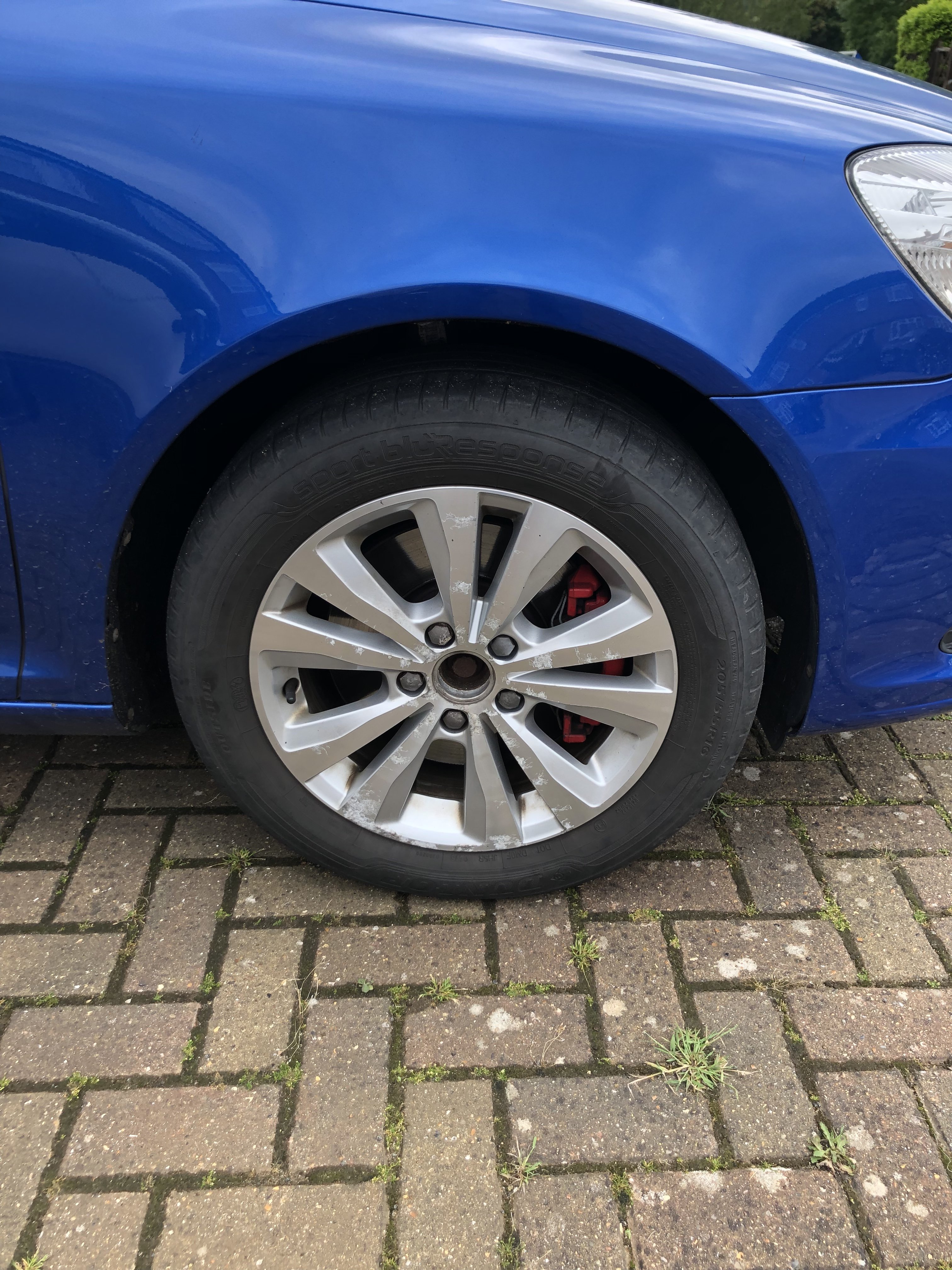

Will ET50 steels fit over the VRS brakes?
Swapping the shocks for something like b4s should make the ride a bit softer as b8 is a performance shock and the low speed ride can be quite harsh.
The Octavia MK2 VRS uses 312mm diameter front brake discs, so 16" rims will clear the front brake calipers.

I have now fitted a set of Mk7 Golf 16’s and the ride is more settled.
Also the DSG feels quicker to engage and change gear. Maybe it’s just in the mind!
They are Toronto rims as shown below.
If you want a spare, it makes sense to match the 6.5Jx16 ET46 specification, rather than the Octavia MK2 6.5Jx16 ET50 specification. The change in offset from ET50 to ET46 will move the centre of each wheel 4mm further out in the wheelarch.
TORONTO 6.5JX16 ET46
(1) 5G0 601 025 aluminium rim 'TORONTO'
6,5JX16H2 ET46
5/112
  5G0601025  8Z8 diamond silver
https://volkswagen.7zap.com/en/rdw/golf+variant+4motion/golf/2016-746/6/601-601055/
Edited by Carlston
6,5JX16H2 ET46
5/112
