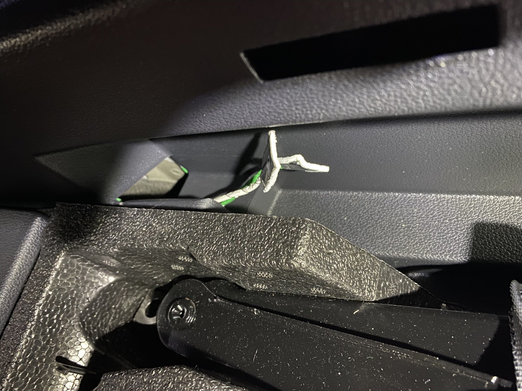

Hi @Teir, do you mean this:
I have been wondering what these wires are for... asked the dealer and they had no idea...

Hey,
No, not those, sorry! Those wires are something to do with moisture detection during the factory build. They have no use once the car is complete. Tuck them away and forget about them. The towbar prep wiring is much chunkier and isn't visible without removing trim.

thanks for the heads up @Teir   Dealer insists it has something to do with the sense for automatic boot kick release. They know nothing … grr. You’d think they’d know their own product

@TeirDealer insists it has something to do with the sense for automatic boot kick release. They know nothing … grr. You’d think they’d know their own product
Do you mean the dealer is saying the virtual pedal isn't working because of the loose green wires?
Yessir. They are hopeless!
