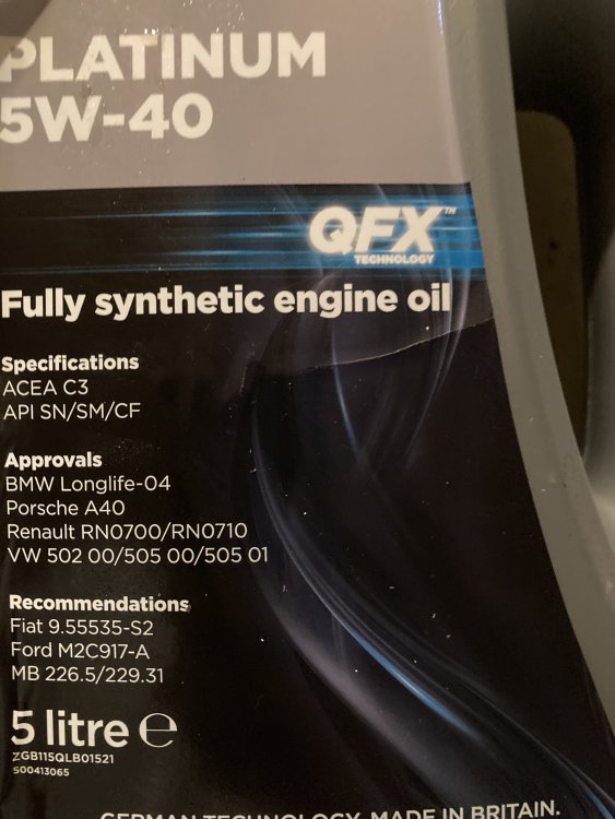

What's the VW spec number thing?

This is the detail off the old can

That's the stuff my Fabia takes too, IIRC. Can't seem to find it, so I think you're right. :sadsmile:

I heard it going to be replaced next month no other details yet.

ASDA / Tesco or other places will sell 5w 40 to VW 502 00/ 505 00/ 505 01 at cheap enough prices.  (often on clearance as used to beat other supermarkets price promise.)
Proper oil produced by oil producers for Multi National Retailers just like any named brands.

VW group changed their classification not that long ago, so that oils for diesels and petrols are more segregated than previously
Platinum 5W40 went from 502 00/ 505 00/ 505 01 to just 505 00/ 505 01.
Don't know if what's in it changed at all though.
I remember looking at the approved oil lists back when I first spotted this, znd there was just one oil left that was approved to all 3 of those specs.
Not sure why the change, maybe just to further obfuscate and baffle potential DIYers about what oil they are actually supposed to use in their own cars.
