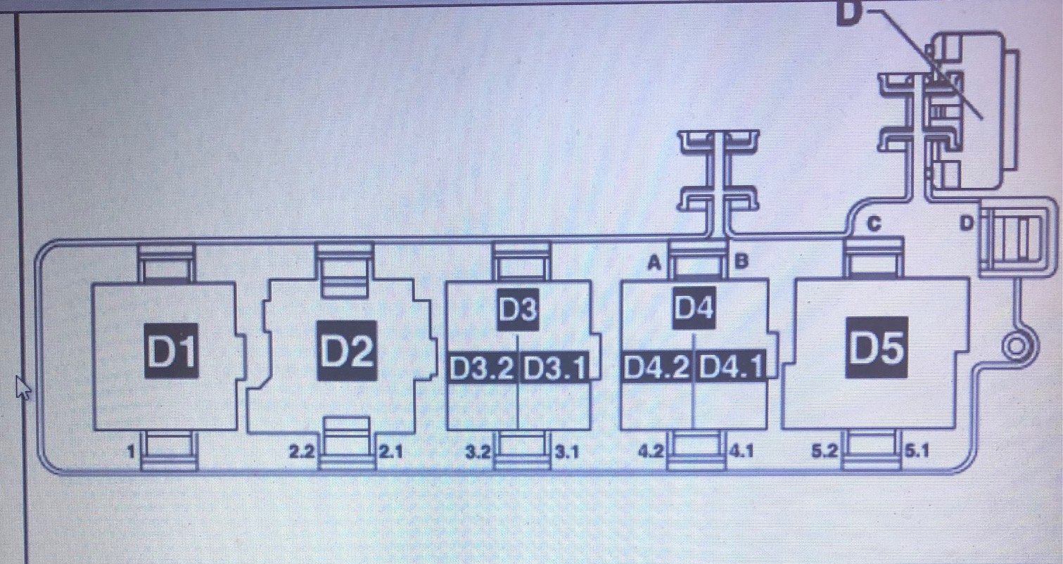

As it's an auto, it could be the starter inhibit relay
Thank you. Is that a big job to sort out? What testing would I need to diagnose?
It's relay D2 in the above picture under the dash drivers side, I would pull it out and just make sure the contacts are clean, if it persists probably replace the relay
Thanks Nige that's really helpful I will take a look!
