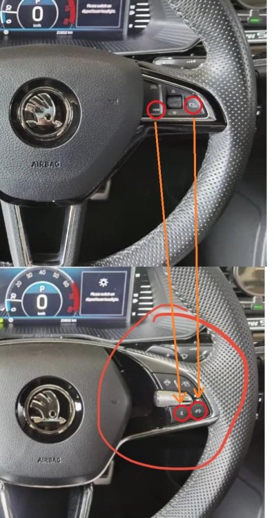

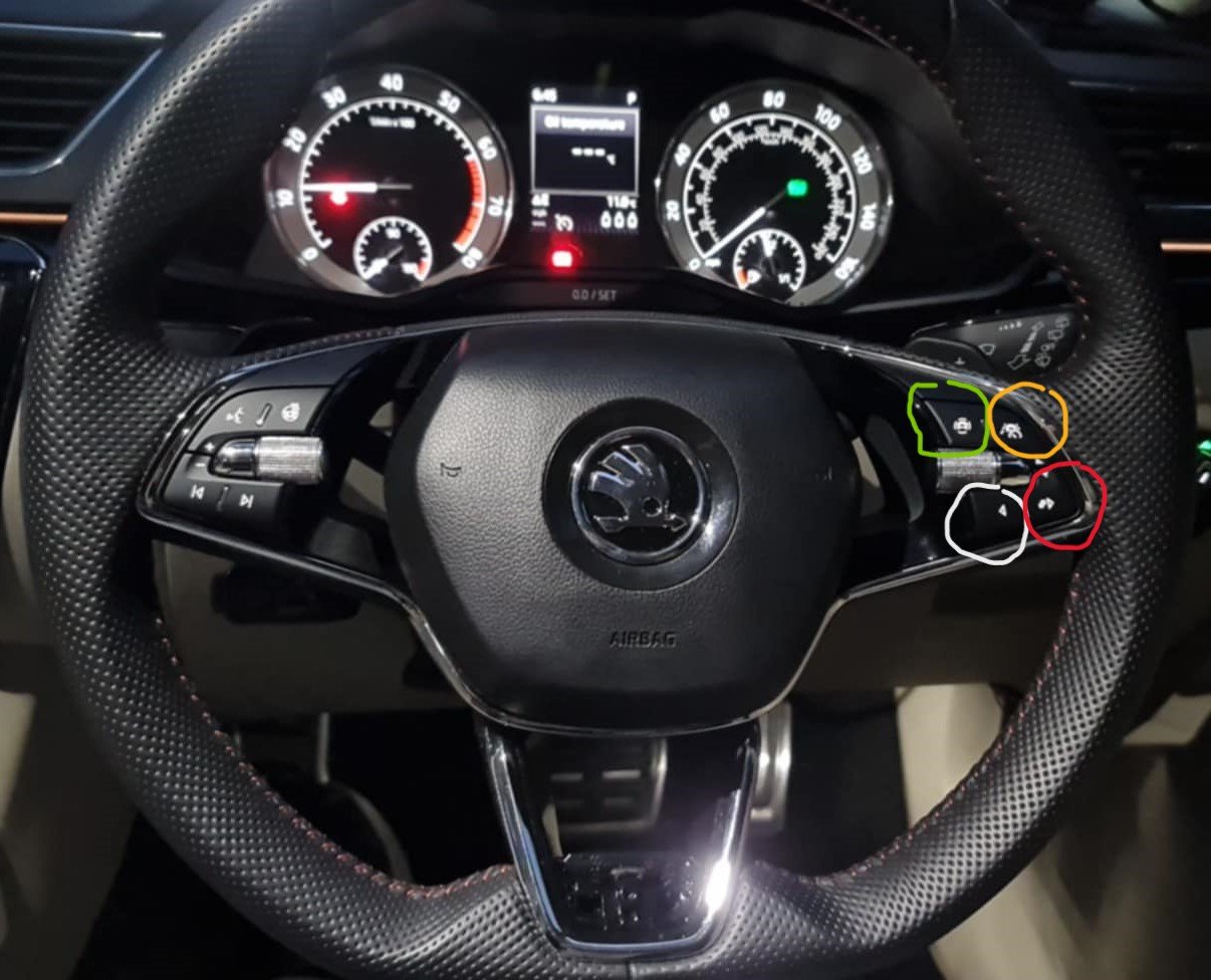

This is Arduino module that works with CAN bus(not LIN) and does not work correctly. The Travel Assist button for some reason triggers View.
Double-clicking OK also triggers View.
From the factory, this is how it works on the FL:
Bottom left arrow - Menu
Right arrow - View
So, if you’re gonna retrofit TravelAssist, then it’s not possible with Arduino CAN module.

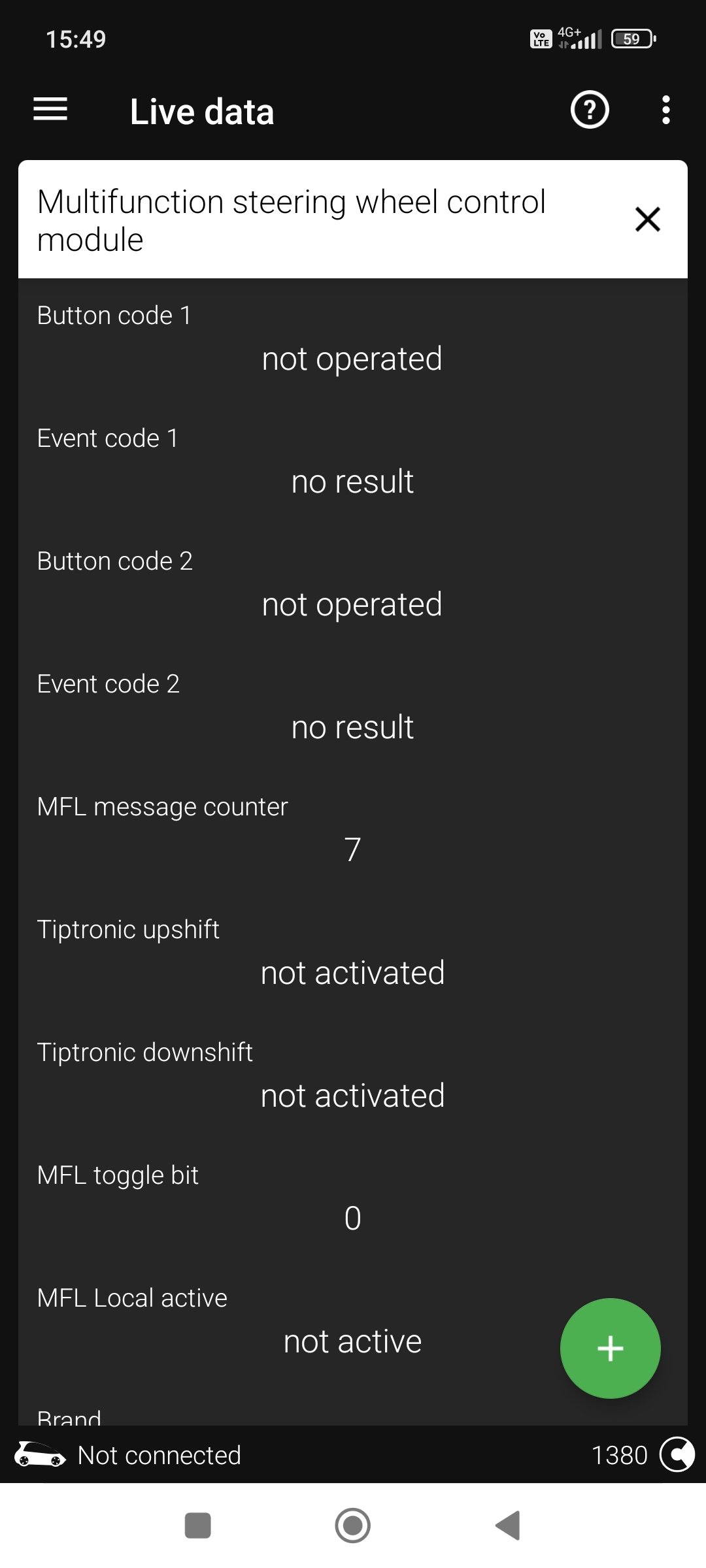

Button code 1:
is displaying the actual button that is pressed: "Voice", "Steering Heating", "A arrow left",...
Even code 1: is displaying: 1 click, 2 clicks,....
Nothing is displayed for Button code 2 and Event code 2 when any of the steering wheel buttons where pressed.
Any other ideas how to find the HEX code for 5WA Gateway?
Thx
45 minutes ago, djmartzian said:
Cheers @zacko_O
I've checked but without any luck ☹️
Button code 1:
Thx
