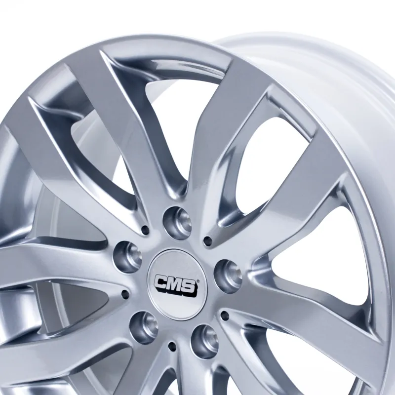

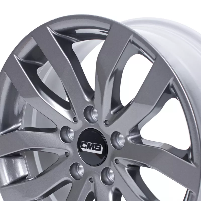

Right now, because of looks (and modest price), I'm tempted by CMS C22 (i believe CMS makes the original Orion wheels on my car) in either racing silver or titan gloss for about 340€ a set. they look good and won't break the bank + they are to OE specs:
CMS C22 Titan Gloss
CMS C22 Racing Silver
