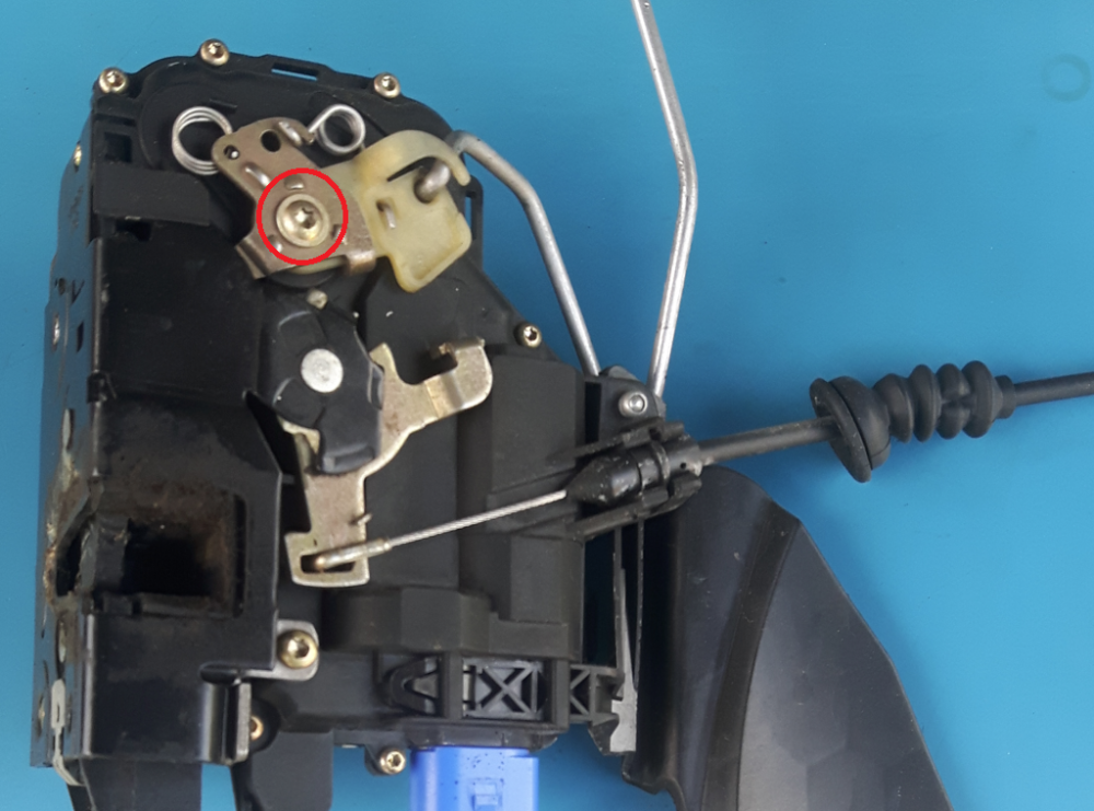

This may help, although Polo-based rather than Roomy, same principle may apply (see posts from 17th Feb>): Deadlock hack

Are you saying you drilled a hole, put a tool in the screwhead but still couldn't open it?
To get the rear donor door open I had to access the loom connector in the B pillar and feed 12 volts to the lock to enable it to open( using double door pull), I then changed the lock to the original in damaged door and before fitting connected it loose to the loom and checked that it worked , result , so fitted this to the donor door and all is good on that front. Passenger front door is more difficult, it is closed shut but has door card off, as you cant access the A pillar to get to the loom connector so I an going to have to figure out which two wires I need to add the 12 volt feed to open the dead lock. when I push the remote the lock mechanism works but the door will not open so the deadlock has to be at fault worst case I will dremmel and remove the deadlock. What a pain!

@Nick-w You don't seem to have understood the link I supplied.
The way I read it, if you drill a suitably positioned hole on the inside of the door metalwork, you can get a Torx screwdriver through it onto this screw, which then allows you to unlock the door directly without electrical help.
