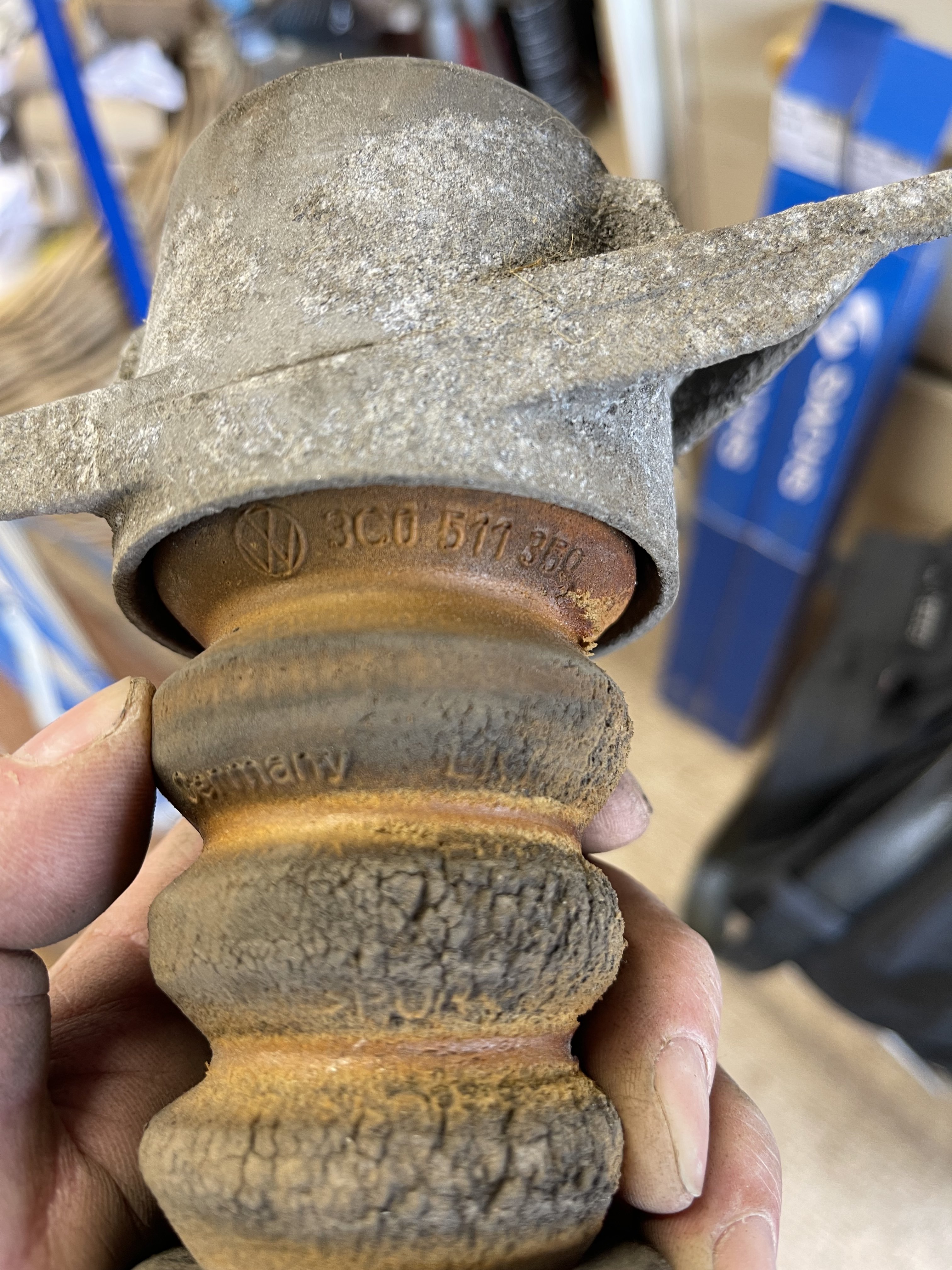

They are foam rubber convoluted sleeves that should sit at the top of the piston rod under the plastic cover and resemble a Michelin man, usually they have degraded dropping down bringing the dust cover with them exposing the piston rod to the elements.
Very cheap to buy, about €6 each and dead easy to fit, 20 minutes per side for a half decent mechanic.

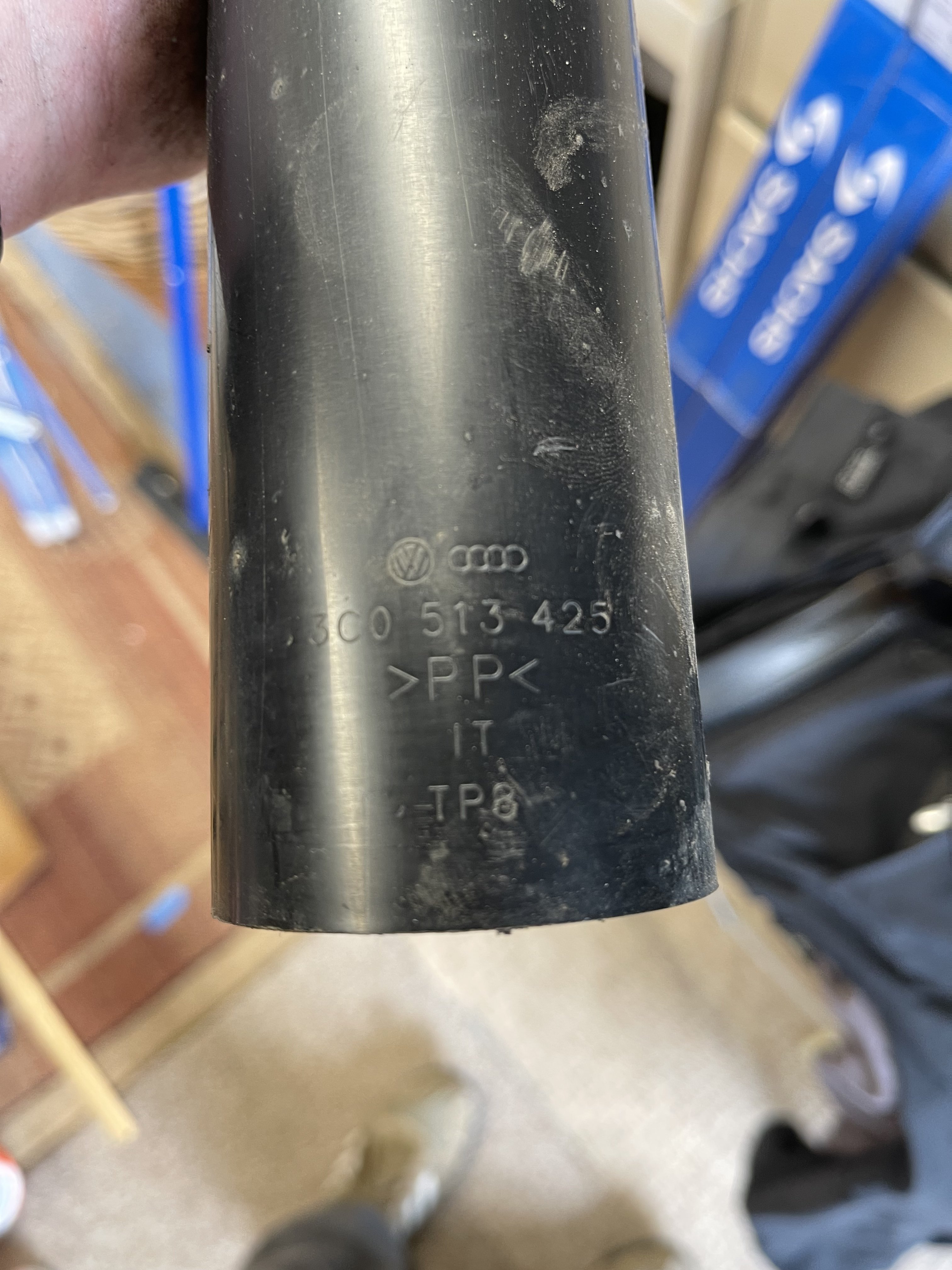

These are them, just had them off other day fitting new shocks and coil springs.
the cast part is a separate component

Those are they!
My new ones look as manky as those after only 2 years, I had to think hard to be sure I had in fact changed them and not dreamed it.
