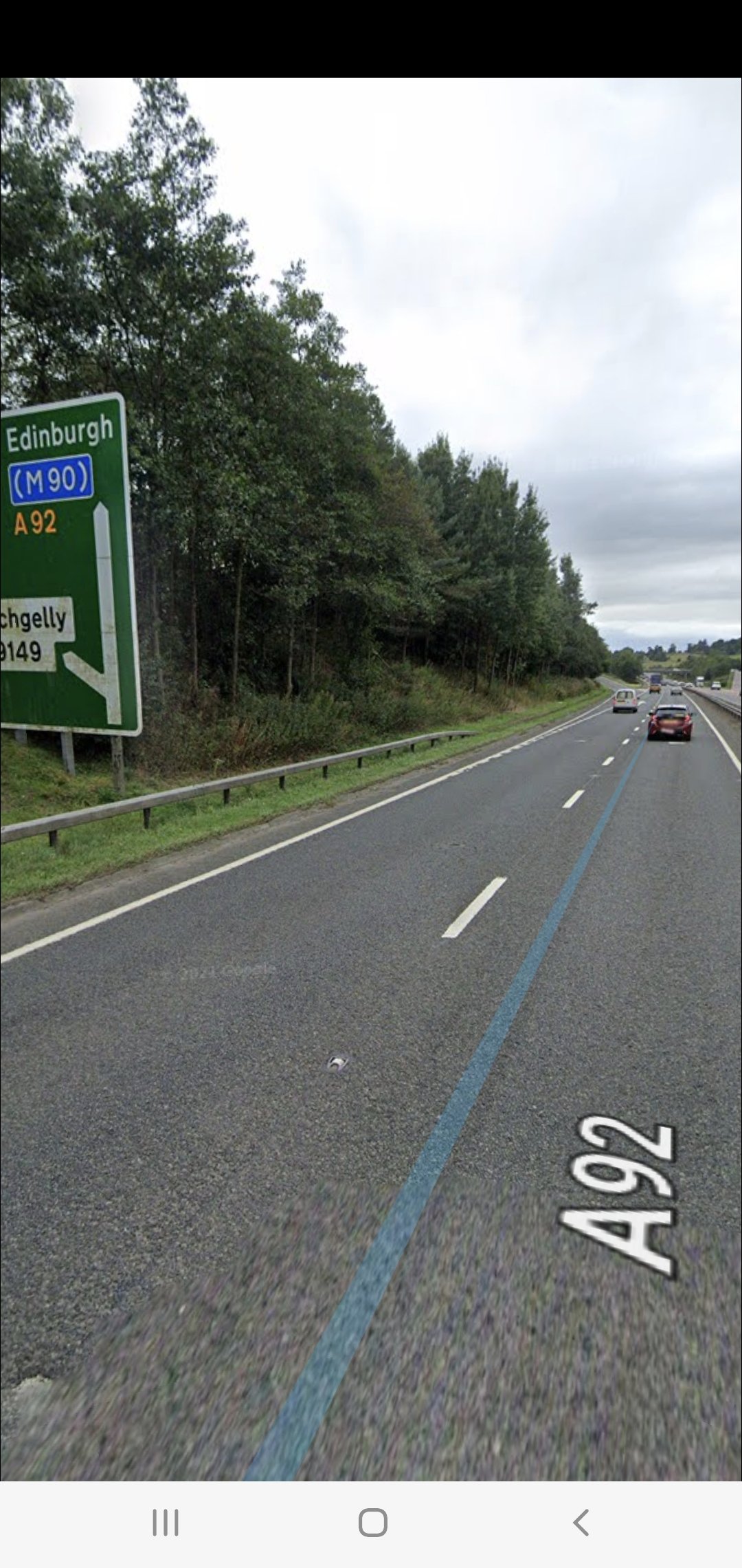

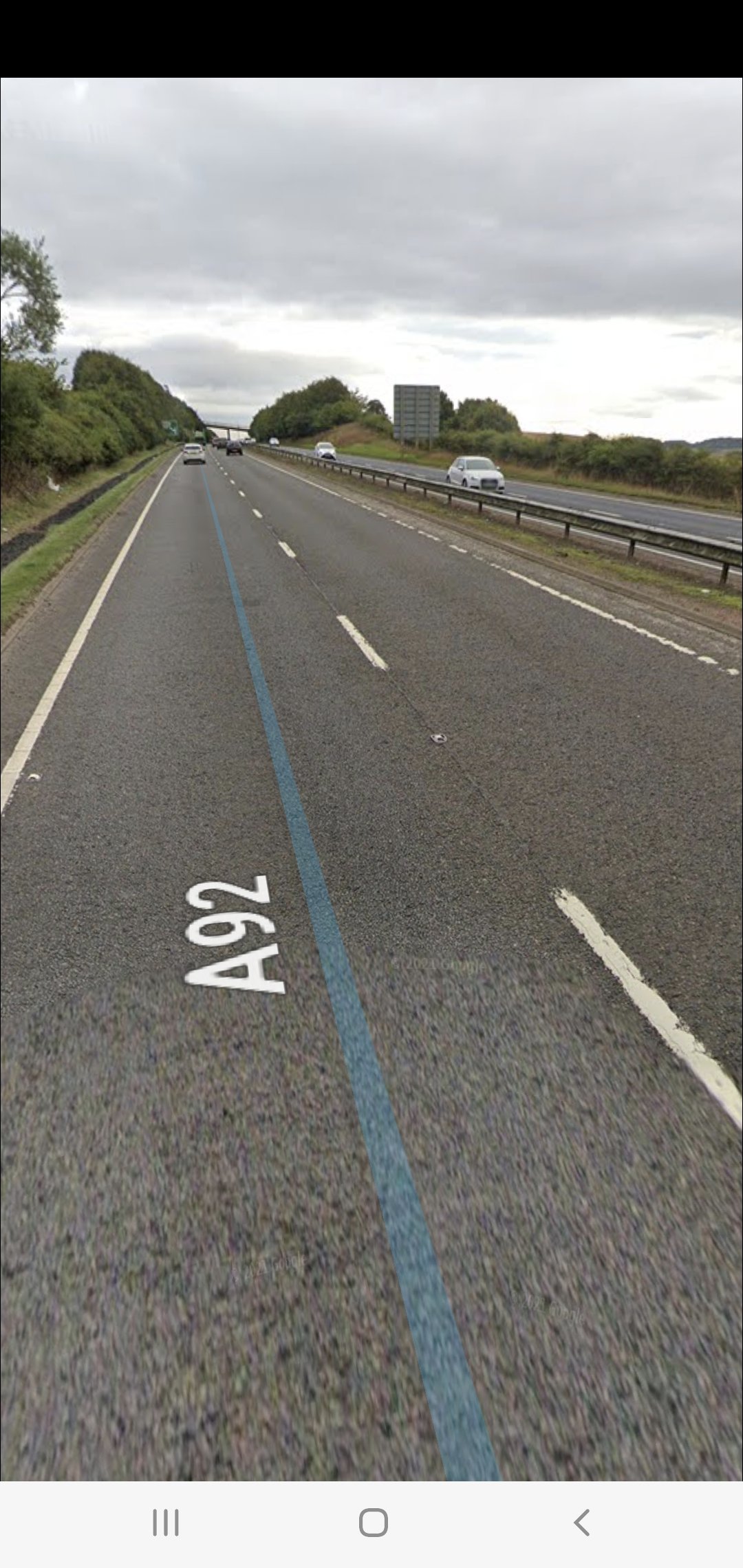

The point it usually happens is going to work its a slight downhill and heading home its a slight uphill, all within half a mile of each other. These pictures show exactly where it usually happens

On my way to work it would be but not on my way home. Its only done it once somewhere else, thing is I only really use the vrs for work tend to use a couple of old retro cars when I'm at home so that might be why it's only happened at that point.
