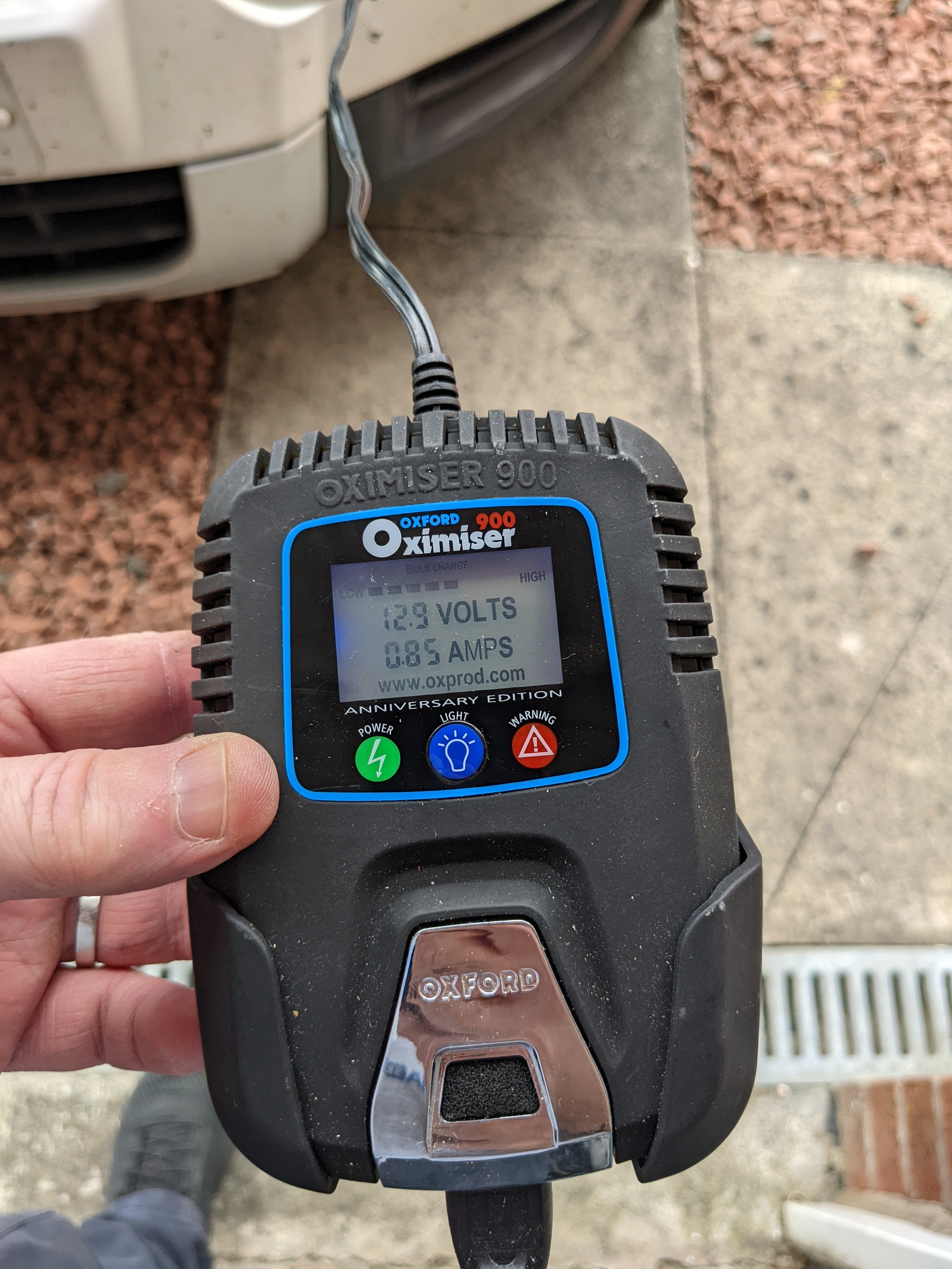

I've just checked the battery, 12.8v, 0.85 amps. Is that in good operable order?
What the hell is that 0.85 amps, was that connected to a charger?
You do not measure battery voltage whilst being charged.
Was that after being left overnight without starting the car?

What the hell are that 0.85 amps? Was that connected to a charger?
I used my bike multimeter; it's used for maintaining a charge for prolonged periods of inaction.
The reading is an overnight, from cold. So 12.8v should be reasonably accurate.
I take it the charger was not on overnight, but if not I cannot believe even a new battery would hold 12.8 volts after standing overnight without a charge.
No, I just tested it in the morning, and that was the reading I got.
It's for keeping bike Bike batteries maintained but it should be accurate.

Is that image with it plugged into mains?
Strange it has an AMPS reading.
Edit: To save going round in circles I know that was plugged in, that is the charging voltage that will say very little about the state of the battery.
It has to be in the morning after standing all night with NO CHARGE to give a voltage that pertains to battery health. On a volt meter NOT on a charger.
