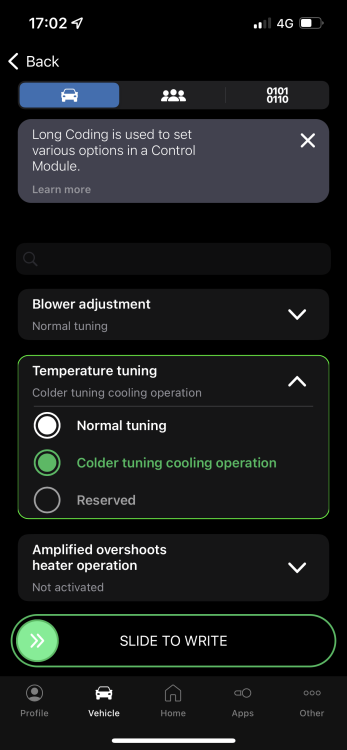

As well as fiddling with the air-con profile settings in the climate menu, you can change the air-conditioning settings using OBD Eleven/ Carista and the like to change it to "hot country" settings, making the compressor cooling rate increase - I tried it with the hot country setting enabled and it does make a noticeable difference to how quickly it will cool the cabin down to the desired temperature
IMG_7911.thumb.PNG.963b1098ee188cd8e5ca5f83e7962d78.PNG Thanks - I already did this mod using Carista but the difference is only marginal. I never use the Auto aircon setting, only Manual.
