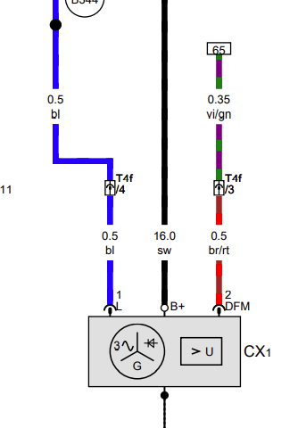

Check for broken wires at the alternator signal (2 pin) plug interconnect which is usually on a bracket near the starter motor. Possible blue wire broken.

Apparently it goes via pin 4 of a four-way connector pair on CAVE engines, 'front left of engine bay' (right as you look in from front bumper)
CX1 is your alt. Blue wire is what helps it start up correctly, which it seems not to be doing.
Alternative to visual inspection is to measure voltage at pin 1 of the two-way at the alt, with connector disconnected, ignition on. Should be about a volt below battery voltage.
Edited by Breezy_Pete

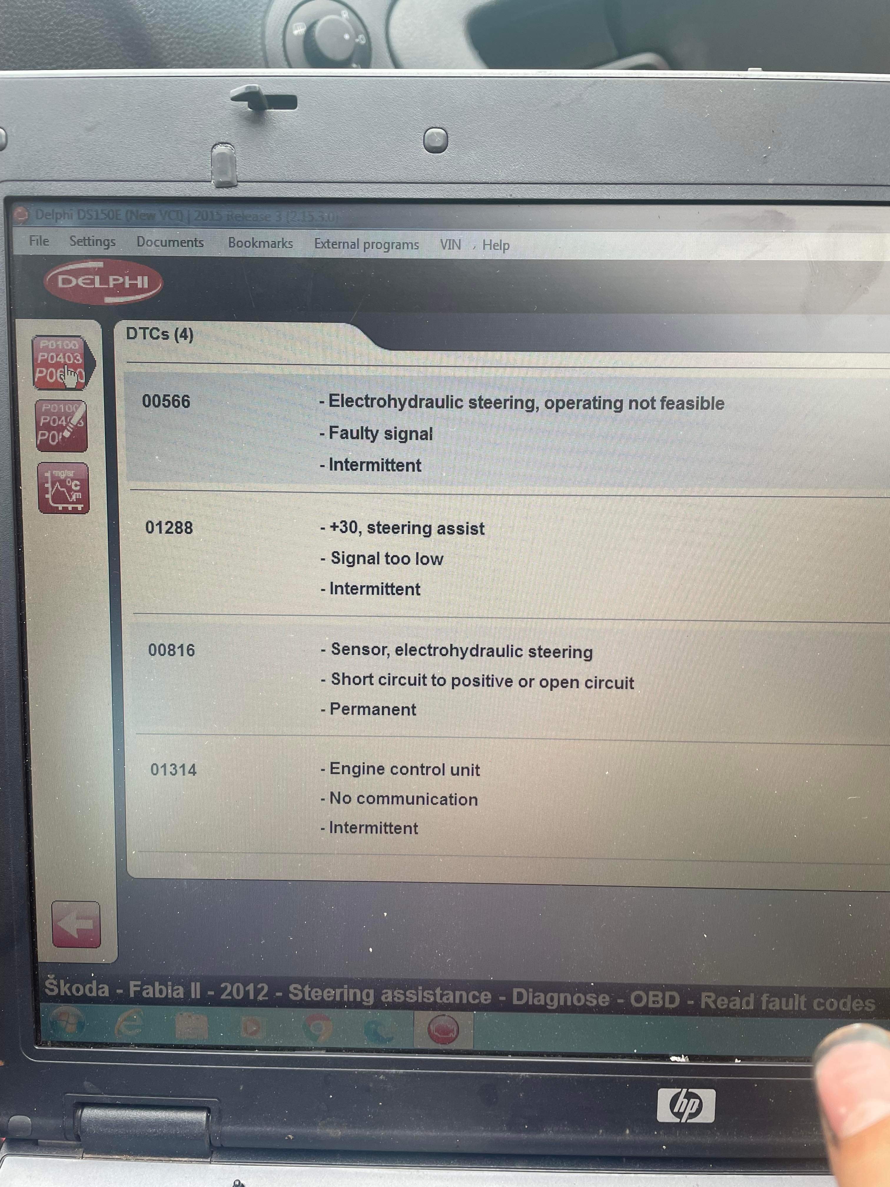

Thanks. I can’t get near the alternator without removing a load of bits so will get it my next day off. I did replace the steering pump , got one from the local breakers yard.
it’s as if the steering is partly working , warning light is still lit. Strange thing now is that the pump keeps running even when the ignition is switched off, only way to stop it is disconnecting the battery.
  • Sponsor
Seems to mainly point the finger at the angle sensor or its wiring/connections.
