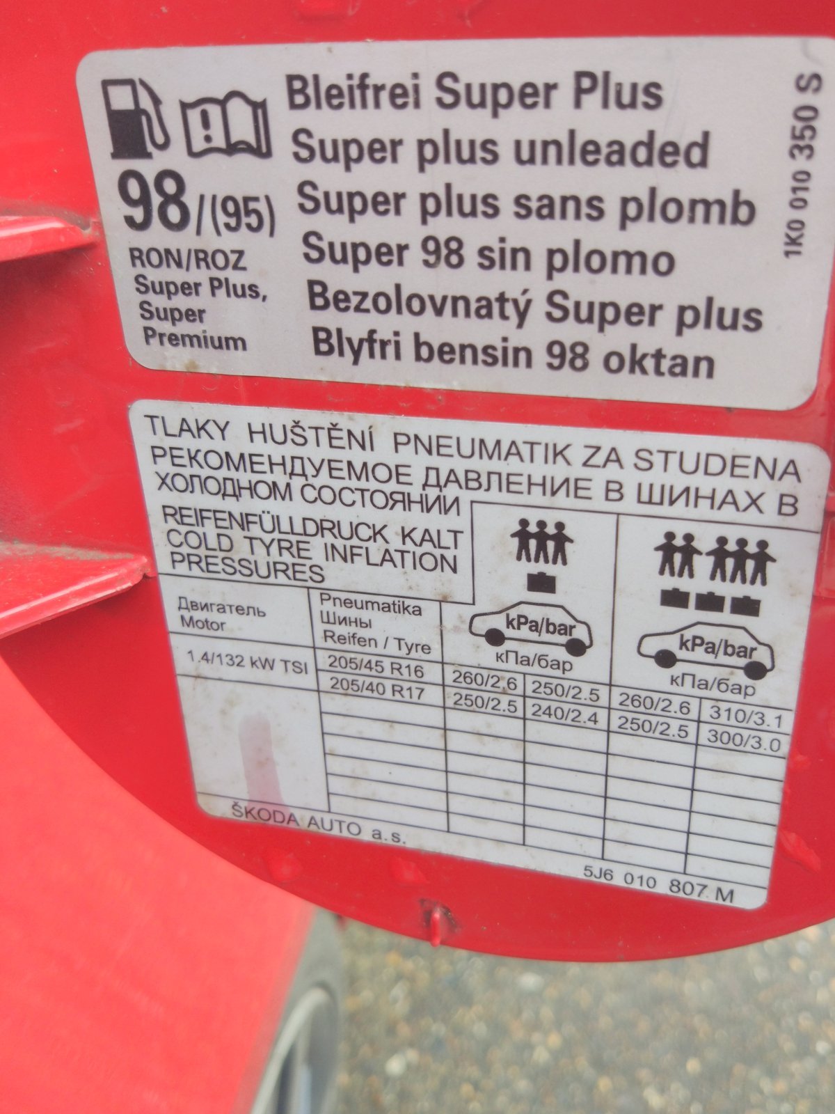

Are you able to run the car on Super Unleaded or are you just running it on Unleaded 95?
