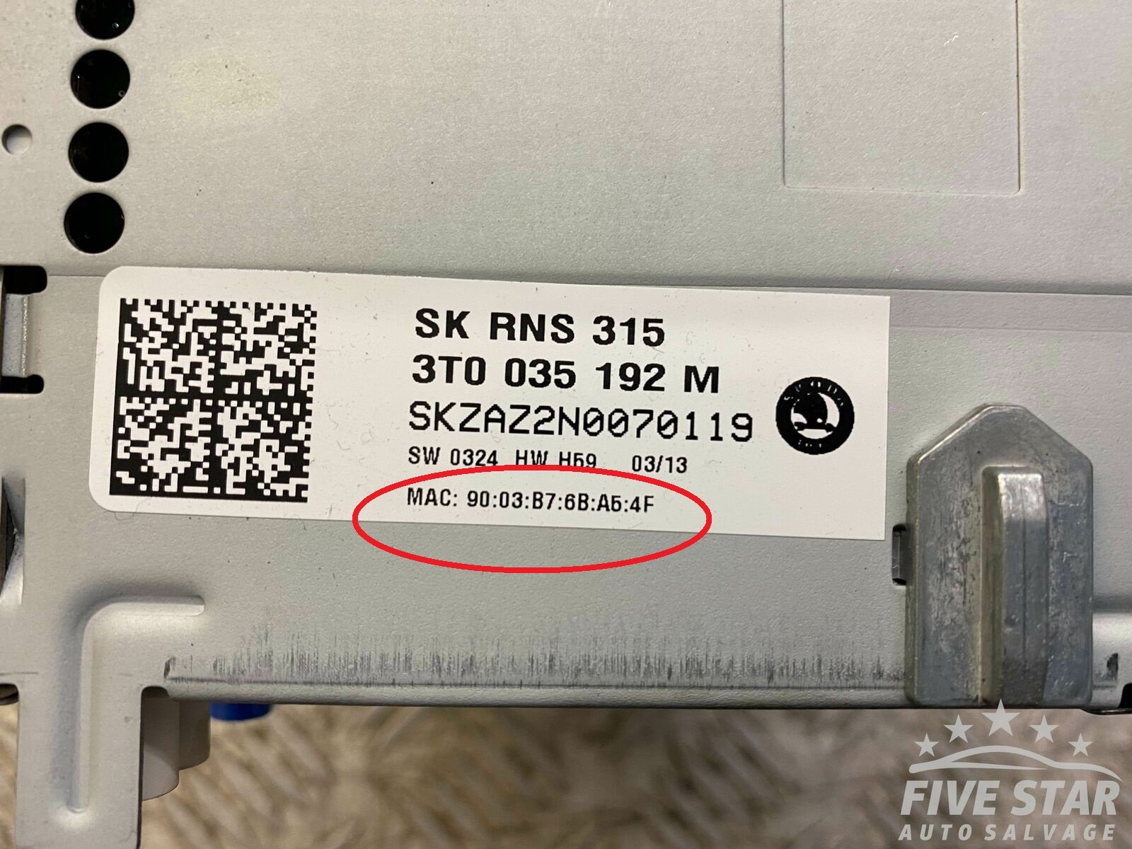

Amundsen can be bought WITH or WITHOUT bluetooth, you simply have to check the radio label to see the MAC address, if its ALL 0's there is no bluetooth, if its populated, then bluetooth is built in.
so..........Ignore Amundsen , Amundsen + (some have no writing like mine), even the factory part number, you NEED to see the label as in the attached picture showing the MAC address is populated (bluetooth built in) if its 00:000:000 (no bluetooth)

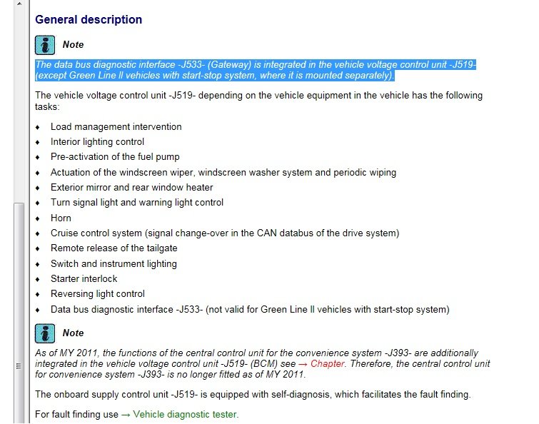

You "could" replace the CAN gateway (if its a seperate module)......need to check this if thats possible, or maybe new BCM then you would also need VCDS or similar to code a used / new module to your vehicle.
Edited by UrbanPanzer
The canbus is built into the speedo head on these fabias
not sure why you think that, it certainly is nothing to do with the speedo head.
If you have a Greenline with stop start, you CAN gateway is a seperate module (for some reason)................otherwise you would have to update the vehicle voltage control unit (BCM) as its part of that module.

The "brain" of the car is in 1, or several control units depending on age of vehicle...........as an example, on my 2013 vehicle, the CAN gateway, central convenience and voltage control all come in 1 control unit the BCM, thats the daddy of the electrical system.

CAN gateway will be a sub-module of the vehicle voltage control unit above accelerator pedal on that age of Fabia, I think, same as on mk1.
Edited by Breezy_Pete
I don't think it is Pete, only on a Greenline with start stop tech, all the others it's part of the the vehicle voltage unit.

So you WILL need to buy either a replacement CAN gateway (seperate module) OR as I strongly suspect a replacement BCM with a later revision.
