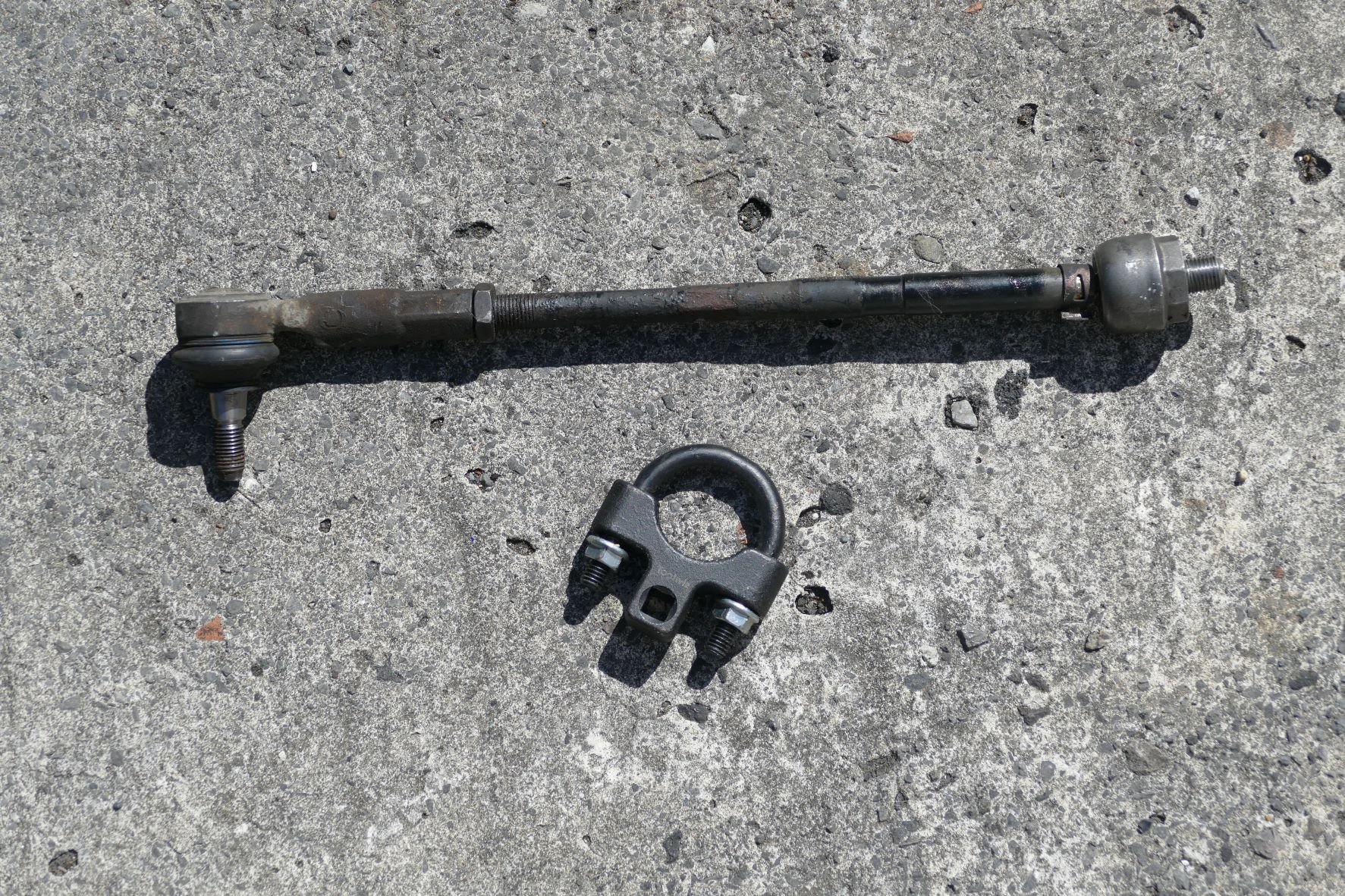

I decided as a challenge to do the work my self and its not been easy with one trackrod end so tight I had to use a 2ft bar and socket to release it then cut through it with a hacksaw.
I used a clamp tool to free the inner rod hub ,but if ( and I'm not)I was ever to do this again I would use the tube type tool which locks on the rear nut of the inner track rod.

Well done! My 2007 1.9 suffered the same seized trackrod end issue, with at least 3 separate tyre places unable to free it. Cutting a long and painful story short, my usual garage replaced the track end and rod  (and boot, burned by one of the other garages...). Out of curiousity they then took a destructive angle grinder to the old seized joint and it still wouldn't free, it was absolutely solid.
Twice in its 120k mile time with me it was on (different) 4wheel alignment jigs;  both times  I was shown that the rears were slightly out but was told that there was no means of adjustment for the rear.
Yes John mine was the same as if the parts were welded together! I have only had 5 cars in a lifetime and this is the first on to have this problem. The 12 to 13 years I have had the car its been garaged every night so corrosion ?  I have always serviced my own cars but never thought to cover the threads and nut with copper grease as I now do.  With the new parts even considered  fitting a small electrical rubber shroud (used in electrical construction industry)and filling with grease to slide over thread and nut  ,but thought this might confuse MOT and tyre staff.
