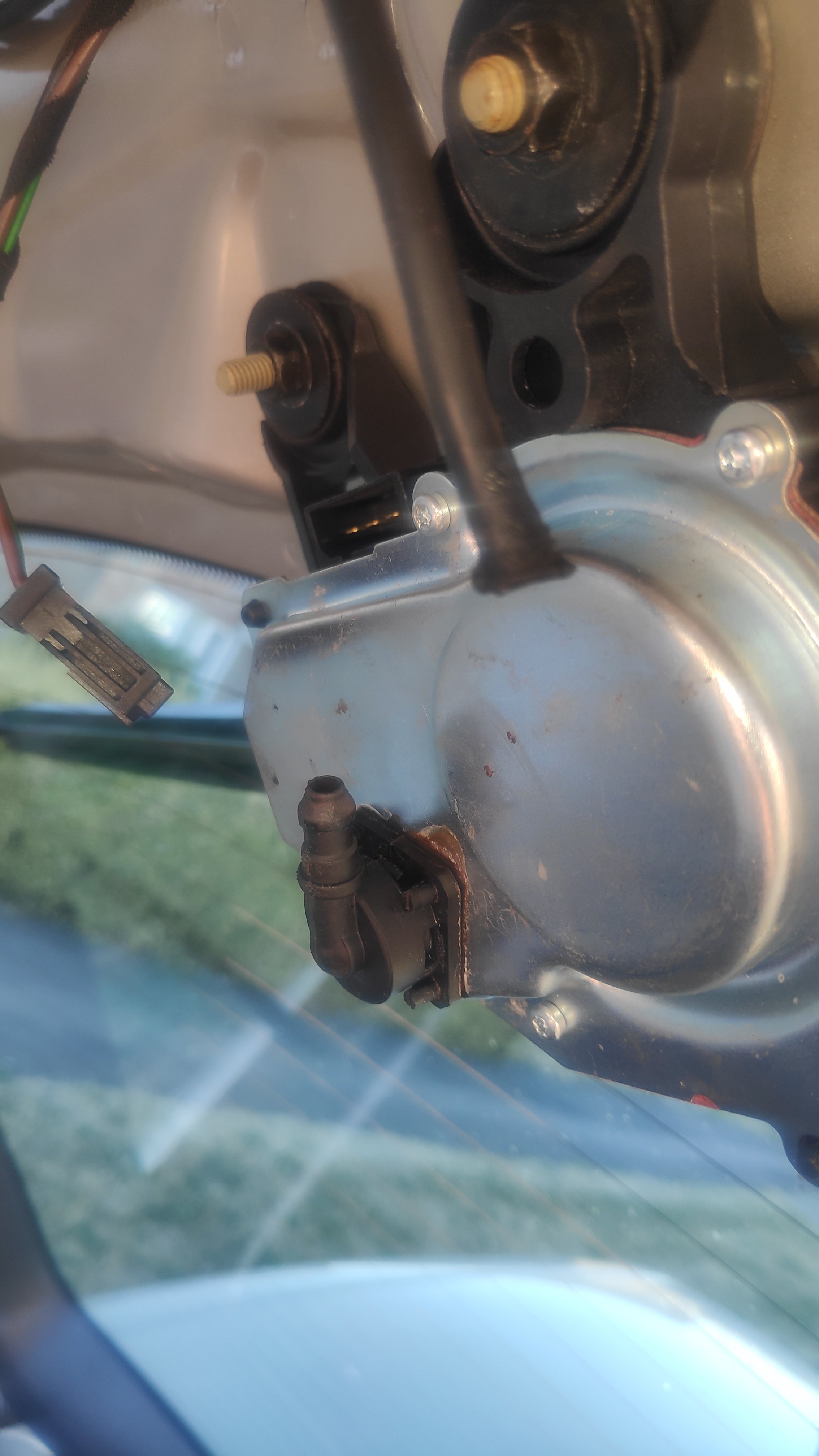

had my car VRS diesel a while now and the rear washer has never worked ?? Read up about the jets been blocked so cleaned up still nothing bought new as you couldn’t move the jets rusted up,, so this morning I decided to remove the boot lid cover and see if I could see anything as it sounded like I could hear water ??? 🤣,,
well I’ve just seen that the actual plastic bit on the wiper motor has actually snapped clean off 🤣🤣,, as it’s plastic can that be replaced or is it a new motor ??

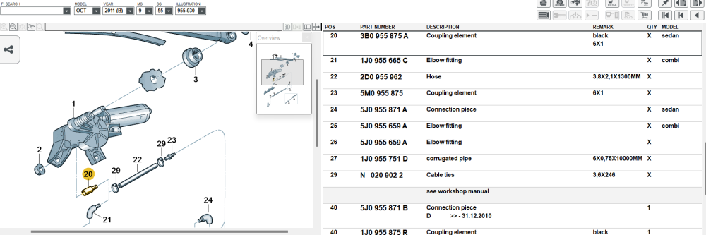

You might be in luck, but you should really check against your VIN at dealer/TPS as this could be wrong part.
Here are the less than useful removal instructions that don't show the coupling, but often they don't anyway.

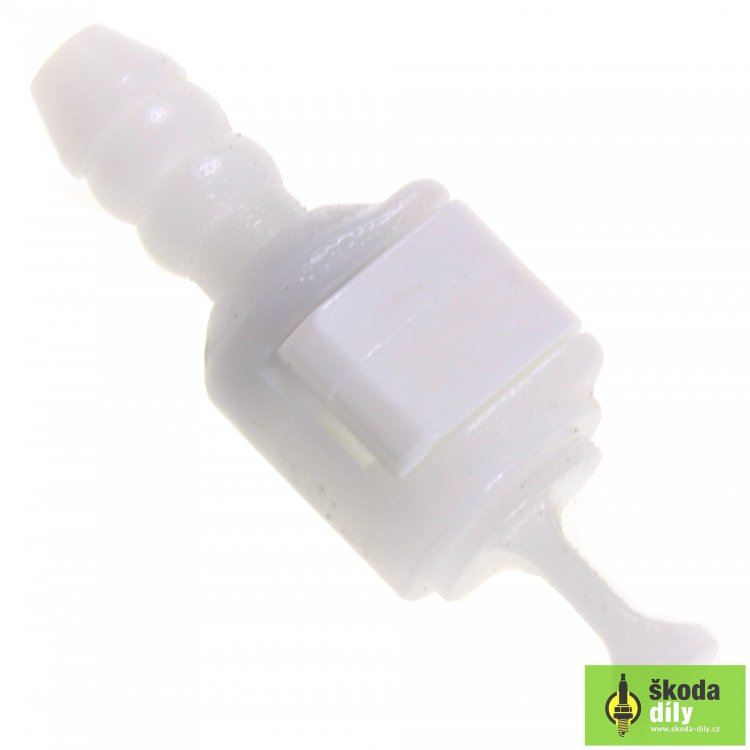

Year 2010/11 all use the same part, 3B0 955 875 A
This has image of the part
https://www.skoda-parts.com/spare-part/3b0955875a-coupling-element-37202.html
You may wish to check if the snapped off part is still in the end of the water entry point still, as you won't be able to fit new one.
If there, you can probably pick it out, maybe a small self-tapping screw carefully screwed in a little will tease out the snapped off part if still embedded.

It’s the bit on the motor that’s snapped and the part you have a pic of is still intact (thankfully) the bit on the motor looks like it kinda clips in so wondered if it was interchangeable or I’d have to purchase a new motor with it on

The connector does appear to have Male connections at both ends?
Can you see any evidence of this inside the entry location where it should plug in?
Didn't want you to beat yourself up when you get new motor and find that you could have changed a cheap part.

The bit on the black part on the motor has a male fitting and that was in the boot lid, it fall out in the boot when I started popping the clips to remove the trim,, the white connector part on the pipe is a female connection, can’t really get a pic of it now as I’ve put it all back together but it looks like it’s a complete new motor judging by the diagram you showed me 🥲🤣
Could be, shame that it snapped.
this is what mine should look like on a new motor

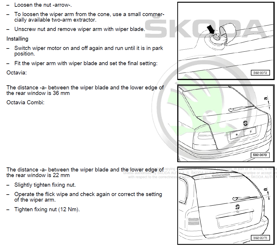

You should only need to "calibrate" the end point.
I would take off the wiper arm, and then get someone to do a flick wipe from inside the car, try your best to observe the stop point of maximum clockwise rotation and mark the thread if needed.
Repeat the flick wipe, and see if the mark or position you observed stops at 3 o'clock again.
Attach wiper arm, and take note of the measurements listed below, tighten up, repeat a single wipe.
Again gauge where it stops, and hopefully only a minor adjustment is needed.
You should not afaik need to remove the wiper motor, and I believe from reading documents, after 100 operations the motor will seemingly store end stop values.

Mate this motor practically wipes the spoiler as well 🤣🤣,, I’ll try as you have described but I’ve even got the stop/parked position lower than it was and it still wipers about 3” past the window onto the boot lid 🤣…

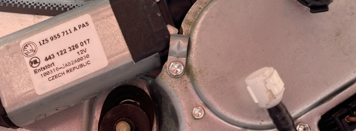

Have you got part numbers off both parts?
If not when you do a tear down, grab them if possible.

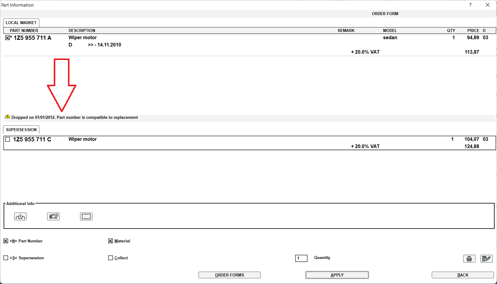

Ok, had a look and rotated your original image
1Z5 955 711 A
This has been dropped for replacement
1Z5 955 711 C
Edited by varooom
Added information
this is the one I purchased?? Numbers match minus the C
5DAE6642-AE83-4814-BDDB-31594A51EA1E.thumb.png.0039f21dd84d8ed370556dc2e442bafd.pngTried the video but I was to large but took a screen shot of the full wipe position and starting position,,
You needed at least A as matching yours, or the replacement C
At a guess, the swines removed the label, so you probably have one that's not A or C, which could explain the wide arc it takes
