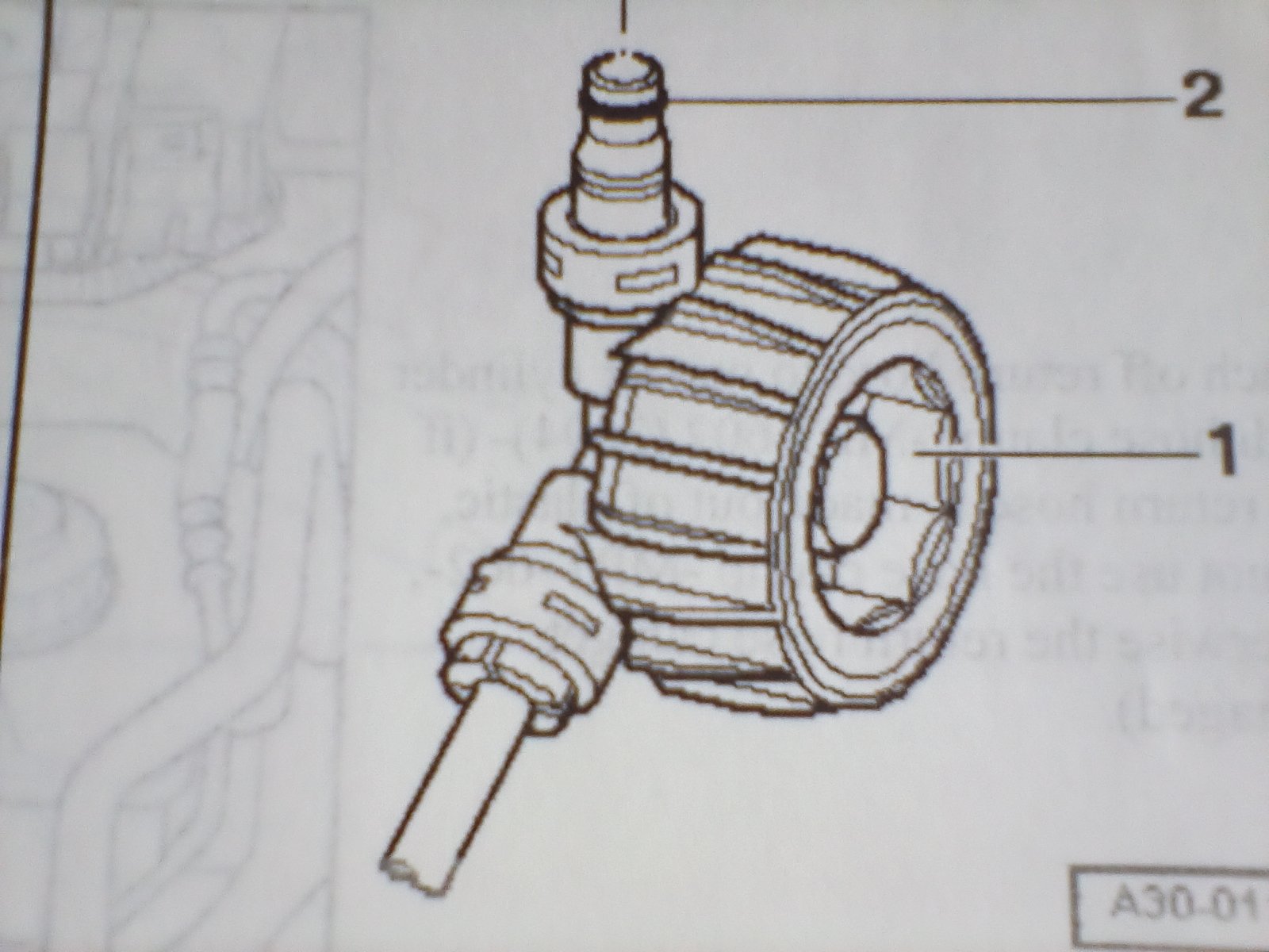

 IMG_20220822_085904.thumb.jpg.328bf25fcfb2ba1df5c5c0a8cebb2527.jpgfound how the garage does it.

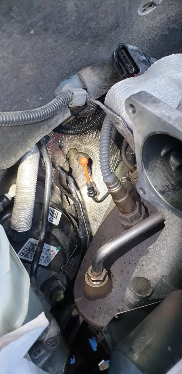

Just been out to try it again and there's no resistance on the pedal, topped up the reservoir to the brim, didn't Use any new seals as it was weekend,yes to taking off the rubber inserts and fitting them to the pipe,carnt see any leaks,there's a round thing in the pipework at the back of the bulkhead ?,   I've got a dentist app so I will try again in a couple of hours.thanks for people's help
Edited by sparky2
I have several of those round things, wherever the pipe takes a 90° bend, I never did work out what their function was but in my case it was a red herring.
What slave cylinder does your car have, is it an internal concentric release bearing one or the external one with a pushrod to the clutch release bearing lever?
You should have a flexible pipe to the bleed block, if you clamp that and very gently depress the clutch you will be able to tell if the air is upstream or downstream, if downstream the pedal will be rock hard, do not push any more as you will have no doubt noticed that the master cylinder pushrod is plastic.
Once again don't ask me how I know :sad:
Hi JR, it looks like it's inside the bell housing so I presume concentric,I will try clamping the rubber pipe but there is absolutely no resistance on the pedal and I pumped it up and down 20 times !  Is there anything inside the main cylinder that gives problems ? I will show a pic of the main outlet pipe after removal as I don't know if the seal was still on it ? Although I would have thought it would pee out fluid if it wasn't there.

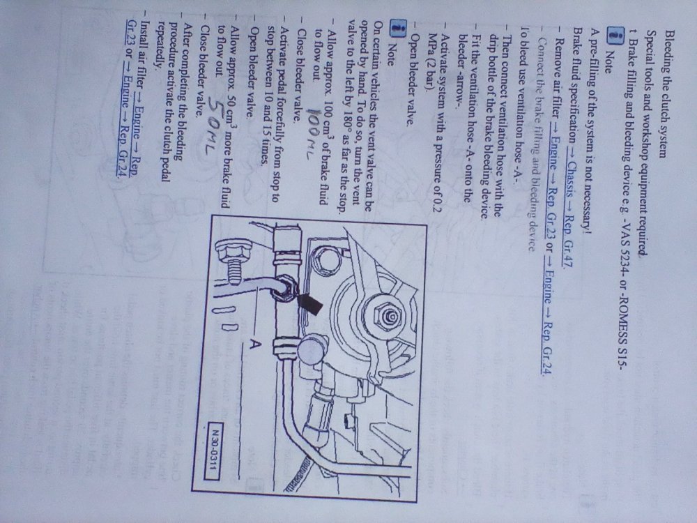

Hi J.R, apologies for reviving an old thread but I need to bleed my clutch so was reading various posts on here and just wondered where you came across this information that a pressure bleeder is not necessary and the system is designed to be 'gravity bled'? I downloaded the Skoda workshop manuals and they say to use a pressure bleeder? 🤔
