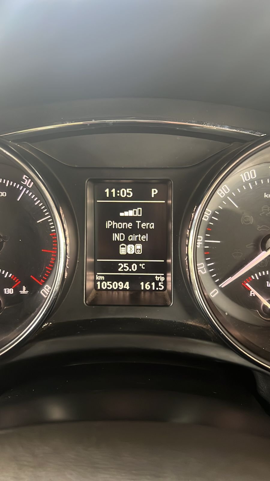

I installed the 9W7 BT module in my car. The coding for the Telephone module is done. I can now make calls and listen to music played from my iPhone.
What has happened -
The MFD that showed details like Fuel Consumption, Trip Duration, etc, has been replaced with a constant display of
The connected phone
Network Strength.
 I am unable to view the other info. How do we fix this ?
The back button on the steering wheel doesn't take you to the menu?
Nope. Tried everything that’s there.
Check coding of BT module and Gateway - you must select Skoda, not VW / SEAT.
I actually got it coded from a Skoda dealer here 😁
