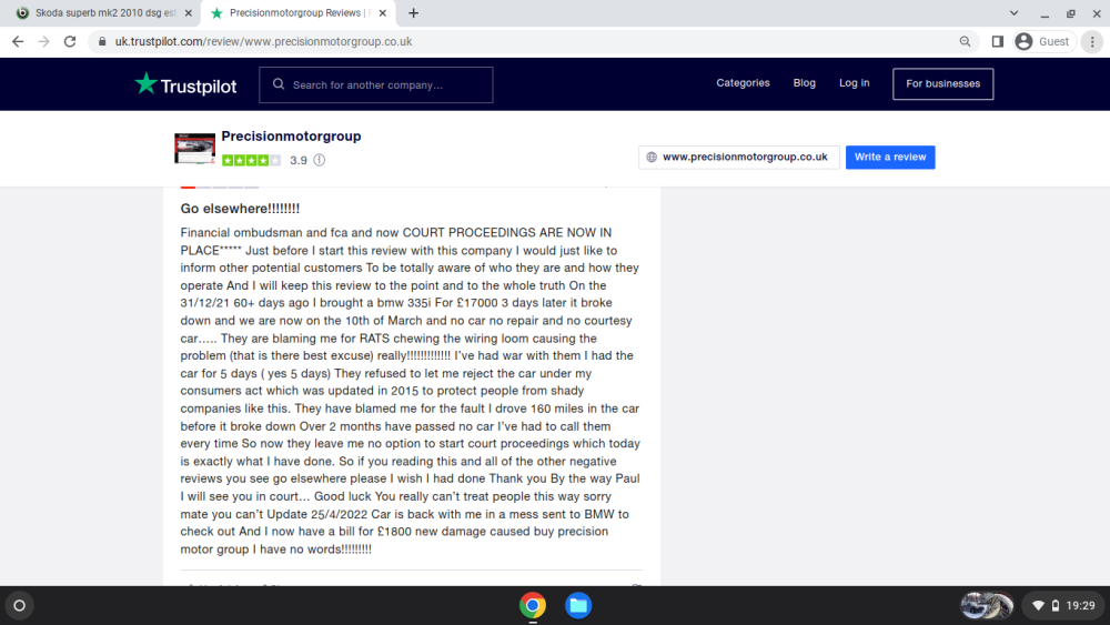

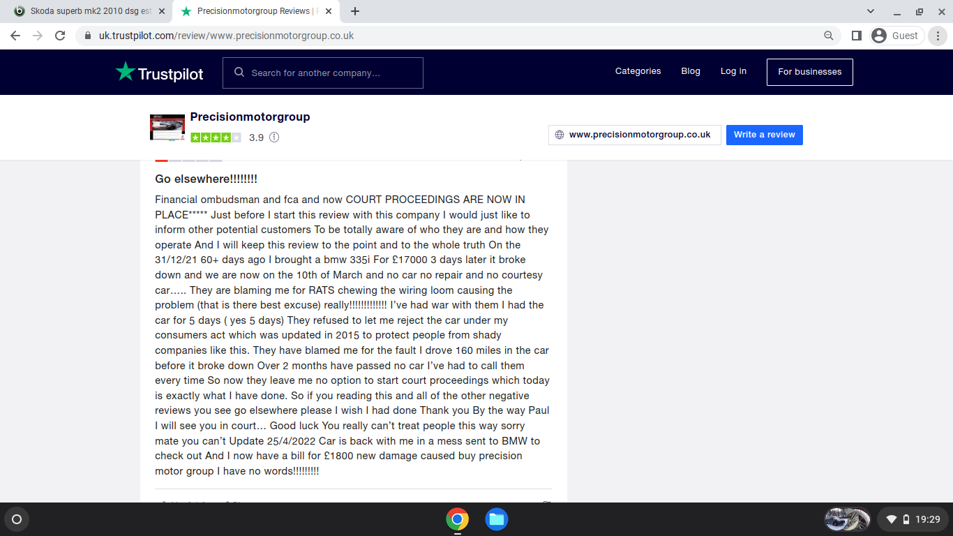

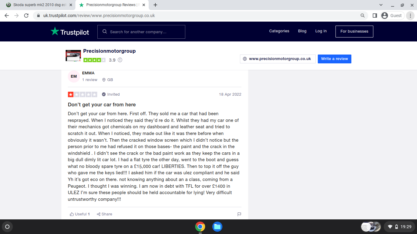

Are the tyres OK, matching, brakes looking OK, windscreen not chipped or tiny tiny chips?
Those that gave Good Reviews were happy.
Those that did not were not.

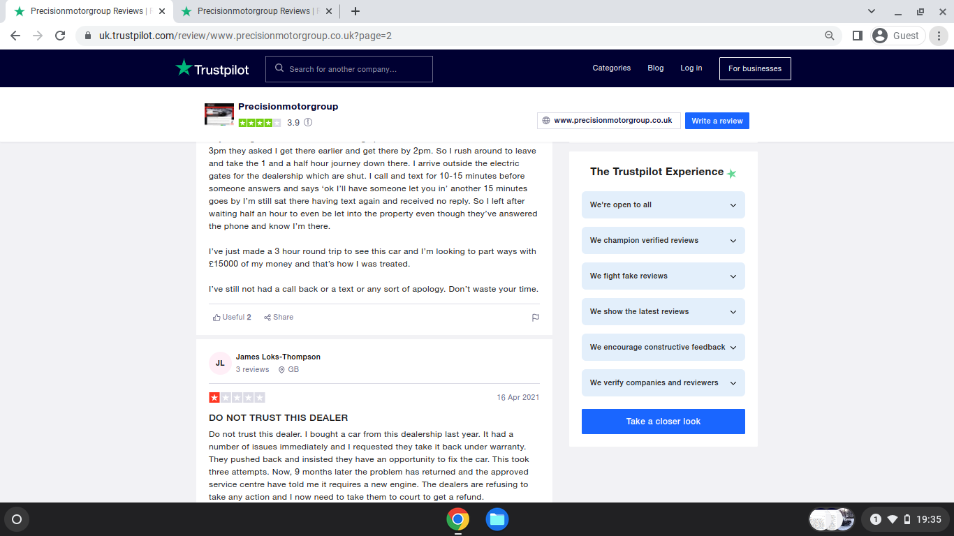

Edited by roottoot
