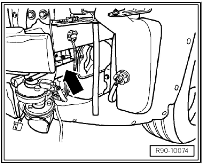

Have you been able to get eyes on the location the fan controller is supposed to live?
It does look fair tucked away, down very low.
Unless you are desperate for AC right now, I would pause buying new parts until you have checked more parts of the loom.
In engine compartment, front left -arrow-
Yep, (still) isn’t there ;)
The 2 rods are welded onto the chassisleg. The loom is tied to one of them. No relaybox there.
I’ll take a picture later today.
