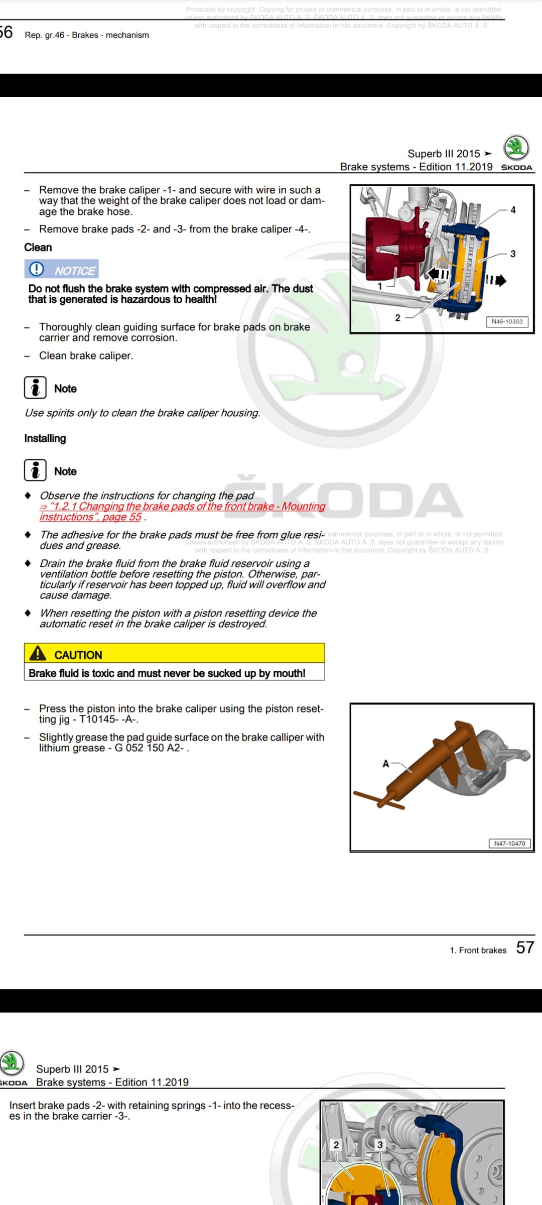

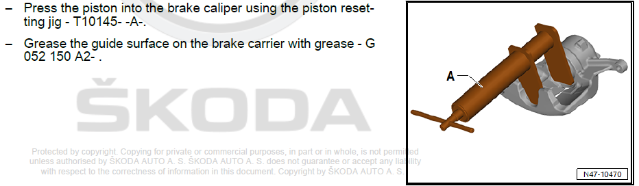

Image added

It's fine to push the piston back with or without the old pads still in place, it's also fine if the front pistons rotate while you're doing it. The rears, however, must be pushed straight back without rotating because this could damage the electric park brake mechanism.

Just something to add from my experience.
I completely get that the service manual shows pushing the piston back with no pads. In this situation its completely fine. There are 2 situations where it is not fine though.
1. Multi piston calipers. Youll be there all day fighting the pistons back, just leave the pads in and push back on them.
2. Ceramic pistons - Some expensive calipers have pistons made of a ceramic material - if you even try to push back straight on the piston youll crack it and they aint cheap.... Use the pads, make sure its completely square and push away.
