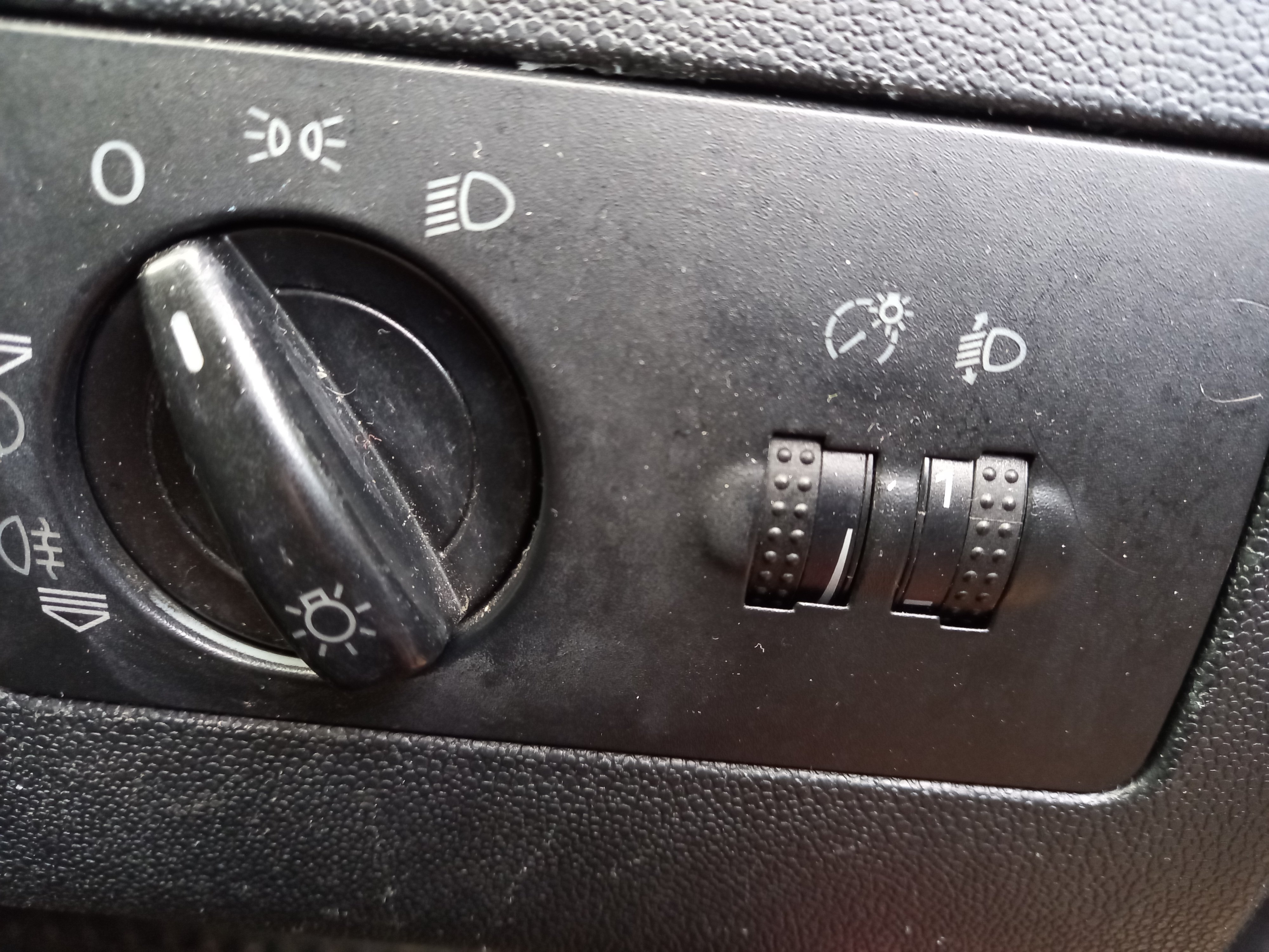

Grab a spare dimmer thumbwheel bit from a scrappy. I think there's some electronics behind it that may have failed.
Edit: that's after checking that it hasn't just got knocked round to a very dim setting!

No, the adjuster for the backlighting brightness, near the exterior lighting switch.
When I bought my car I thought the lighting had failed but then I found the thumb-wheel mentioned above.
There is none in my car.
